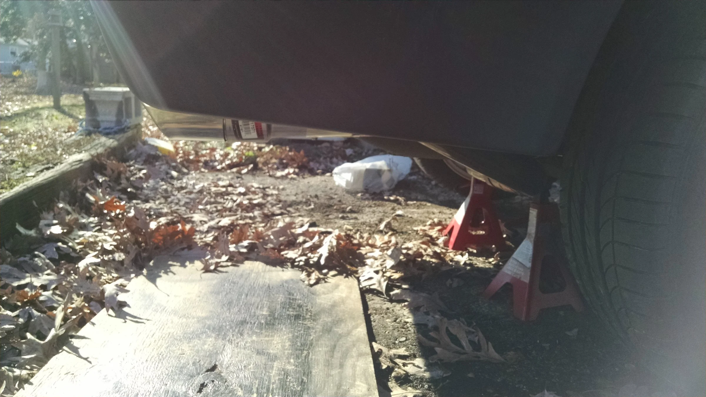

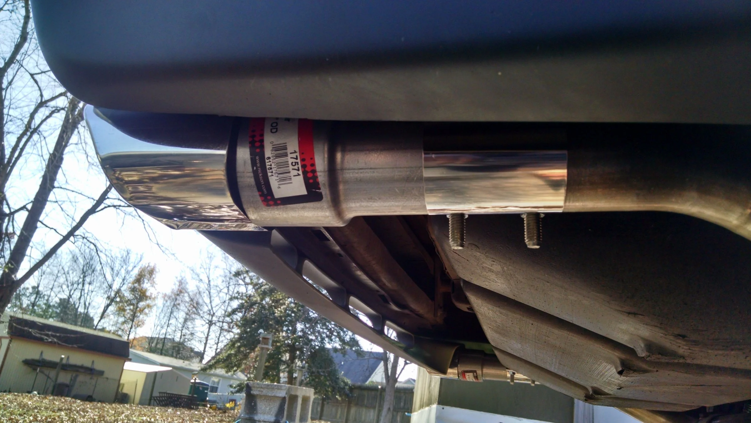

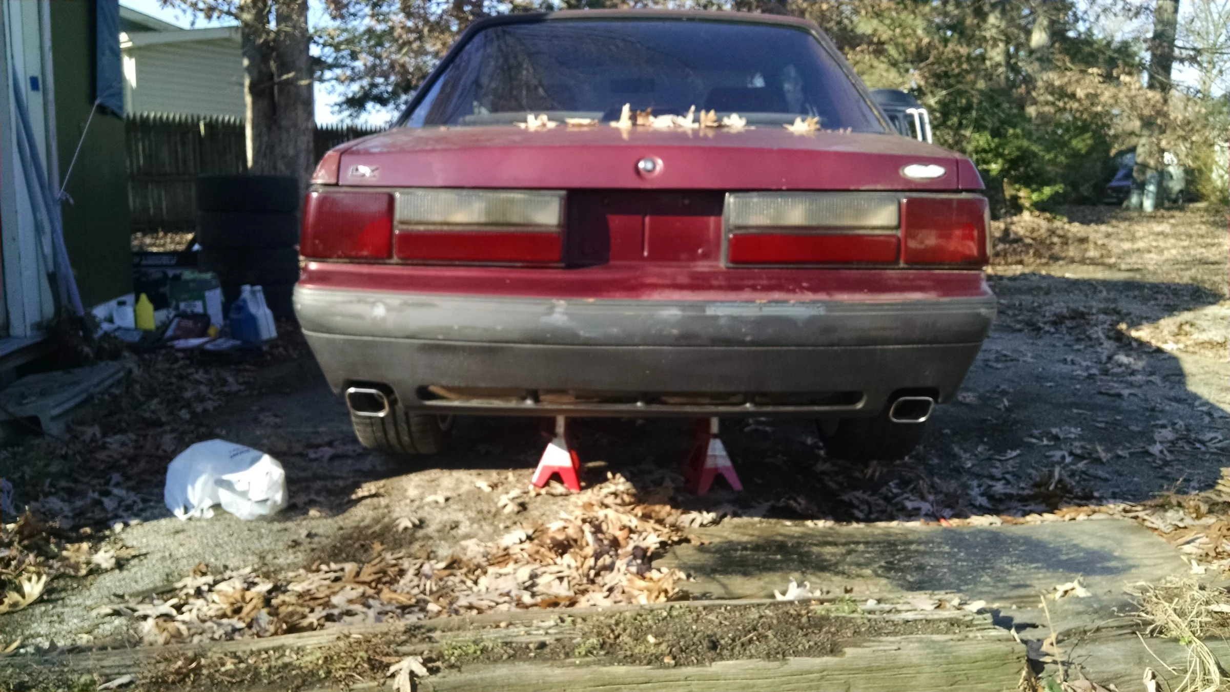

My rattles were caused by my exhaust....that I forgot was loose under the car. Had a buddy stop by and I fired her up on jack stands. The plate for the cut out takes three bolts. That thing sounds horrible when its loose.

Tightened up the exhaust rattles...but the down pipe bumps against my bell housing a little. The hangers should fix that [emoji106]
