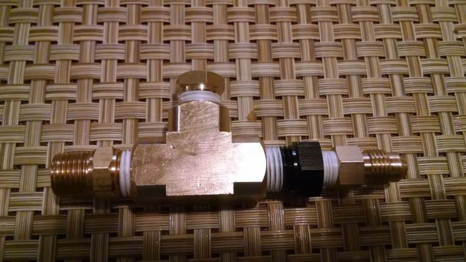

Looks like my fuel system did on version 1.

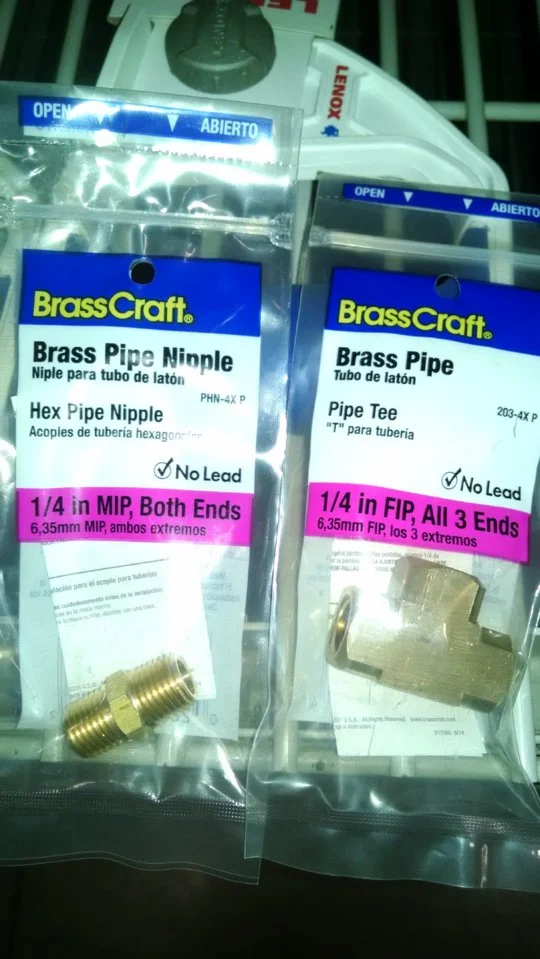

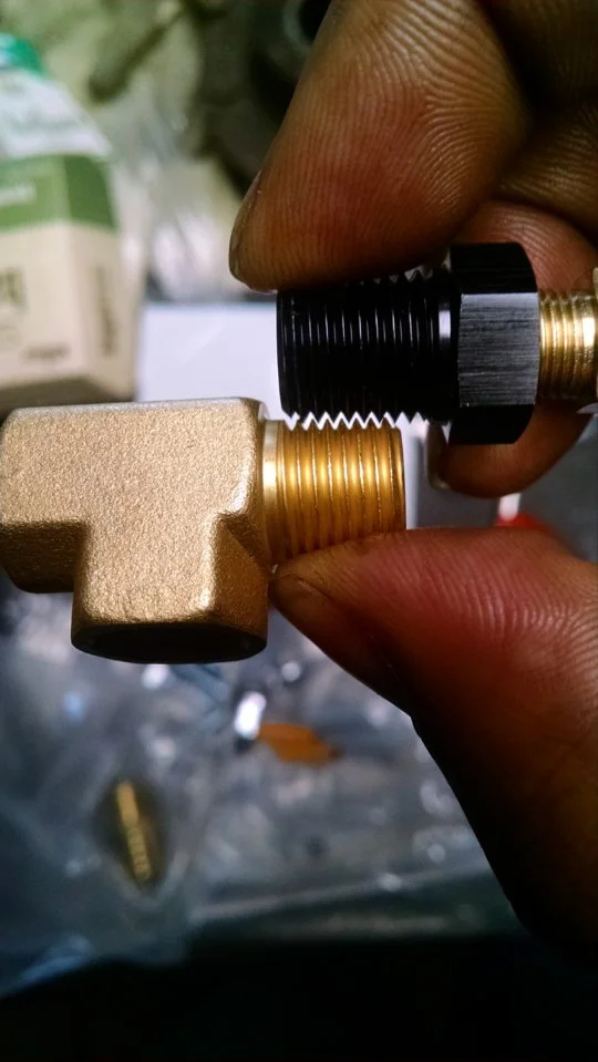

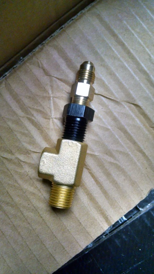

A word of advice... Be dang sure none of that teflon tape is able to get past the threads and into the turbo supply. It'll kill that turbo quick. When i had trouble with mine, that wasbthe first thing Chad accused me of, among others.
How about import grey silicone ? With tape or anything else I always leave the first couple threads clean. But pulling this stuff back off I can see how it could unravel and get pushed to the turbo. No more tape...i don't want to take any chances. Thanks @mikestang63 and @Boosted92LX
Wish I knew what the red stuff is they put on the threads of new screw in sensors.

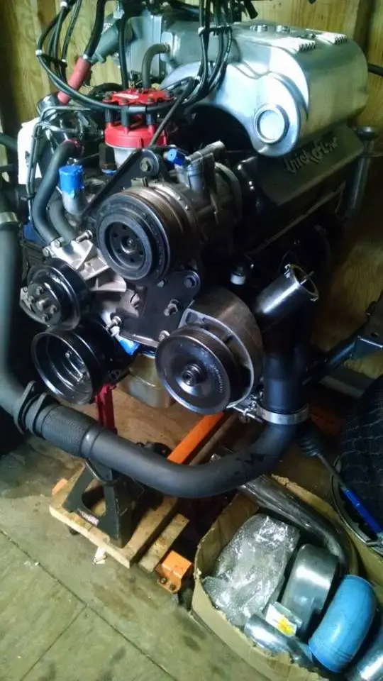

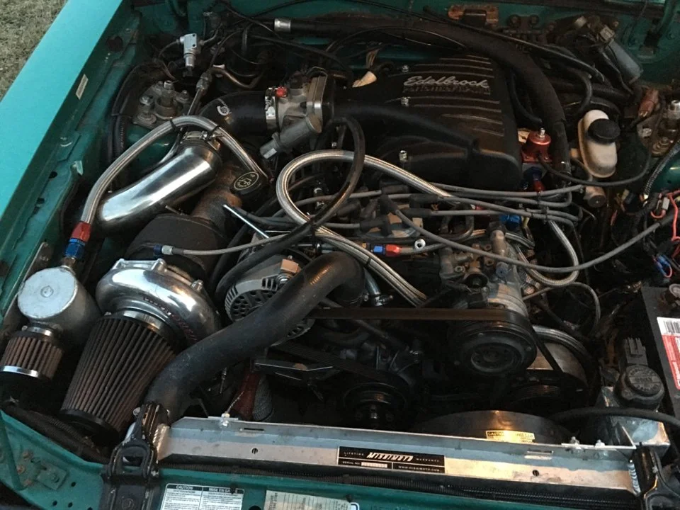

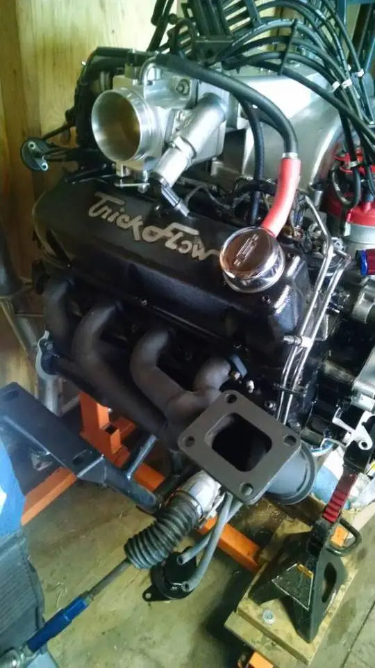

On3 says that the crank case needs to be vented to atmosphere...is that true ? I wanted to use a catch can to try and keep oil escape to a minimum.
Any ideas ?
Also, I was thinking of running amsoil synthetic 10w30. What oil is best for a turbo 5.0 ?

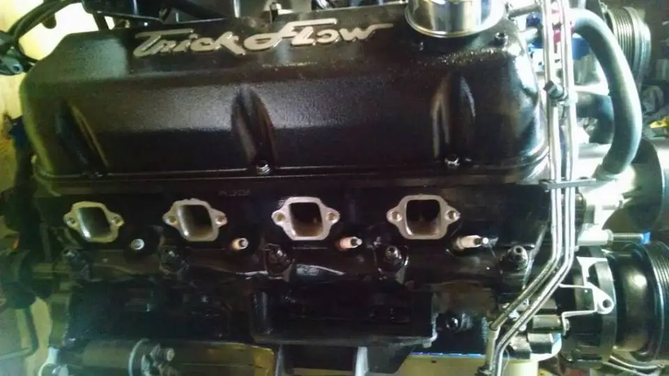

Could you post a pic of your can set up ? I only have one breather hole in my trick flow covers. I do have the pcv hole in the lower intake. Just sold my Motorsport vavle covers w/holes on both sides.... Smh ( I'm doing a lot of that lately )Don't use silicone on pipe threads. If not tape, use the ptfe paste. Silicone will leak.
If you don't use a catch can you are going to have a huge mess on your hands. My tuner told me to run two cans, one off each valve cover withno less than a -10 AN (5/8) hose going to each one with a 1 1/2" breather opening on each one. Anything less won't be enough. Using a catch can IS venting to atmosphere... It's just catching the aerosol of oil particles in your crankcase.

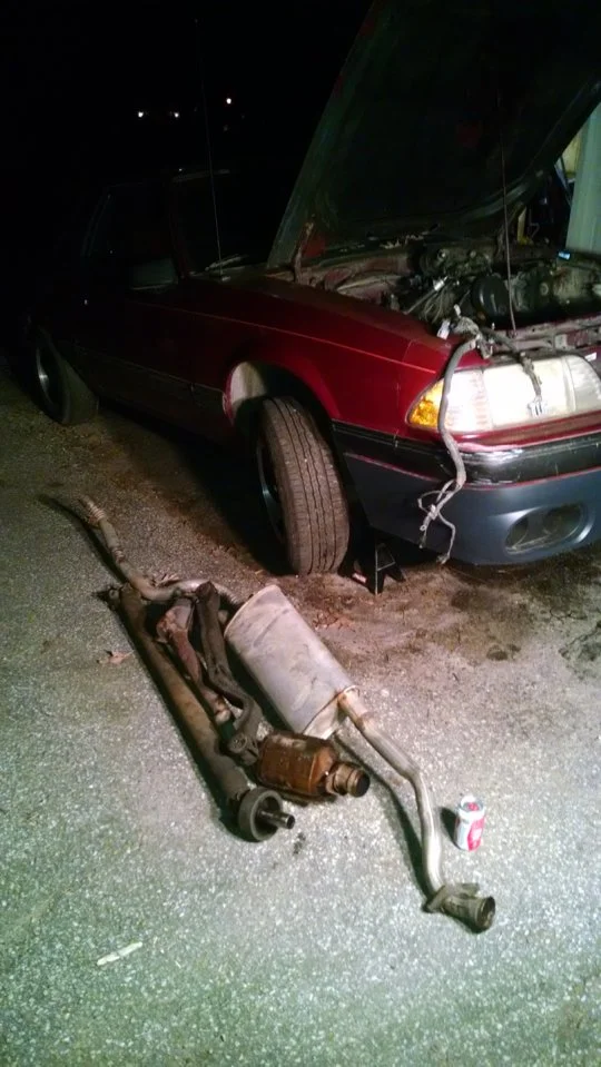

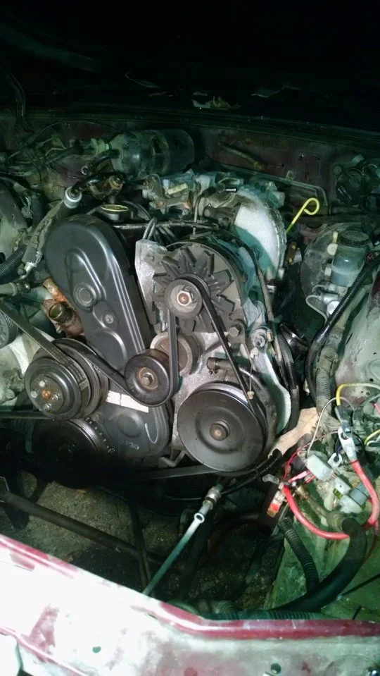

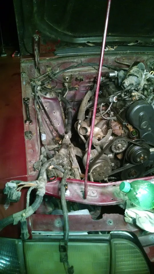

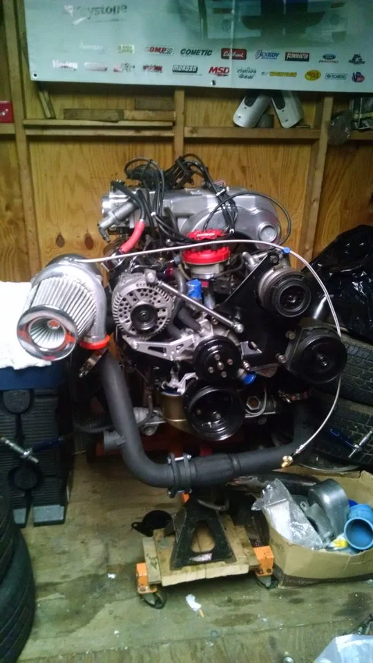

Make the plan, then just take one step at a time. I get overwhelmed when I think of all the stuff I have left to do on doby.Today when I get off I'm going to start taking the 4 banger stuff out of the car. This is an overwhelming task, unless you have a list, a plan, and a realistic budget.[emoji85]
