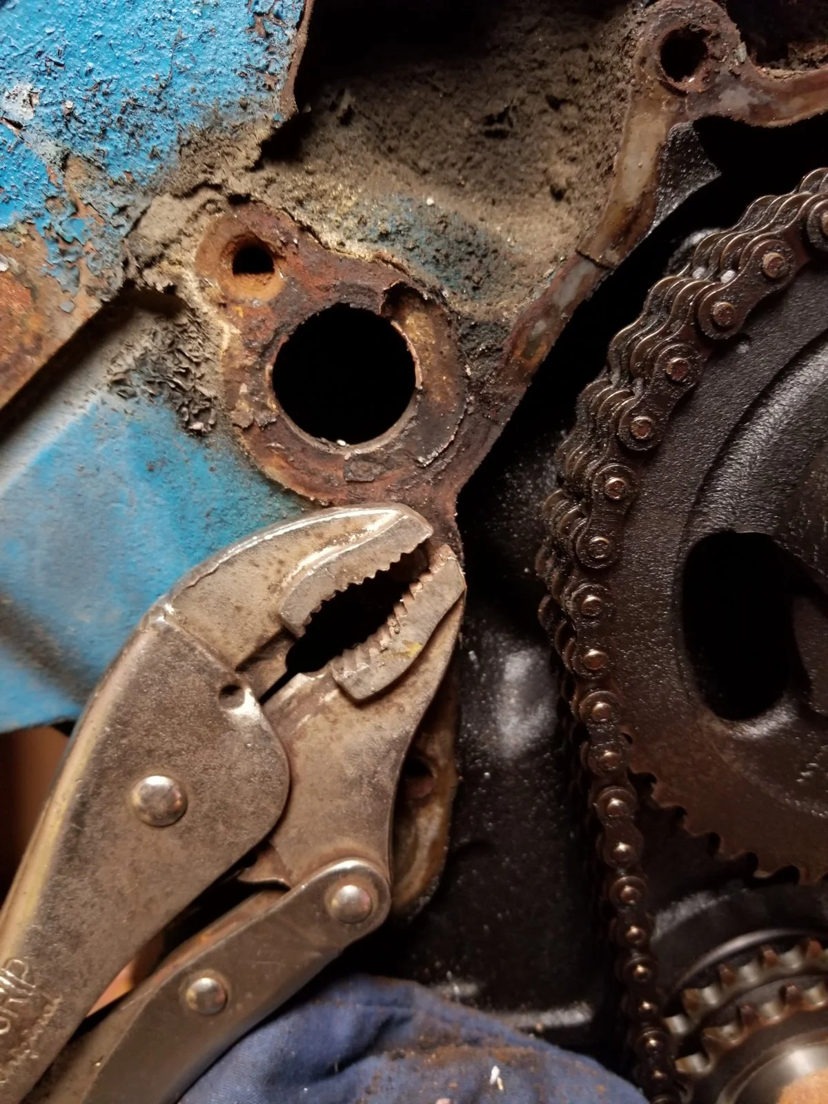

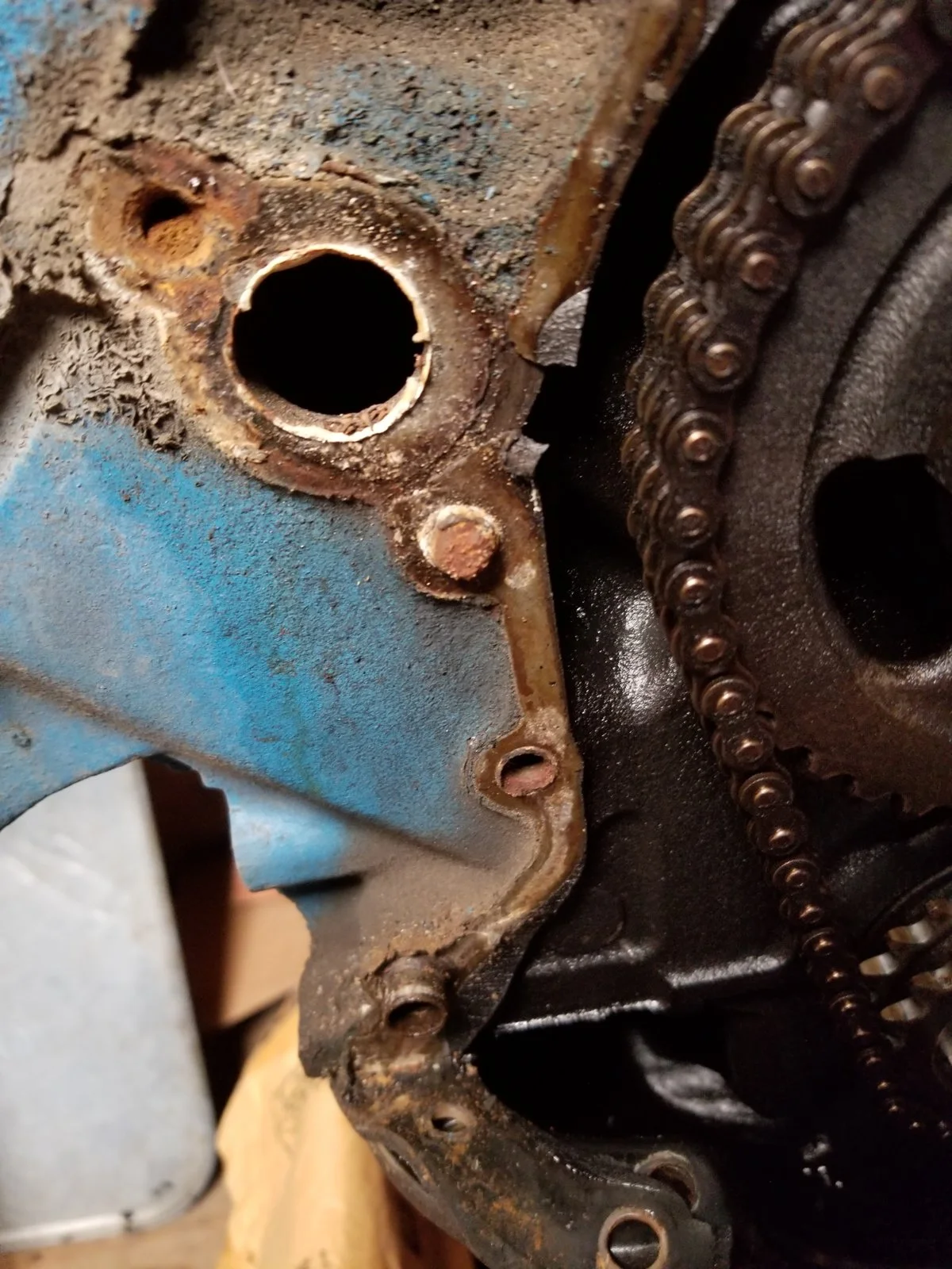

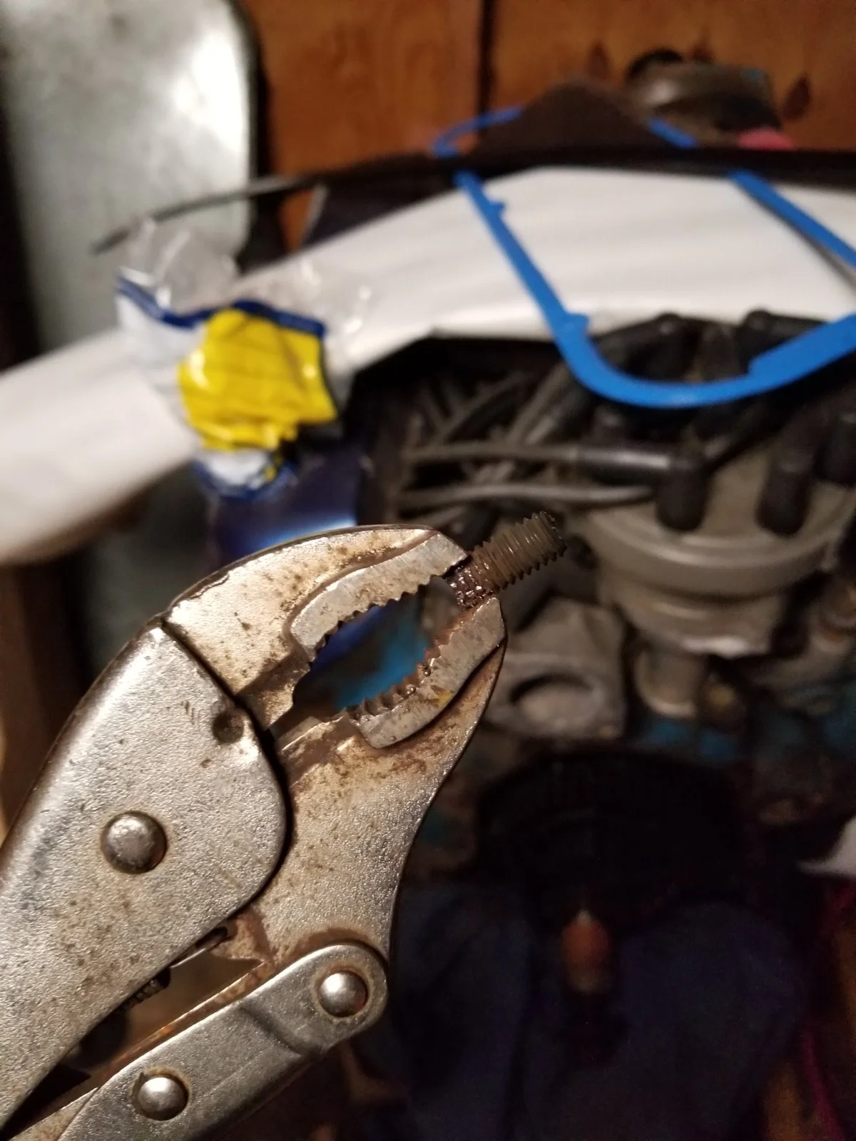

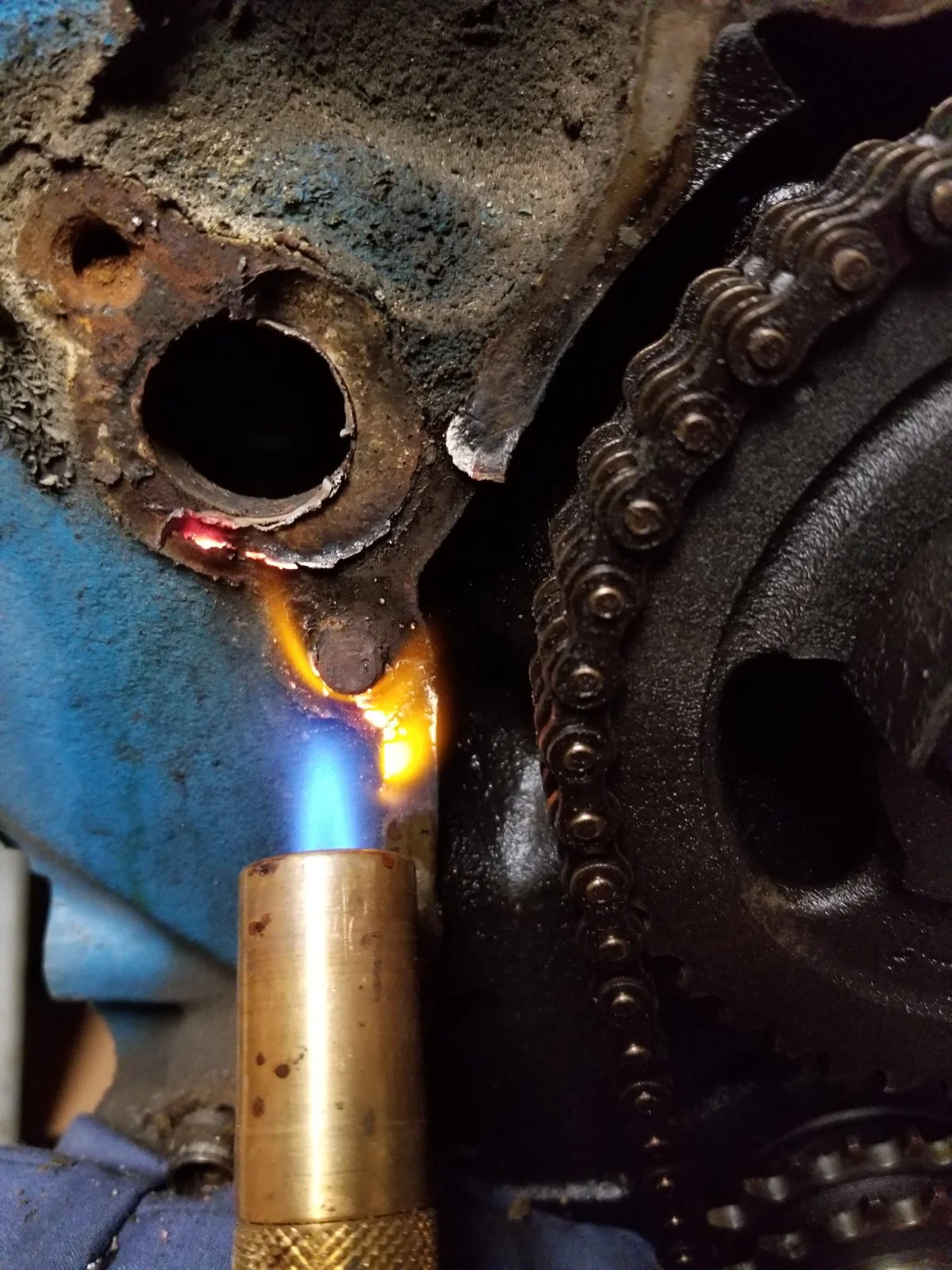

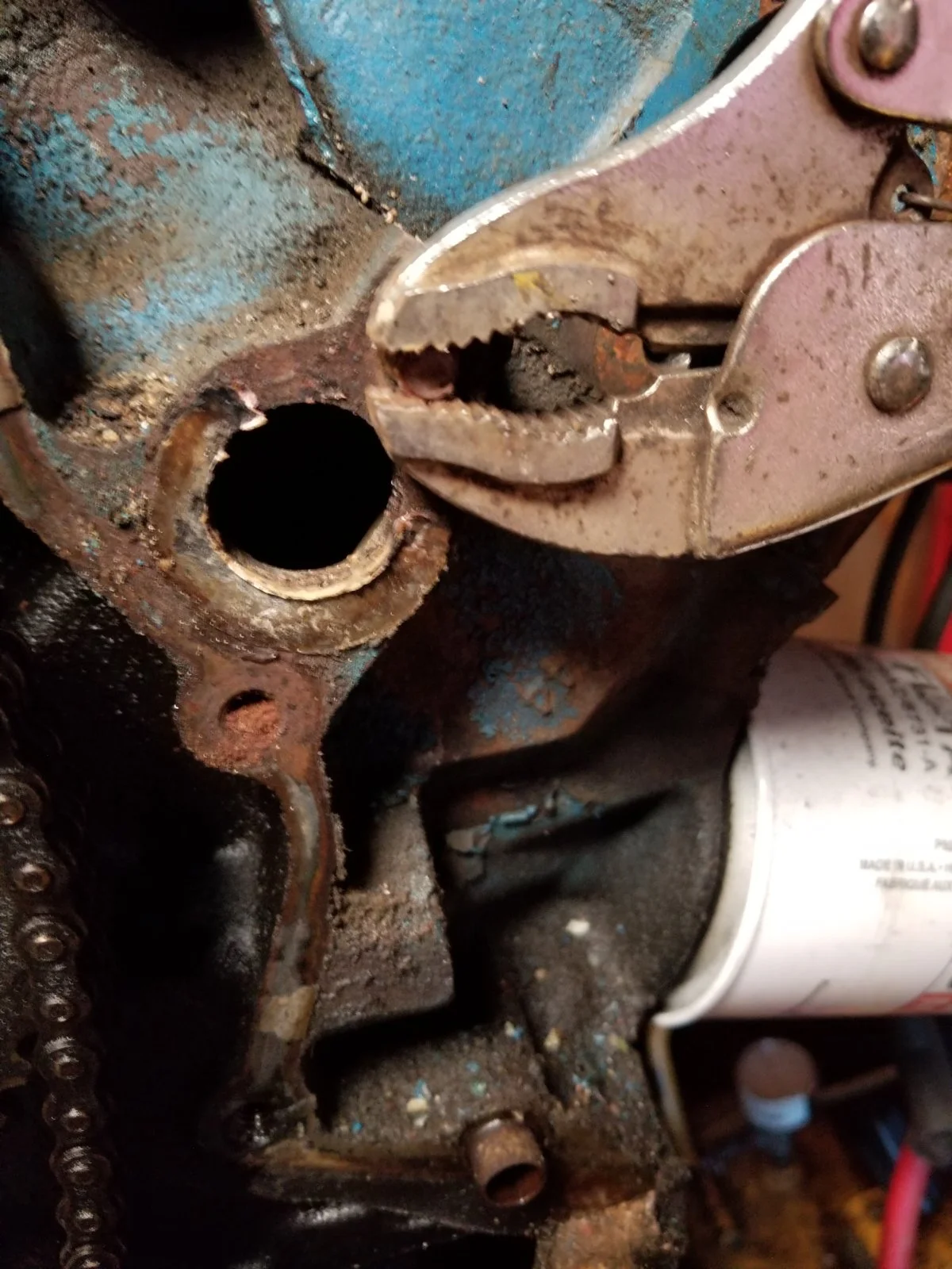

Finally got off my butt and did something I've been putting off for 5 years...
Had a kinda rough day at work.... so i came home and did this....
These are water pump studs that broke off 5 dang years ago. I really procrastinate sometimes. I also hate water pump studs on our engine's.
Somet vice grips....MAP gas....
Haha...I won !!!!
This engine has been installed in two different cars of mine. It never skipped a beat... so I figure its time to get gone through and freshened up.
Reactions: 02 281 GT, Davedacarpainter and RaggedGT

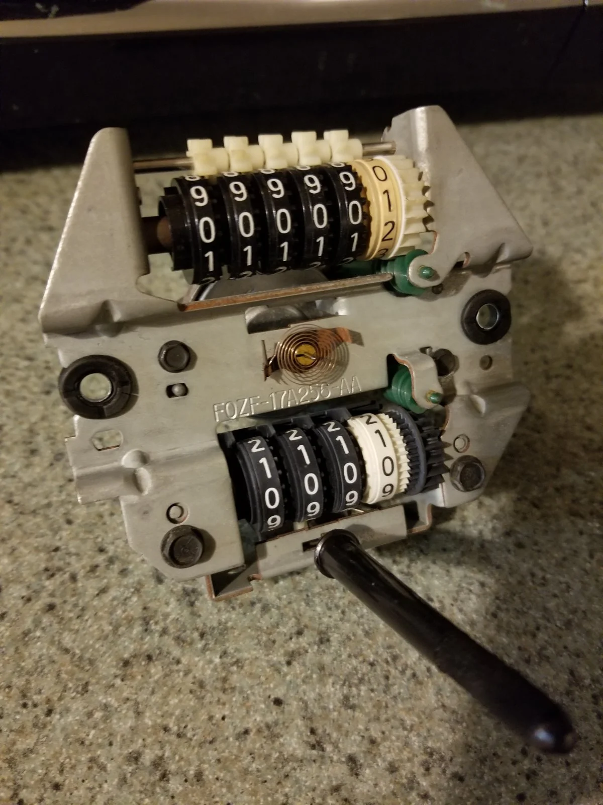

I did something a little illegal....i think... maybe not
Since i put this car together I've wanted a way to track the mileage. Pulling stuff off my parts shelf revealed an old cluster. This was the old cluster from the 4 cylinder set up so i commenced to stripping it down.
All the bulbs out..... slosh module.... gauge needles... stepper motors..... speedometer....hhhmmmmmm.
I pulled that thing apart and the gears of the odometer intrigued me.... so i did what any curious mechanic dude would do....
Now, as soon as the tags get put on Dusty, the clock starts at 0....
I did learn how to set the mileage to any amount.

Not as long as you declare odometer change/discrepancy if/when you sell it,

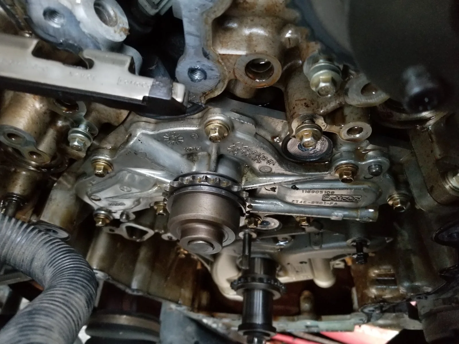

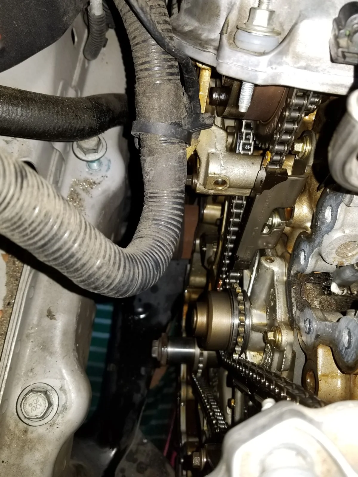

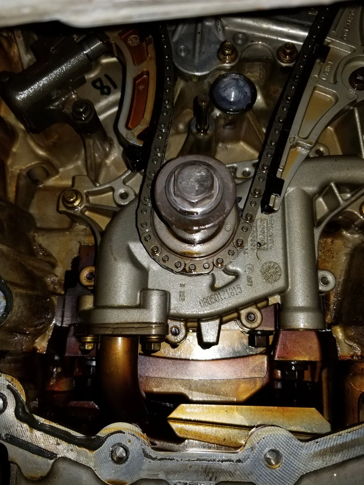

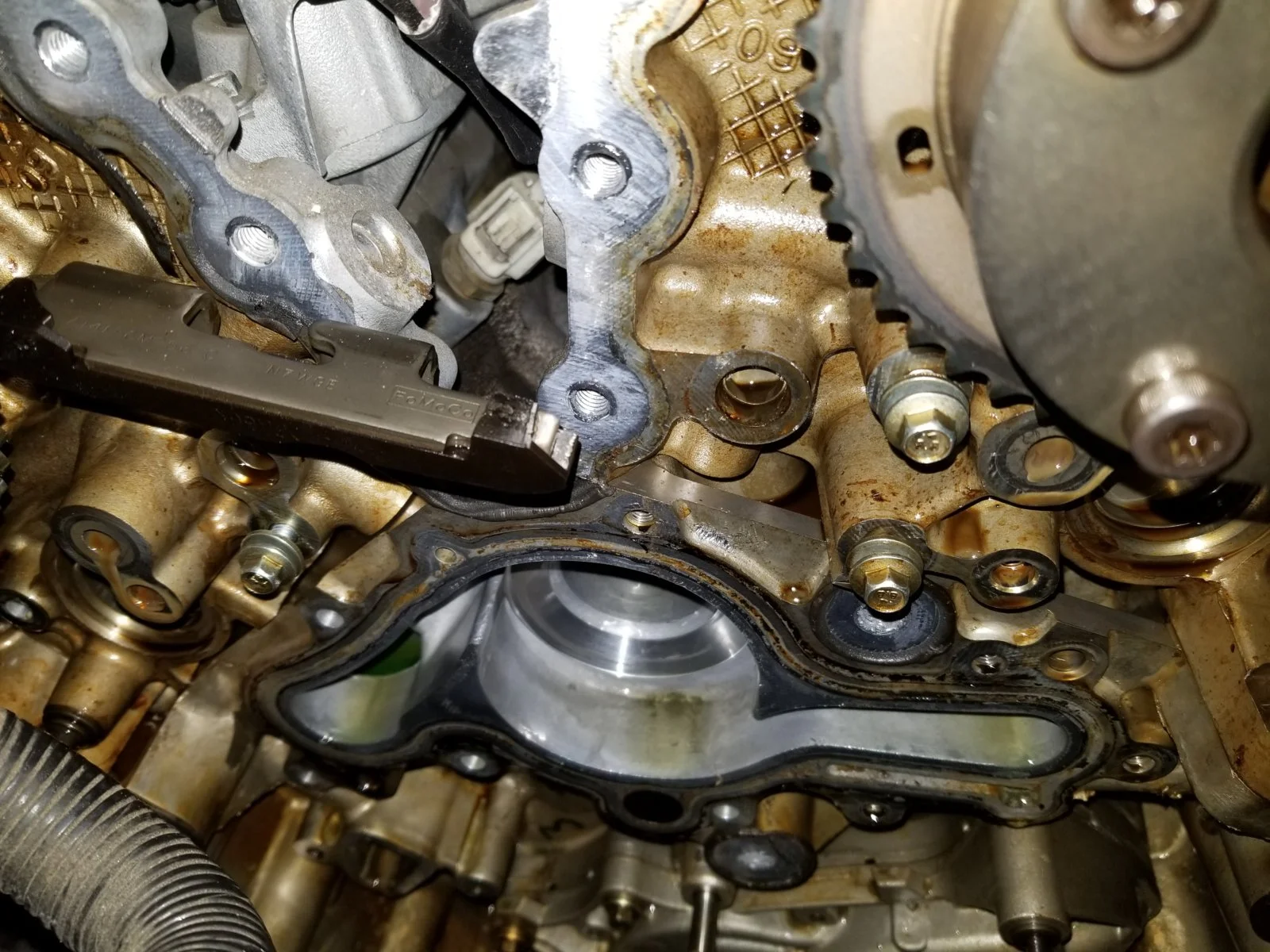

If anyone's wondering what I've been up to....
All of this just to get to the water pump. That thinv is buried behind the chains. Had to buy a special tool to take off the balancer....and one to hold the camshafts. PITA

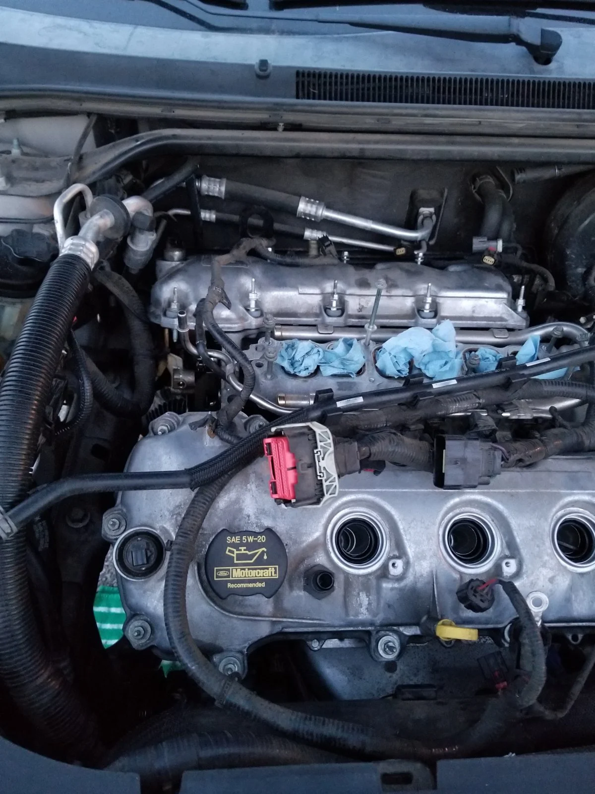

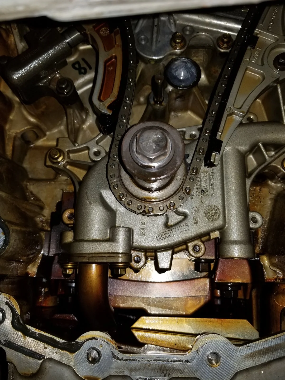

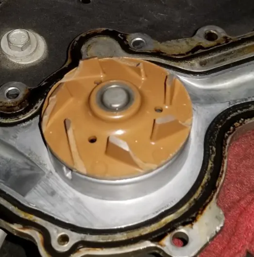

These 3.5L engines suck....
Ive been working on the Taurus ( Gizmo ) for a while. Ive been busy as hell. We're moving to outside of Fredericksburg, VA. Lots and lots going on.
Finally, this thing is taking up my mustang time.... and moolah...

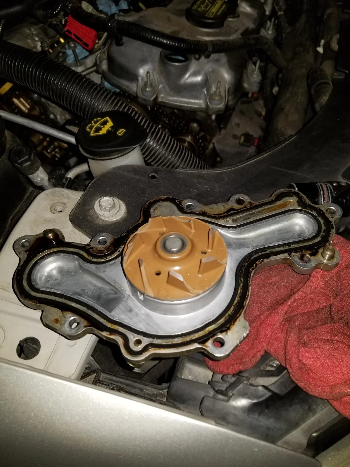

This pump was almost completely locked up. Theres something weird going on.....does anyone see it....?

Looks like you are missing some pieces on the upside-did you finally find/buy a new house ?
I dont want to jinx anything..... the house search has been a nightmare. I'll post when we move in.
Those little plastic pieces are in the engine somewhere. Guess I'll have to pull the thermostat housing, too.
The saga continues. Ive got to get everything moved by the 23rd....including my man chapel...the huge shed i built.

I might be asking myself [why] those teeth went.
Did your coolant freeze at some point perhaps?
