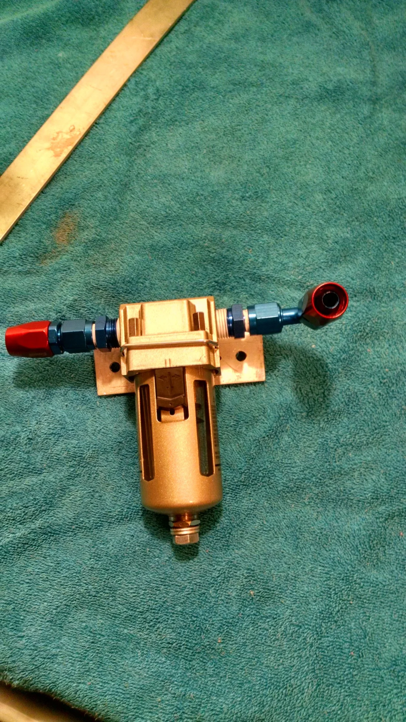

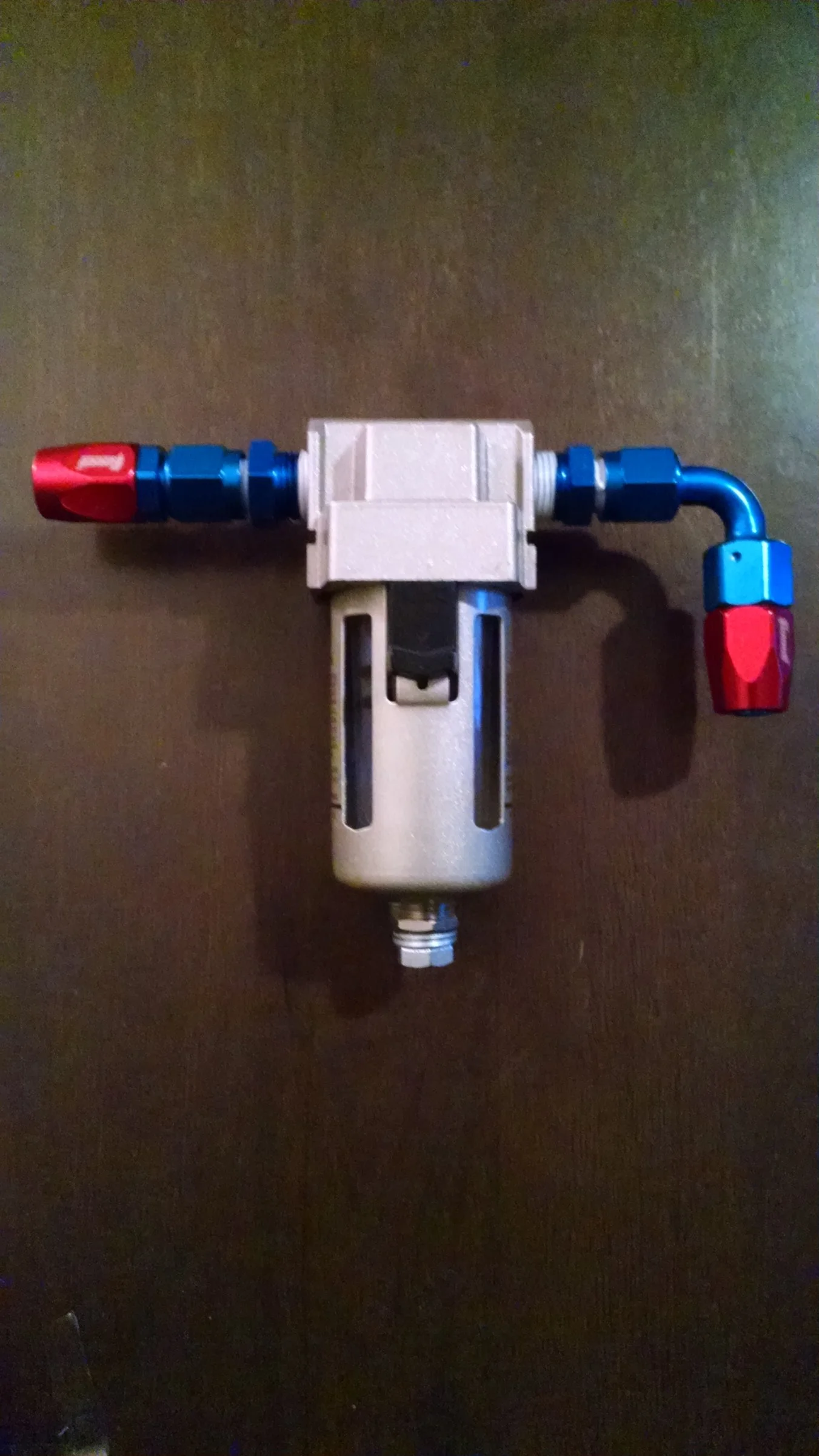

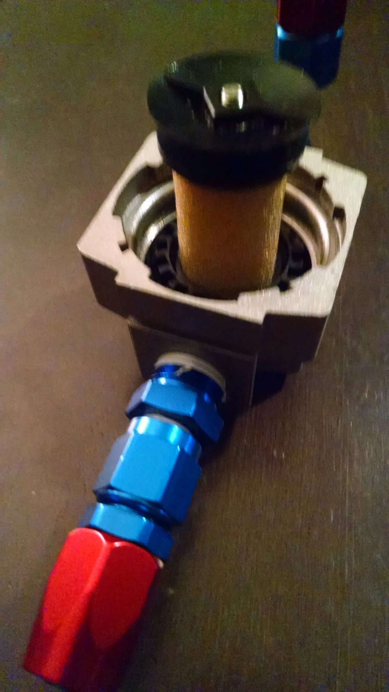

My little oil separator is coming together.
I went to Lowes and bought a bunch of dang brass fittings ( to the tune of 18 bucks )...only to find out I had AN fittings that I got in a CL purchase....
Here's the inside filter....I'll be adding some steel abrasive later.

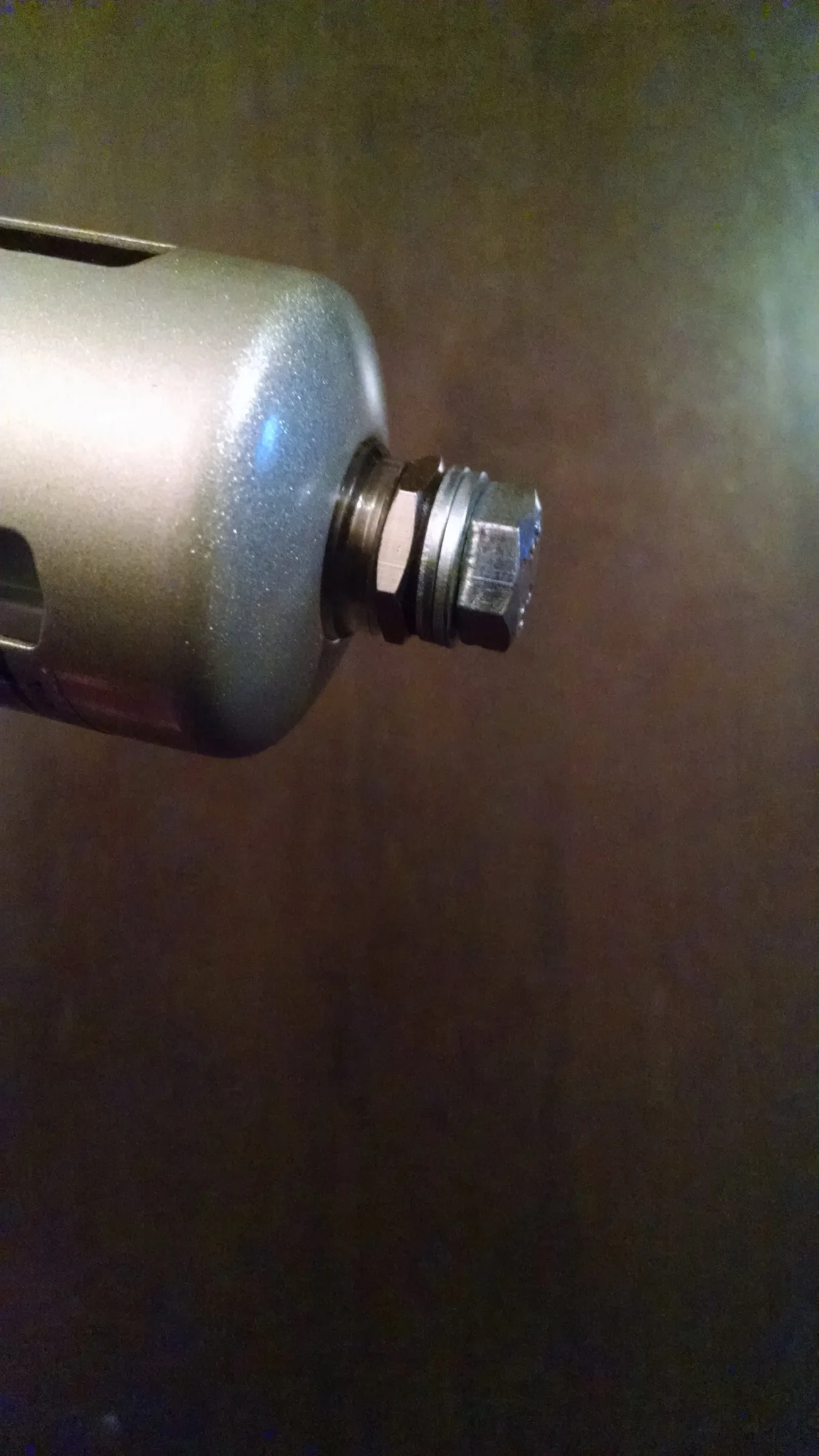

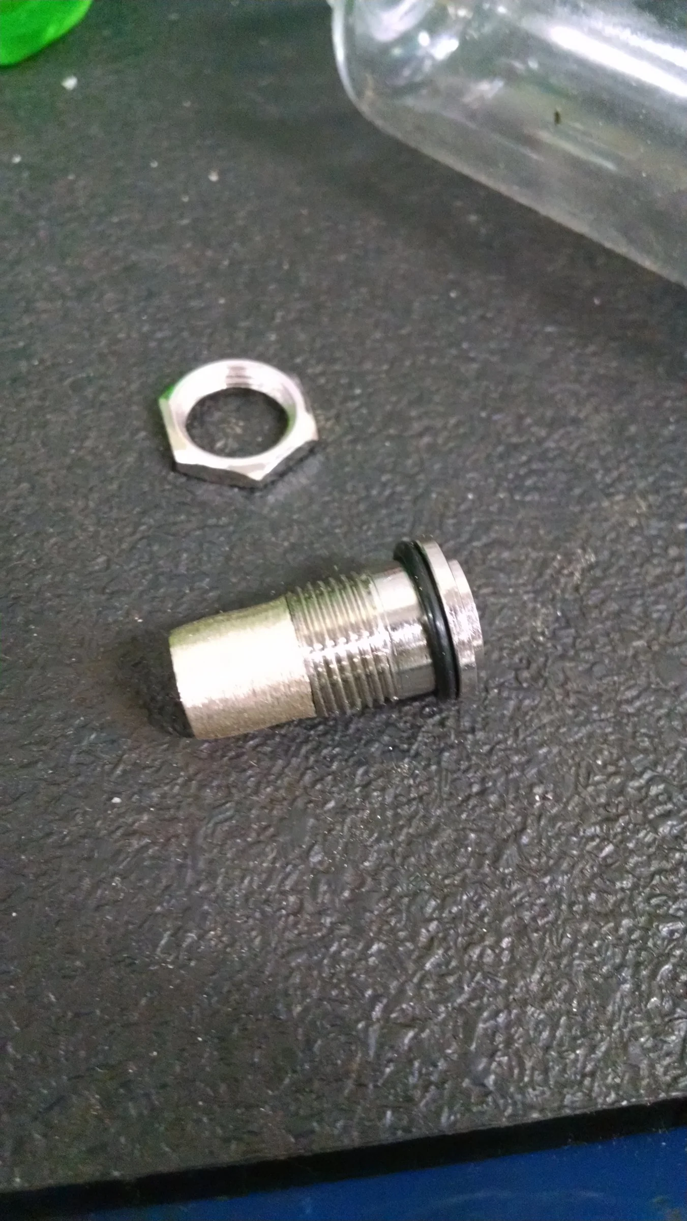

The little valve on the bottom was spring loaded and wouldn't work. Some quick work with a grinder to take the bottom off...and M8 x 20 tap and its good to go.

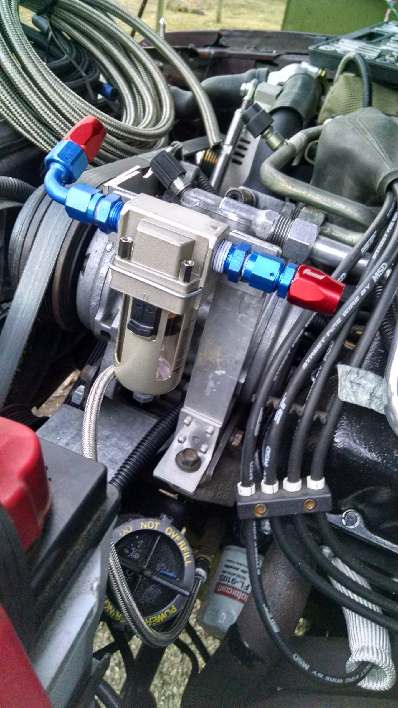

Here the almost finished product. I still need to make an aluminum bracket and figure out whether I'm going to use steel braided or black nylon braided hose.

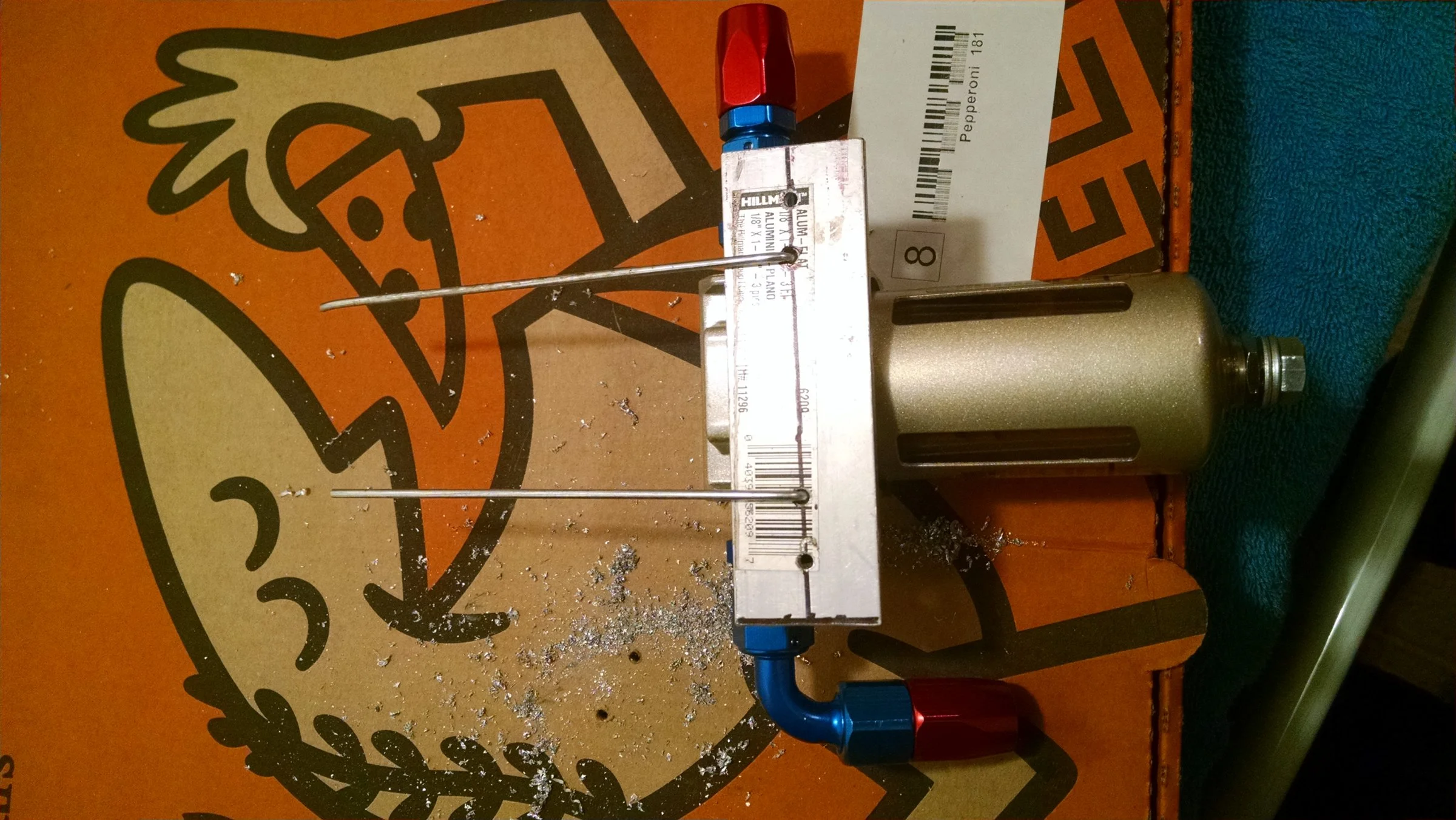

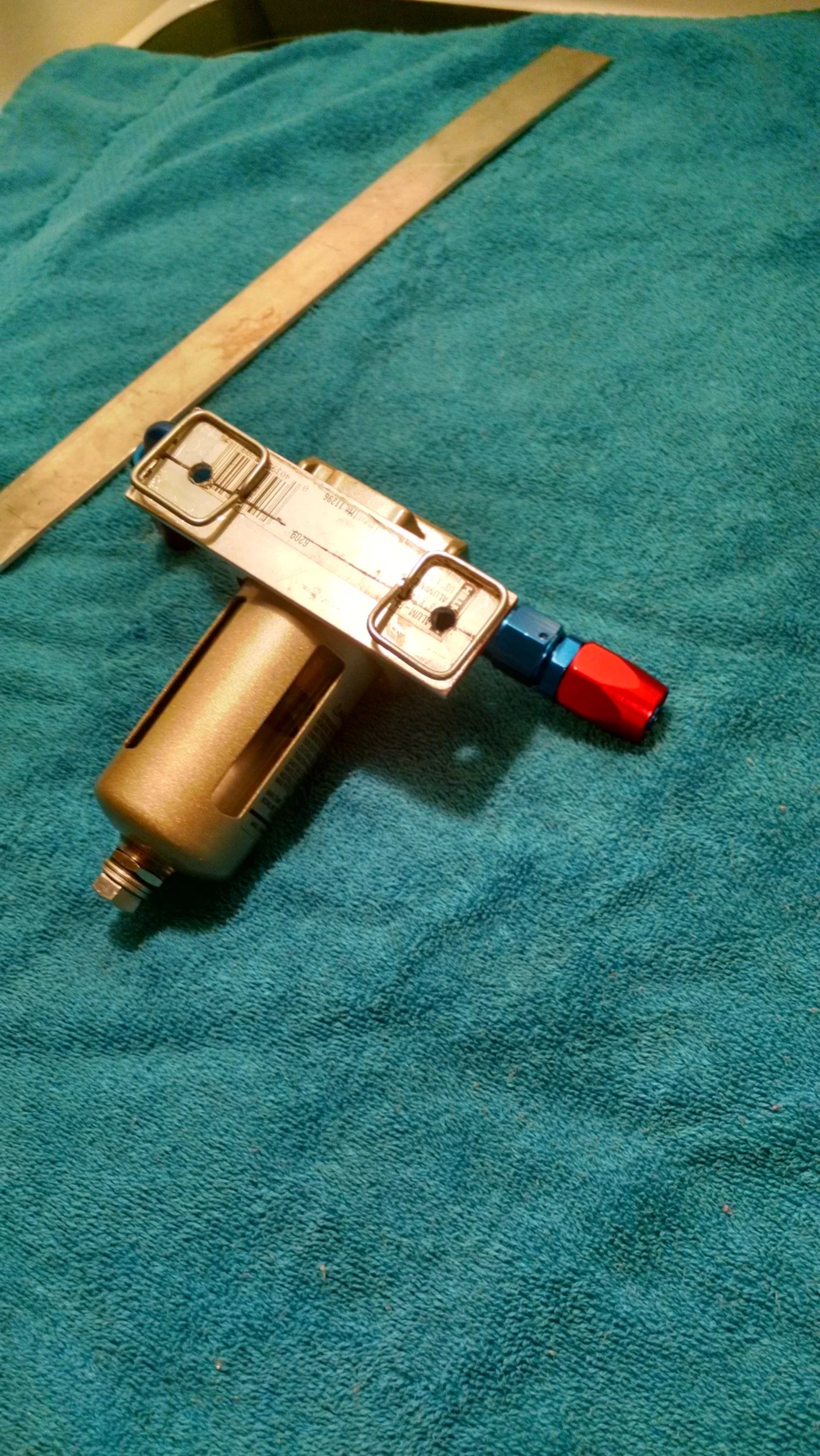

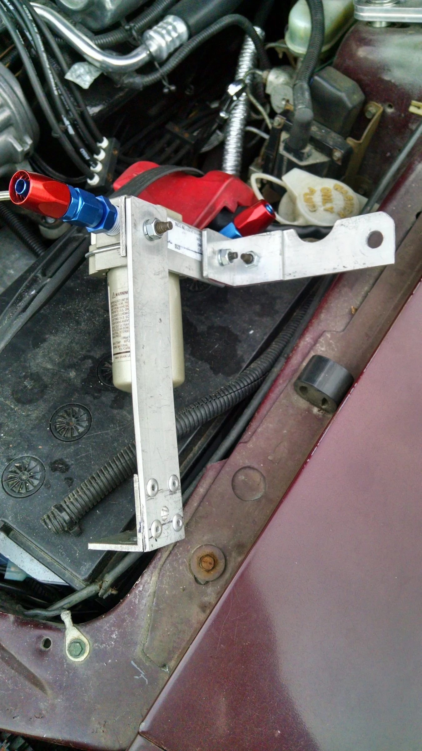

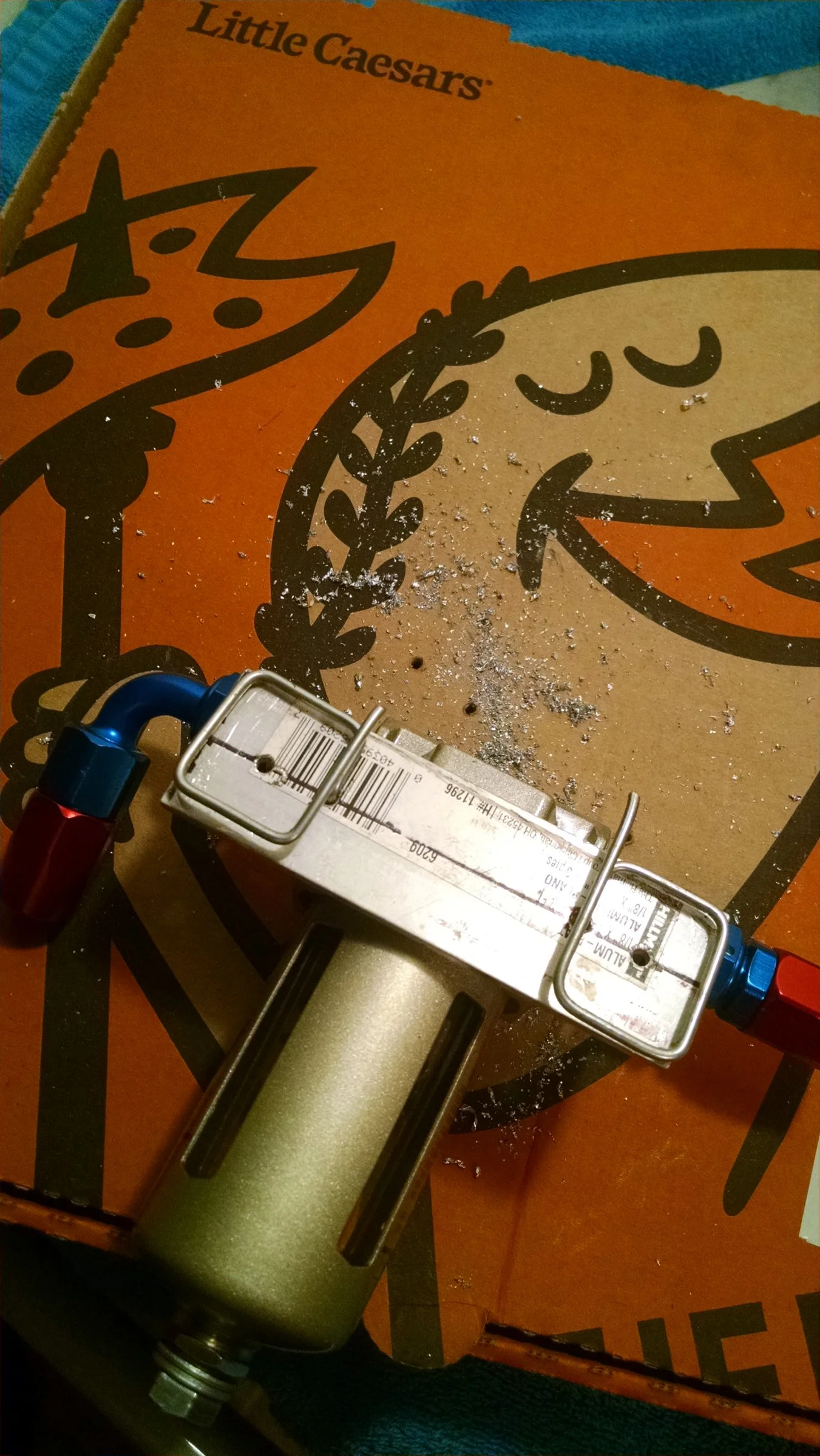

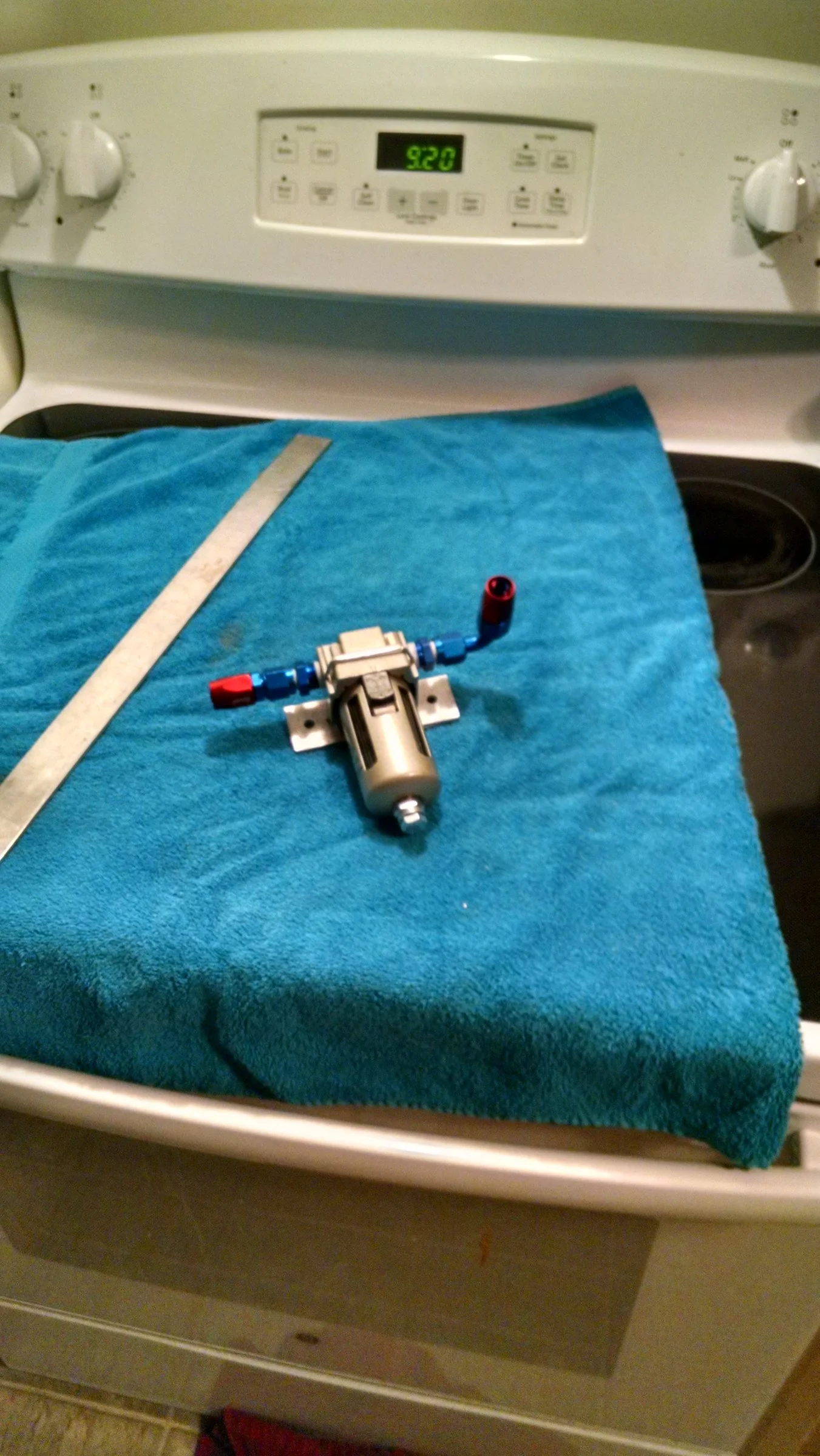

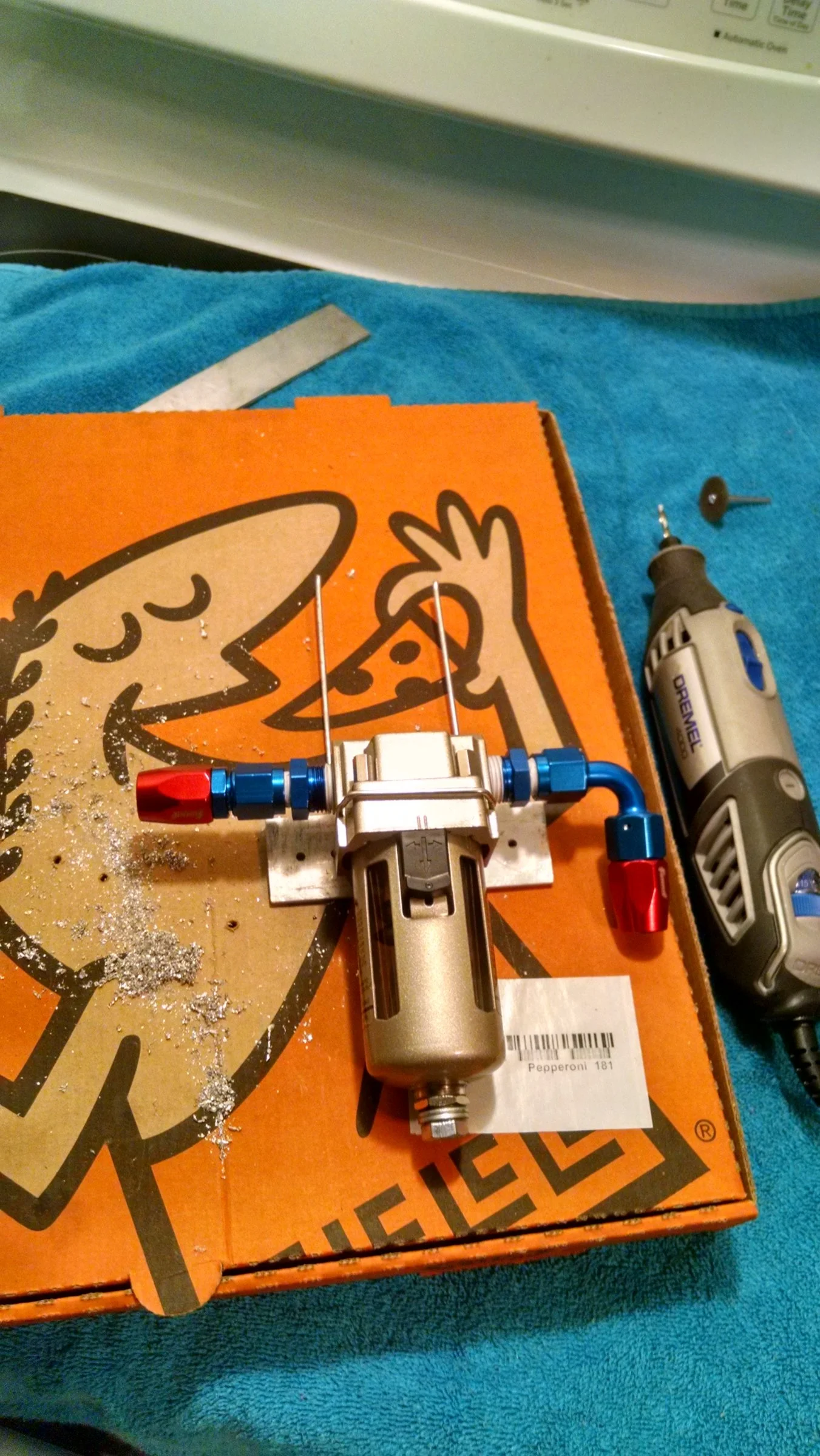

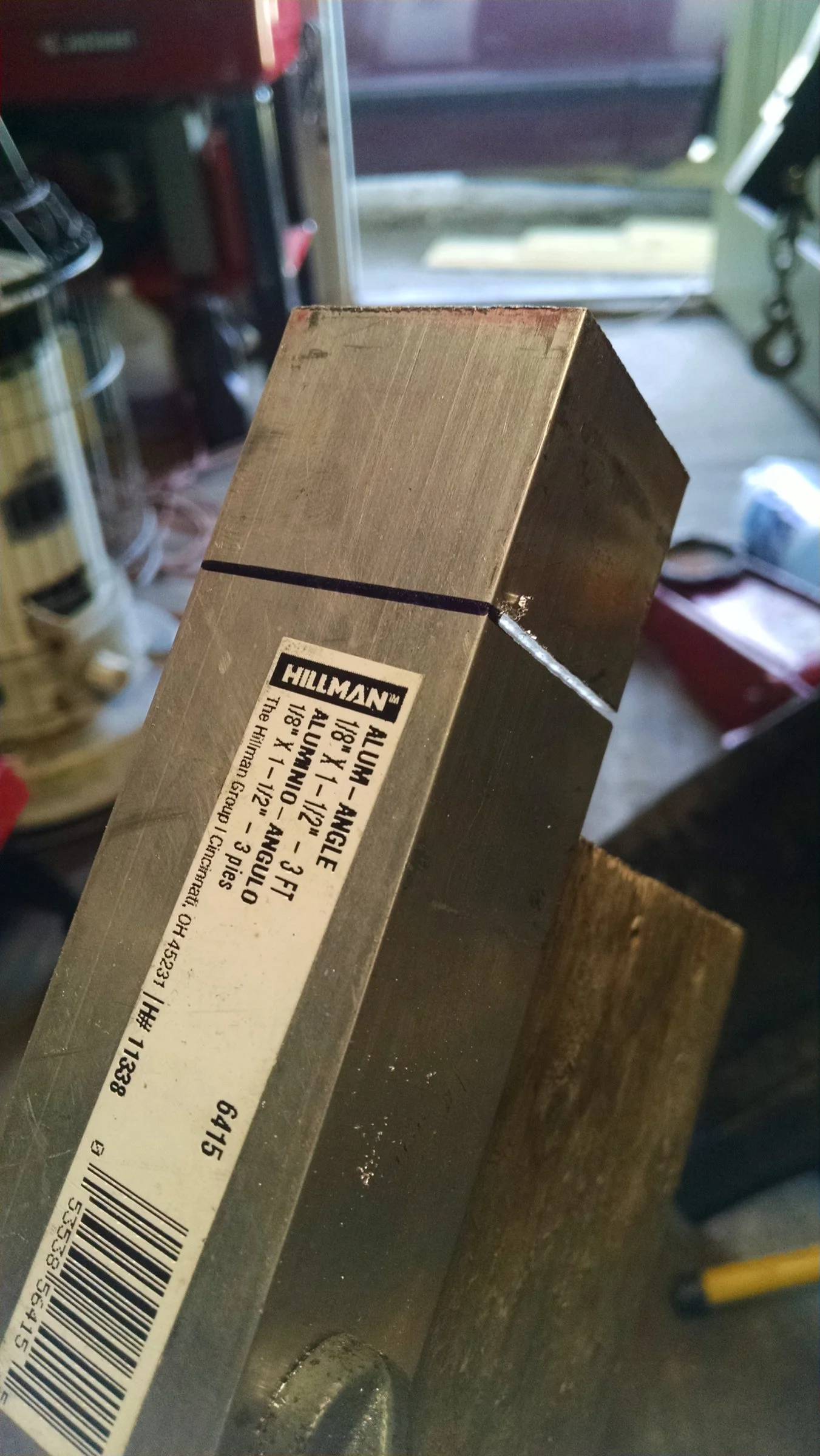

This is the process with my latest mini project.... I made a bracket for my PCV oil separator. I used a hanger and a piece of aluminum I had laying around. I should have polished it before putting the wire through it...but....it'll work.
...and guess where I did all this....
....all done on the stove in the kitchen...with the wife watching. She's got her eyes on that red GT so I'm getting away with murder right now. :rock:

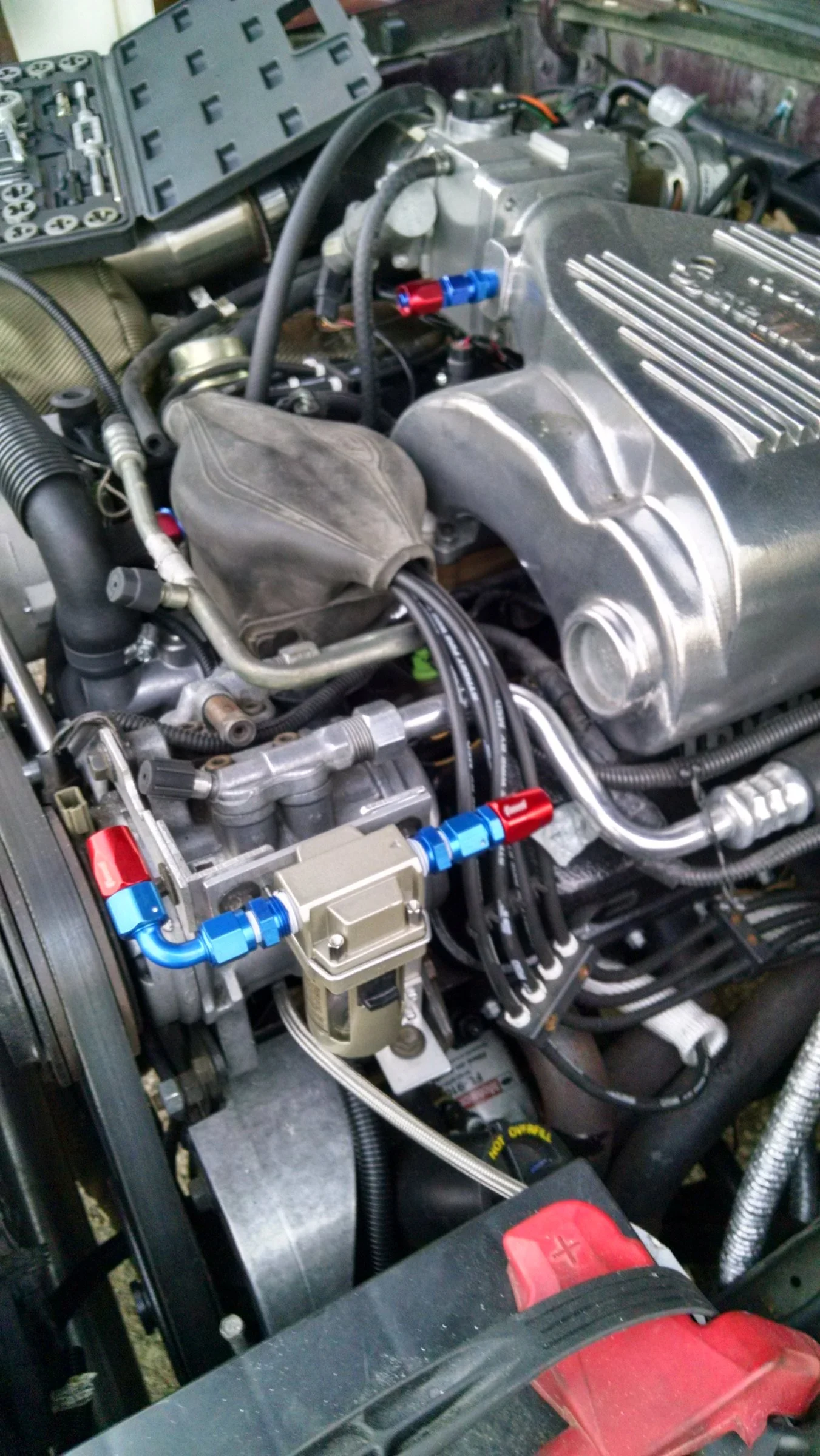

So I gotta ask then...You're gonna rely on a air/water separator for a high pressure/low volume compressed air compressor setup to act as a vent for your engine? Can you blow through this thing w/o feeling any restriction?
That looks to be what?...... A -8 inlet? Doesn't the internal restriction drop that down to 3/8"?
I've got a big breather tank already. It's plumbed off the valve cover with 5/8 hoses... 10 AN and vented to atmosphere.
The catch can is 6AN and the same size as the hose running off the top of the PCV valve...3/8.
I'll be using a vibrant check valve ( not ordered yet ).
OK then, you are gonna run out of the catch can, into that -6 line water/oil trap, through the check valve, and then back to the valve cover?
Its going to run from the pcv valve in the back of the lower intake in to the catch can, through the check valve and into the intake. Its been shown to help.
Its a lot better than running a booster check valve in the factory hose.

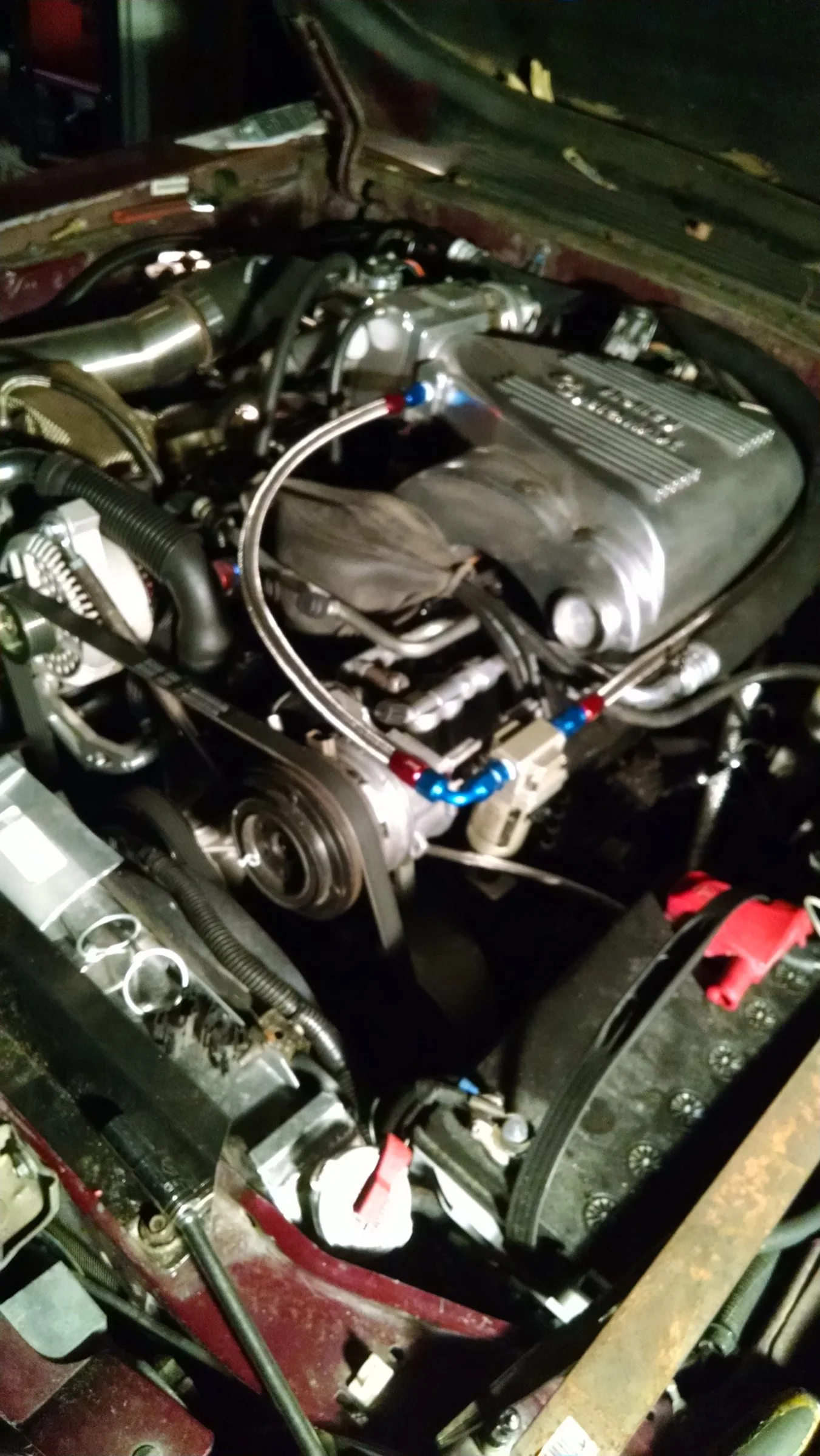

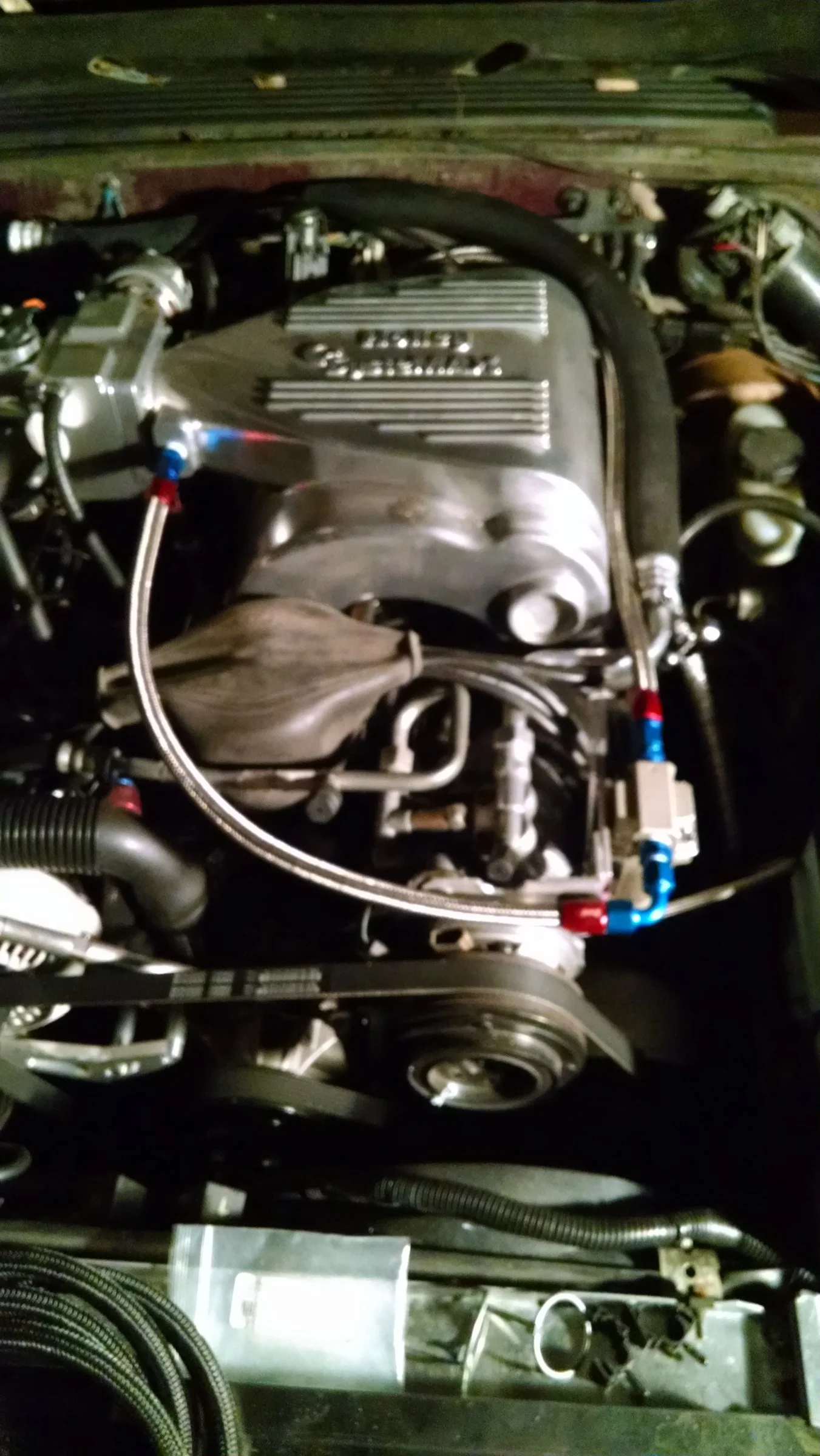

Just to note.. .
The summit fittings were a breeze to deal with with the stainless braided lines. I've never put lines together so easy in my life. The one Russell fitting, by the intake end, was tough as hell.
I've learned to lubricate the threads on the part that threads inside the hose. A Dremel with a cut off wheel does wonders on the braided hose. A tight wrap of electrical tape on the fitting and a pair of decent adjustable wrenches work wonders without marring the fittings....unless its a dang tight AF fitting...I got the corner a little bit.
