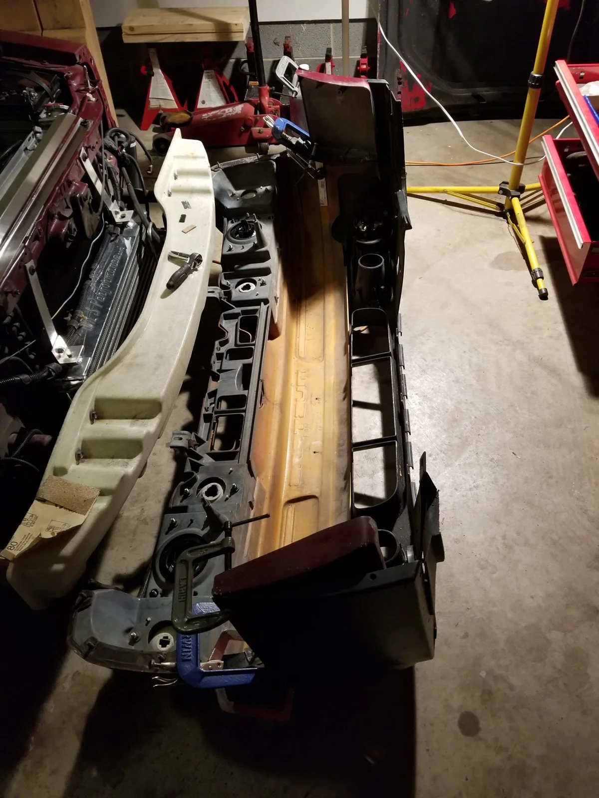

I kinda like this garage thing.

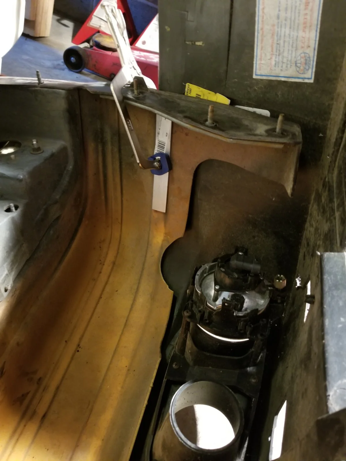

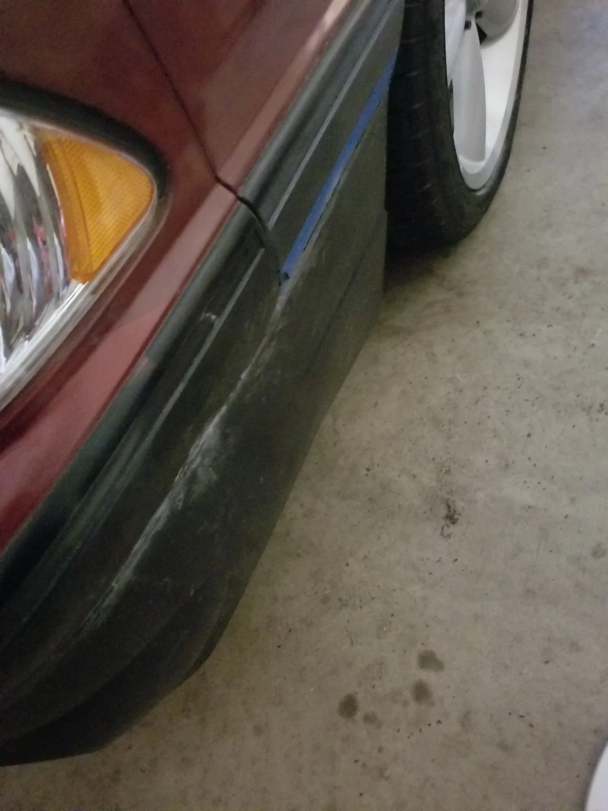

Finally, got some more 3m 8115 on the front bumper. Added metal supports to table the bulge out of the side.... and glued the spats to the lower.
Guess we'll see how it turns out...

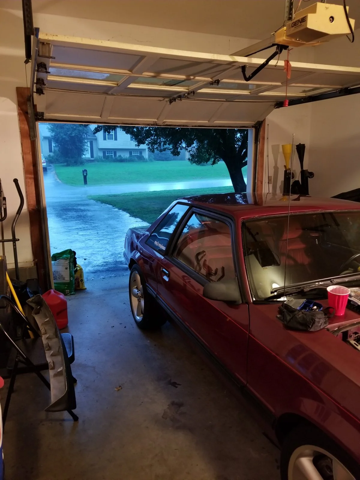

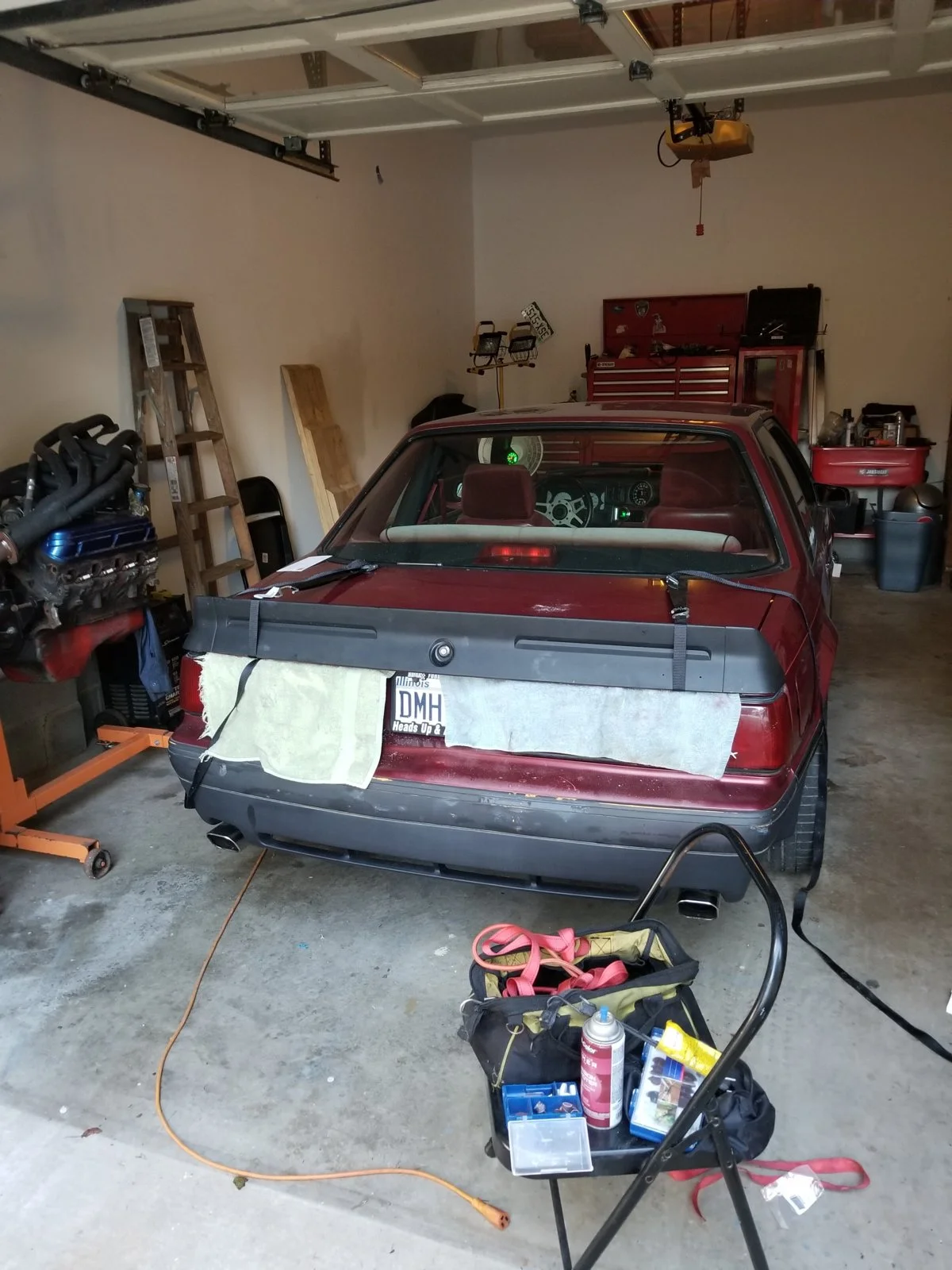

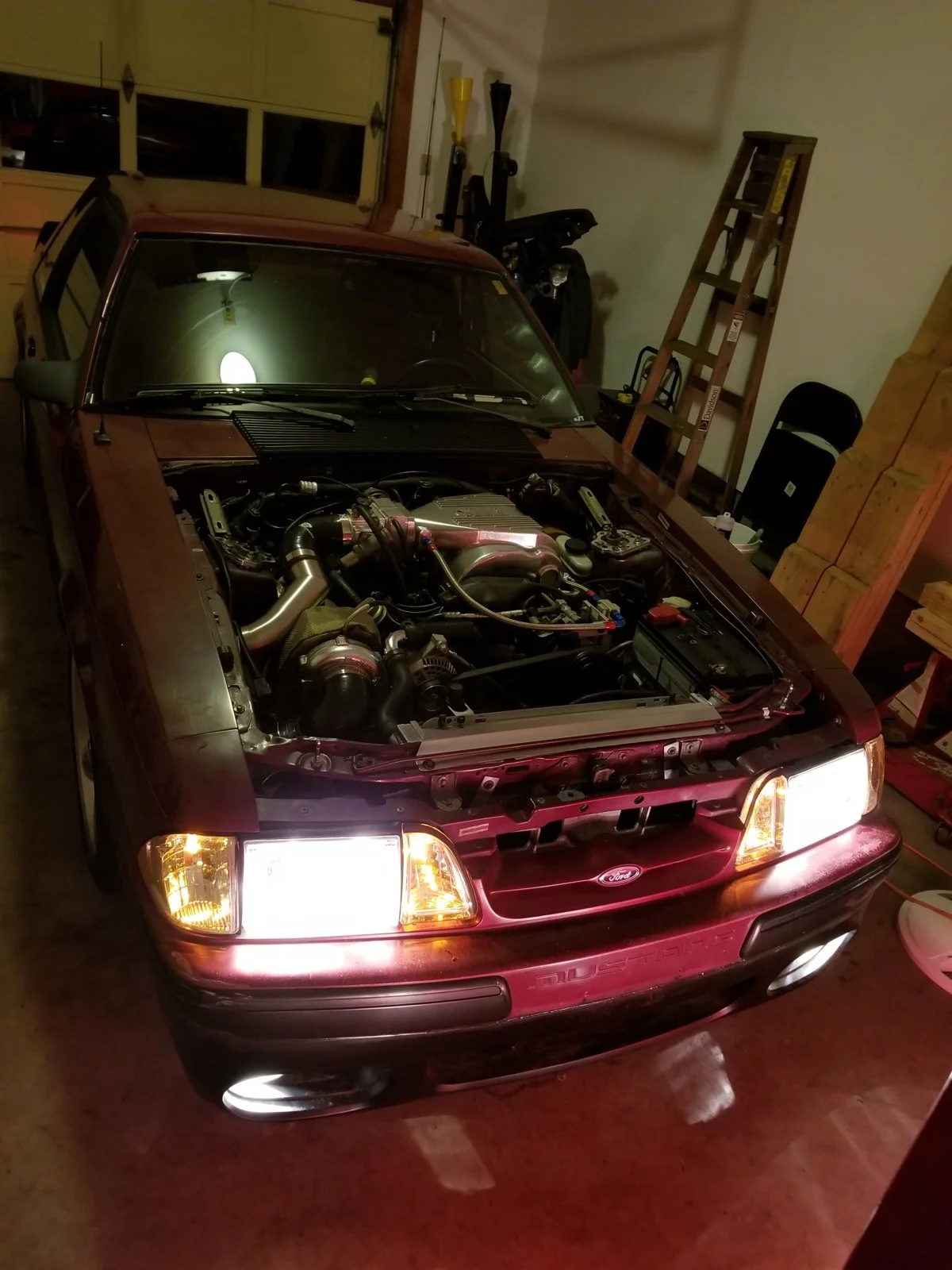

Man it's nice to have a garage. Got all the yard work done and this happened...this pic is at 3pm

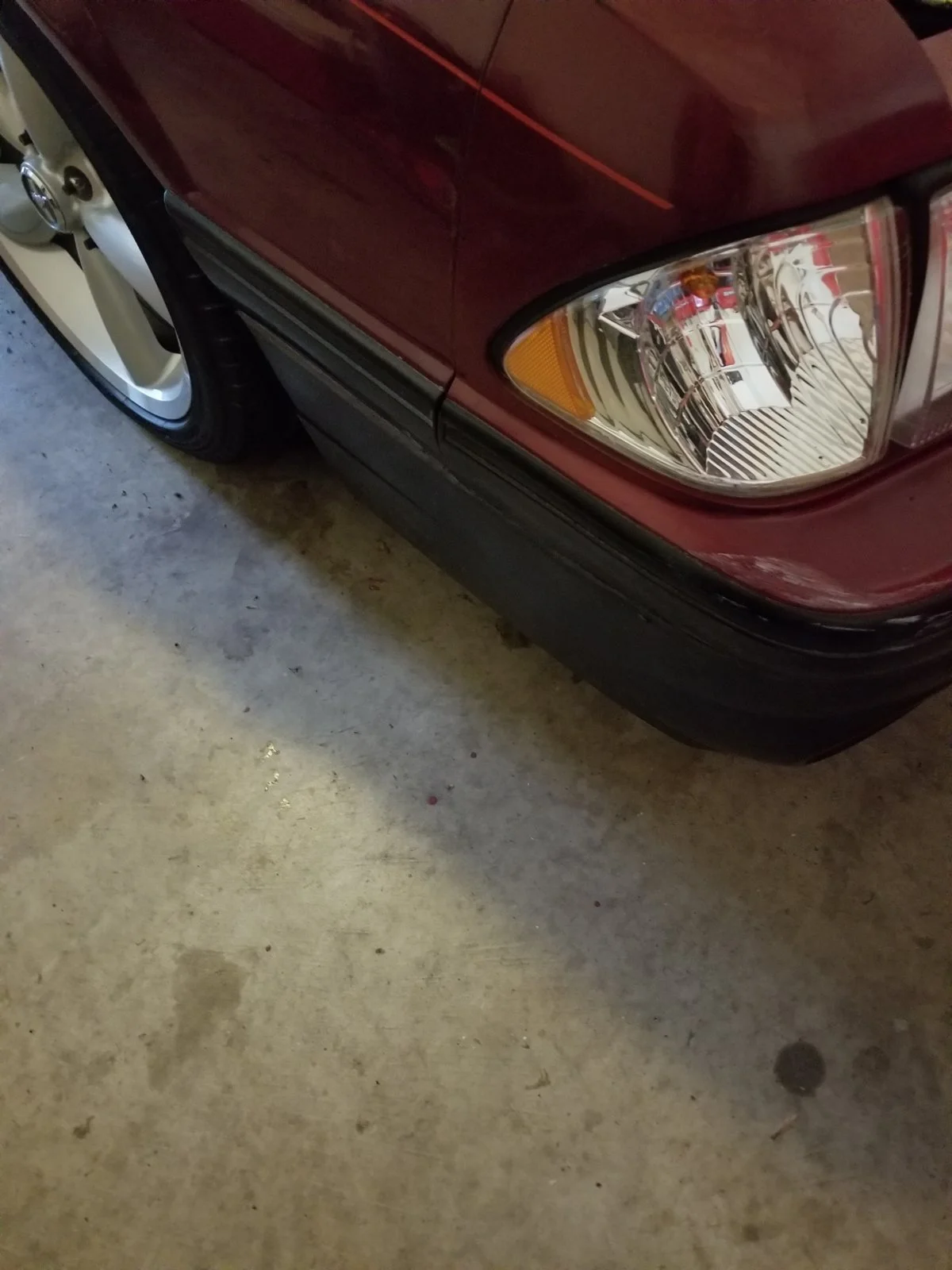

...so....I put on the front end....no more bulge
...even managed to get the surface rust at the trunk lock sanded and painted to match the wing.
Pretty productive so far. If it wasn't for you guys I'd be no where near done. The car would probably been someone else's " new bought " project car. Thanks for keeping me motivated

Very nice! We sure could use some rain out here.

I love being in the garage while its raining outside, unless I am working on the end of the car closest to the door, lol.

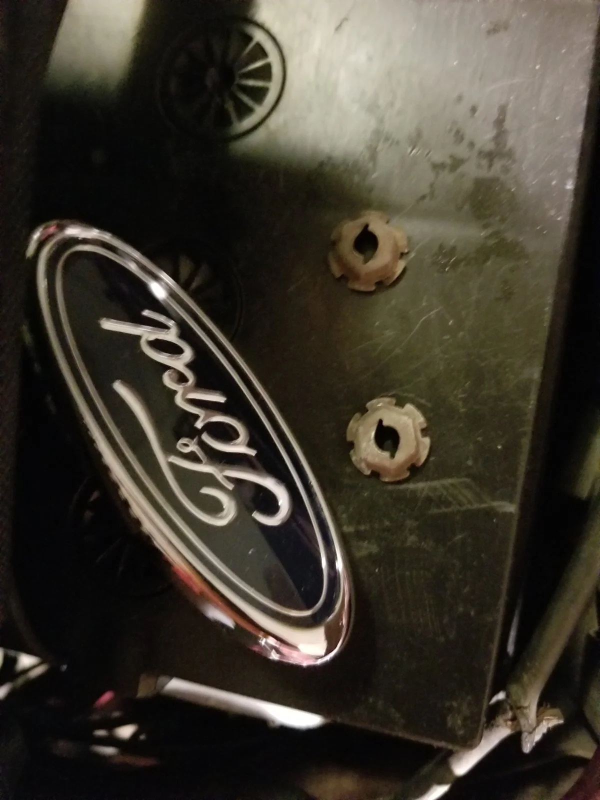

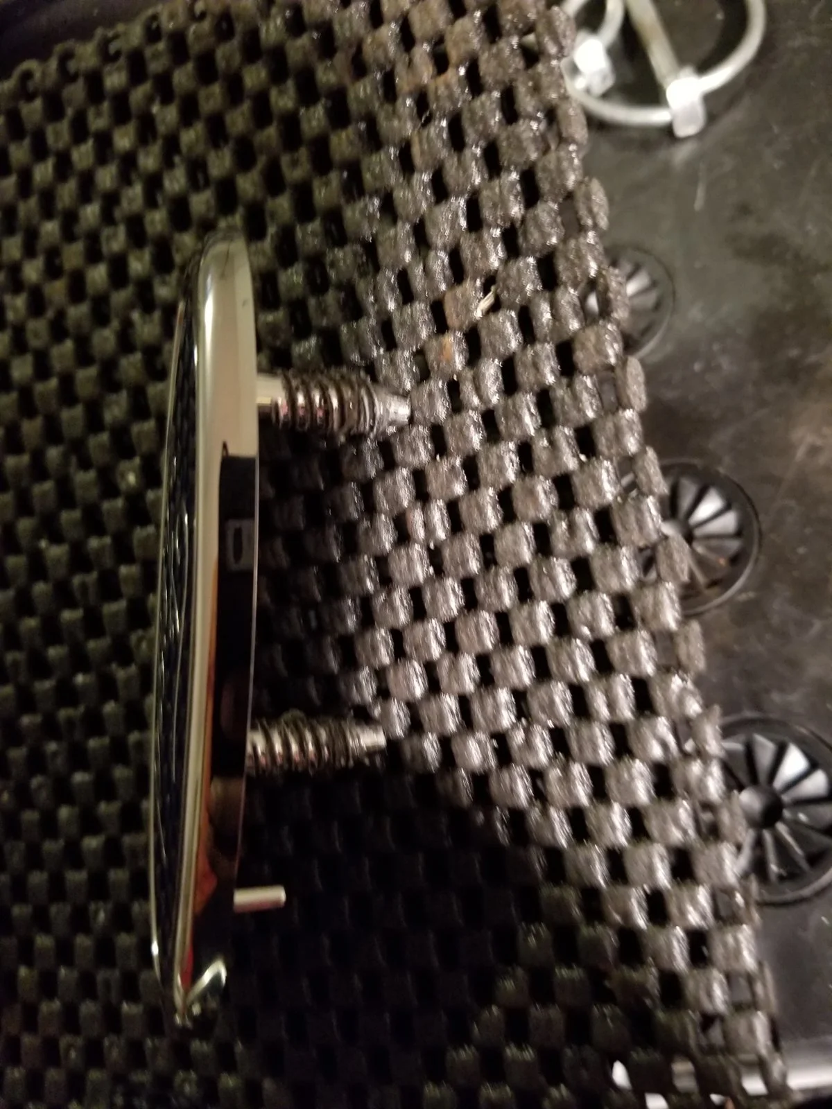

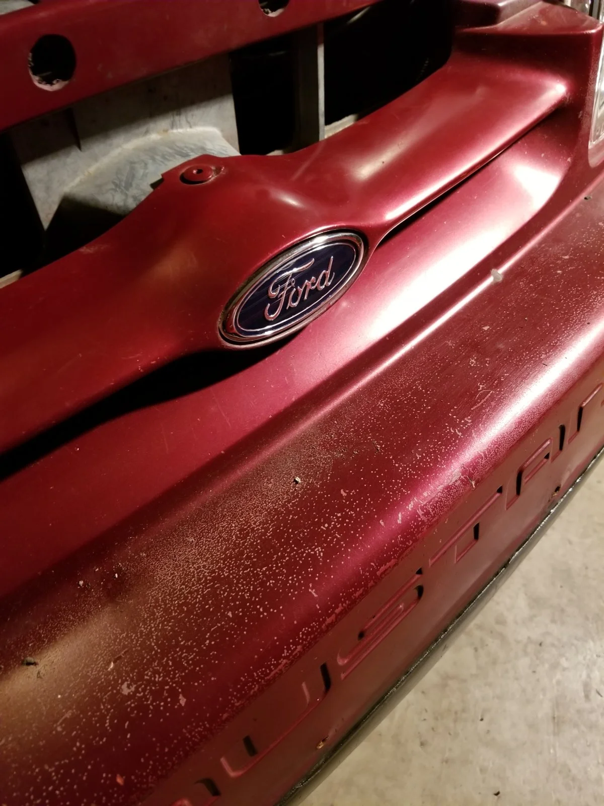

This thing kicked my rear.... something so simple... that I could've done 100 times when the bumper was off. The front emblem is held on by two 10mm speed nuts. There was no way I could get my socket on the passenger side speed nut. I tried everything....1/4 regular short extension, swivel extension and deep socket, swivel extension and short socket, extension and swivel socket.... got dang that thing was a pain in the gazoo.
Finally, I broke the old emblem off and fetched, the now broken, old studs off the garage floor. Held them with a pair of pliers and removed the speed nuts....
That's with the new emblem. The old one came off in a bunch of pieces.
I ran the nuts on the new emblem first so it would be easier to get them started
....I then fought this thing for an hour.... but this is the result. The best looking thing on my car.
Now I'm going the hell to bed.... kids got school in the morning.

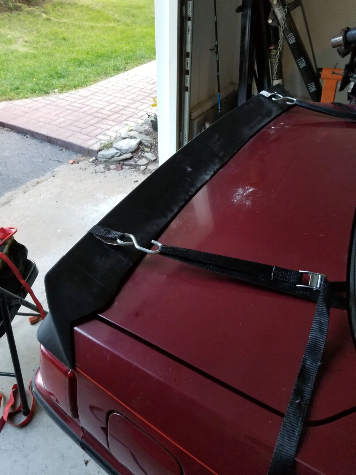

The wing is finally getting installed.... and door speakers.
Took a while to figure out how I was going to add pressure to the process. A few days of 8115....well a bunch on the mounting surfaces. It'll hold...that stuff is amazing.
Thanks, Dave, for leading me to this stuff.

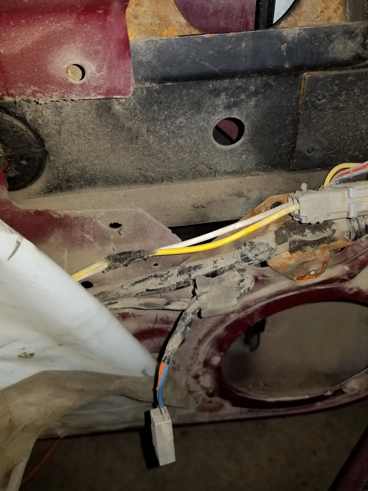

The door speaker thing didn't go so smooth. My car doesn't have the dash portion of the harness so I had to tap into the 3.5 speaker wiring and run it down to the door harness plugs by the kick panel.

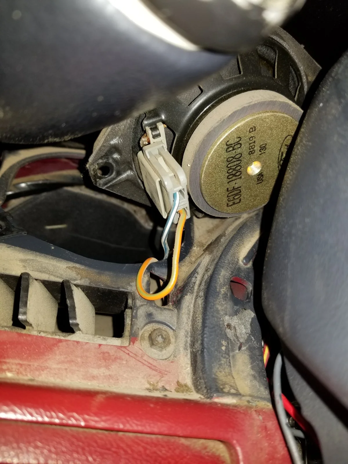

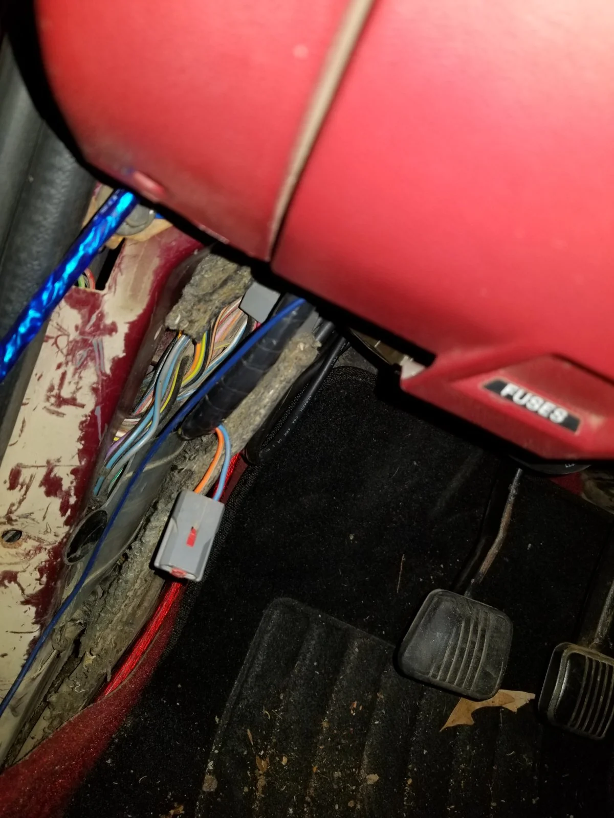

This is why I call Dusty....Dusty.
These are the driver's door speaker wires. Here are the wires under the corner of the dash by the kick panel.
Now, to my drivers side 3.5 speaker. I had to loosen my 3 gauge pillar and the cluster surround to get the grille off. You'll notice the same colors on the wires. Tomorrow I'll actually install the speaker....this is all for tonite.

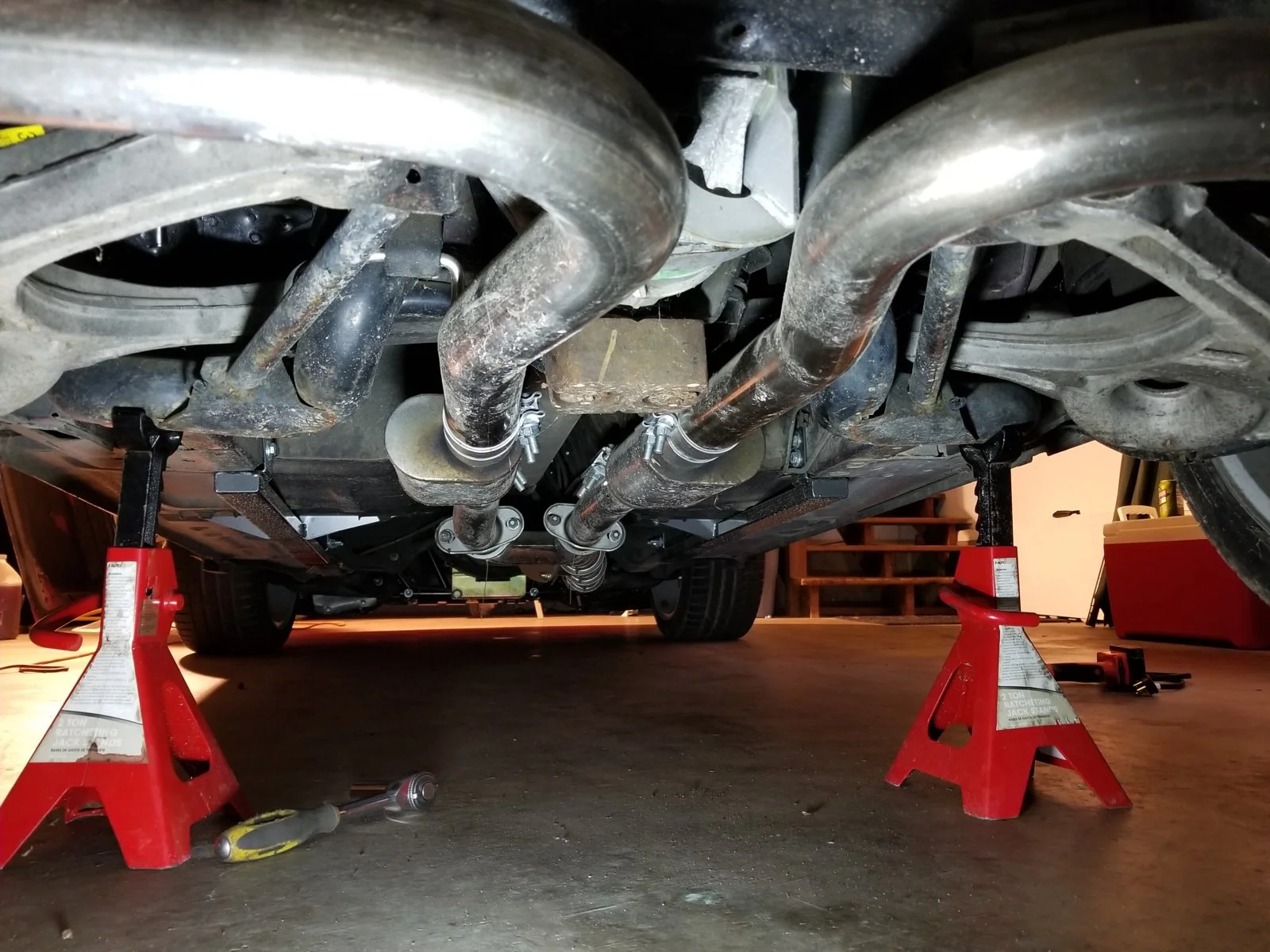

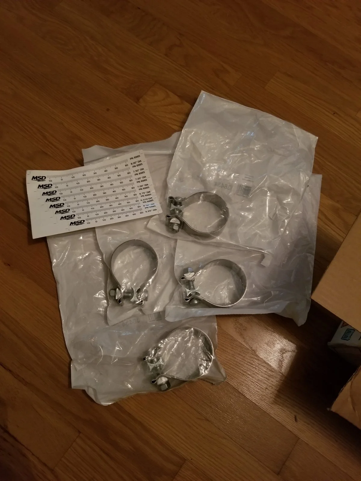

Got some small stuff in the mail. Previously, I used masking tape and transferred my timing marks to my crank pulley. It works but I need something a bit more legible.
The exhaust also has never been completed. The pipes are just slid together. I finally ordered clamps and can button up that part of this project.

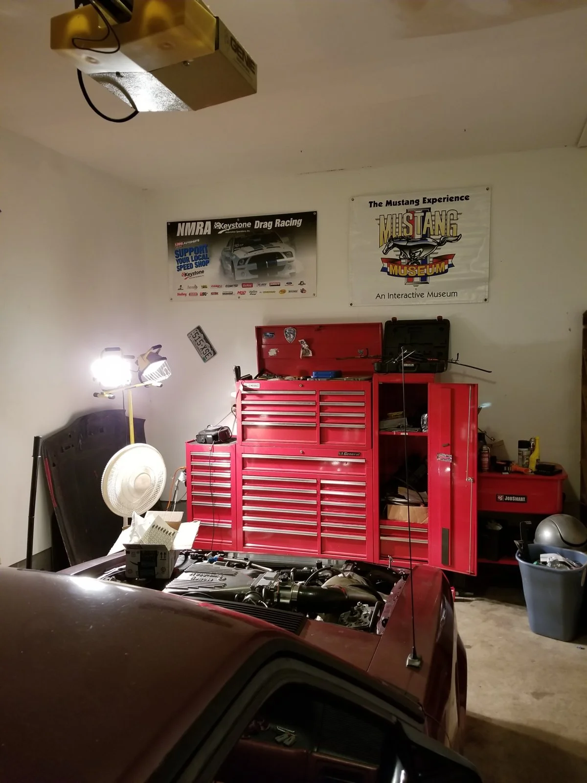

I went out in the garage with big plans.... all I accomplished was this....
Got two of my banners up. That's it and that's all for yesterday.
