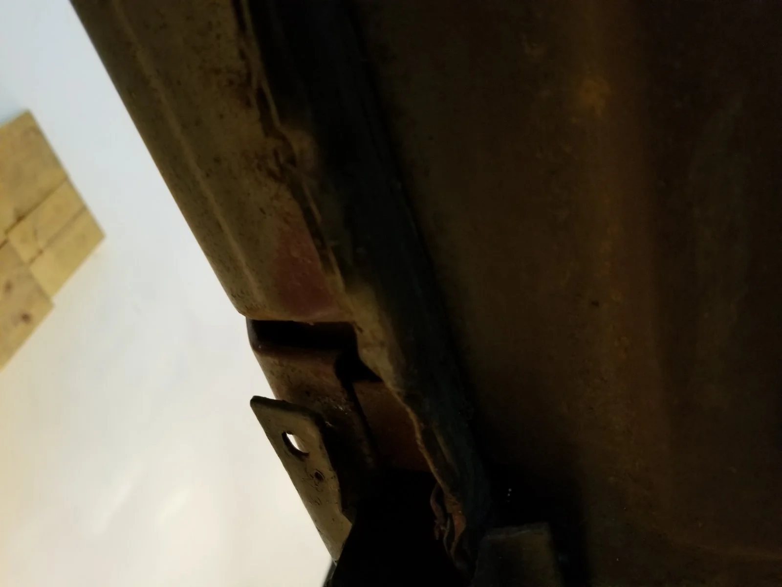

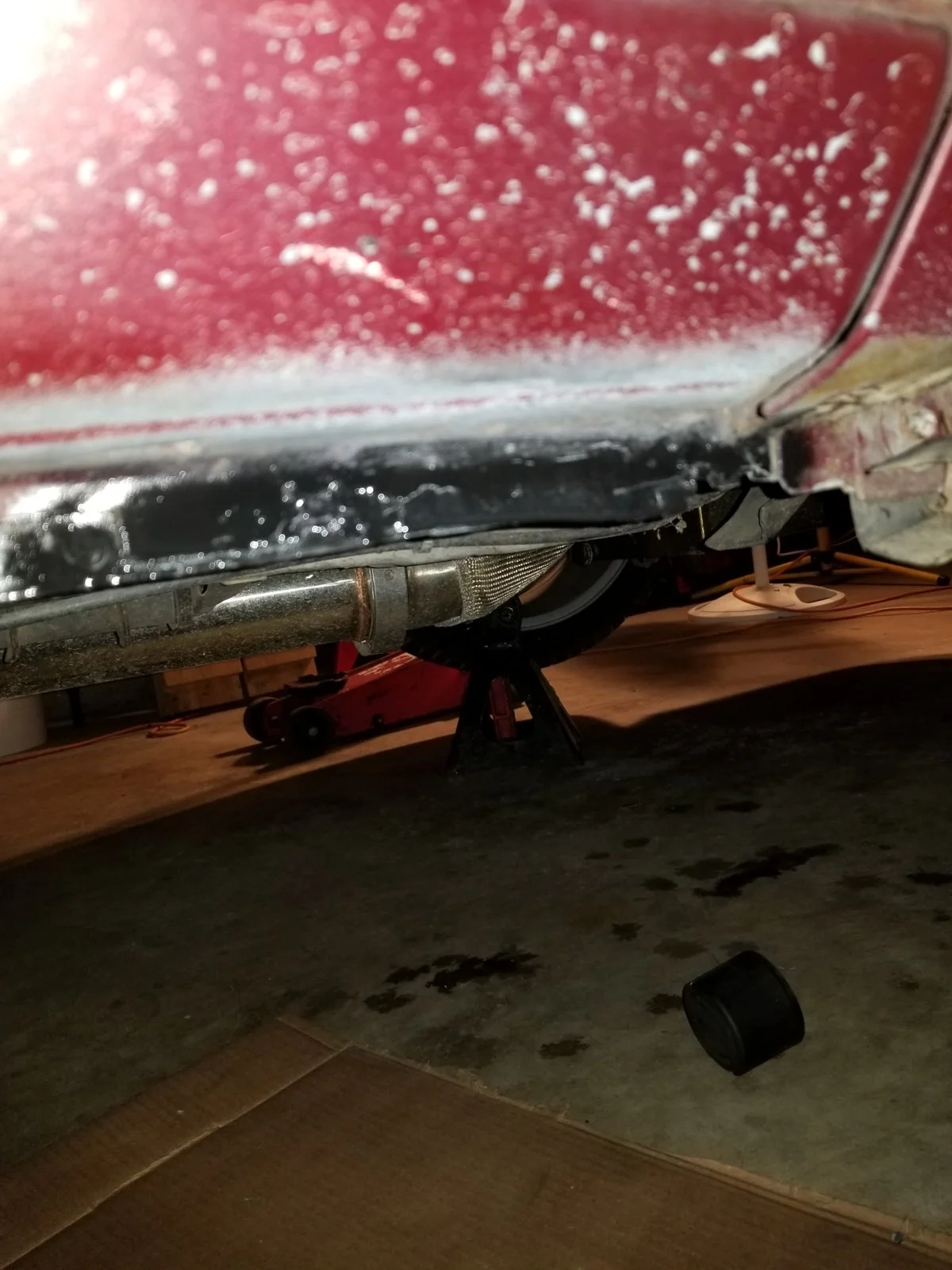

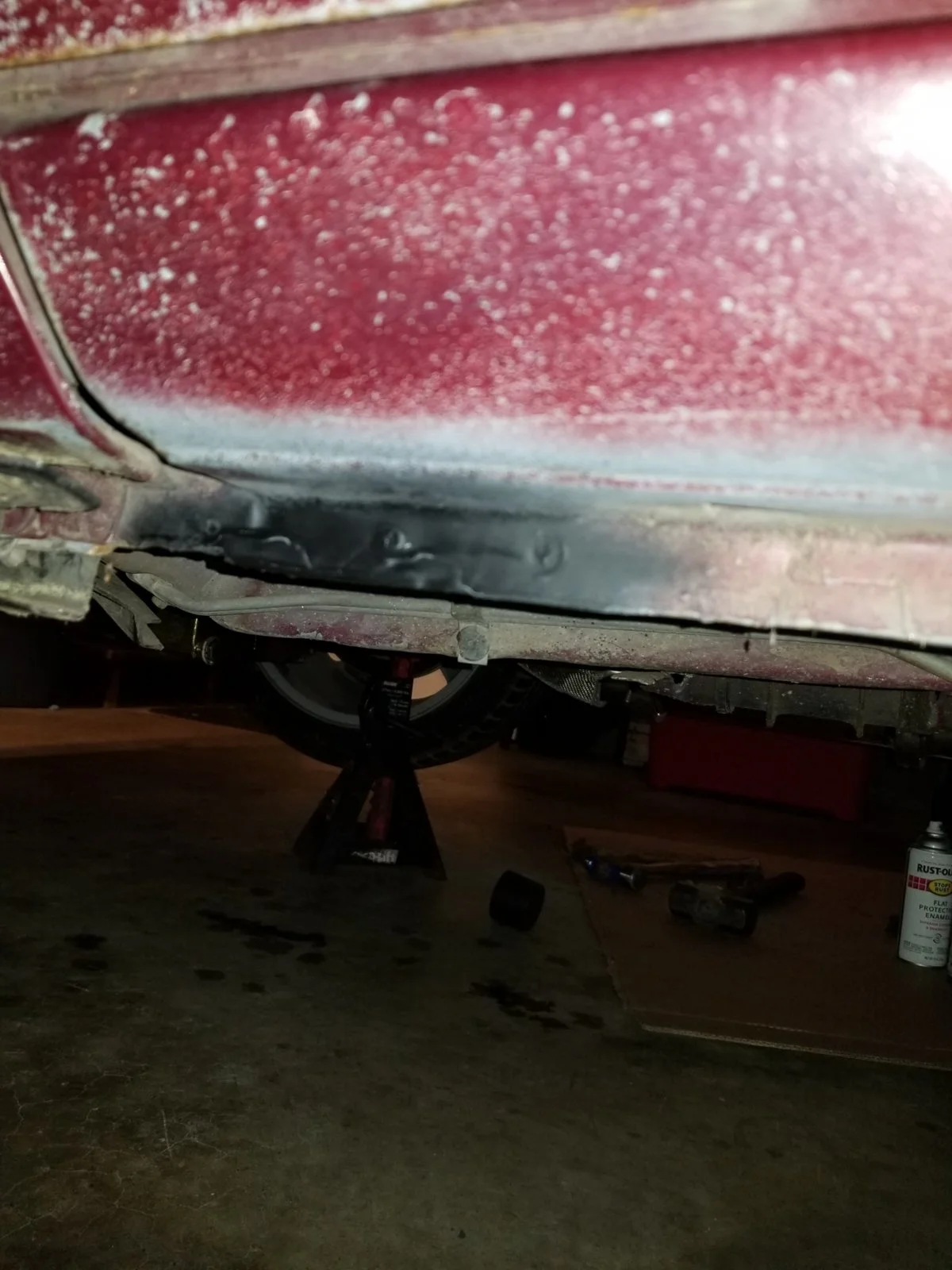

I hate bent up pinch rails. If I ever catch a guy having his mustang on the pinch rail I'm going to giv'em a fresh can of whoop a$&

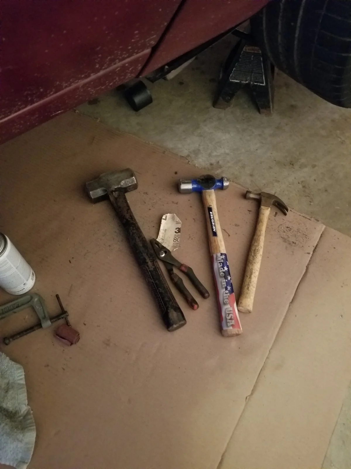

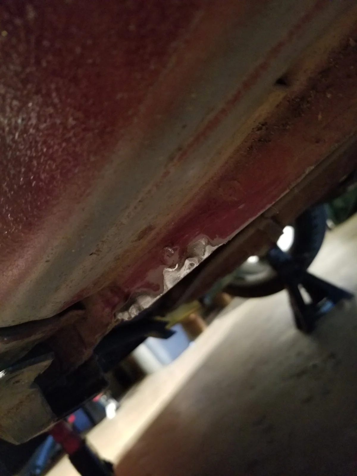

I had to break out the poor man's pinch weld repair kit....
Here's the kit....

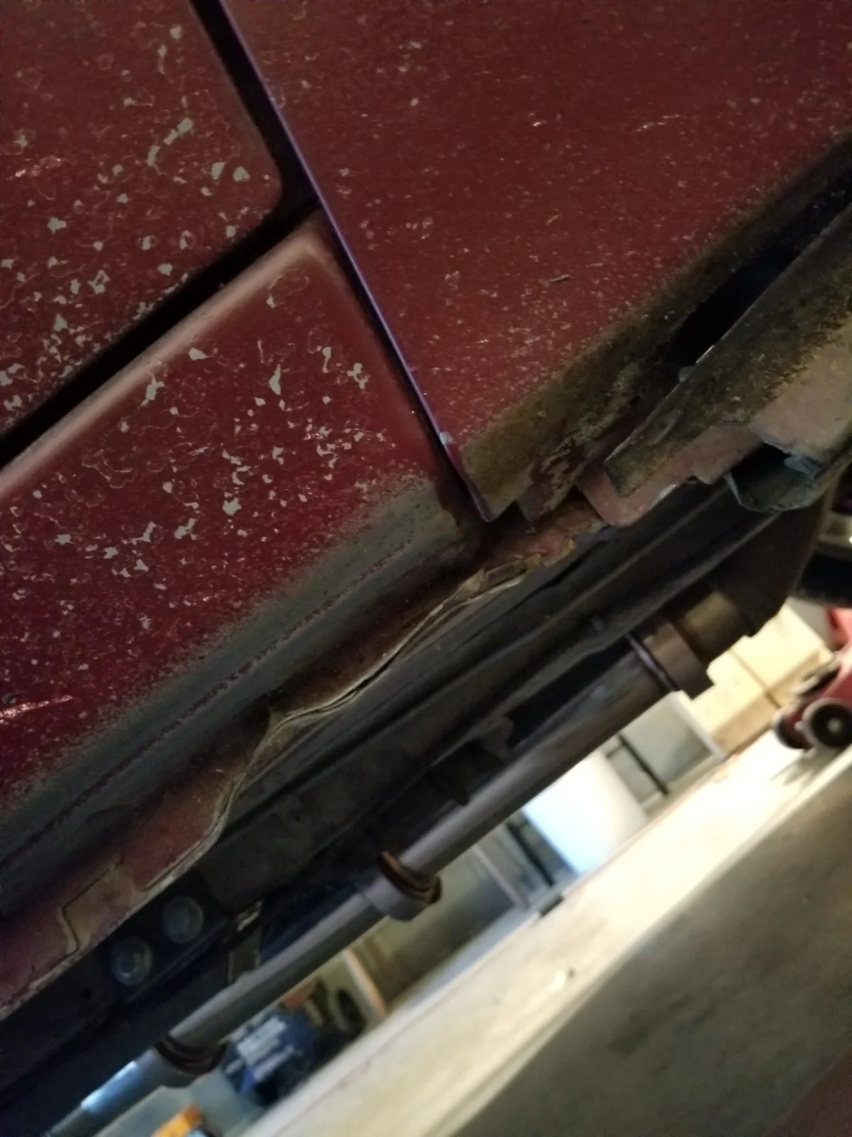

Ther passenger side was worse. The rocker is pushed up about 1/16th in. Came out easy better than it was.
If I ever get around to it I may get a body shop to put a clamp on it and pull it... but until then... it'll be what it is.

Mine had some of that same fugly Scott. A frame machine sure comes in handy then.
Fact is, I’m going to smooth mine once the jacking rail is welded in too.

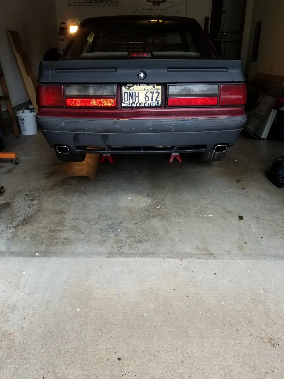

This took me over a year to do.... and I'm proud of myself. Finally, the tail pipes are positioned correctly. No pictures of that yet.... but they really sit nice now. I even polished the steel adapters to look like stainless.

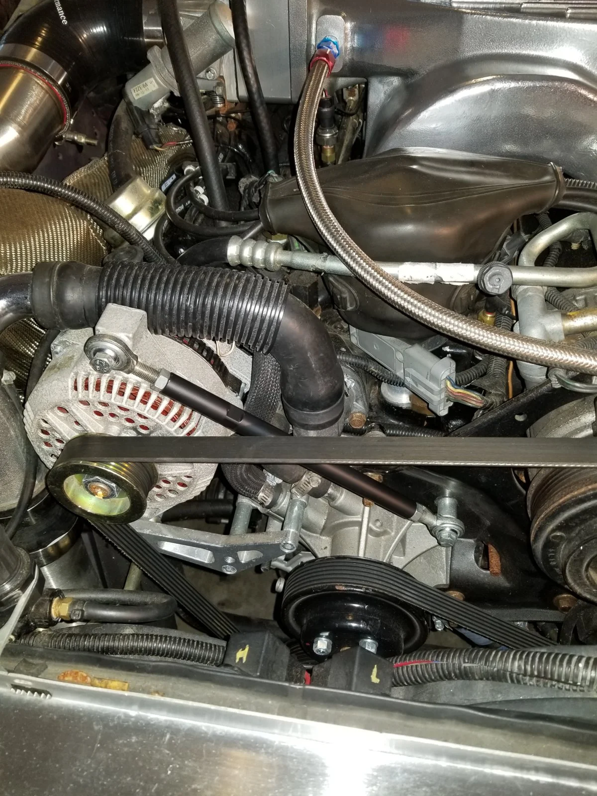

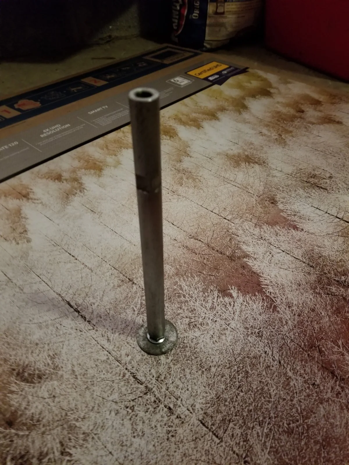

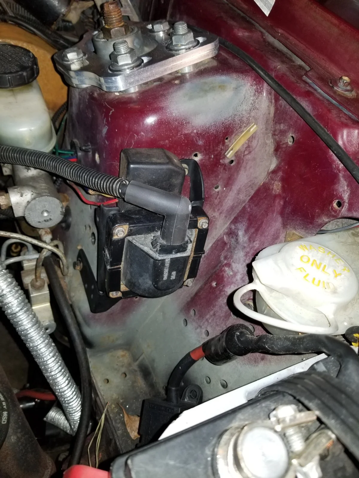

I also removed the coil bracket and the tensioner adjuster and painted them.

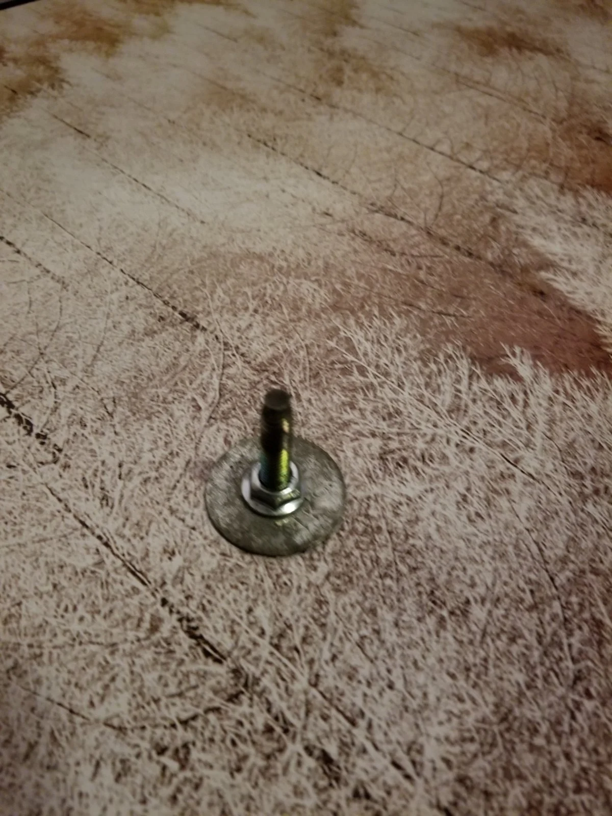

Had to use a bolt and washers through cardboard to hold the tensioner adjuster thing.
Worked out well...

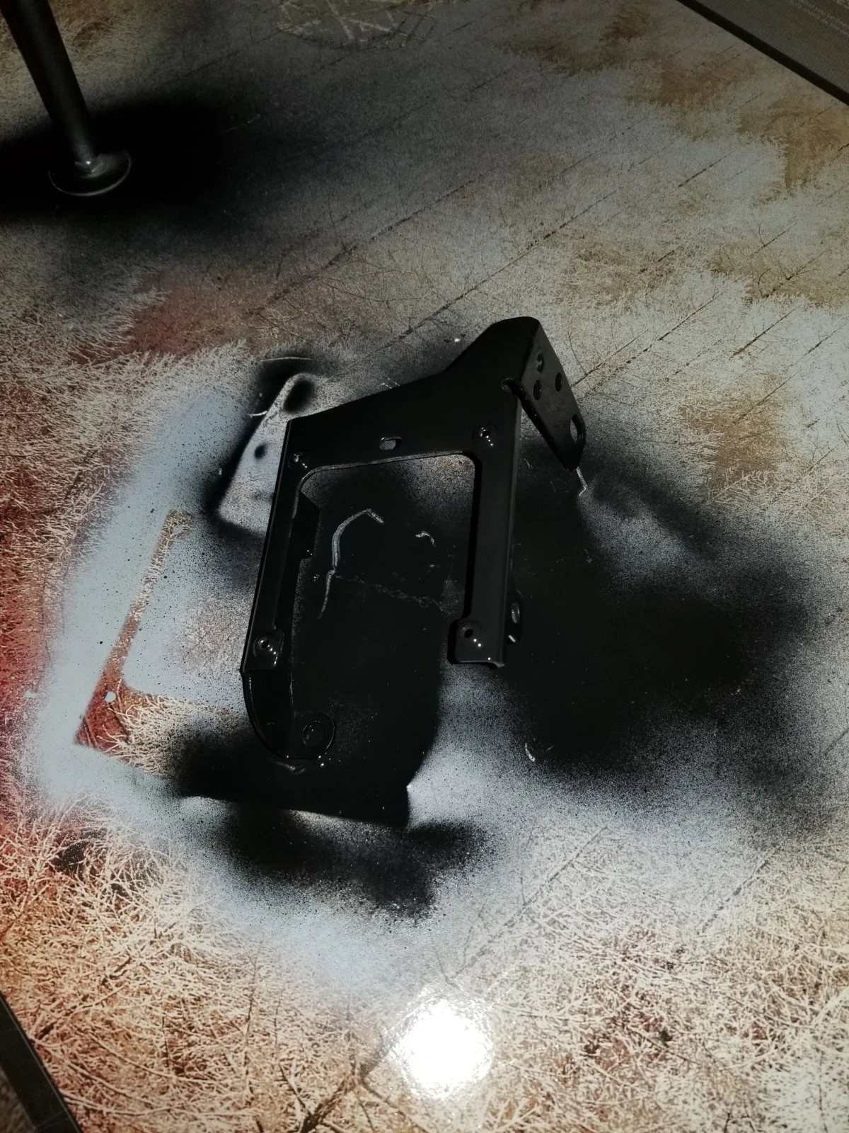

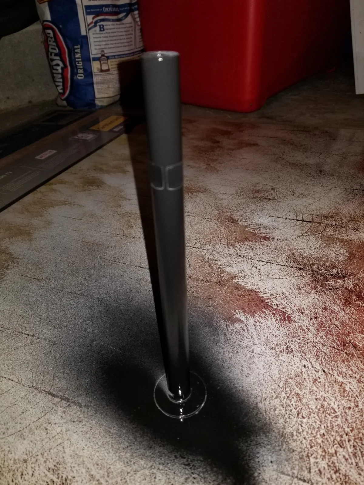

Here are the painted parts. I uses rustoleum primer and satin black rustoleum paint. I've had good luck in the past.

The on3 belt adjuster came out great.
... so did the coil bracket...
Tail pipe tips finally sit right...

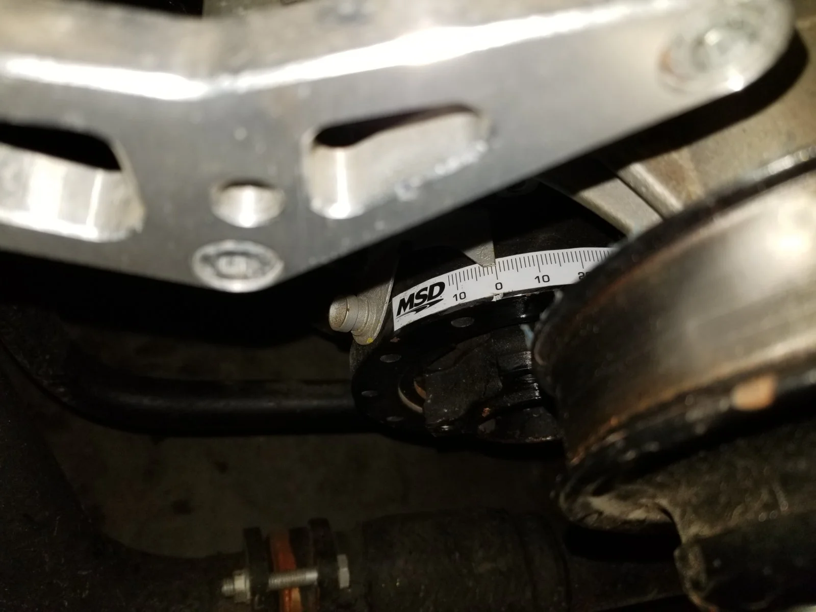

Got something else small done. When I started this thing I used a piston stop and found TDC. Then I used a stock balancer to mark the timing marks using smurf tape. The balance on my car is bigger than stock so I had no real way of telling the timing. Tonite I did this....
I used a brake micrometer and a metal ruler to get as close as I could to the measurements supplied by MSD. I'll still probably buy a new balancer... but this will allow me to see the marks a little clearer.

Everytime I tried to use that tape, it flung off the balancer. It didn't matter how clean or smooth I got the surface under the tape. I think I even tried to coat the tape with clear paint so it would act as a membrane to seal it...
Hopefully you'll have better luck.

One other suggestion for your timing tape, since as it has been mentioned, it's probably coming off once the engine starts...take a file or hacksaw blade or a center punch and mark TDC and paint it white or yellow so you can see with a timing light.
Guud Stuff rat der!
That's what I did...I marked the balancer so I could know where TDC is. The tape has stayed on so far...
