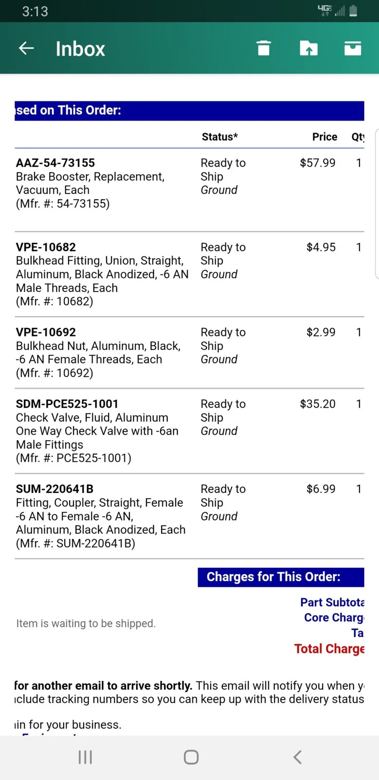

Too late @CarMichael Angelo ...Summit to the rescue....I do need a cobra master cylinder though.
Had to get it above 100 bucks.

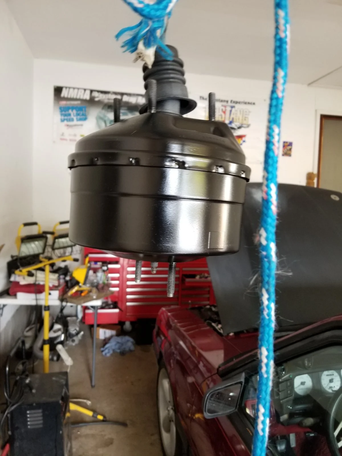

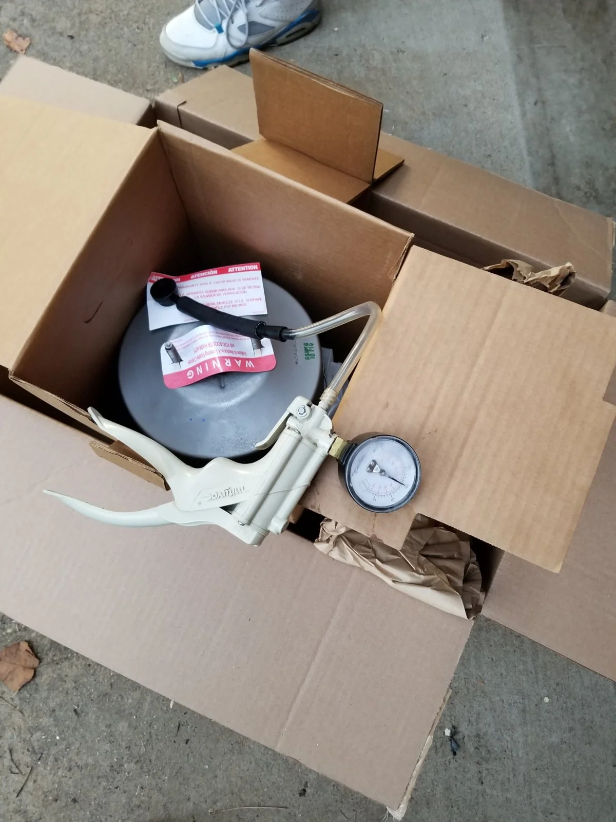

Got everything from Summit today. All the fittings work. The booster is holding vacuum...
I've got to order new intake plenum gaskets. The valve covers have blue Felpro neoprene gaskets so they should be ok. I want to change the master cylinder while I'm in there. This would be a good time to run new lines and install my adjustable prop valve.

Dude, that rusty ass booster only has 50 miles? Shoulda painted before putting it in. Redoing all my wiring with the fender off lets me see how much the previous owner had to heat and beat the piss out of the strut tower to make it fit. I was like, I should take it off so I can paint this side while I am doing this....NOPE!

It's been in for about 50 miles and two or three years. Can't remember when I put this engine in. It was a serious PITA and I should've painted it. I get the lucky chance to do it all again. :doh:

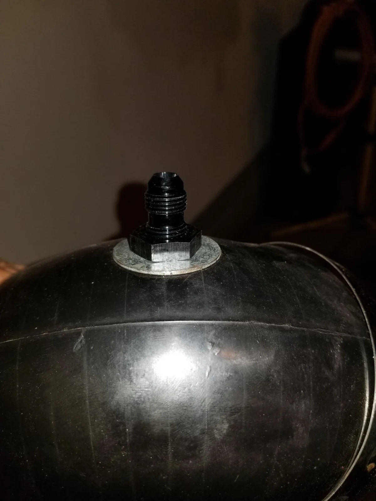

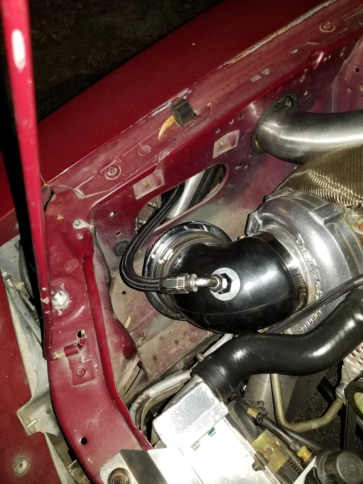

I said it way back in this thread and I'll say it again " I love Summit AN fittings...the other cheap ones are crap ! ". Got the vacuum check valve hoses up. I actually had enough fittings to make it happen but nothing wrong with extras. Eventually, they will all get swapped out for black ones.
For the vapor line from the breather I had to drill through two washers with a step drill bit. Anyone that's ever attempted it knows that it's a puckering moment every time that thing spins out of the pliers. Luckily, I got them done and didn't loose any blood.

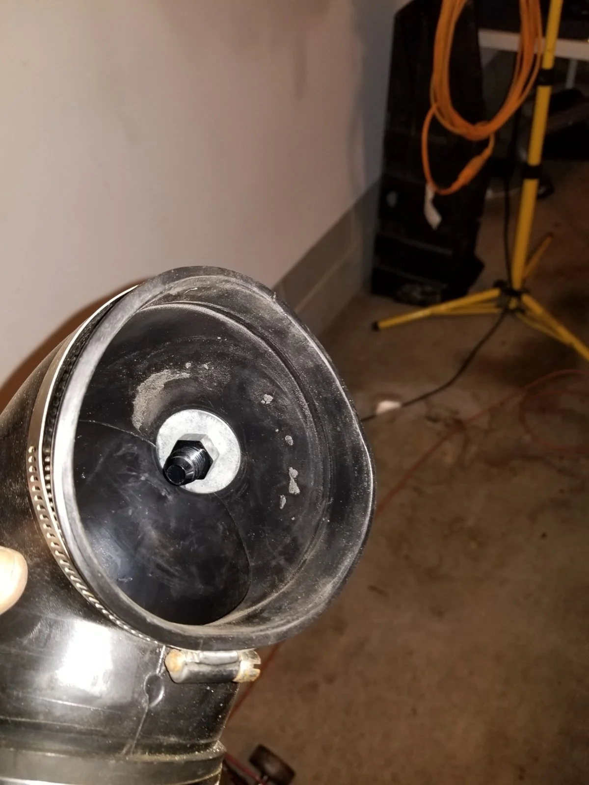

This fitting has the nut on top so there's no threat of it falling off and getting sucked in the turbo.
The straight fittings at the intake and first at the check valve are cheap no name fittings that I've had for years. They've been installed on a few different cars so they're a little beat up. It takes the brute force of a drunk pig to tighten them up. This causes the anodizing to rub off from the pressure. The others are Summit brand and go on with ease. ( with a little AN fitting lube ).

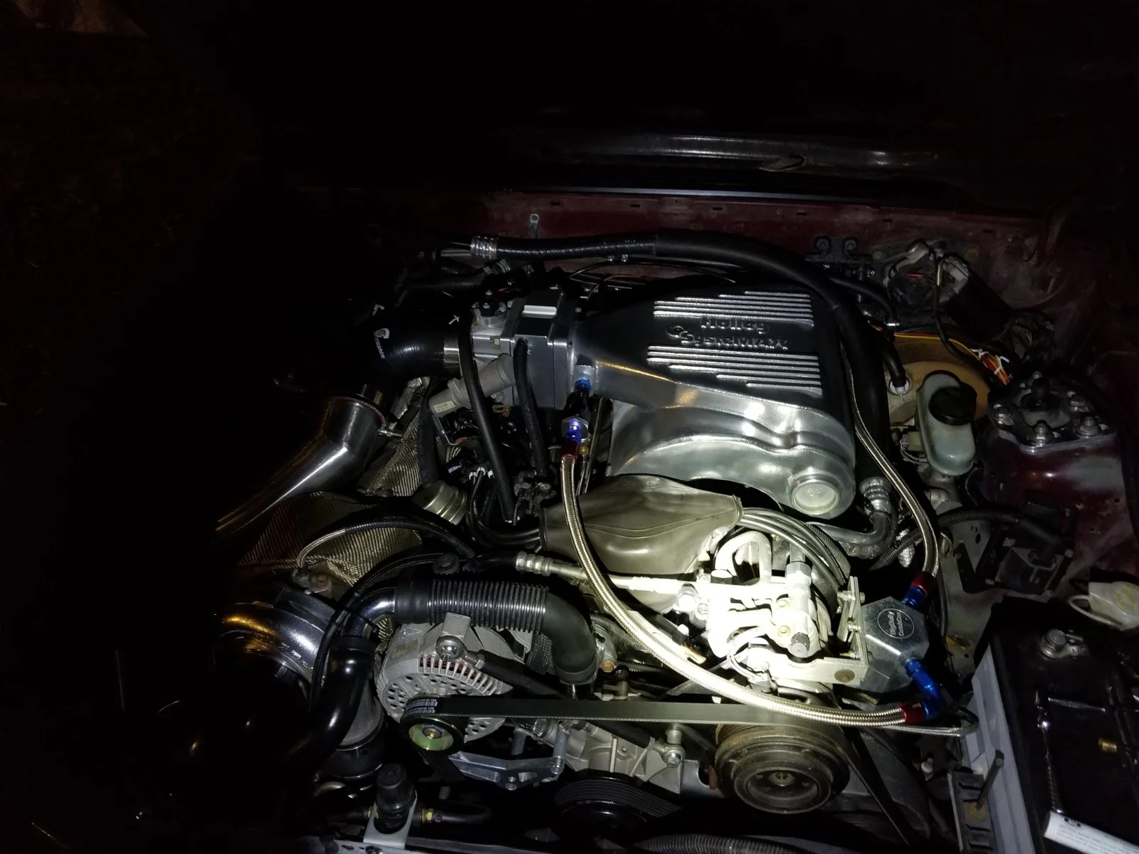

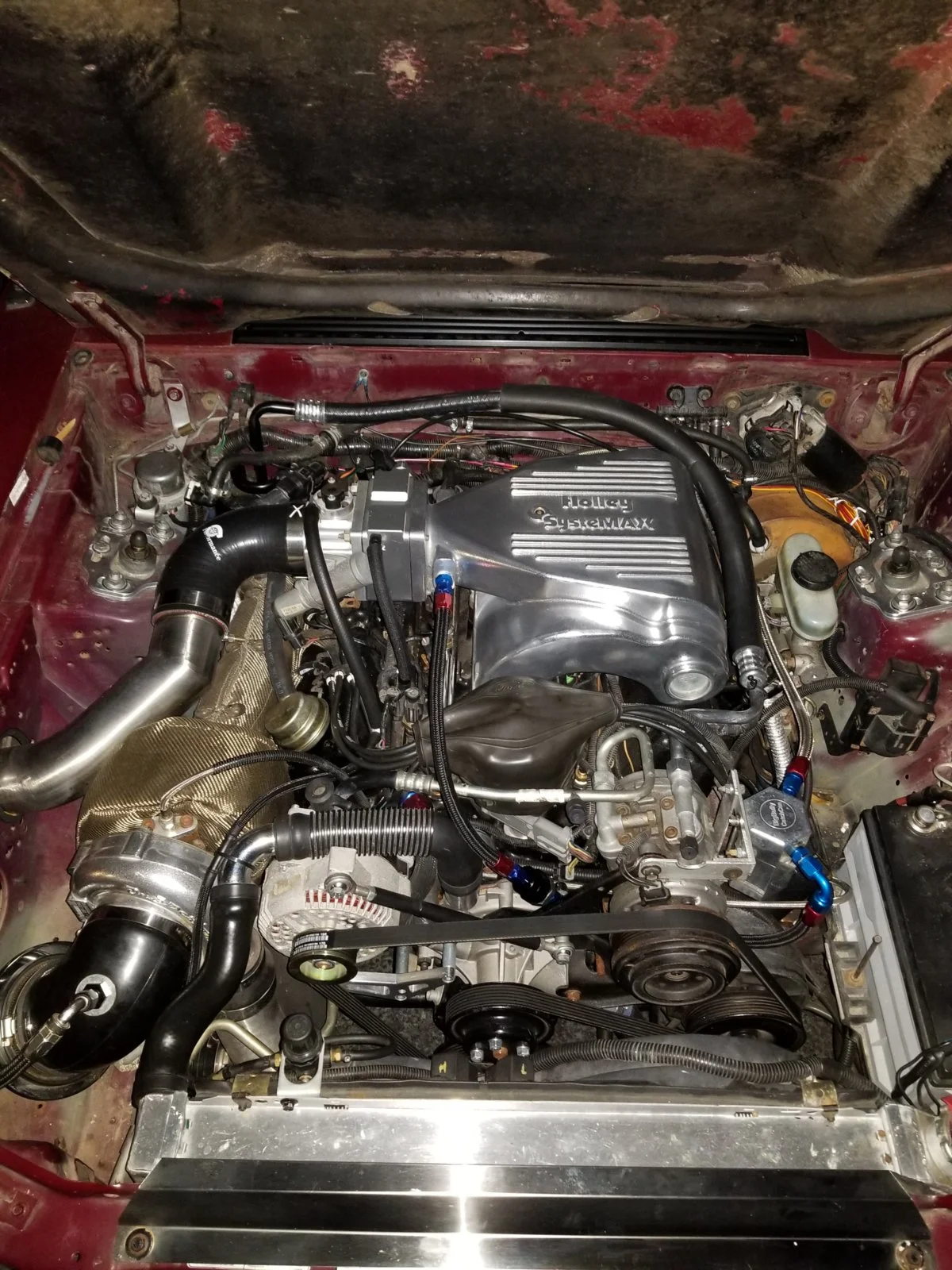

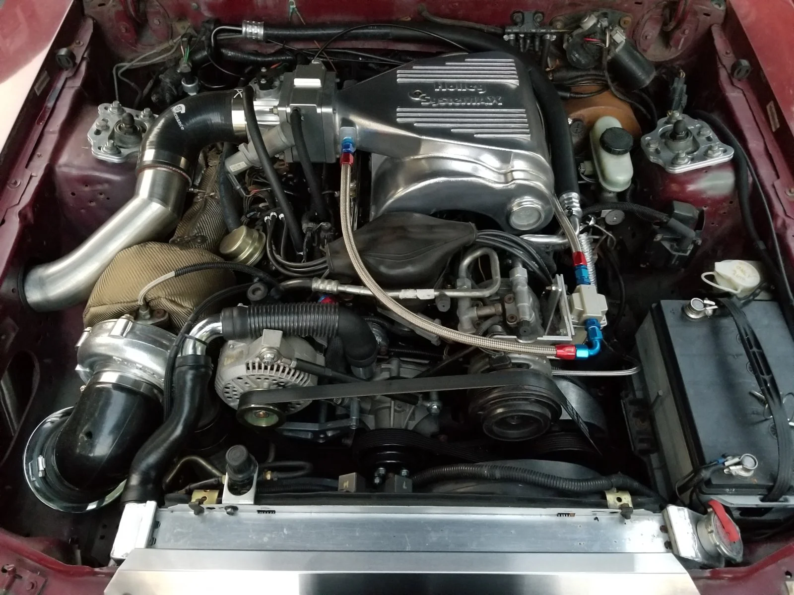

Here's the underhood shot as of tonite. Soon most of this stuff is coming out and getting cleaned up.
Hard to believe I've been working on this thing for a couple years now. Still gotta figure out what to do with all the stuff back there on the firewall.
I'm going to finish drinking now. Any ideas are helpful fellas.

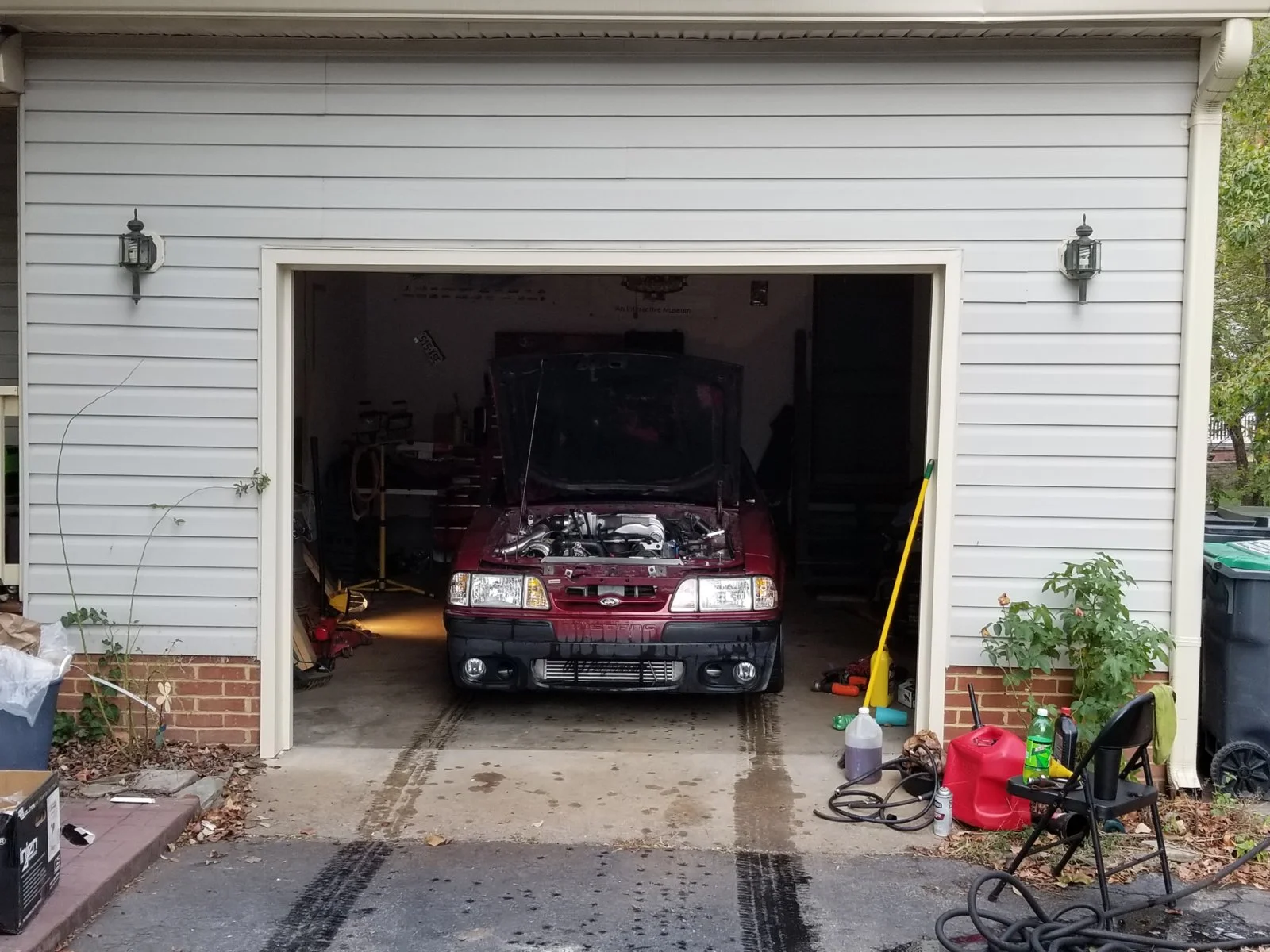

Dusty is back in his room...
Im not going to talk about how much work it took to get him back there. The 300zx I'm working on for a customer runs.... but found out the trans cooler in the radiator is bad and mixing coolant with the transmission fluid. Smh

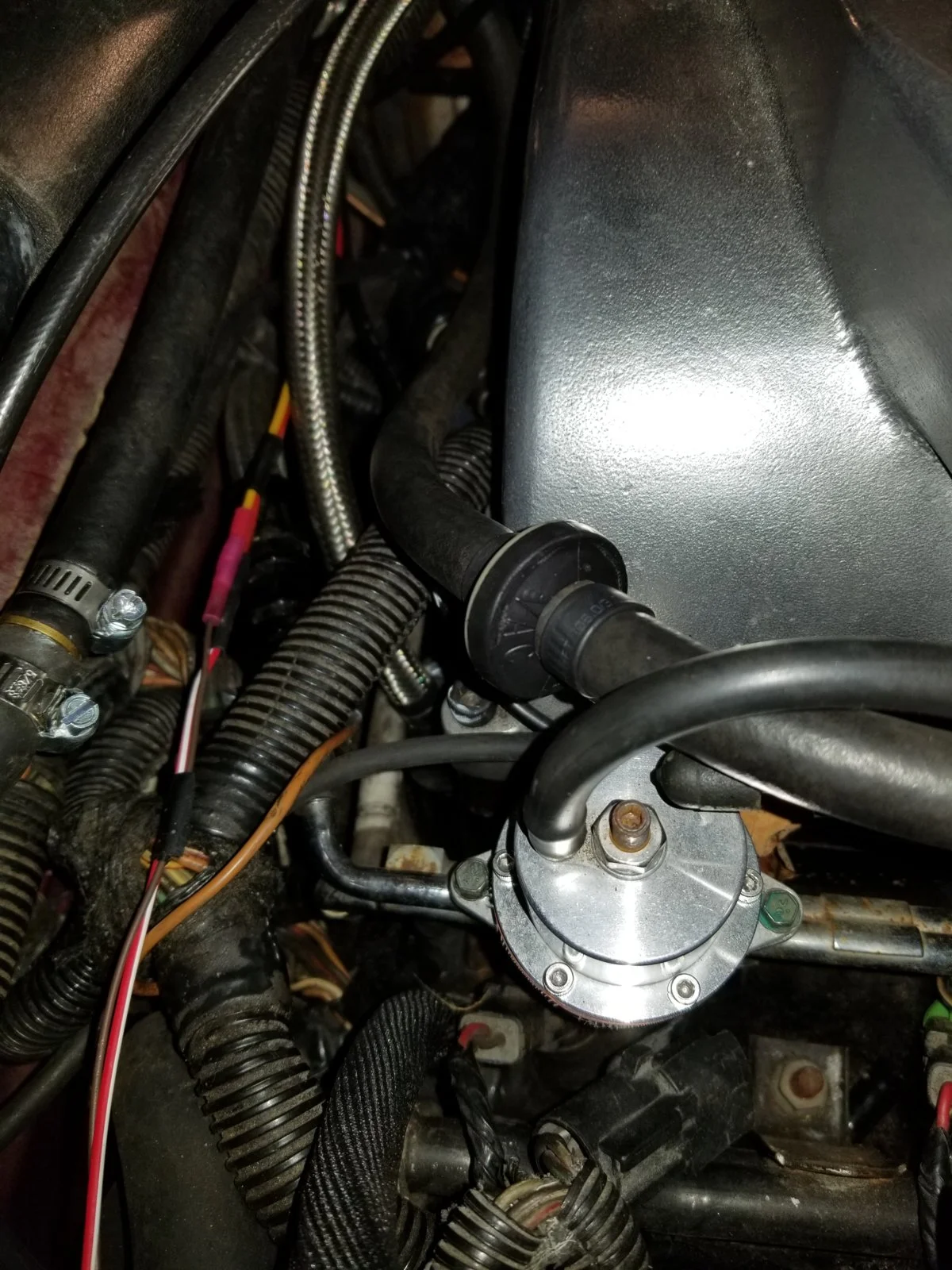

Finally got a check valve in the hose that goes from the intake to the vacuum tree. After upgrading my other car a bit I had time on my hands. Thought I needed to order a check valve but ended up having one that fit in my tool box the whole time. I could've done this 2yrs ago.

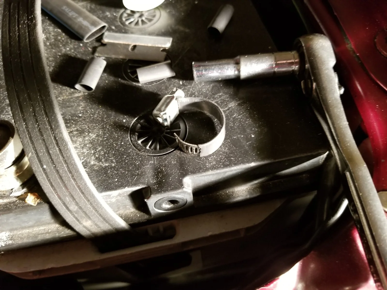

I hate those chrome hose clamps...so...they got my wire shrink wrap treatment.
Here it is installed. The flash makes everything look dirtier than it is. Mike, it's all coming out soon for the beautification process.
Those clamps by the firewall are on the hose running for the vacuum pump...so are those bright wires. ( except the orange one. That's for the o2 sensor ground that I no longer need ). Once the pump is actually completely hooked up those wires won't be there and neither will those ugly clamps.
