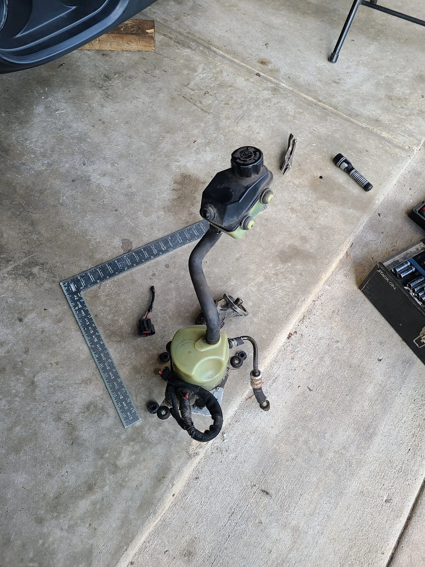

That's a 90 degree oil filter adapter....volvo s40 electronic power steering pump....and MAF sensor harness of an old taurus ( I melted mine way back when I first put the turbo in )

yes sir, and a filter adapter if you come across one but its low priority. I want to do the electric PS at some pointWill do Steve. Are you talking about the electronic PS ?

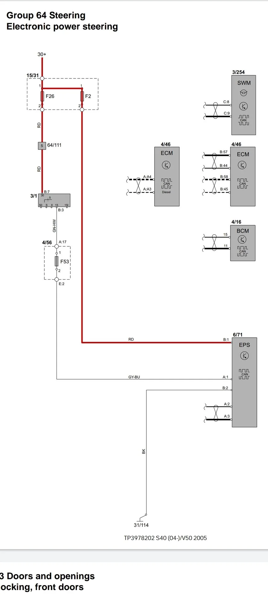

It looks to me like the unit has its own module inside that receives the can signal and then will pwm the solid state relay. unless we can debug the can circuit and figure out what address it is and what its looking for.... IMO alot of work and will require a second module to communicate with it, an arduino can be used but you would have to write your own code for it AND get it talking with the MS at the same time for some type of load feedback.
NOT worth the hassle IMO.
let that bish run as is
