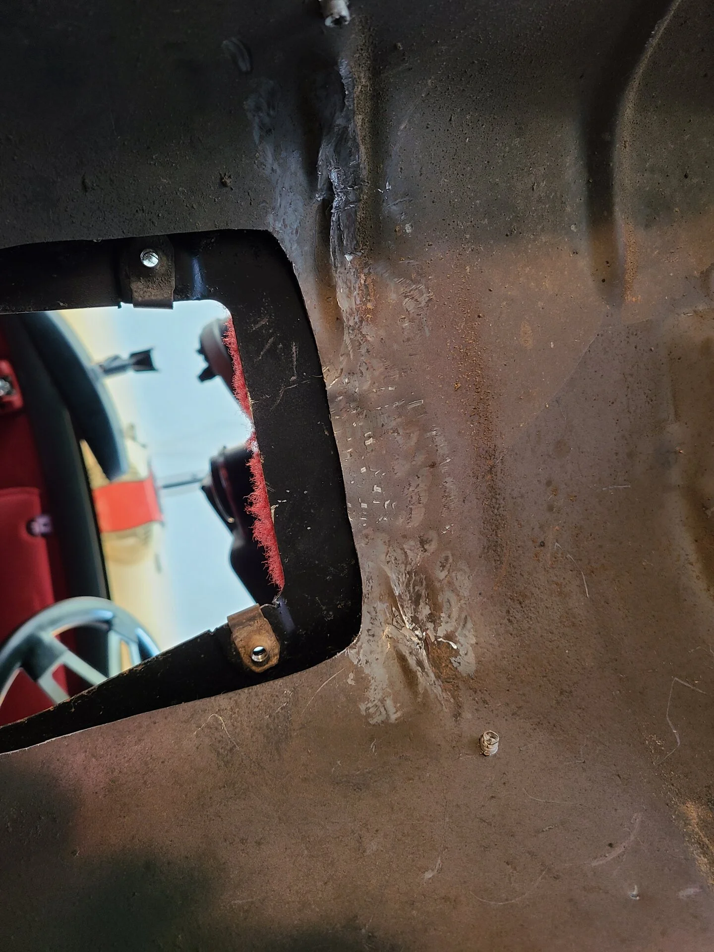

Like some have posted over the years my tko is hitting the top of the transmission tunnel...right at the first rib after the shifter hole. The instructions for the Stiffler crossmember says to use one of their flat spacers under the trans mount ( takes the place of exhaust hanger do- dad ) and to use the spacers from the tko install kit above the mount. They are 5/8ths thick. There is no way I could get them in so I ditched the flat spacer and bolted everything in.
The main issue is that the TKO is a c☆nt hair from the tunnel. Easy fix with hammer but it means pulling the transmission back out. The bolts supplied with the spacers are too long. I had to add washers to keep from running out of threads on the bolts.

I clearanced it this morning. Taking the trans back out was too easy not to get that metal moved. It looks a whole lot better now. My neighbors loved it at 9 am this morning.

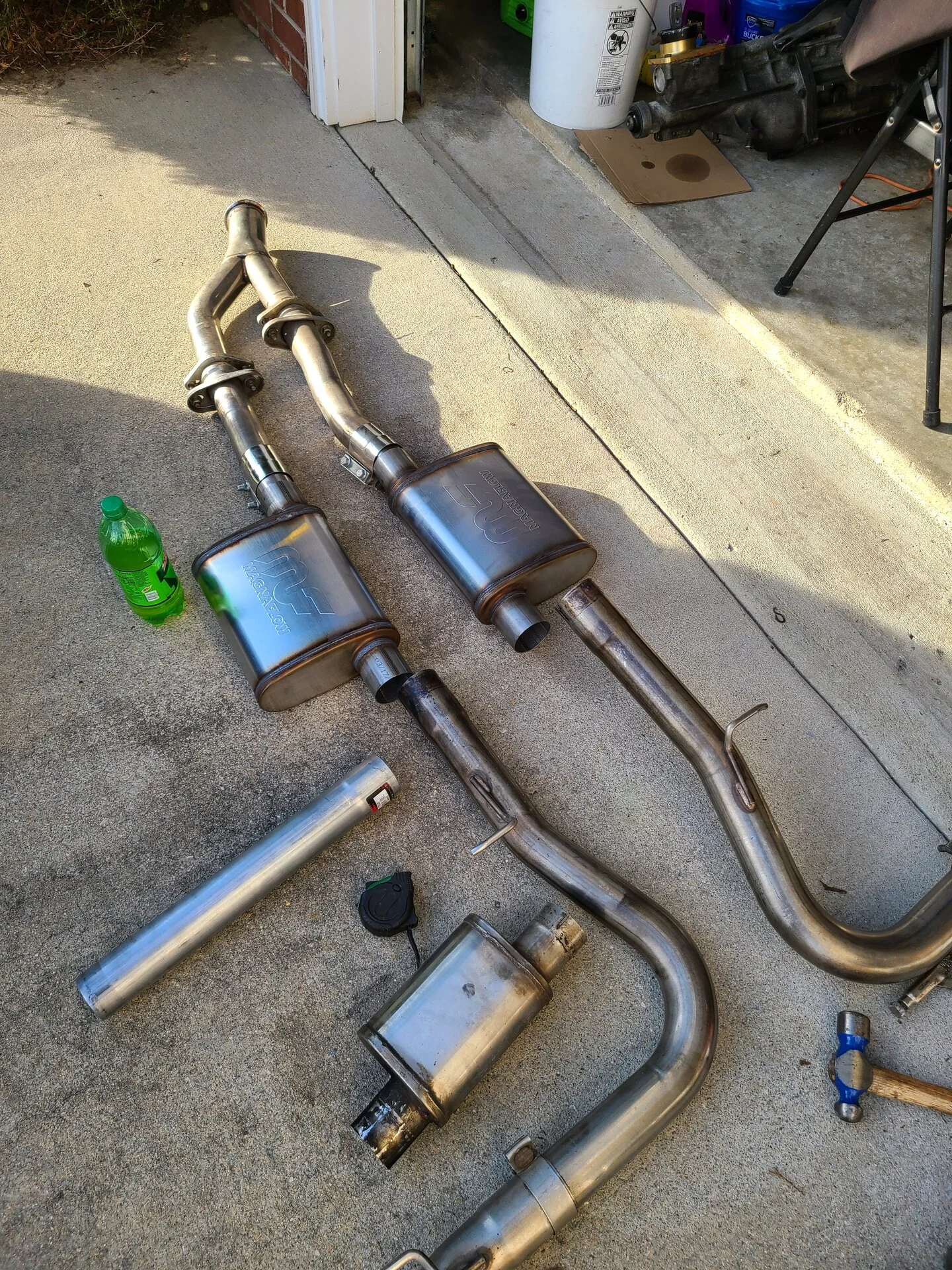

Exhaust is hanging under the car to the mufflers. They'd be on now but the tailpipes and muffler pipes are the same size. This means I need to cut the tailpipes and adapt them to the mufflers. The Kooks resonators are now gone.
Reactions: RaggedGT
Got the exhaust on the car....everything except the clamps. Had to cut 2.75 inches off the tailpipes near the muffler connection. Chopped some 2.5 inch exhaust pipes down to 7 inches long. Got the job done. No pics yet. I want to pull the stainless parts off and polish it up. Also, want to paint the raw steel adapters.

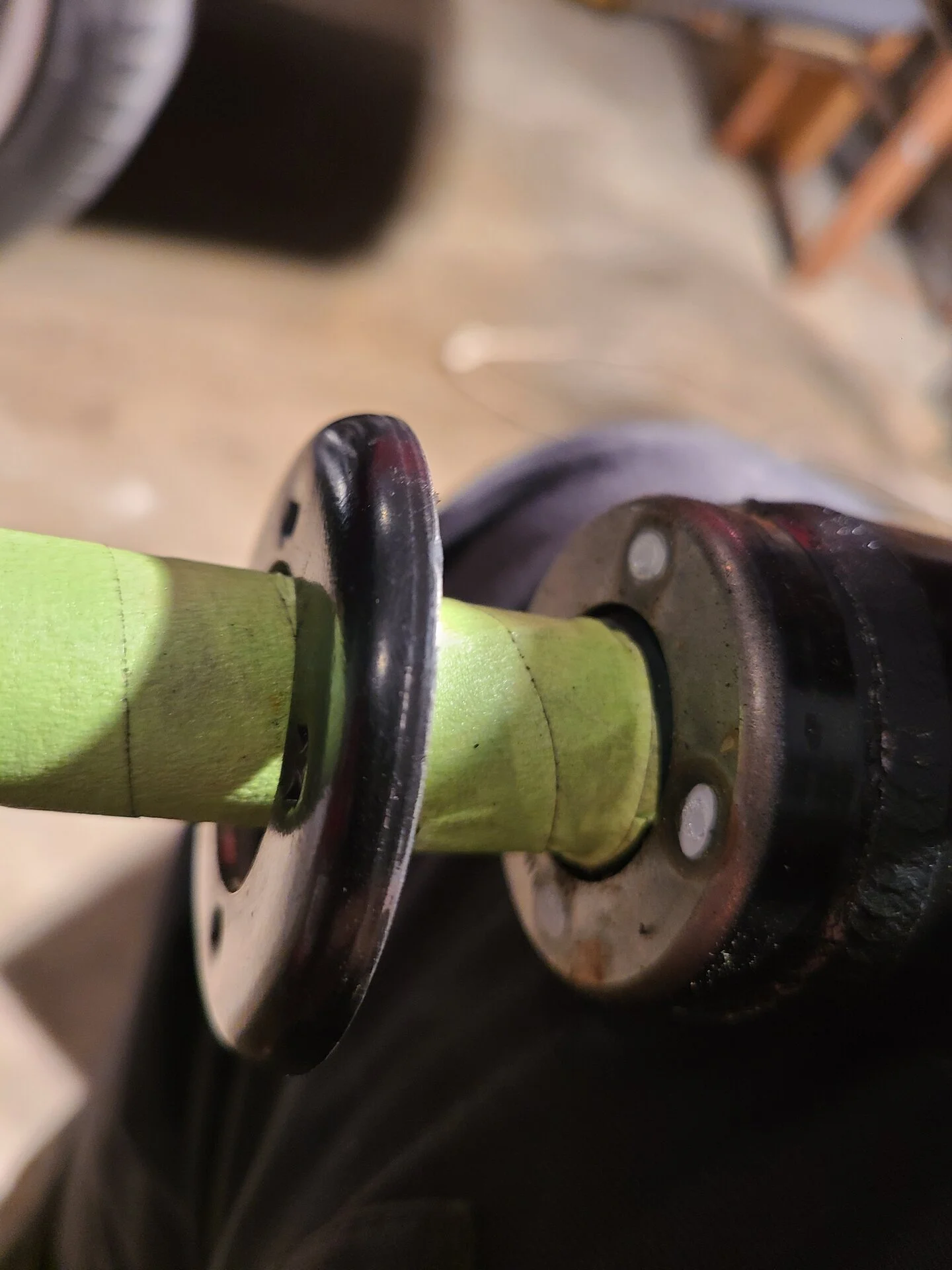

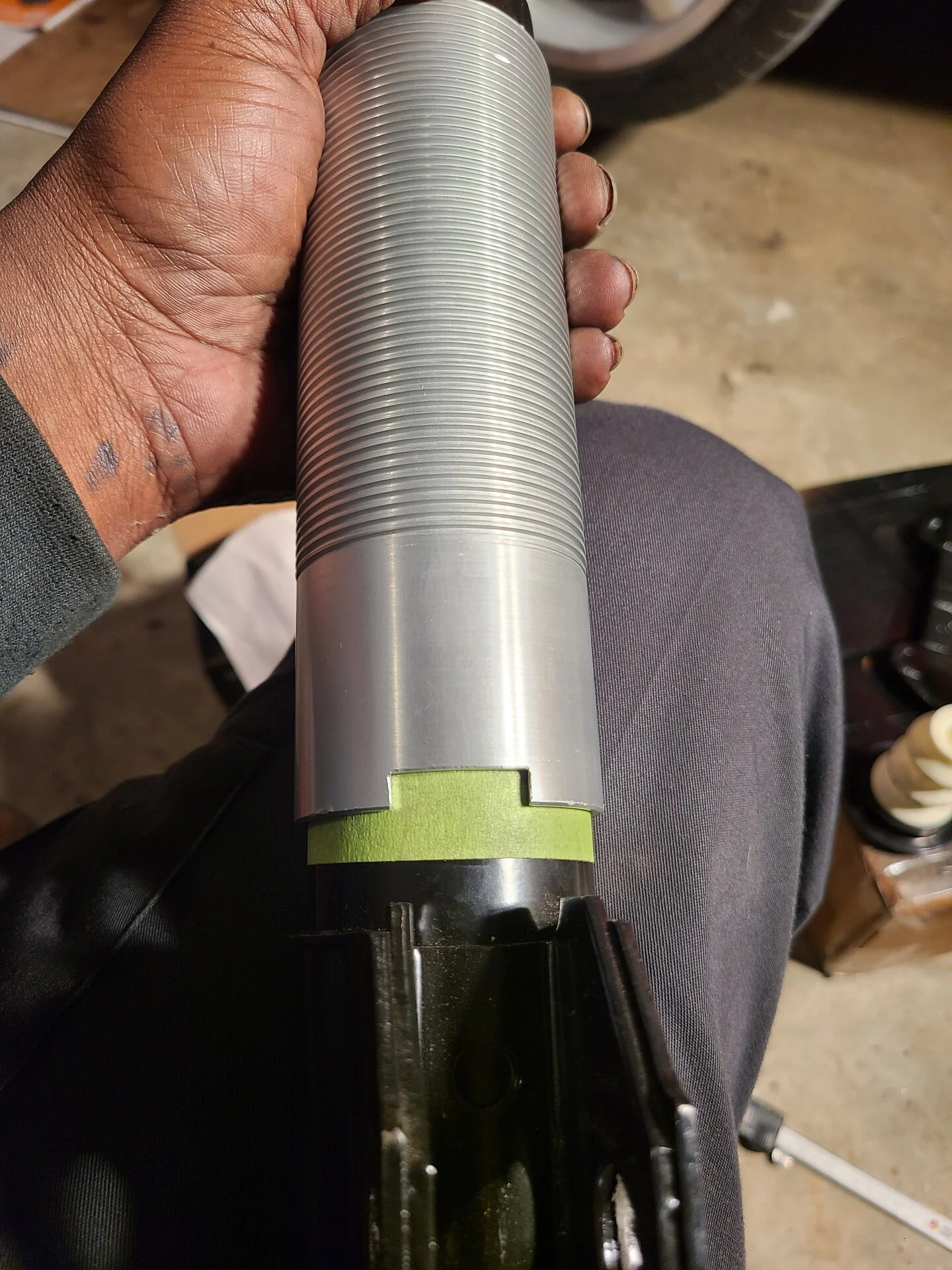

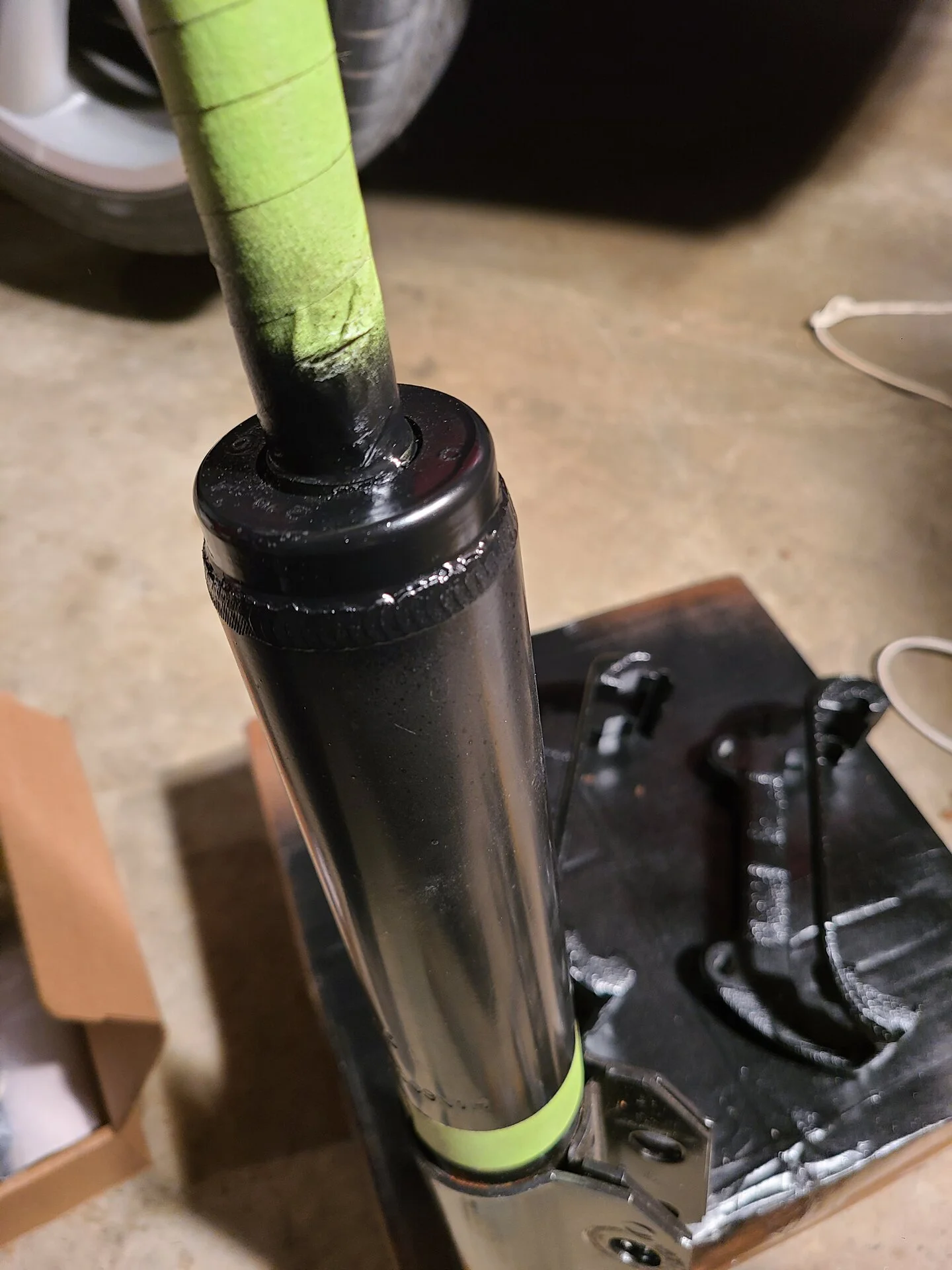

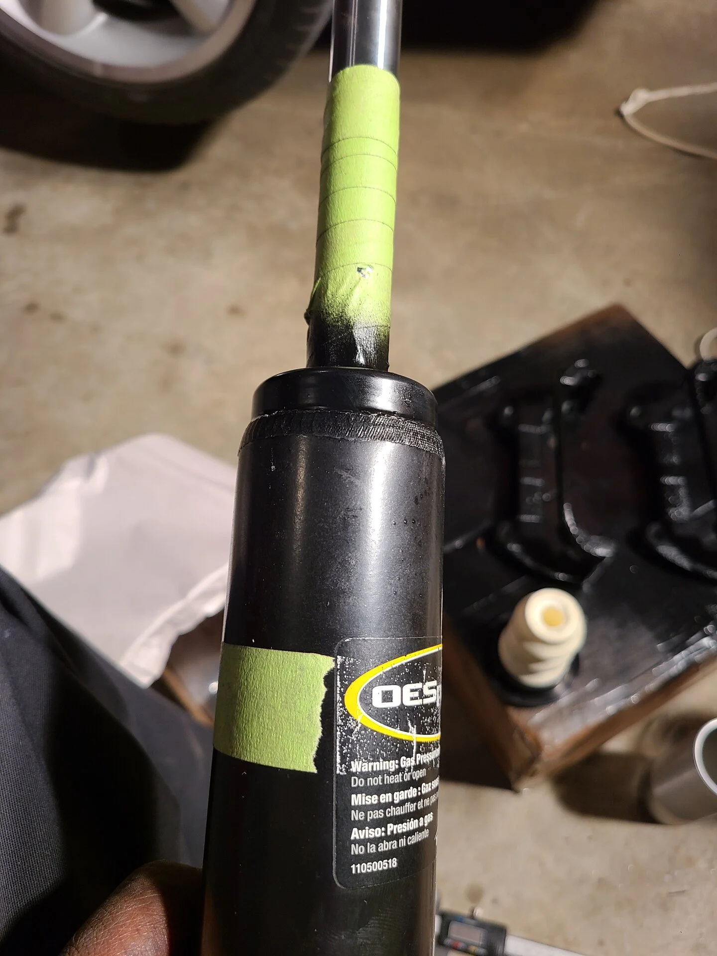

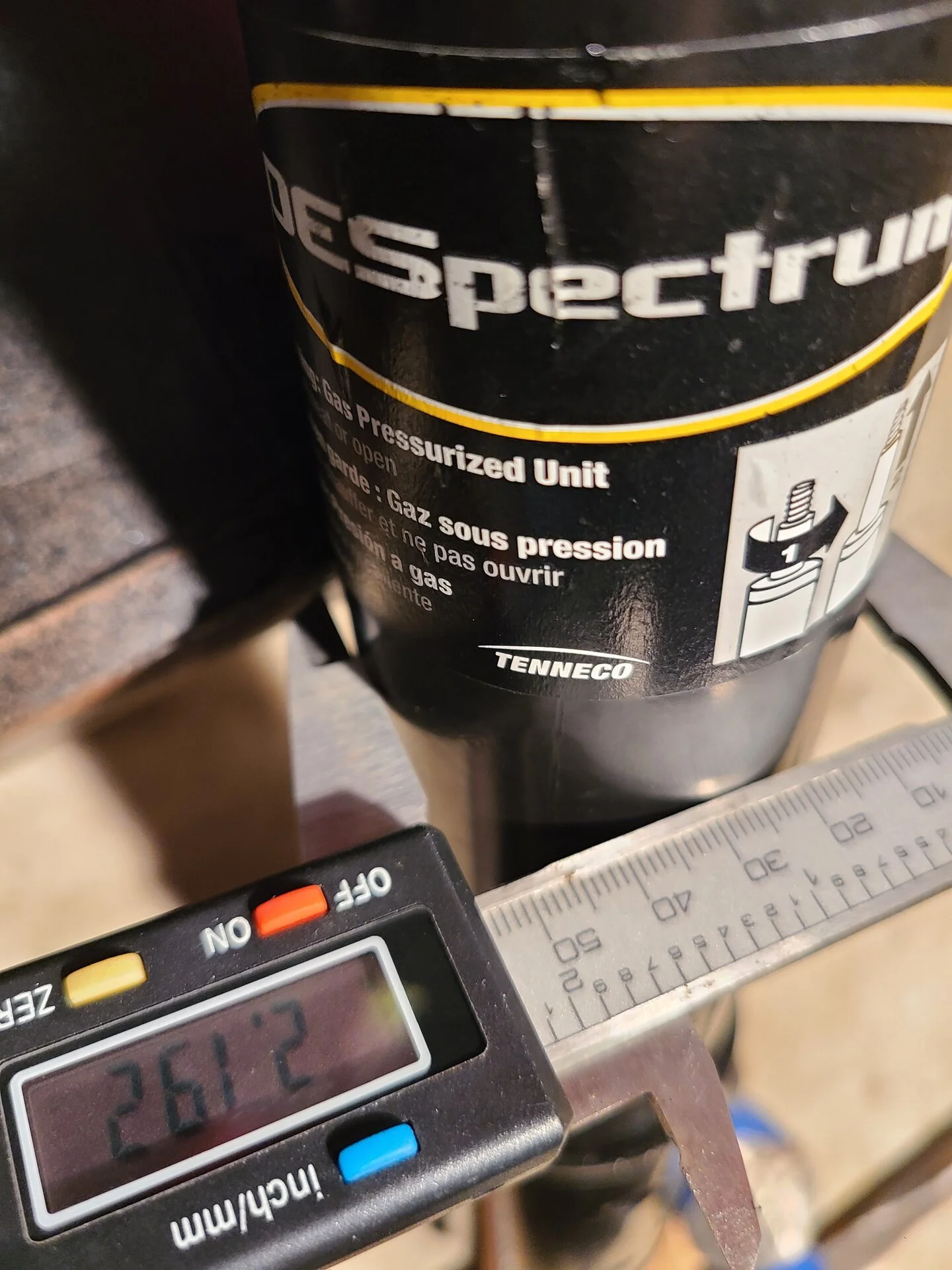

The coilovers went on today. No big issues. For the record....Strange coilovers do fit OEM Spectrum struts very well. The coilover sleeve measures 2.2 inches inside.
There is a very small amount of play...the thickness of masking tape.

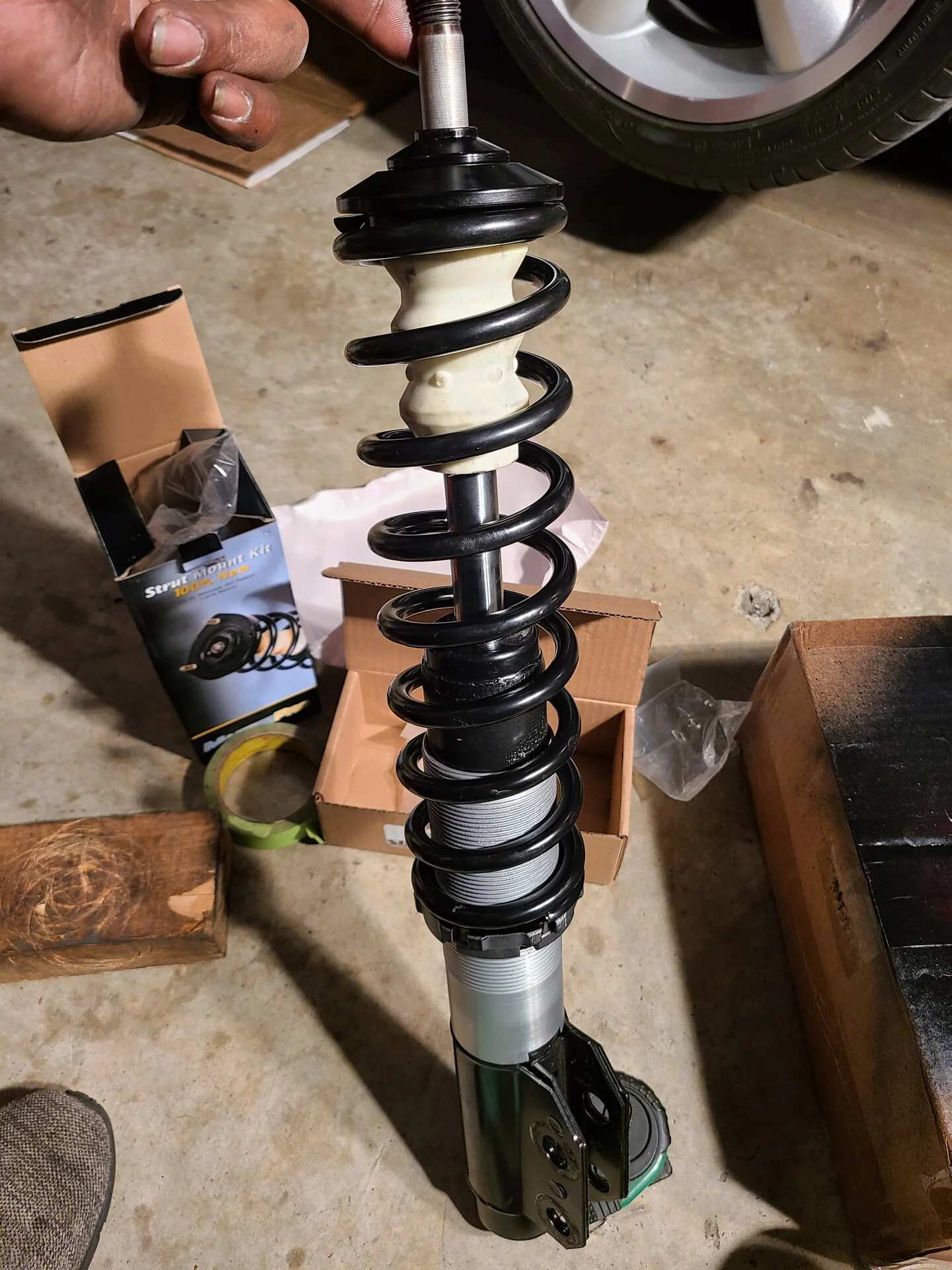

The top cap has 4 tack welds. Popped them of with a chisel and hammer. Painted them with semi gloss black engine enamel...perfect match.

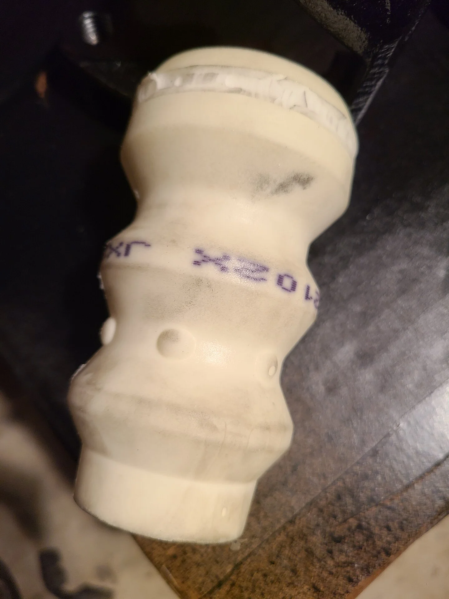

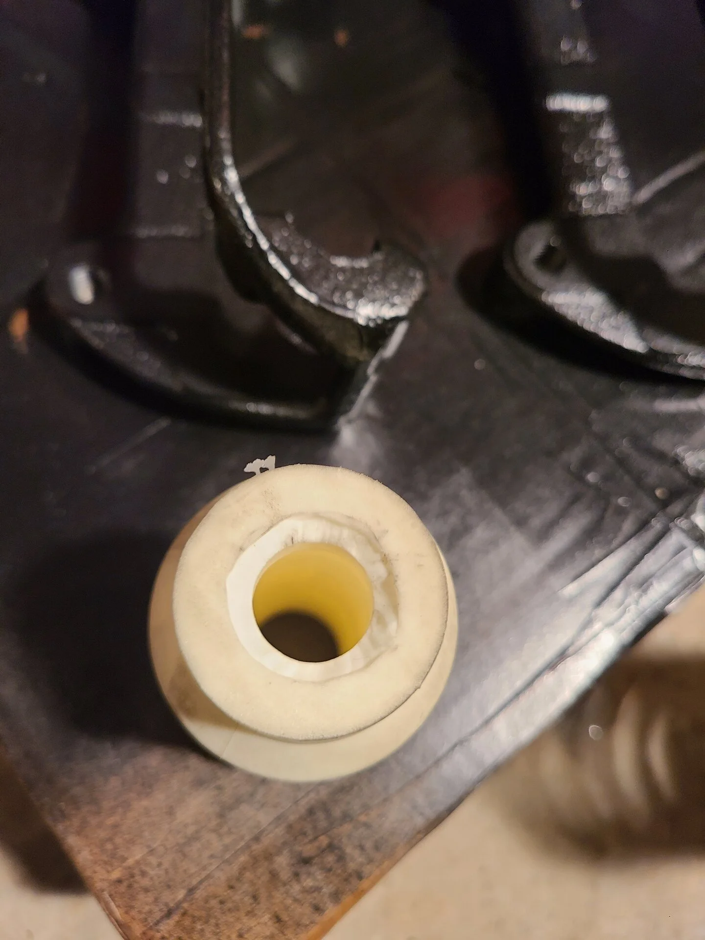

Found some bump stops at O'Riellys in stock. Had to trim a ring around the foam thingy and cut a 45 degree angle at the bottom opening to get it over the strut shaft. Fit very well. The MM coilovers are the only ones I've seen with bump stops. I like the idea. The strange coilover top piece looked like it was made for one.

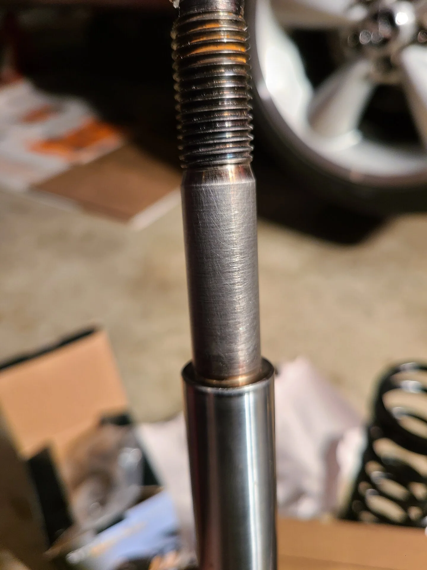

One last little time bit. The piece that cover the needle bearing assembly was a little tight on the top of the strut. I sanded the strut down a little with some 80 grit followed by a red scotch bright pad. Now it slides on and off with no fear of getting stuck.
For one time in my life I didn't get antiseize all over everything aincluding myself. Thats a win in my book. I did have to relocate my brake hose brackets...but that was easy using existing holes. Not really satisfied with how my brake lines look but I'll make new ones at a later date.
Here's the finished product before I put them on the car.
I used peanut butter ( high temp disc brake bearing grease ) on the needle bearings and races.
They came out good but I may have to up my spring rate. These are 170lbs. For the weight of my front end I should probably have 225lbs on there. Not a huge deal...Summit brand springs are less than 45 bucks a piece. We shall see.

Adjusted 5 inches from the bottom it'll take 4 inches. The spring rungs are almost 1 inch apart. We'll see what happens. The good thing about foam bump stops is they always can be trimmed down.

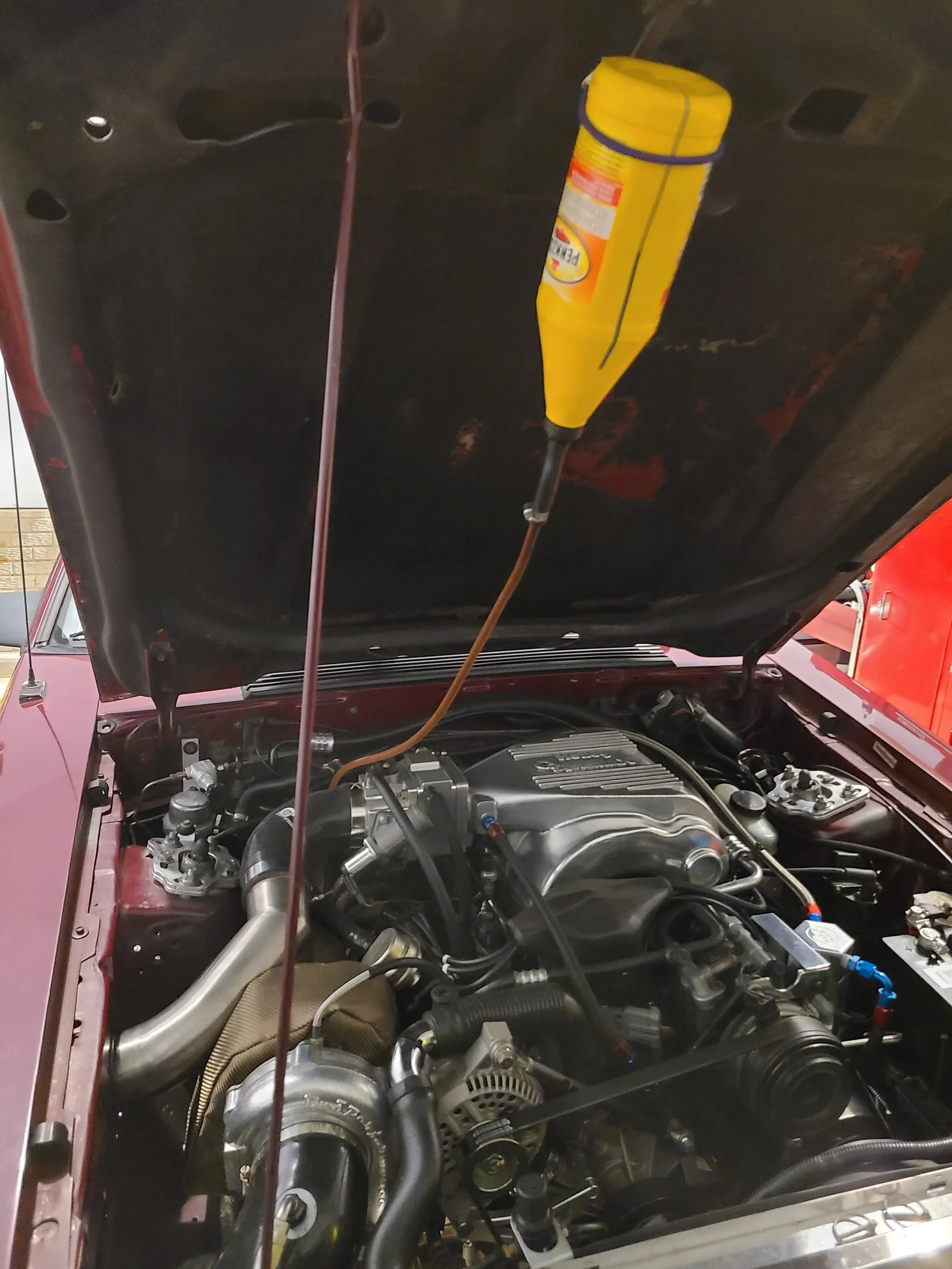

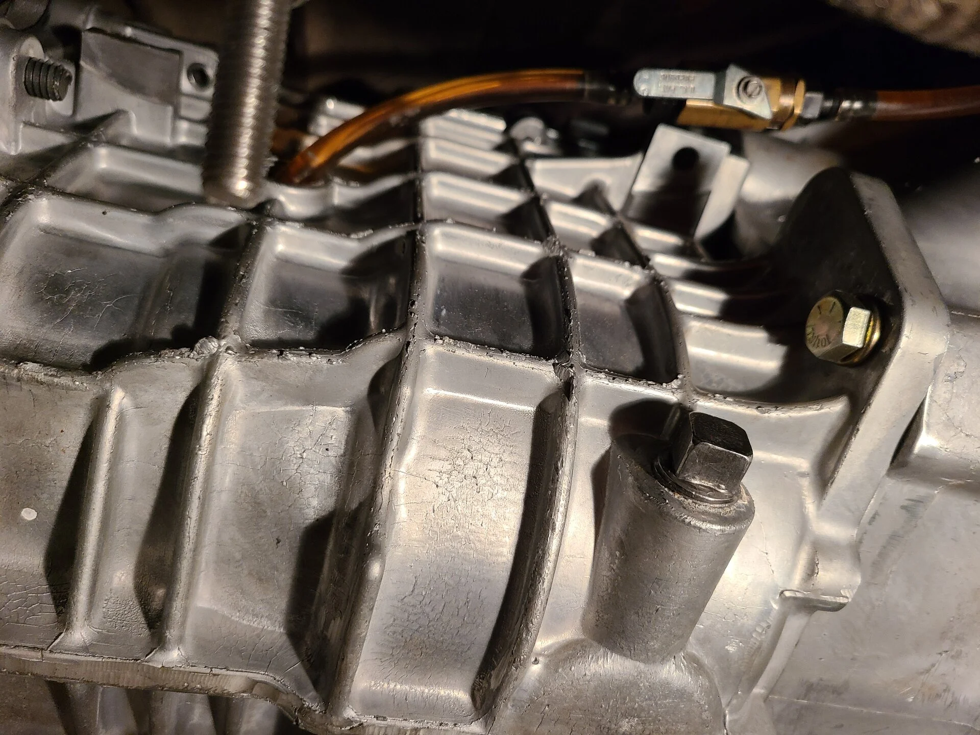

Put Dusty on an IV last night. This is how I fill manual transmissions in the easiest cleanest way possible.
I have a ball valve in the hose by the transmission to cut the line off when it gets close to full. No drips and no mess. All the extra fluid goes back in a bottle.
This has worked for me for years. No mess and no fuss. My TKO600 took 2.5 quarts and ended up right below the fill hole
Edit ; after hanging the bottle, with bungee chords or string, I poke a hole in it at its highest point to allow the fluid to flow out. After it gets low enough I cut a bigger section off to make a funnel for the rest of the fluid. Any left over fluid can be drained back into a good bottle. The clear hose, valve and fittings are cheap at hardware stores. Just wanted to give a little more info for those that want to try this method.

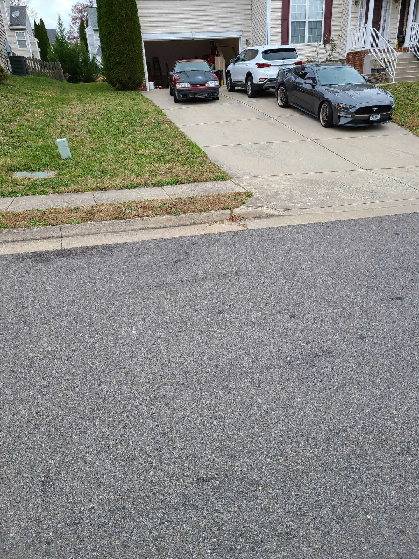

The coilovers ride beautifully so far. Ended up raising them up to 5.5 inches. That actually raised the front about 3/4 inch at the bumper. No more scraping in and out the driveway.

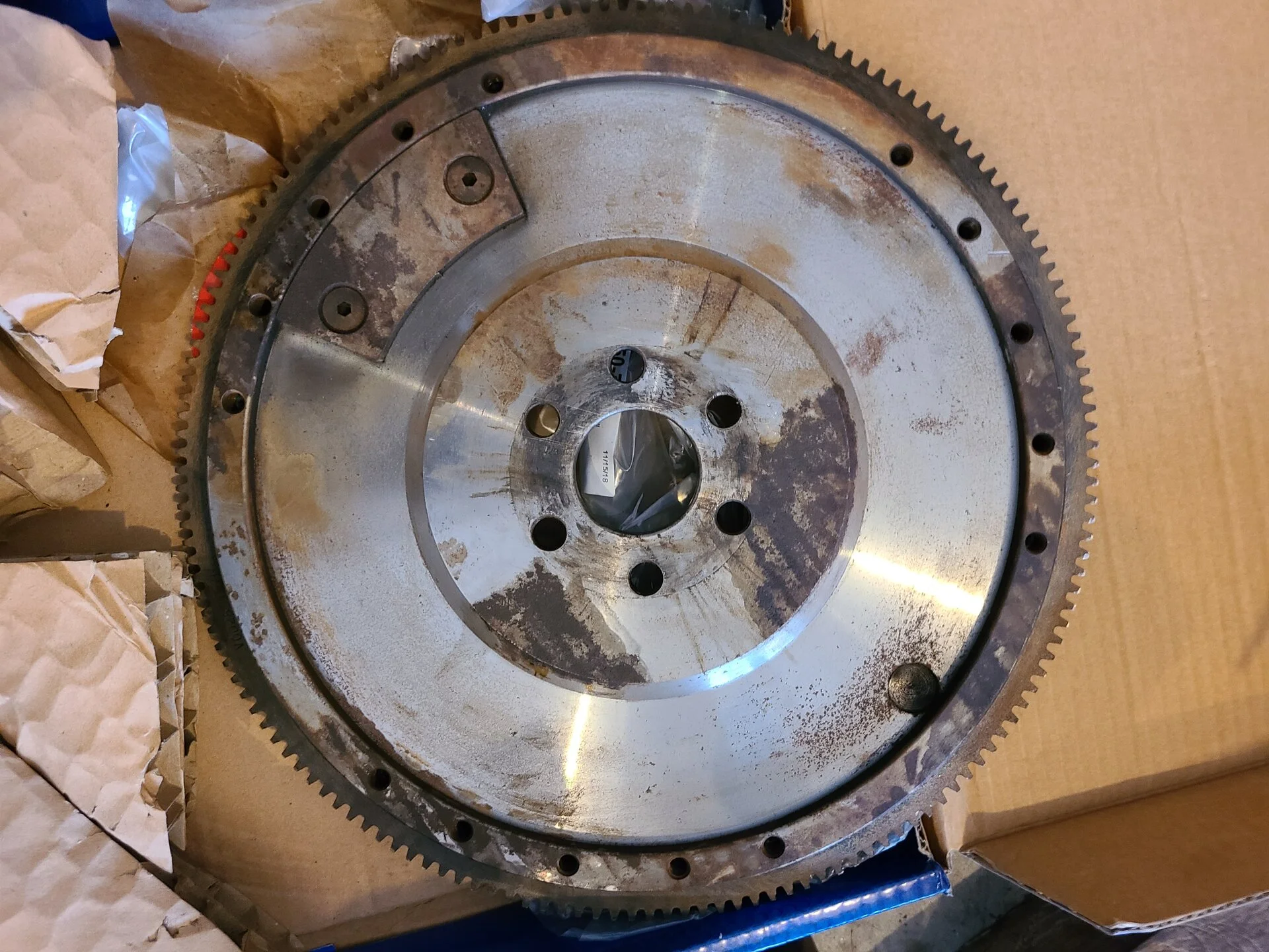

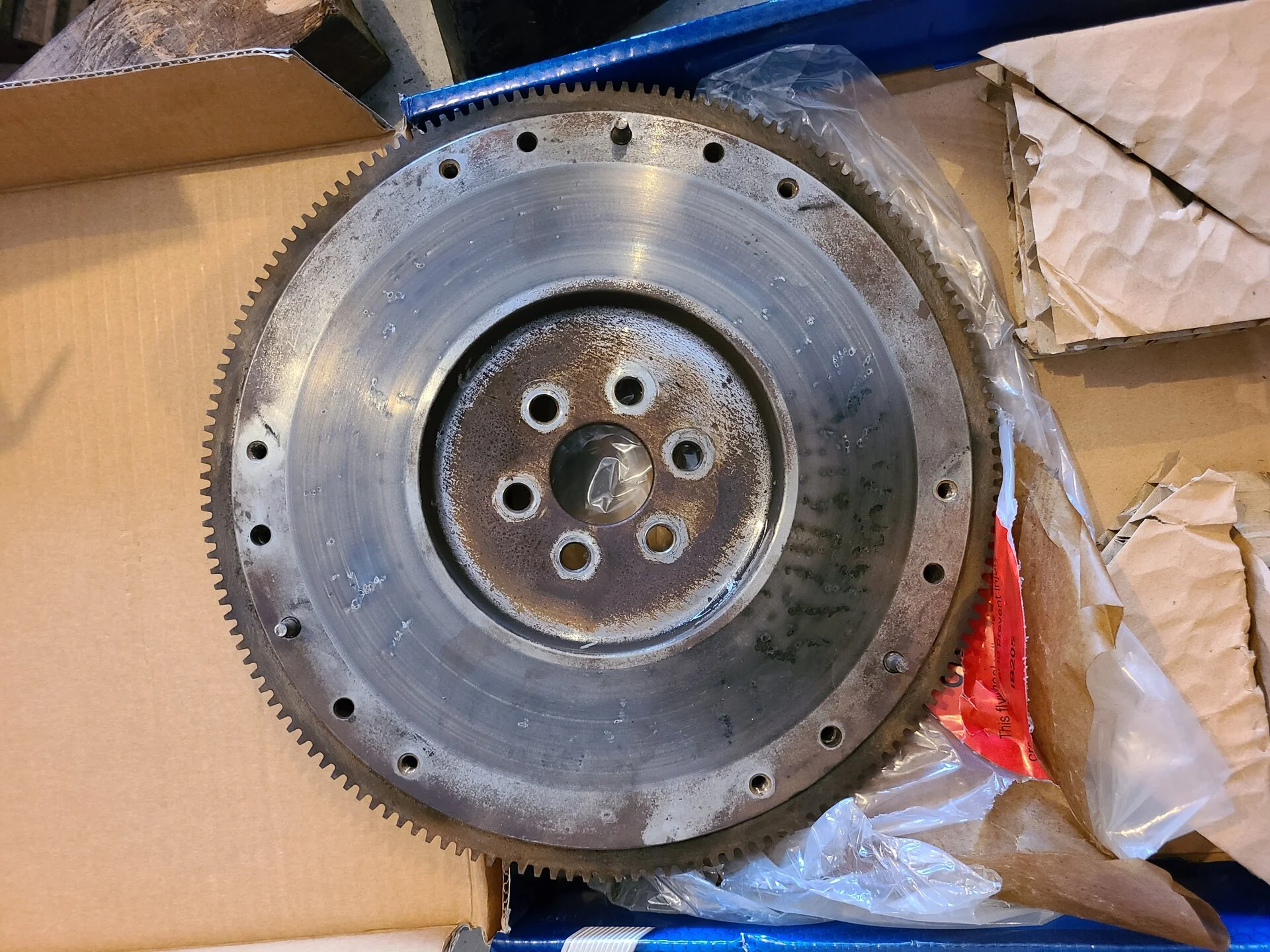

The damn flywheel vibrates its arse off. As soon as rpms rise the vibration kicks in like its trying to shake your teeth out. I took a gamble on a Carquest branded one for a 87 to 93 mustang. Its supposed to be 50 ounce balanced. In actuality I have no idea what the balance is on the old billet steel one. I should've just taken it to the machine shop and got it surfaced. Now I have the fine joy of having to remove the transmission again.
This thing will be resurfaced if they can save it. I'd hate to order another one.

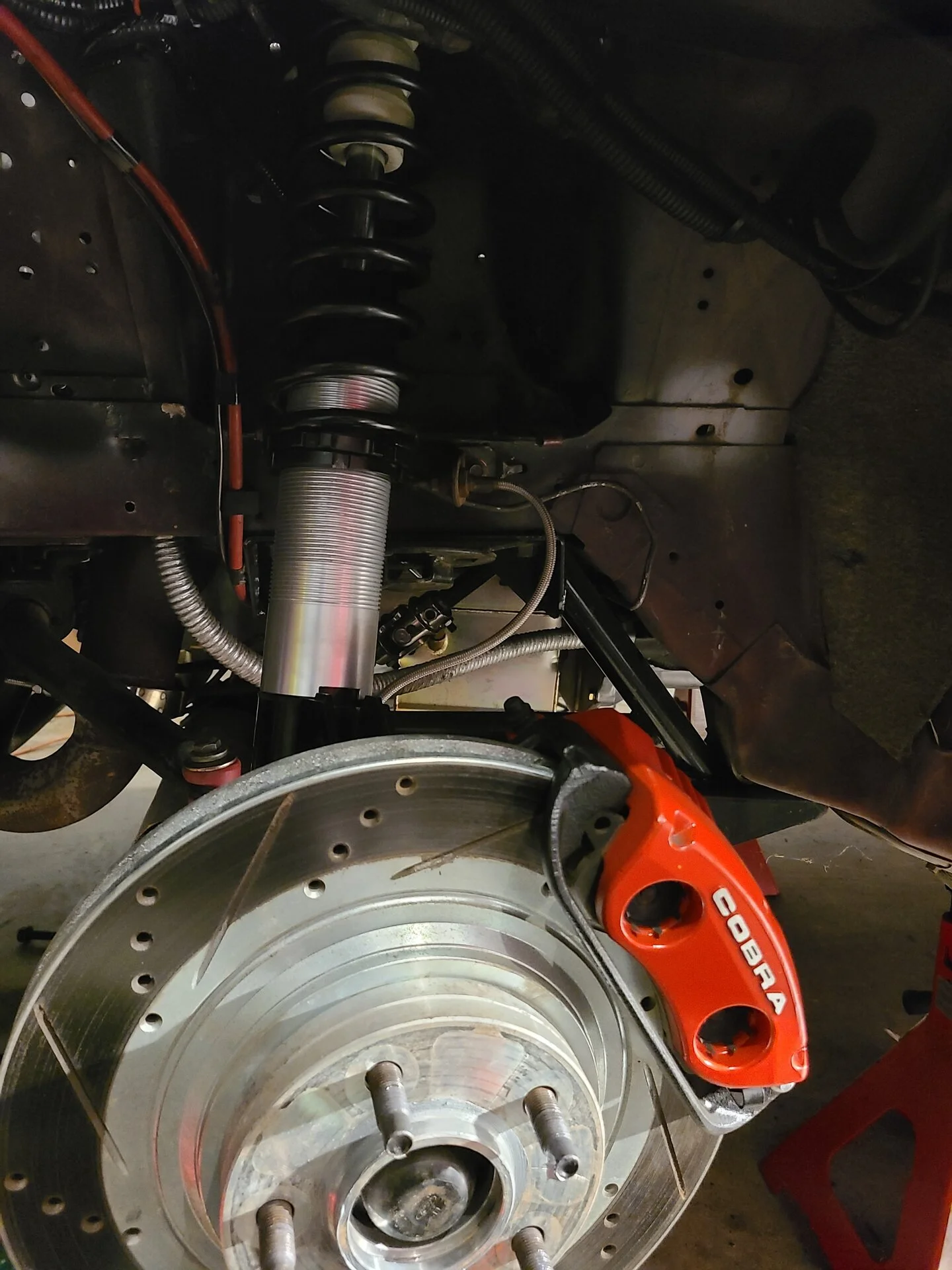

These are the sides the paperwork from the manufacturer said to put them on. Seemed weird to me at the time...but they said to do it this way so...
Everything you read will tell you the opposite.
As the rotors turn forward the grooved slots act like wind vanes, to direct air into and under the pads..the way you have them serve no purpose.
