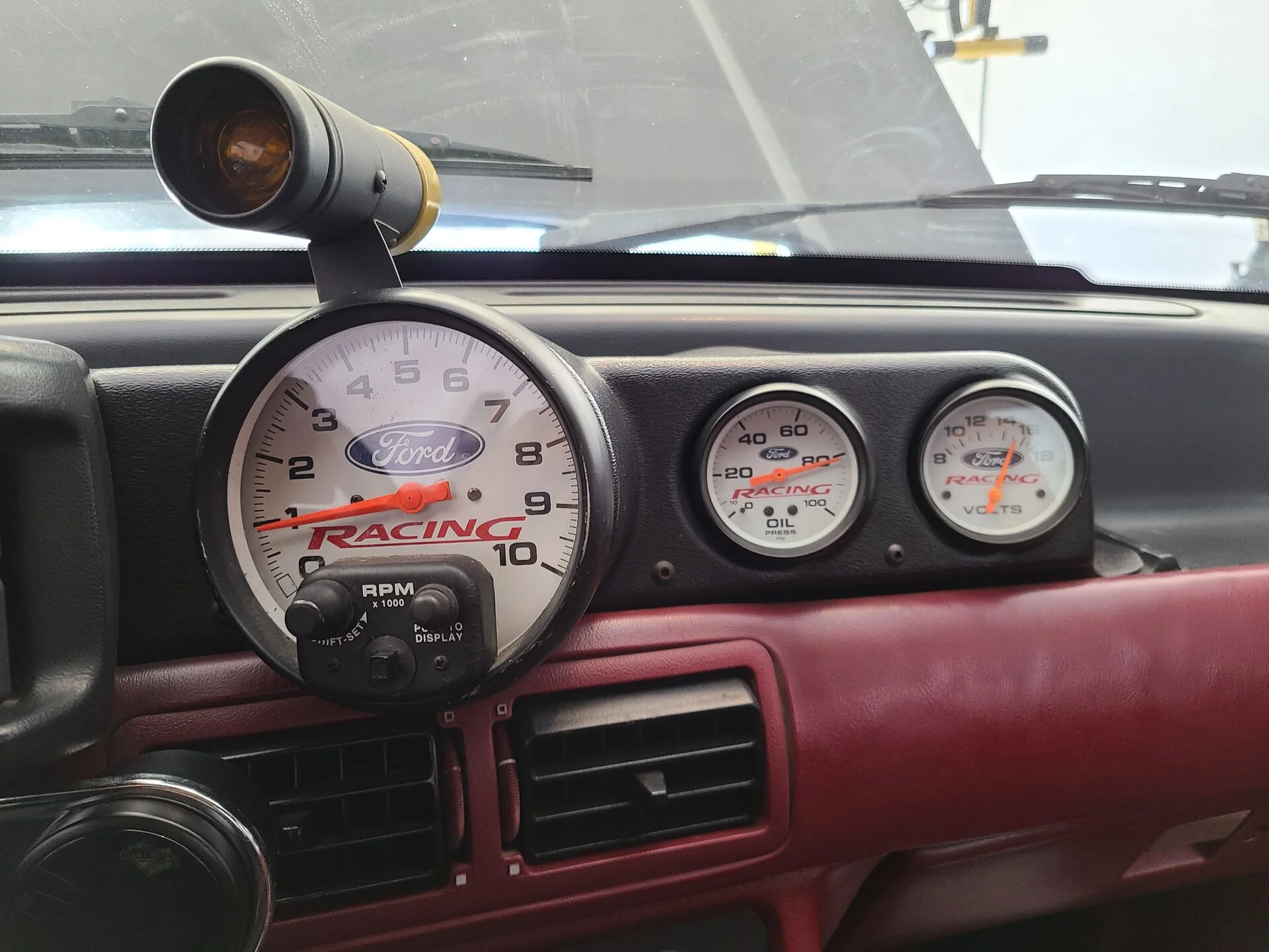

The tach works !!! Fired the car up and the Ford Racing tach works.

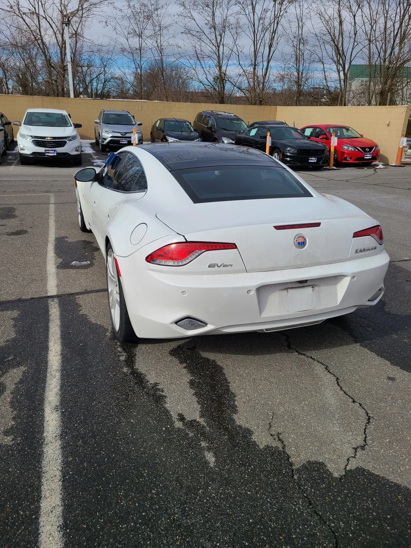

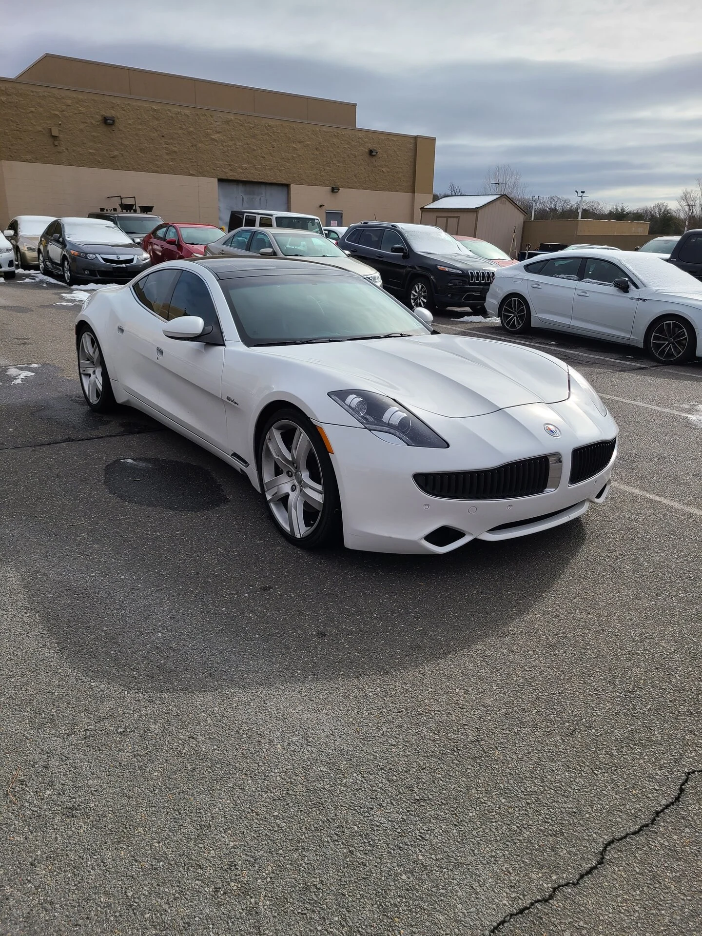

The things we come across at work. What the heck is this.... Fisker EVer KARMA ???
I Googled it. It has a 2.0 GM ecotech engine ( ew !!! ) and the roof is one big solar panel for the hybrid system.
And being a trade-in at Carmax it'll be off to wholesale soon.
That's Bob Lutz's latest misadventure. After bankrupting Exide and GM, helping preside over Chrysler's sale to Mercedes, and being fired by Ford over Merkur, that's the latest work of the so-called "guru of the auto industry".

The Lucid Air looks like a Dodge Charger made love to a Hyundai Azera. :crazy:
The Fisker Karma is a gorgeous machine though.
@90sickfox , the "EVer" stands for "electric vehicle, extended range".
On the short list of things I miss about my time at a Carmax production store is all the crazy and wonderful stuff I got to see in wholesale. Various Lotuses, a few Lambos, several Hellcat cars, Vipers, the rare classic (including a '72 Ford Courier I got screwed out the chance to buy by a salesperson)... Hell, I bought my 4Runner out of Carmax wholesale, and it's been my best vehicle purchase out of about twenty over the last twenty years.
