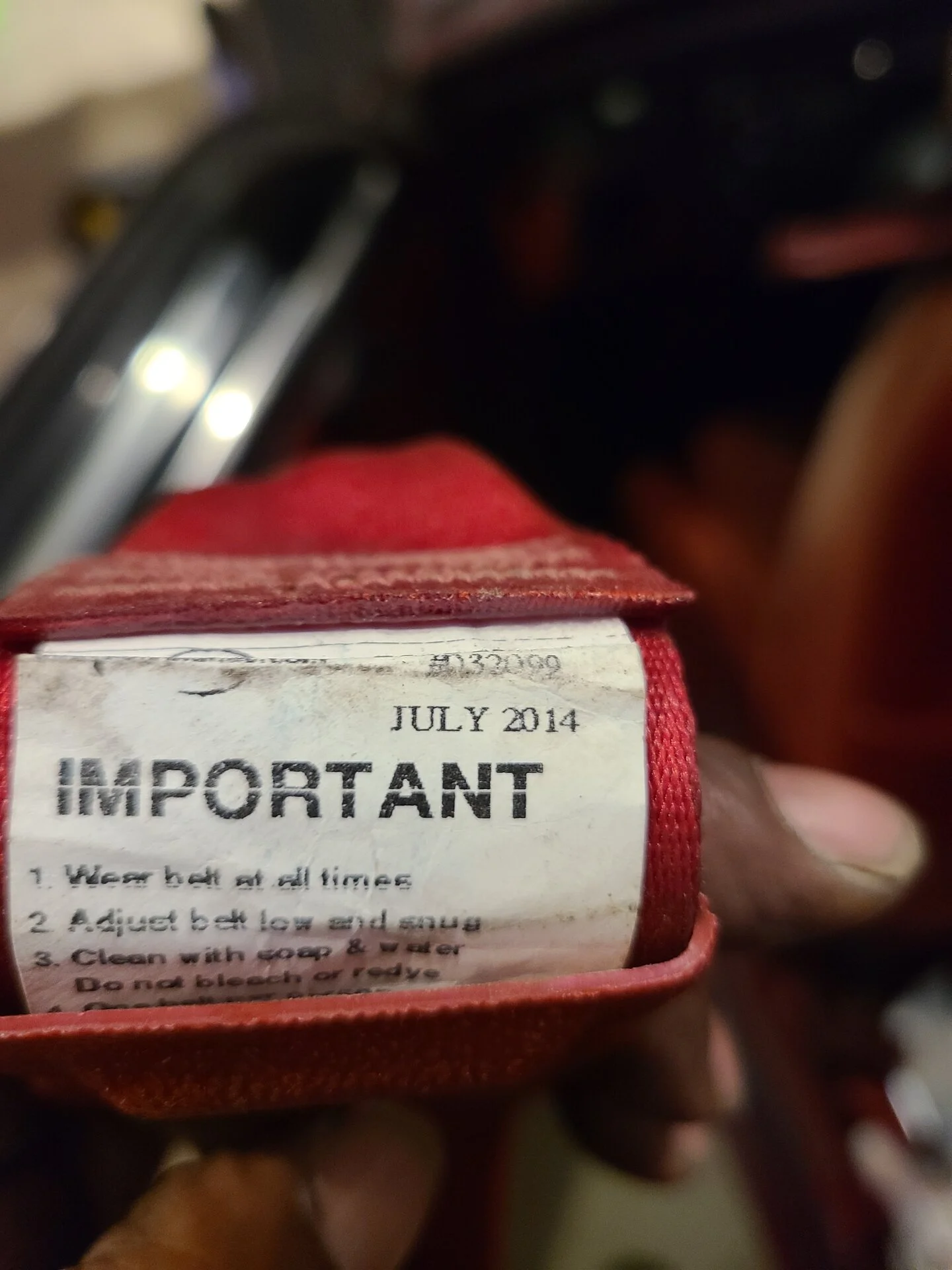

Some picture updates...

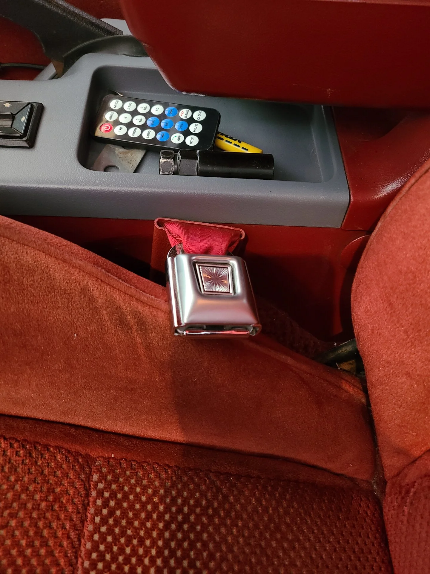

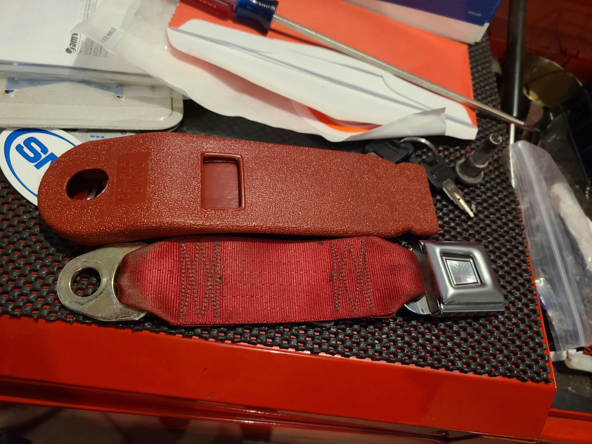

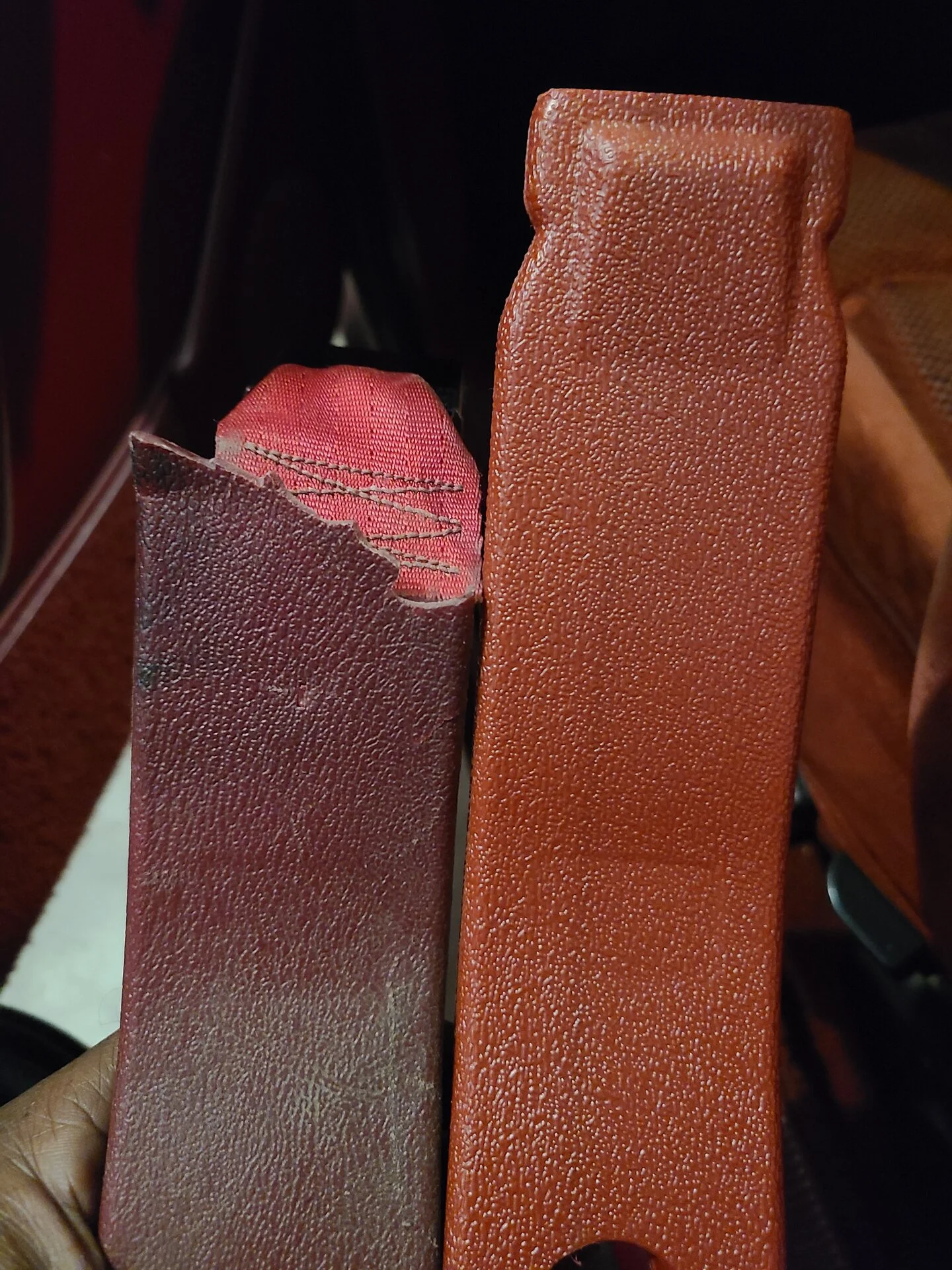

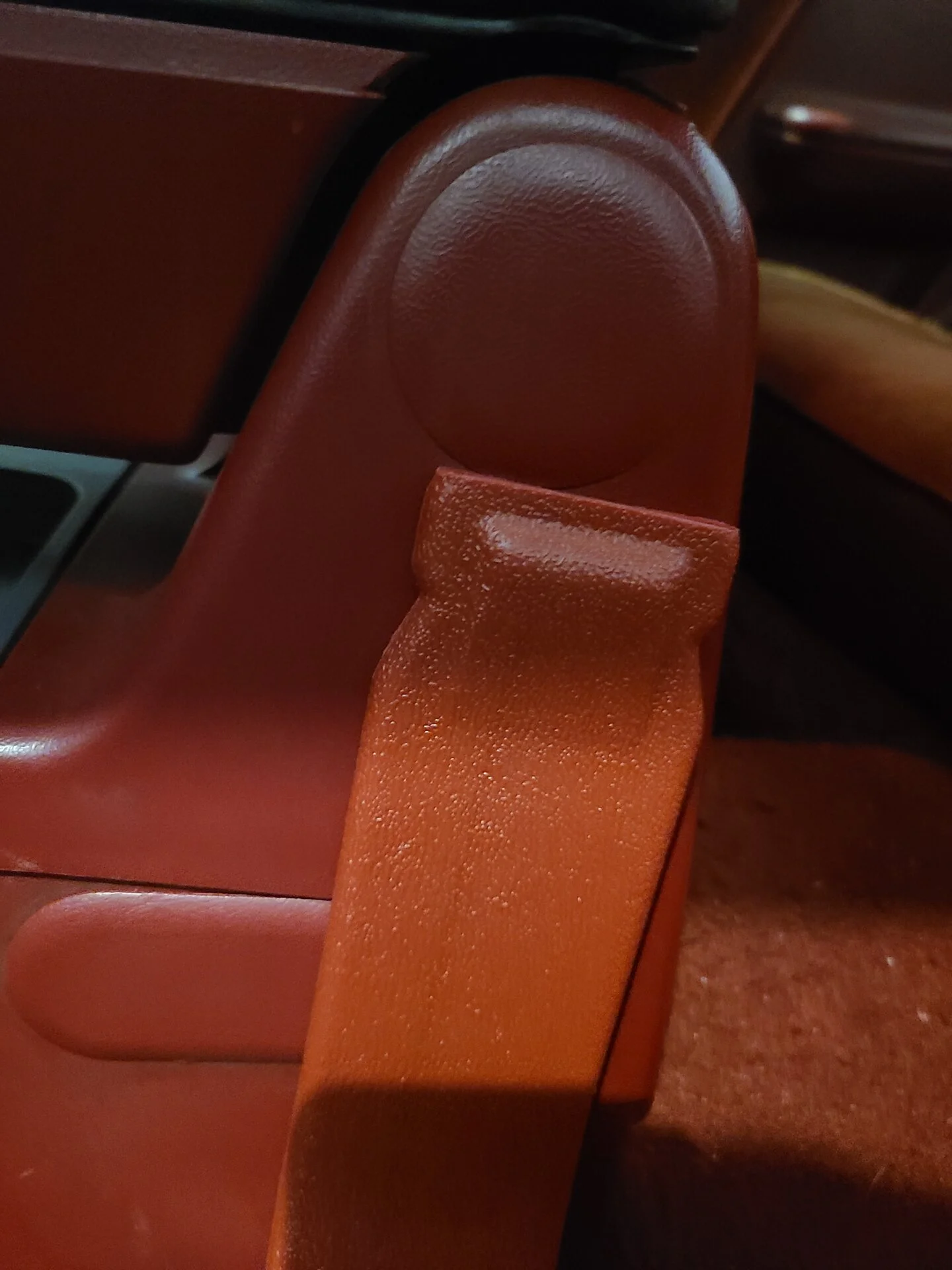

Found out my seat belts latches are shorter than the originals and wouldn't fit in the sleeve. They were replaced after 2014 according to this tag.
This is the color difference with NPD.
Comparison.
I marked and cut them down...good thing they weren't good OEM ones. Now they look a lot better. I'm going to paint my center console when it warms up in the spring, don't worry.

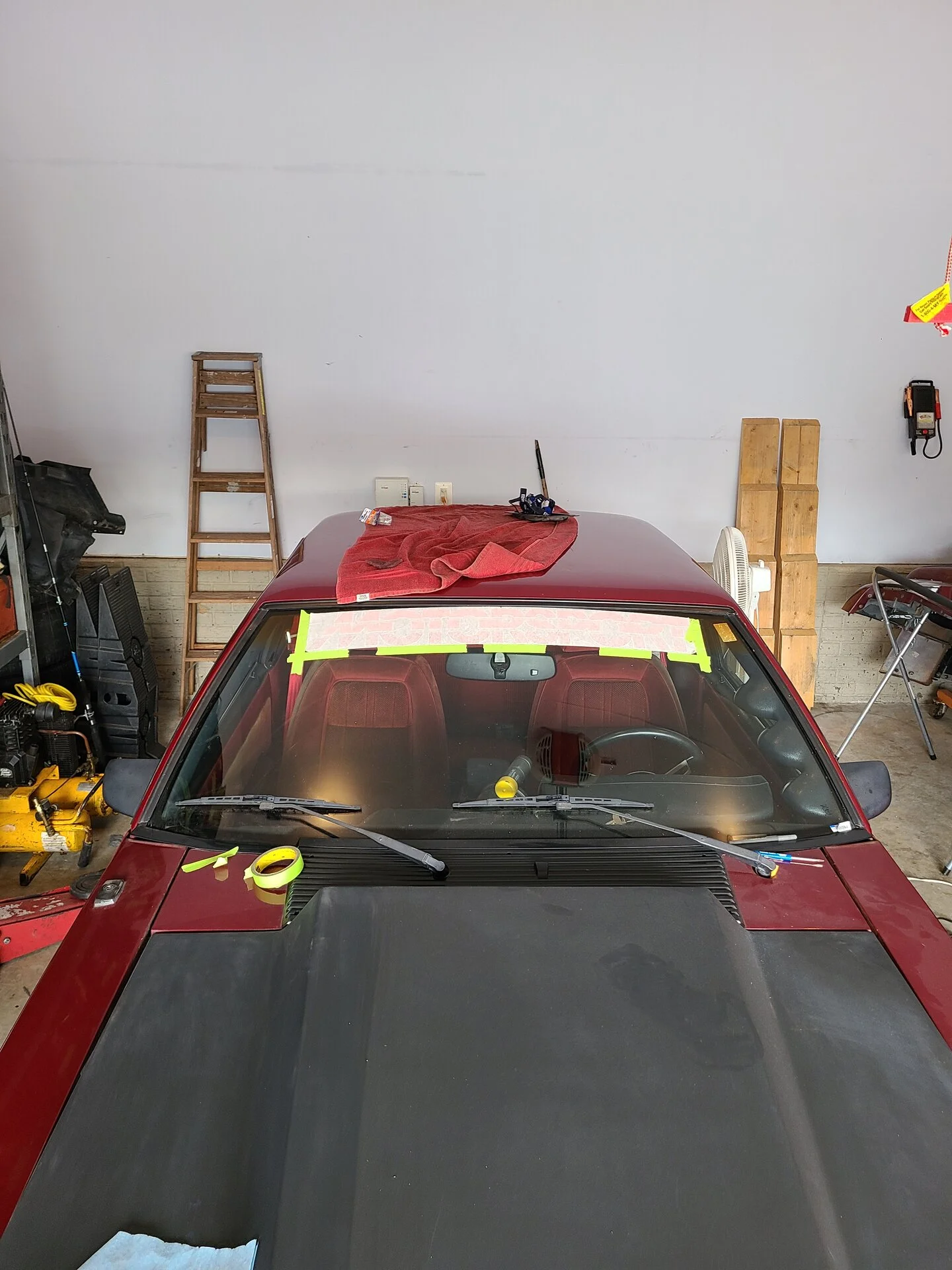

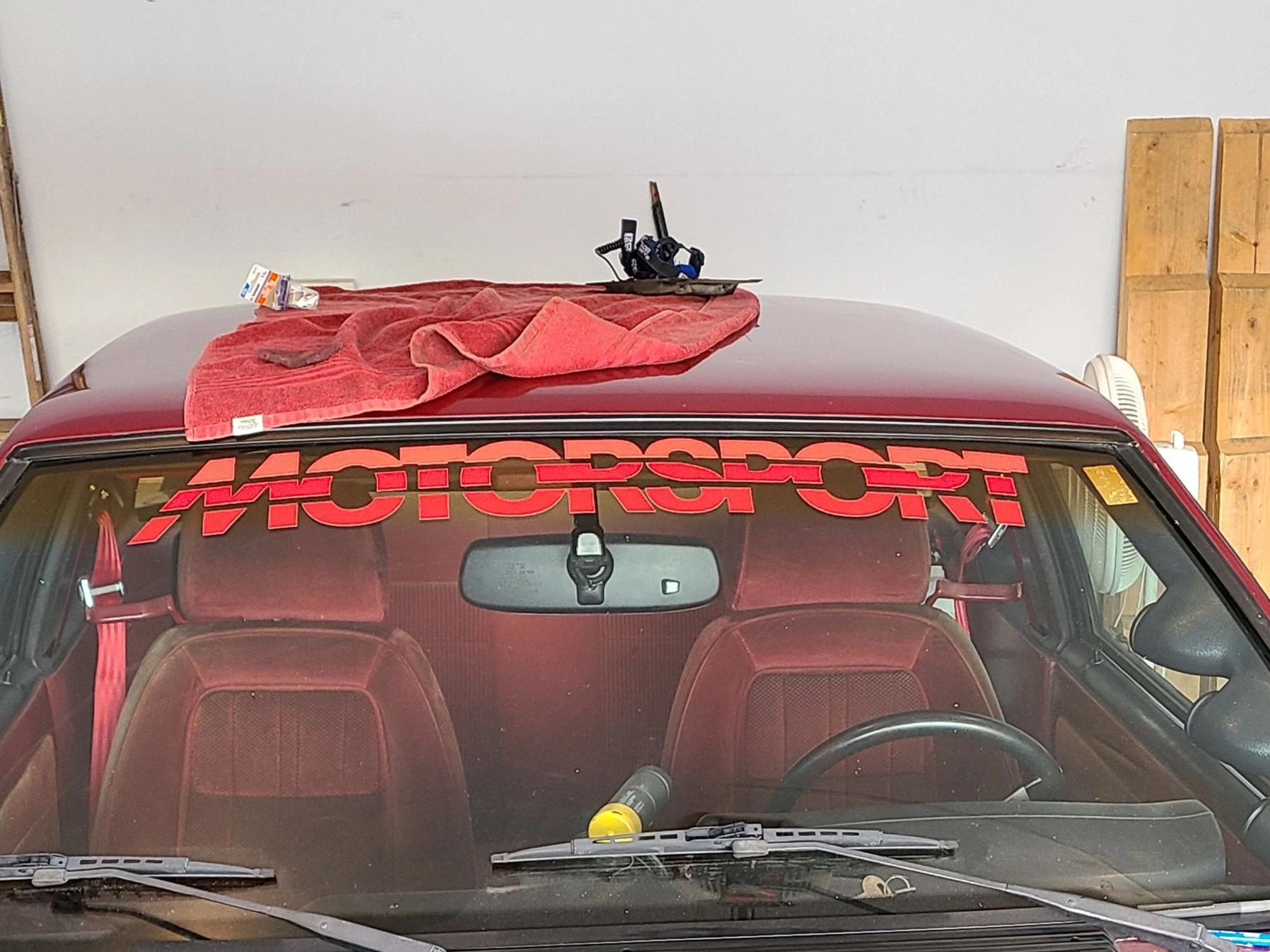

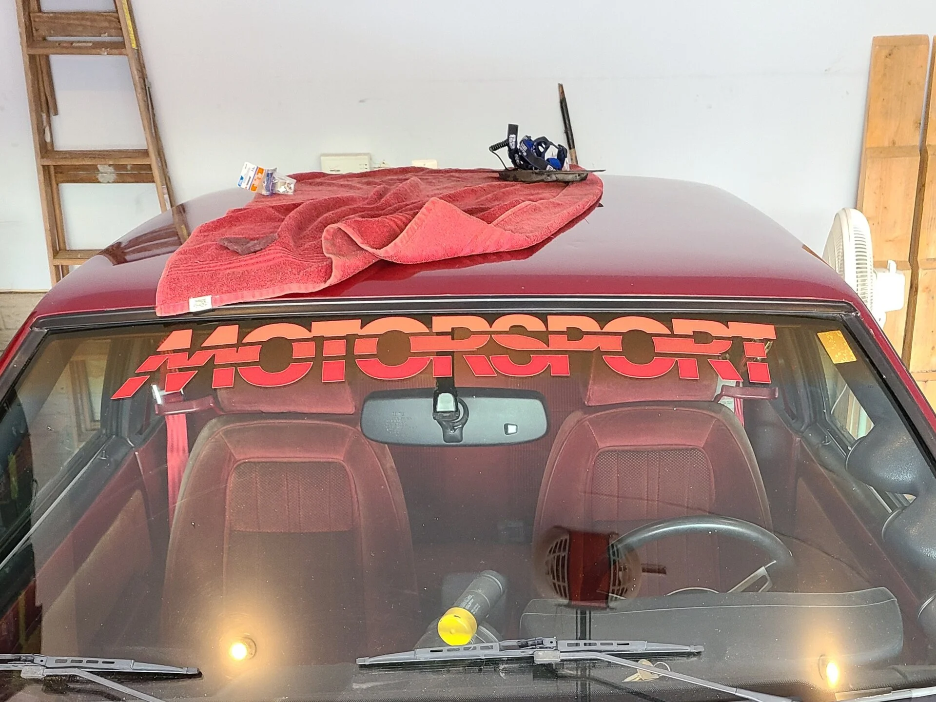

The banner came out OK. It'll look better in the sun. Called the ol' lady out and had her give me opinions on placement. She wasn't a fan of the back window.
Taped it down, measured, and layed out placement.
The bottom line of red is darker than in the pic. Heres an example of what the camera lens does. No way to get a good color representation.
It's almost like a reflective color. I like it though. Needs a tint strip behind it.

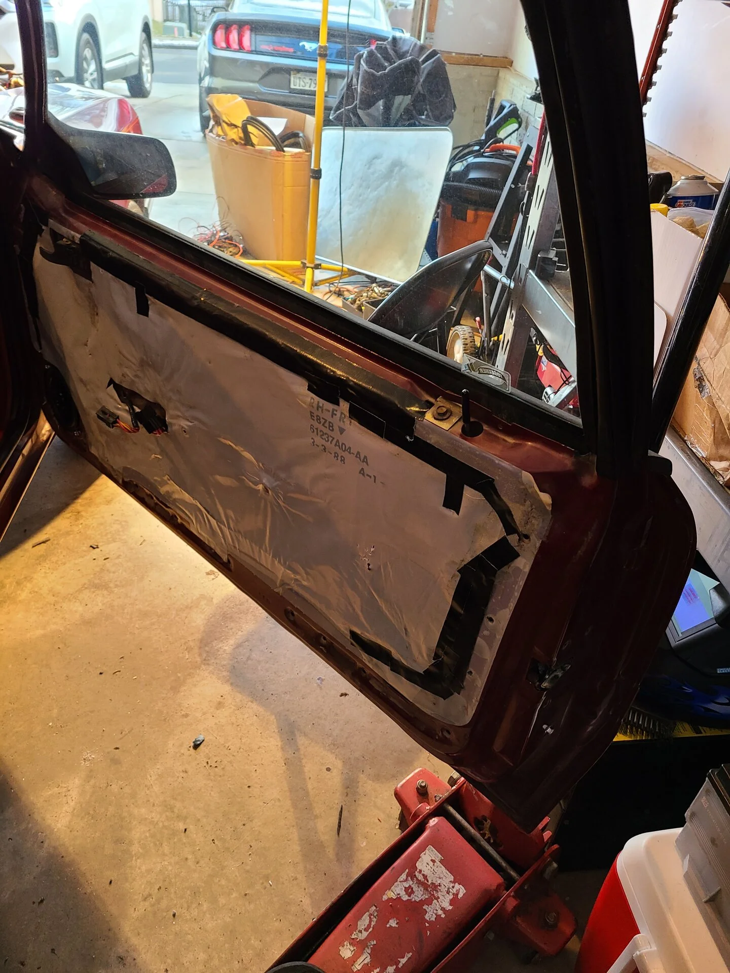

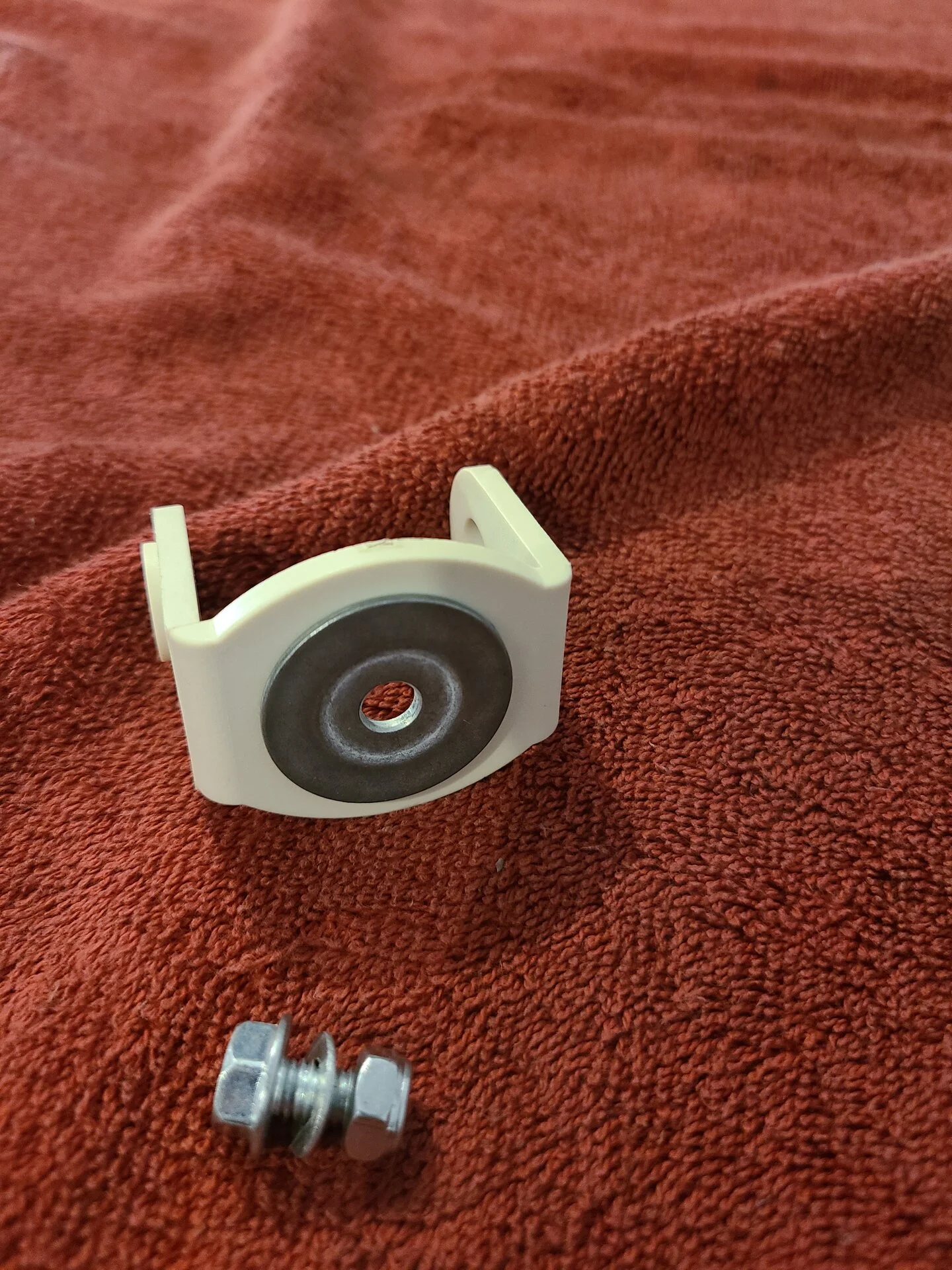

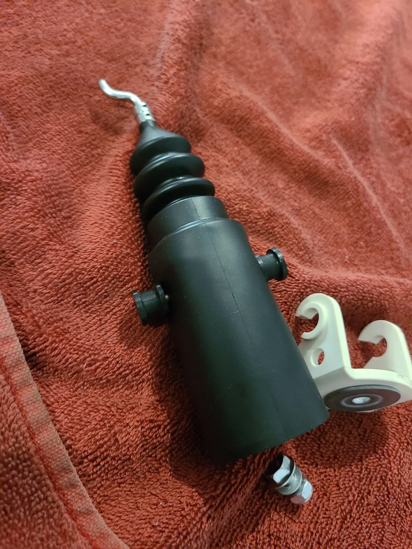

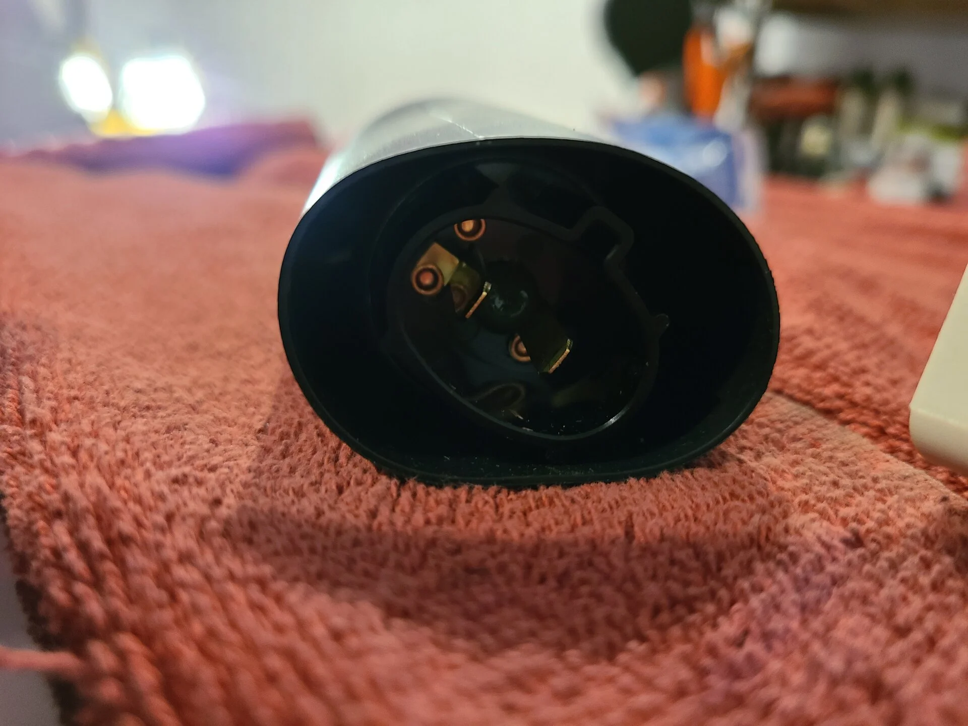

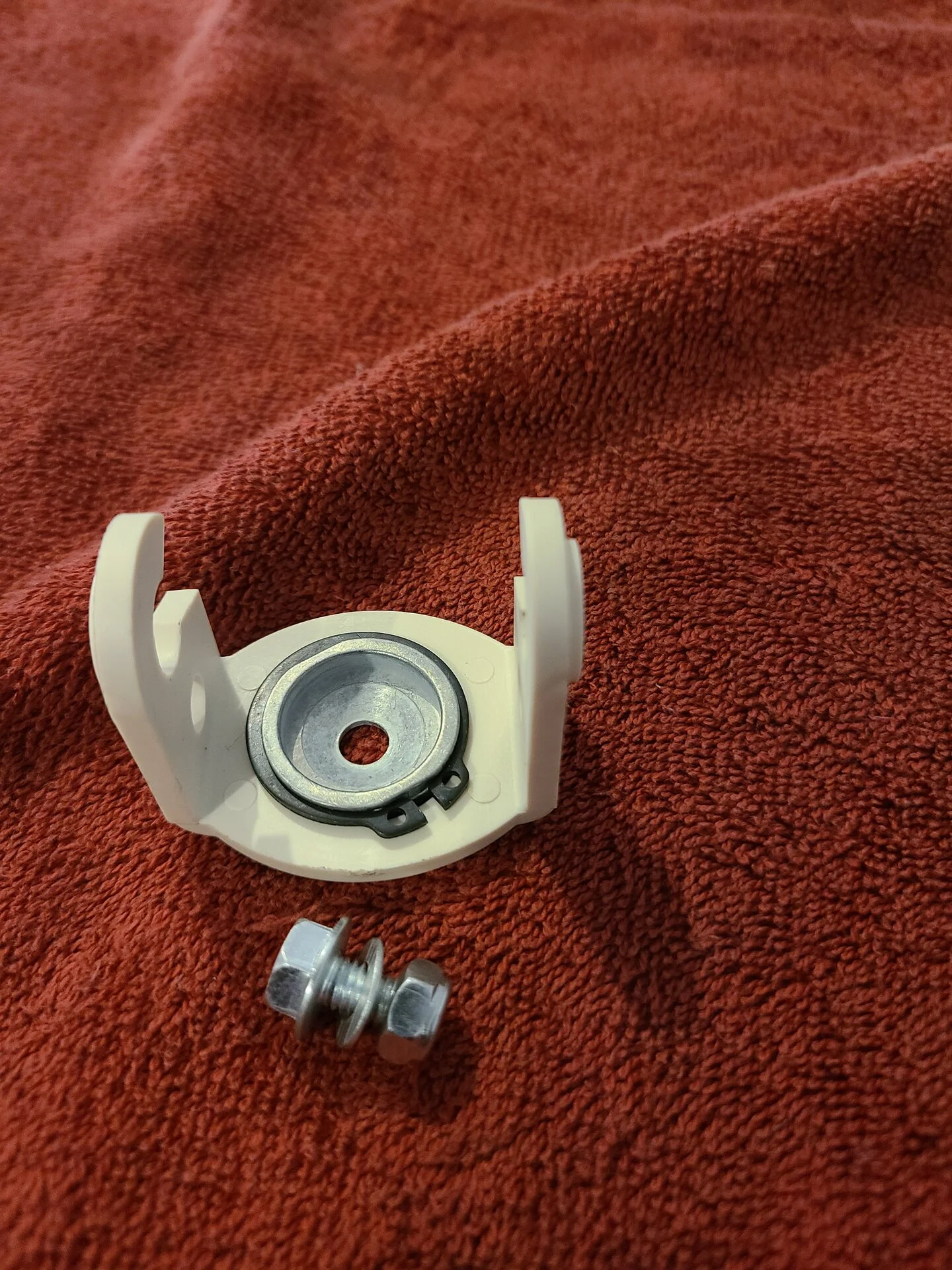

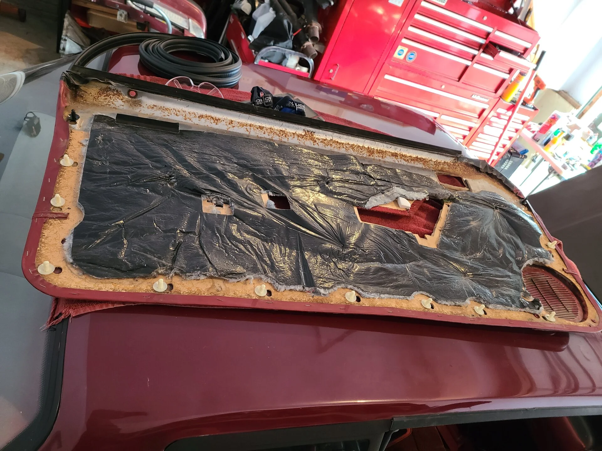

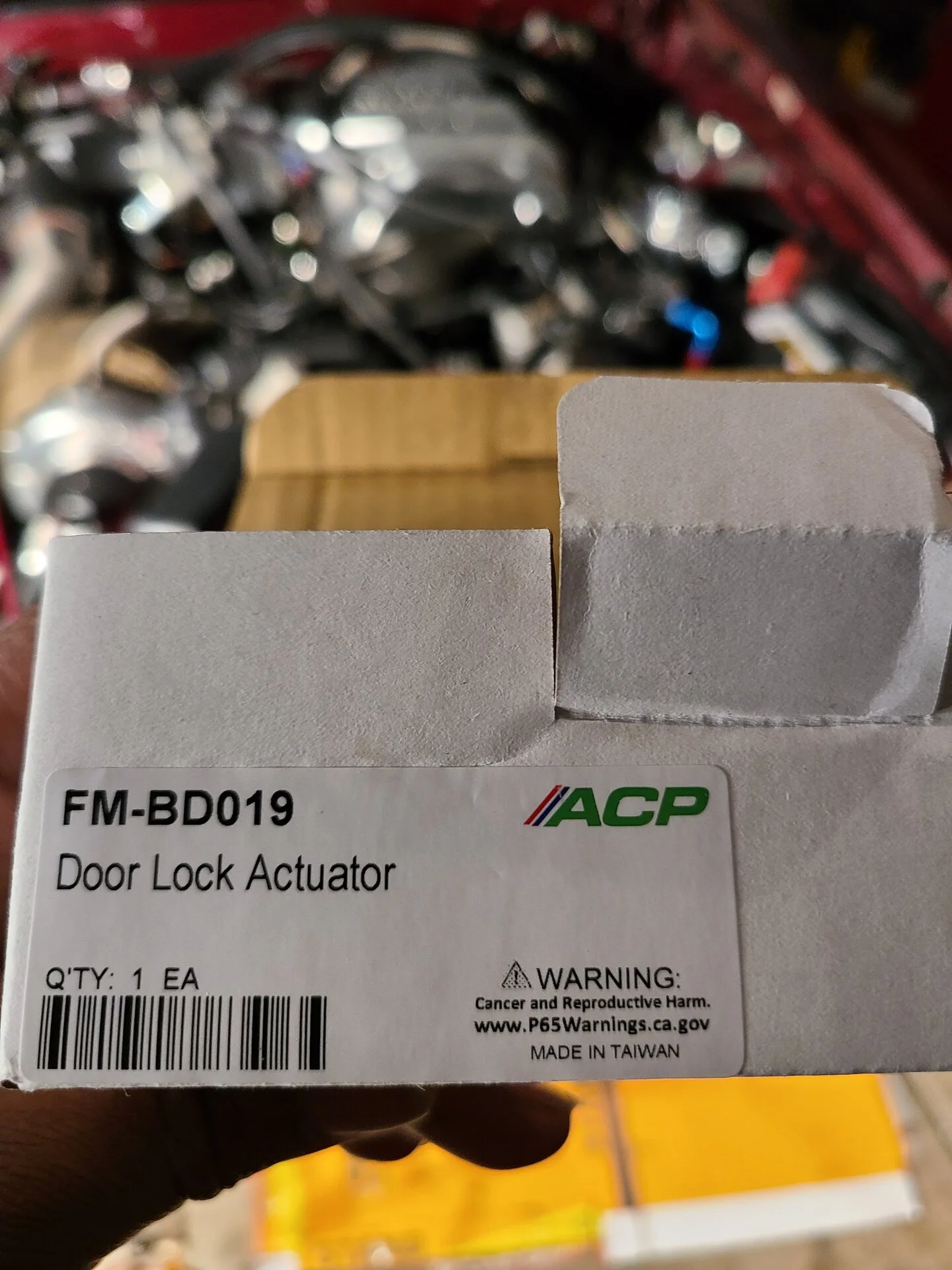

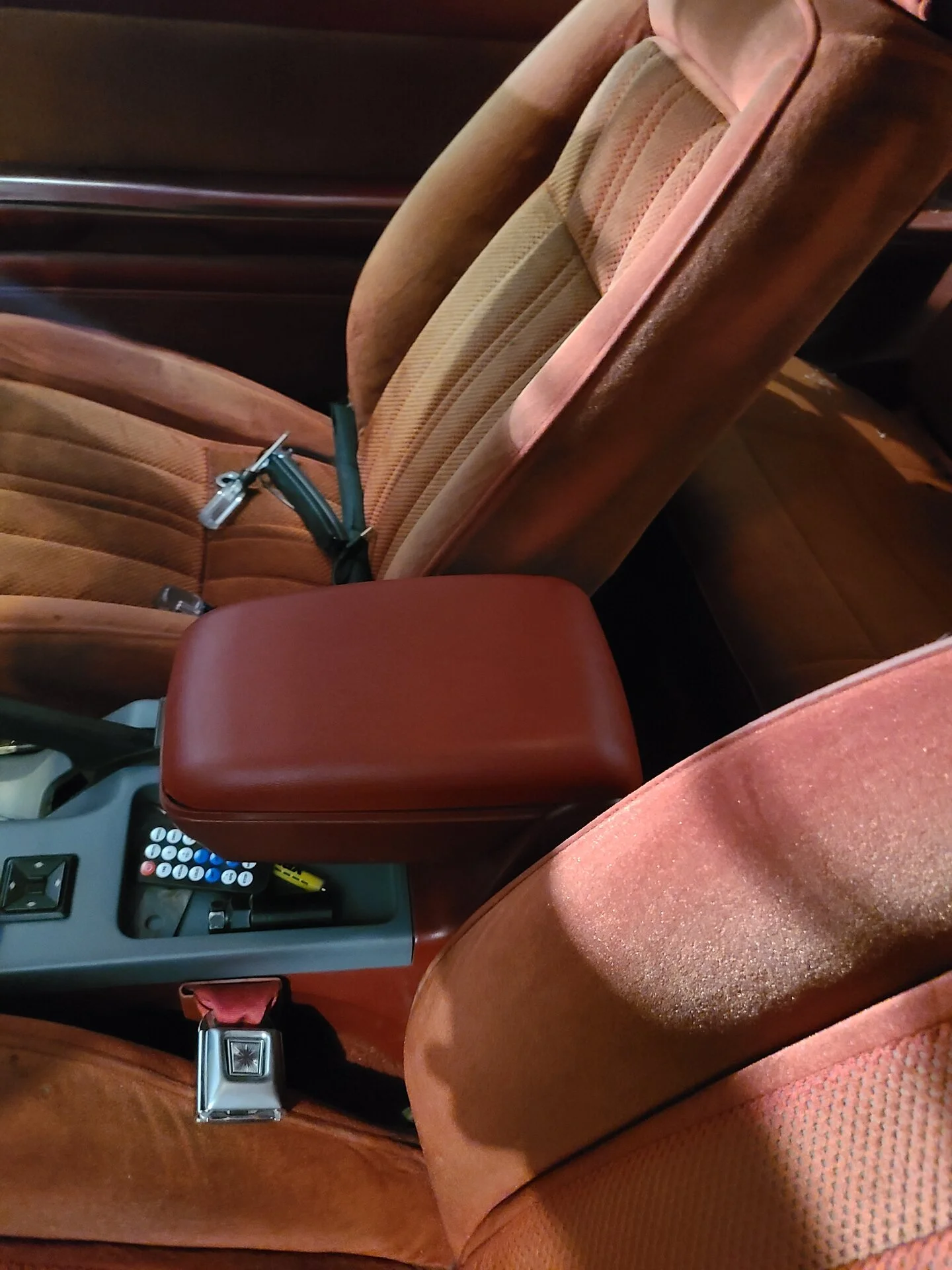

Had a moment to escape to the garage. The new actuators are amazing from LMR. I'll update with some pics of those. Very good quality and strong working mechanism. I didn't rivet them on. Instead, I chose to bolt them. My moisture barrier was all kids of screwed up. Previous owner had used duct tape and masking tape to try and secure it. I removed that stuff and gorilla taped it together. No one will see it behind the panel. I replaced all of the clips and I'm satisfied with the result.
It's amazing this stuff is even still on the car after 340,000+ miles. I'll be replacing the door armrest and chrome trim soon. The new console armrest pad from LMR fits perfect. Its a hair lighter than my original interior but is close enough to no matter. My interior plastics all seem to be a little darker than normal. I think the PO spent a lot of time smoking in the car or something in the past. Doesn't smell like it but stuff is definitely darker....I think the quarter panel plastic has been repainted at some point. I'll fix'er up though.

These actuators are very well made from ACP through LMR. They aren't the old Dorman ones that have plagued people with issues for years.
Very nice powerful actuator. I was worried about them being Dorman and was willing to take the chance. I'm very pleased with what I got.

Oh and the center console elbow pad that fits great and used the factory screws !!! The one from NPD was almost 1/4 inch narrower and sucked arse.

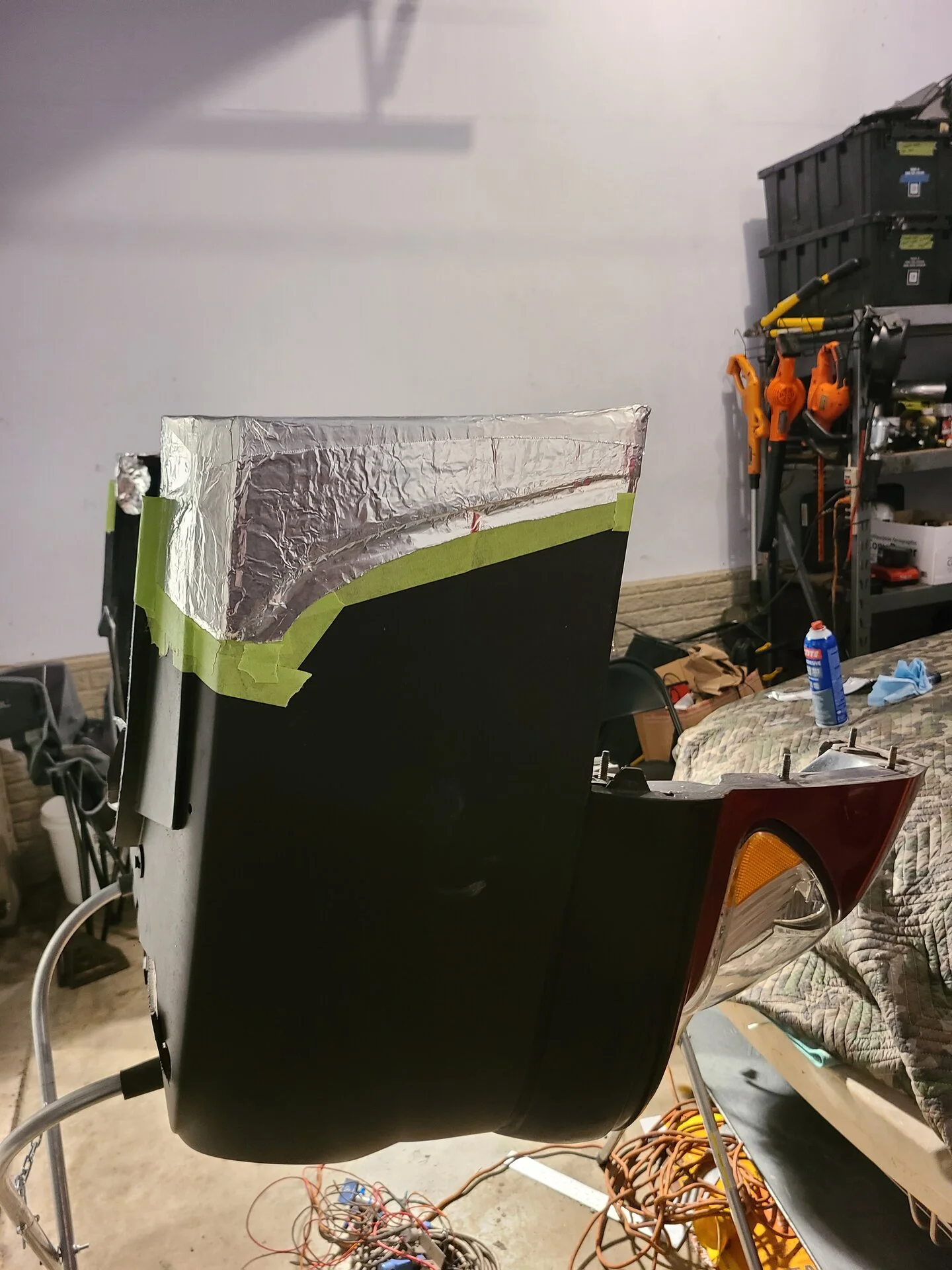

Working on the front bumper now. My driveway is a hill and the front bumper contacted the transition between the asphalt and the concrete. 3m8115 with the drywall mesh failed and opened the crack from my bush surfing incident at Walmart again. I know I'm going to have to buy another cobra bumper and do the conversion again. I'm just trying to hold out until next winter.
I'm going to drill pock marks all over the inside and use some bumper repair epoxy and the same fiberglass drywall mesh as a reinforcement. The crack itself is holding with a general amount of gorilla super glue. Lol. I was going to do the hot staple thing but had time to mess around and haven't purchased one yet. If this attempt doesn't hold I'll order the hot staple kit and try that.

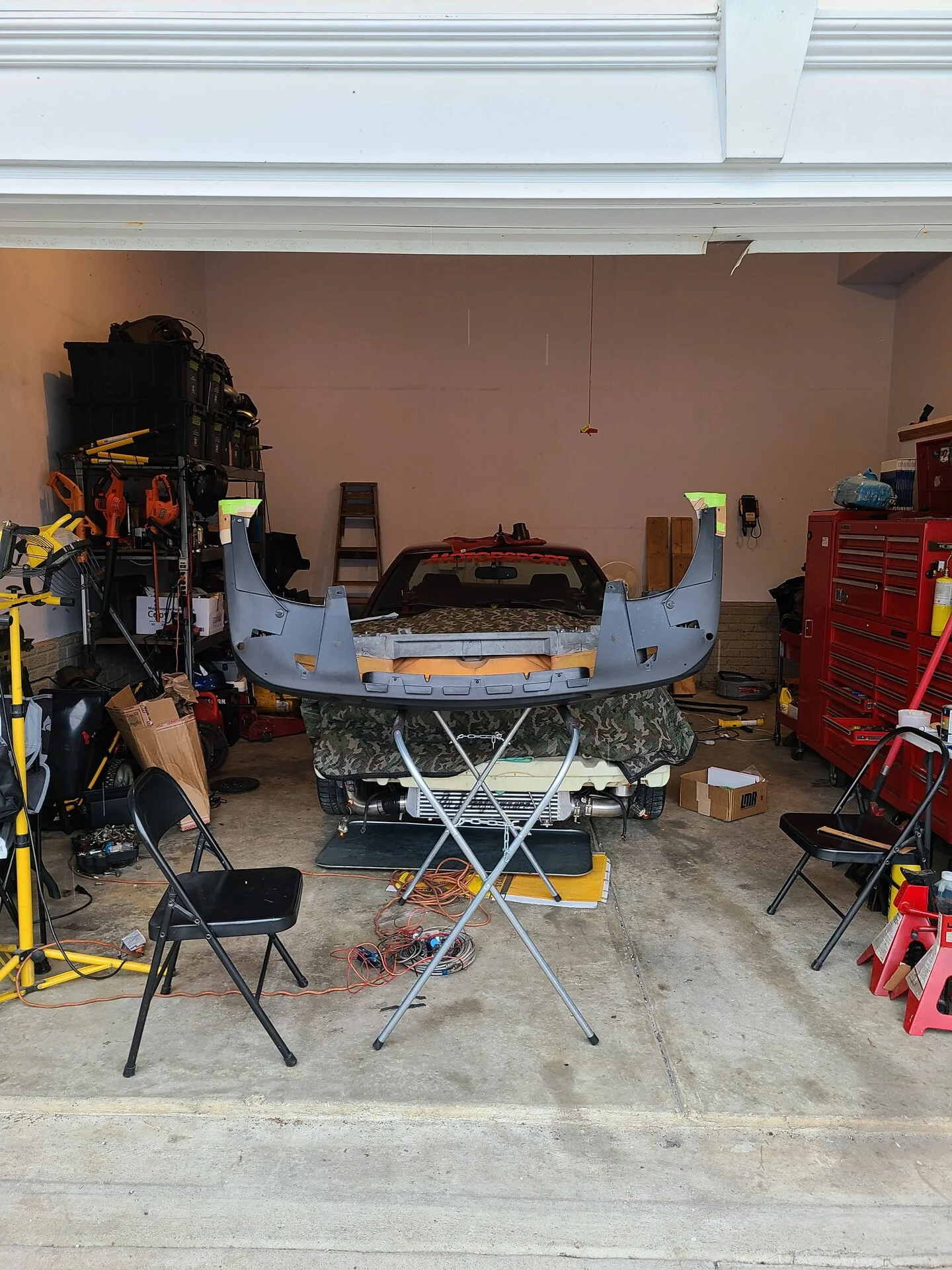

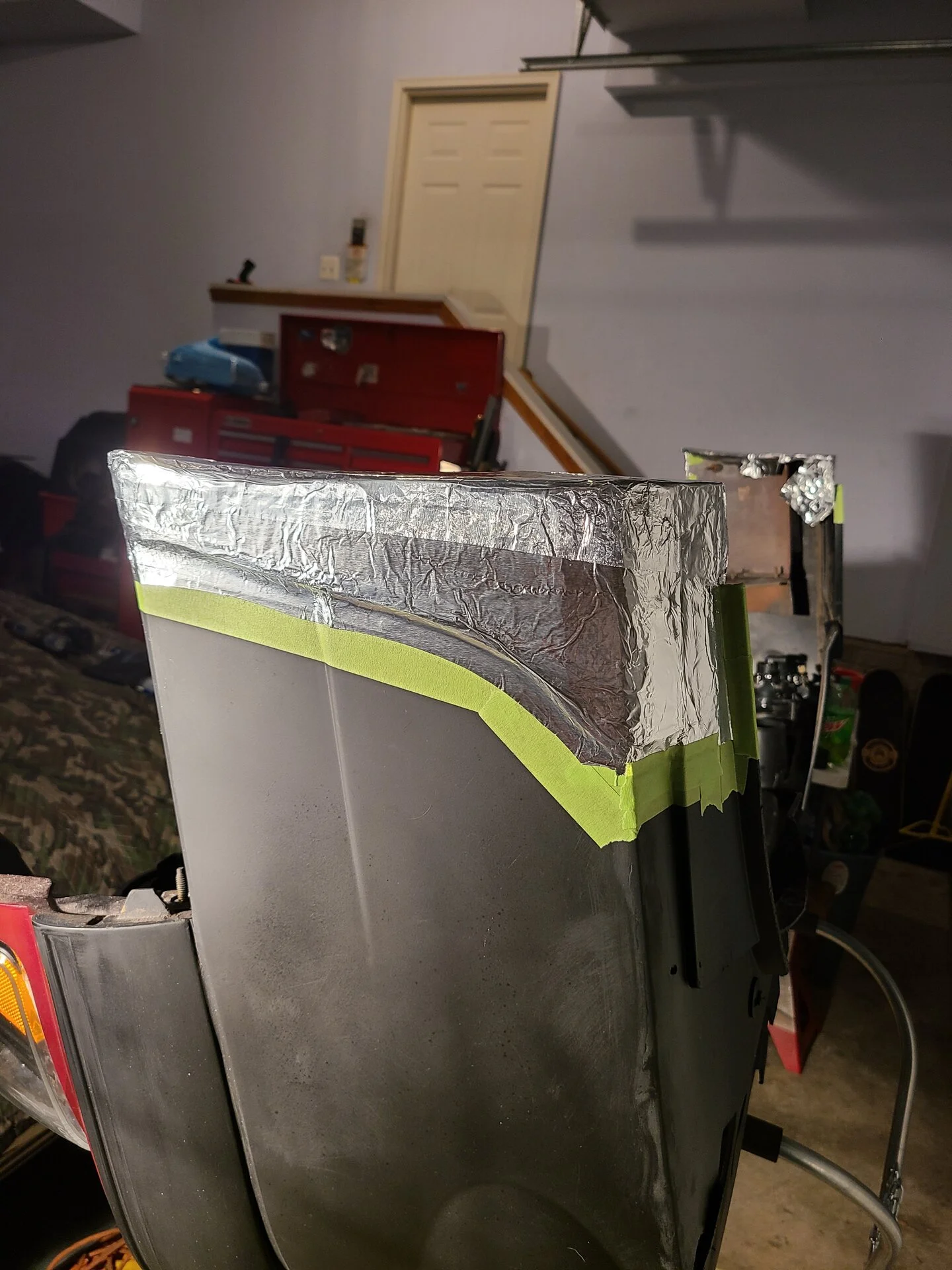

I've been trying all types of stuff to make the ends of the cobra bumper. On a 91- 93 there's no issue, but my car is a 88 so extensions have to be made. I tried spray foam ( used that a bunch way back in the days...but wouldn't work for this ), tried clay ( have done a bunch of mold making and such way back in the days...wouldn't work for this )...resorted to the tried and true cardboard templates and aluminum foil. Had to have the bumper off and a stand. Plus, I procrastinate and jump to other things.
Anyways, here's where I'm at. Gotta pick up more glass, resin, and activator tomorrow. Had less than I thought.
The garage is a mess....
Getting it done this time.
