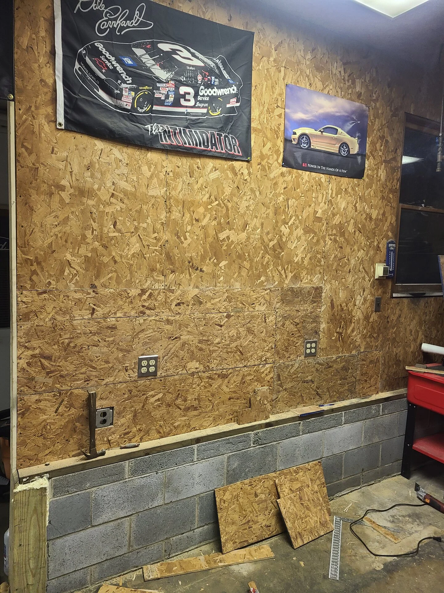

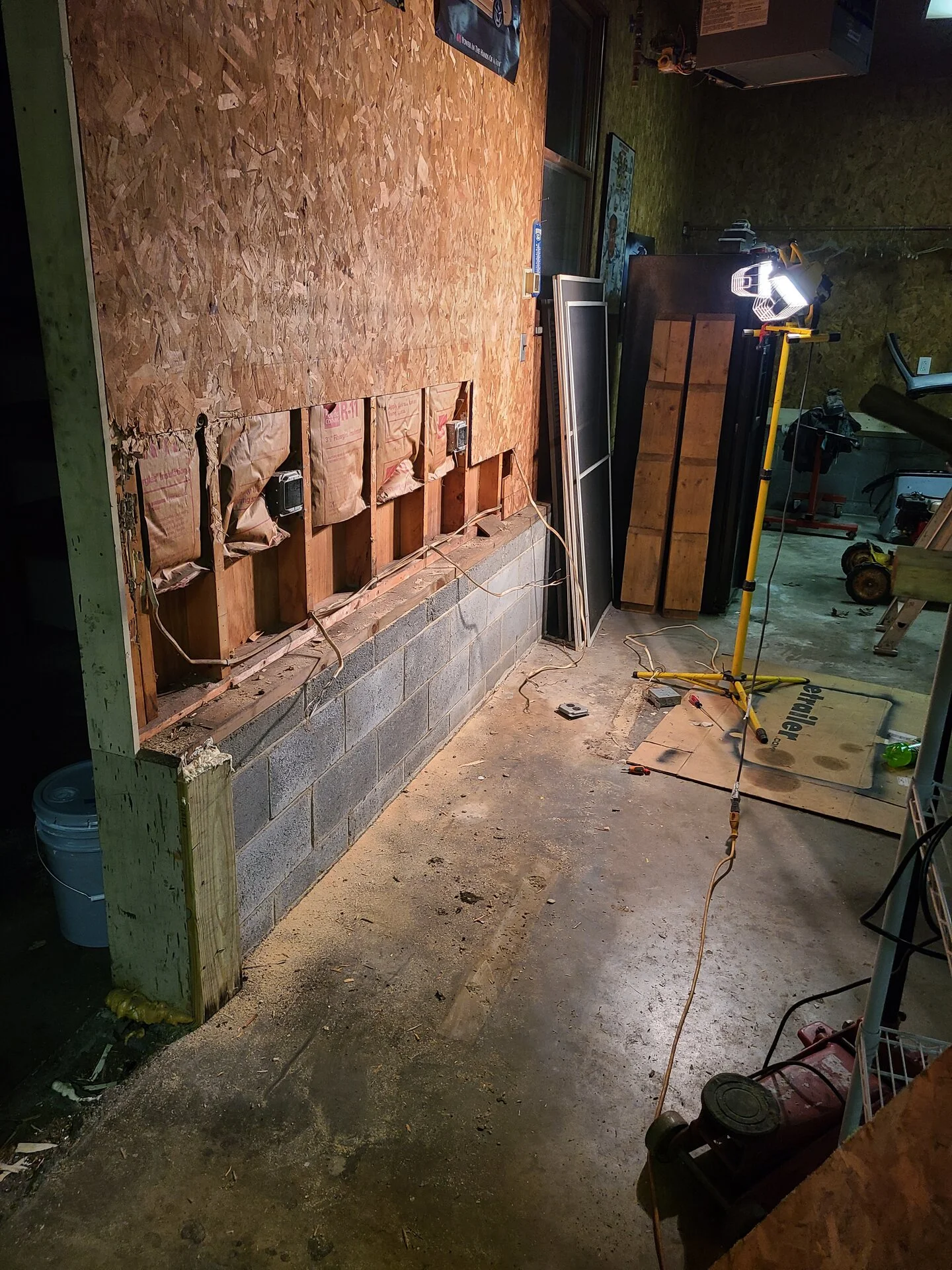

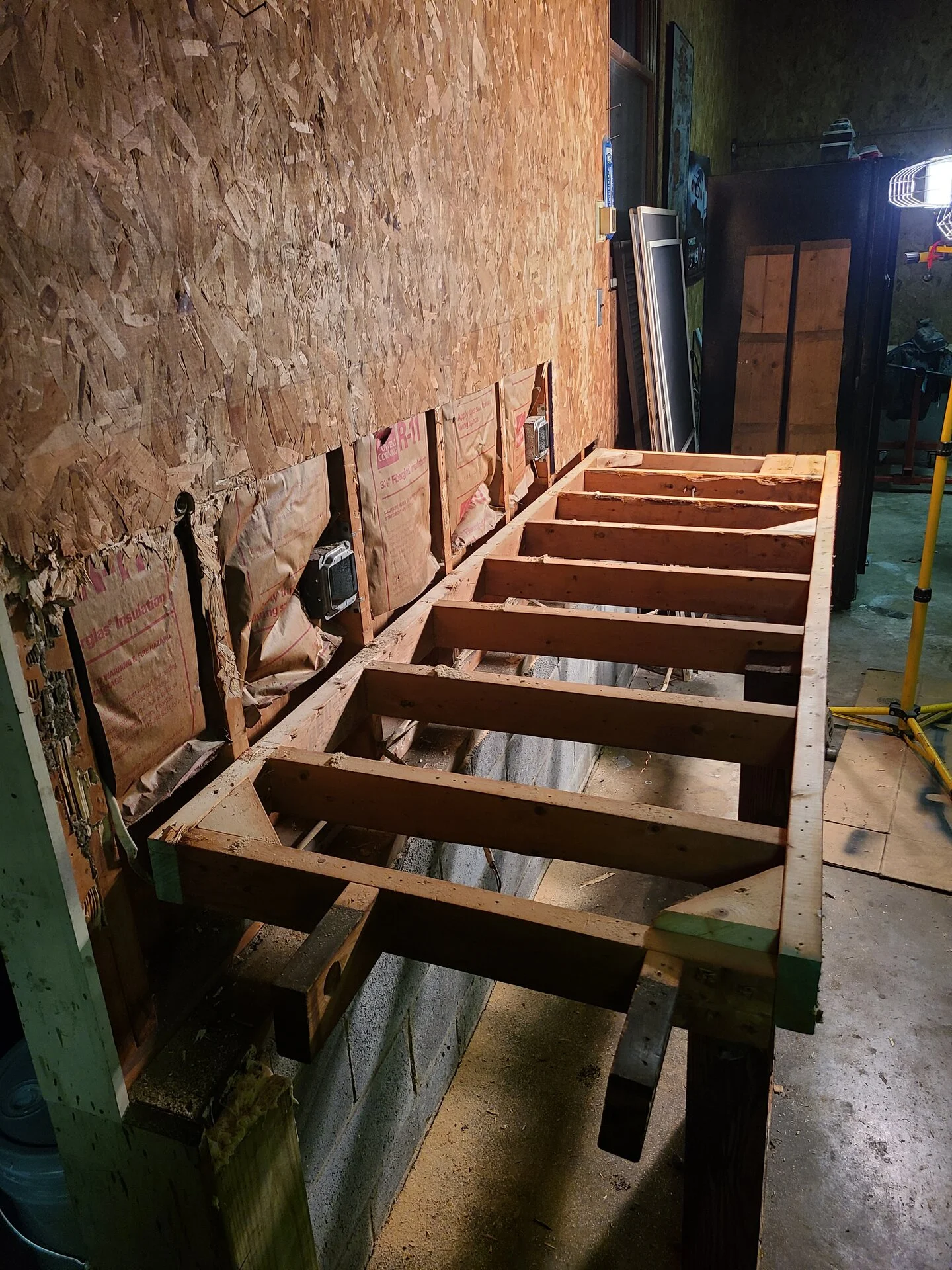

The previous owner built a work table that was designed to hold dump trucks. It was absolute hell getting torn down. I can't even explain the frustration. 200 screws and, atleast, 100 nails have come out of this thing. It's removed now though. Had to cut the wall because the top went back around the studs and had electrical running through it. He drilled 1/2 holes for the wires. The box clamp wouldn't pass through those holes. Out came the circular saw. Now I've got to make a junction box and drill through the studs so I can get everything neatly rebuilt.
This guy had a love affair with spray foam. I'll straighten all that out.

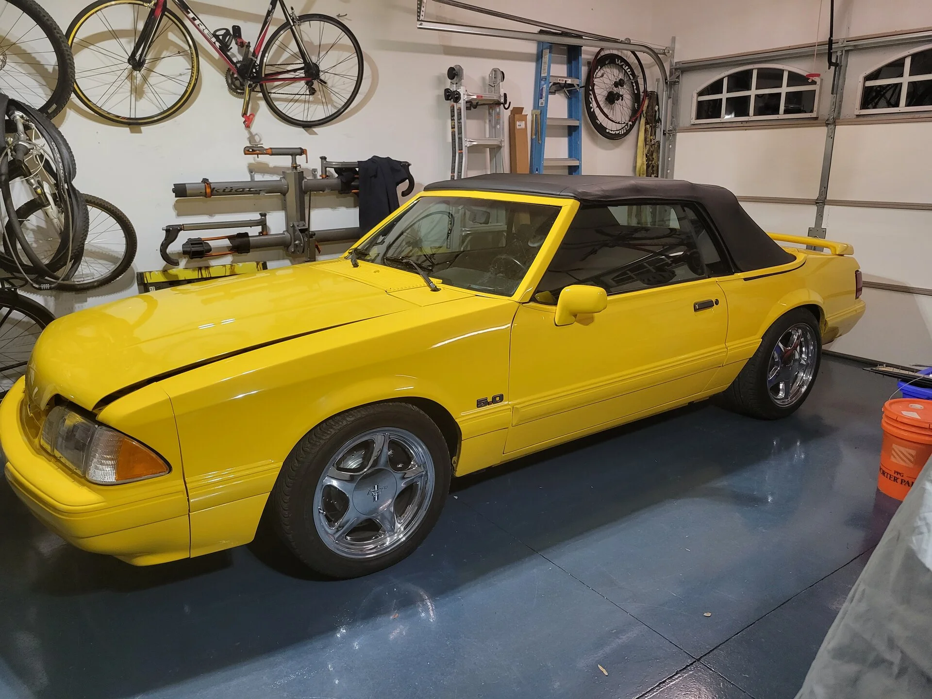

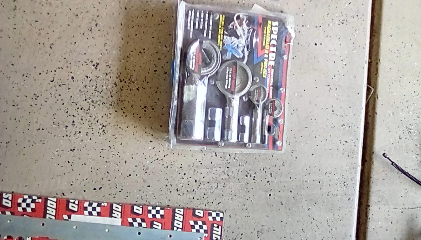

I did the rustoleum rock solid 2 part polycuramine kit from Lowes. So far so good. Will try to find a full car less pic.
Wow, that floor is shiny. Looks good. I'd be happy with anything close to that. I've been watching YT videos on prep. Acid washing and grinding. I may tackle it on my own once the paint is done.

I used three kits from Lowe's about 22 years ago when we bought our new home. That s hit is still holding up fine, and I spilled any and all fluids on it.

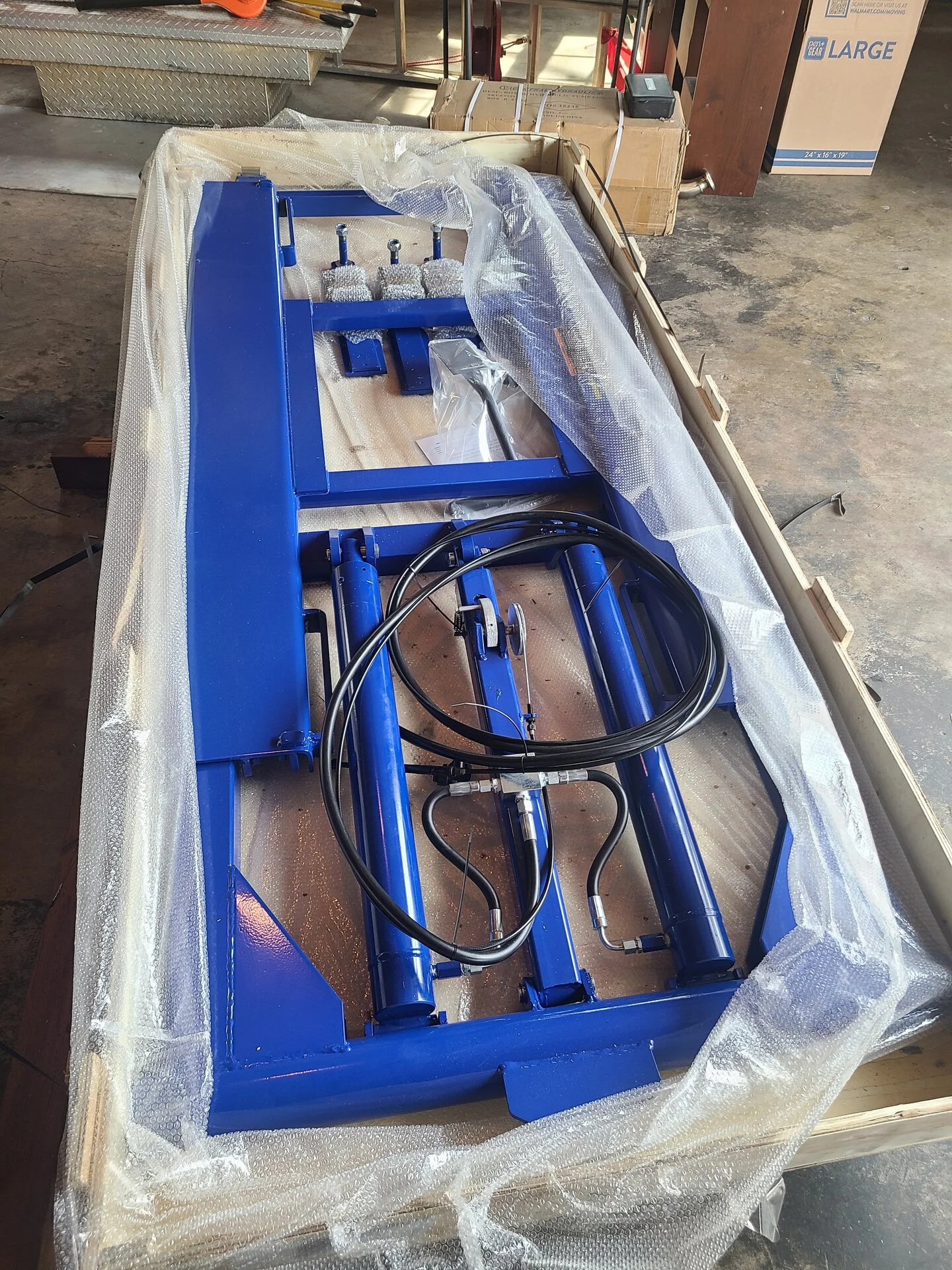

Oh, I almost forgot. Took advantage of a sale at HF. Lift is on its way.
I've done lots of work on a lift almost exactly like this one. Did everything including exhaust work. A couple 2 x 12s or 2 x 10s come in handy, along with a good set of lift blocks. The cross braces and hydraulic cylinders can be tough to get around but I managed just fine. I like that I can move it around to wherever I need it.

Yeah we just followed the directions , worked one section of the three car garage at a time.
I rolled the coating and wife sprinkled the flakes. I pulled motors,trans. And spilled gas,oil,trans. fluid,brake fluid, you name it and they all just wiped up.

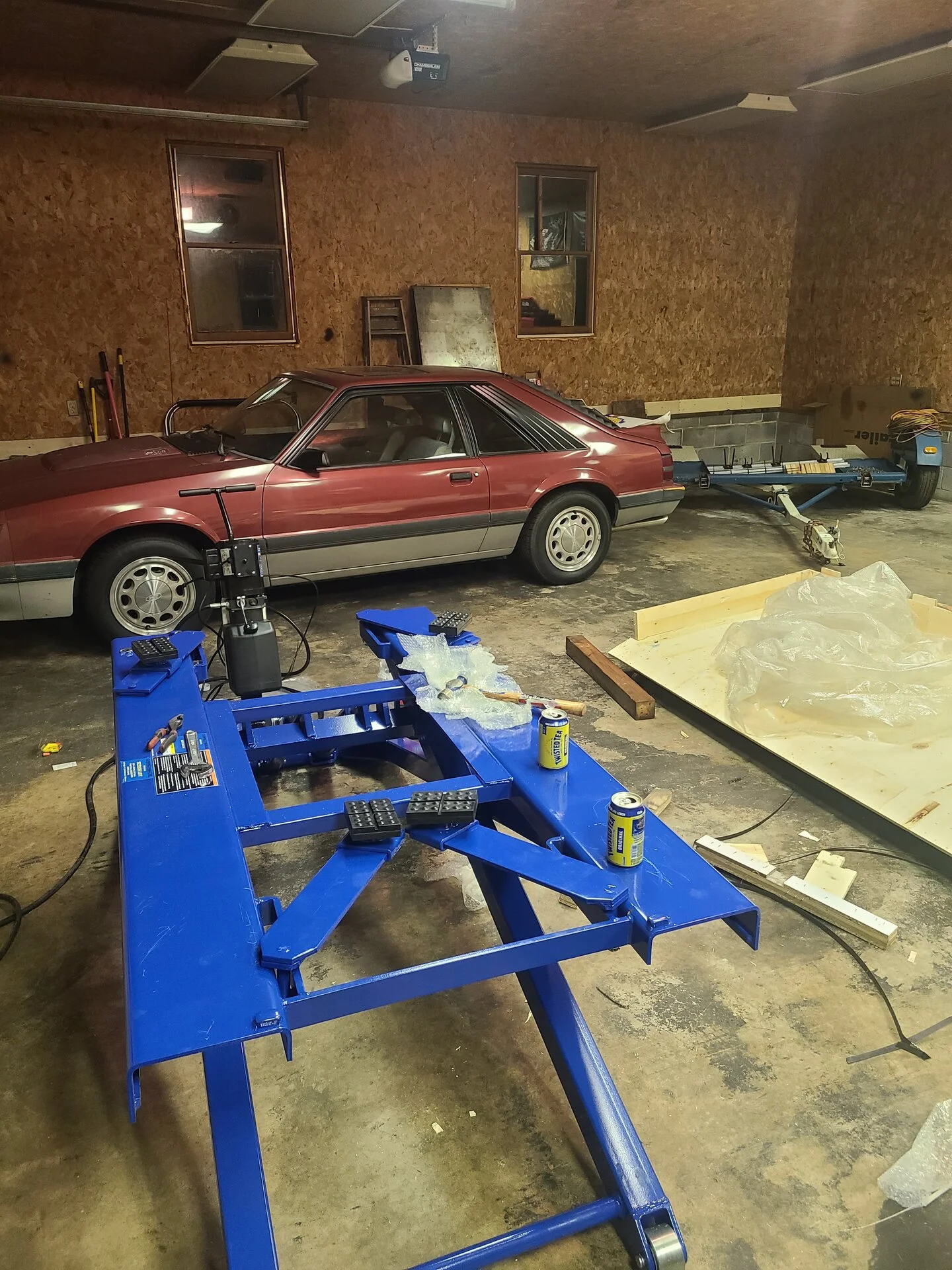

Well...this is as far as I got. Had to run out and buy some wood. 130 bucks later I'm tired and will get the garage cleaned up and put Dusty on it for the first time tomorrow.
So far I'm impressed. Pump is a little loud but it's to he expected. Wanted to make a 240v extension chord but opted to hard wire it up to a stove chord. The wiring here is so old the type of end that fits my socket isn't even available a HomeD anymore. Just the ends and the recepticle upgrade will be over 100 bucks. It works as it is and I'm satisfied for now.
