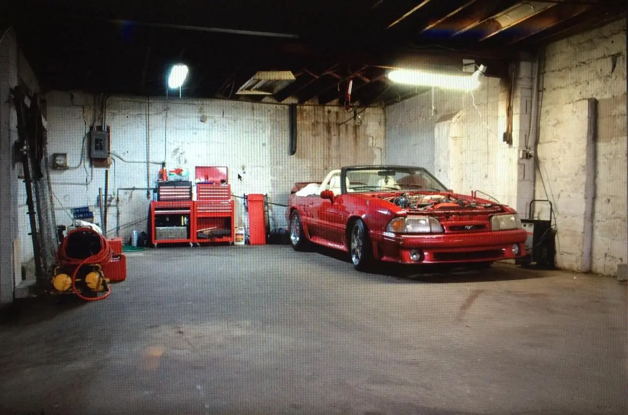

Came across this old picture of my 89 convertible.

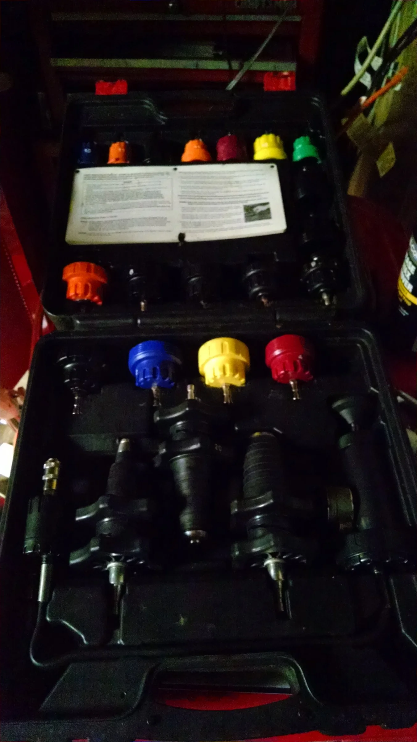

Got home from work and had a minute to really diag the last coolant leak. I bought a 180 thermostat to replace my 160. Felt for sure the housing was leaking.
I pulled out my coolant pressure tester....and it revealed itself.
I don't have a picture of it...but anyone who knows, knows that little bypass hose is a PITA. You know....that one that goes from the water pump to the thermostat housing. The clamp is only accessible by using a 6in 1/4in extension and a swivel....from under the turbo flange and the alternator. Originally, I had it turned so I could use a long flat head beside the alternator.....but it was in the way when I had to move it to put the belt on.
I swear I tightened that thing up....right before....ummm....ummm. Guess not.
If that dang thing was turned the other way I could get to it with a screw driver. [emoji35]
After I get it running right....that 180 will go in....and that darn clamp WILL get turned around.
Good news is.....the system now holds 16psi and no leaks. [emoji469]

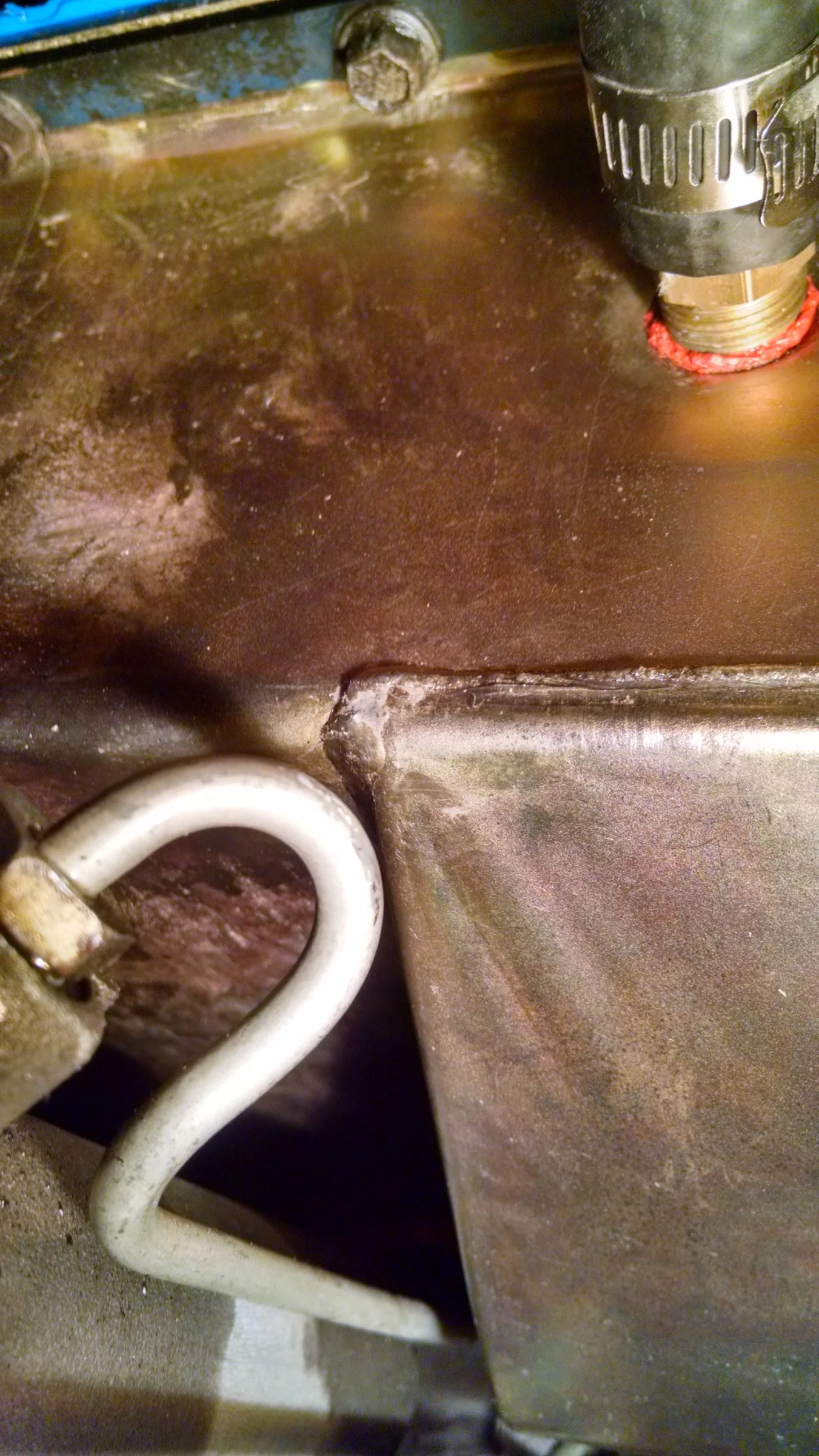

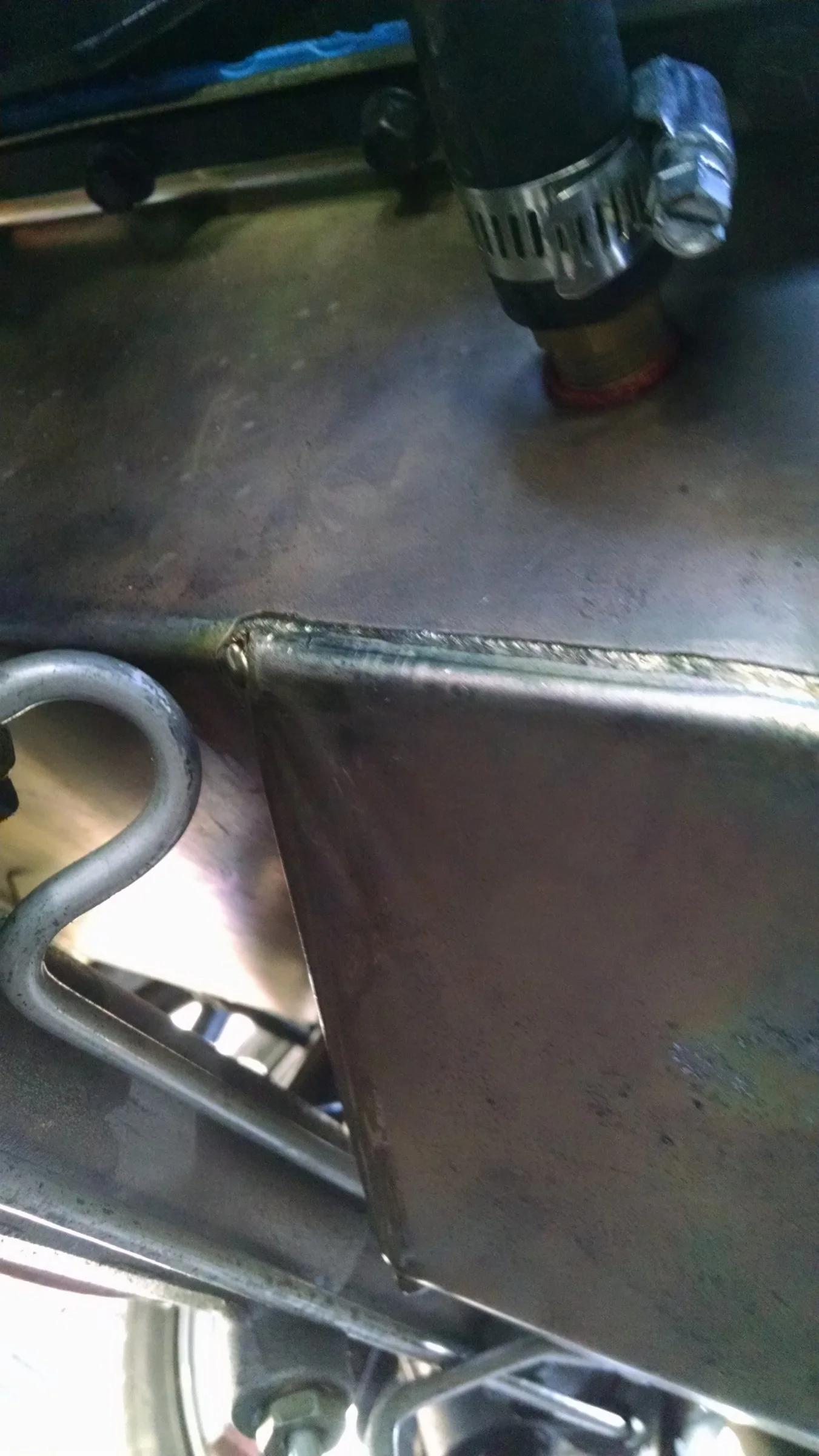

I notice a drip on the pan below the oil return hole for the turbo. I slide unde3r deeper and look at that hole I tapped....bone dry. And then I found this....
If you look close at the weld there's a pin hole. I've had this pan sitting on this motor for years and never noticed this dang hole. Now that the motor bis running its flowing oil over that corner in the pan and exposed itself. Been way too long for me to get another one under warranty. I swear I don't want to drop this pan right now.
I just don't feel like dropping the subframe or pulling the motor for this dumba55 pin hole. Does anyone have any ideas on what may work to patch this weld ? I'm thinkin' JB Weld...

You will never get any epoxy to seal as long as there is oil in that pan. and even after you drain it,...there's gonna be oil in the pan. (In other words,...there will still be enough residual oil to contaminate the patched repair.)
So,...depending on where that hole is. (after you drain the oil) I'd put the opposite end of the car way higher to make sure that I could keep oil from trying to find it's way out of the pin hole,..spray the p iss out of it w/ brake clean and wait to see if the leak is gone. Then do the roughing up part, and epoxy that btch. But I'd use the "kneadable epoxy" that comes in a little tube. That way you can keep the repair looking decent.

The good thing is the oil is below the level of the hole....only dripping when the return line is draining oil from the turbo. I picked up a tube of Quick Steel metal reinforced epoxy. Guess we'll see how this works..

I fixed my oil leaks today. I've been a mechanic for over 20 years and have always used RTV on oil sensors .... Strange how Google had me use pipe dope...which didn't work. My fittings now have High Temp RTV on them and are leak free. The hole I had in the pan is also patched ( I think ). It was tough cleaning all the oil up...but its working for now and doesn't look too bad. I used Quick Steel....kneaded it up and made a point to stick in the hole, then messaged it into the missed weld. Seems to be working.
