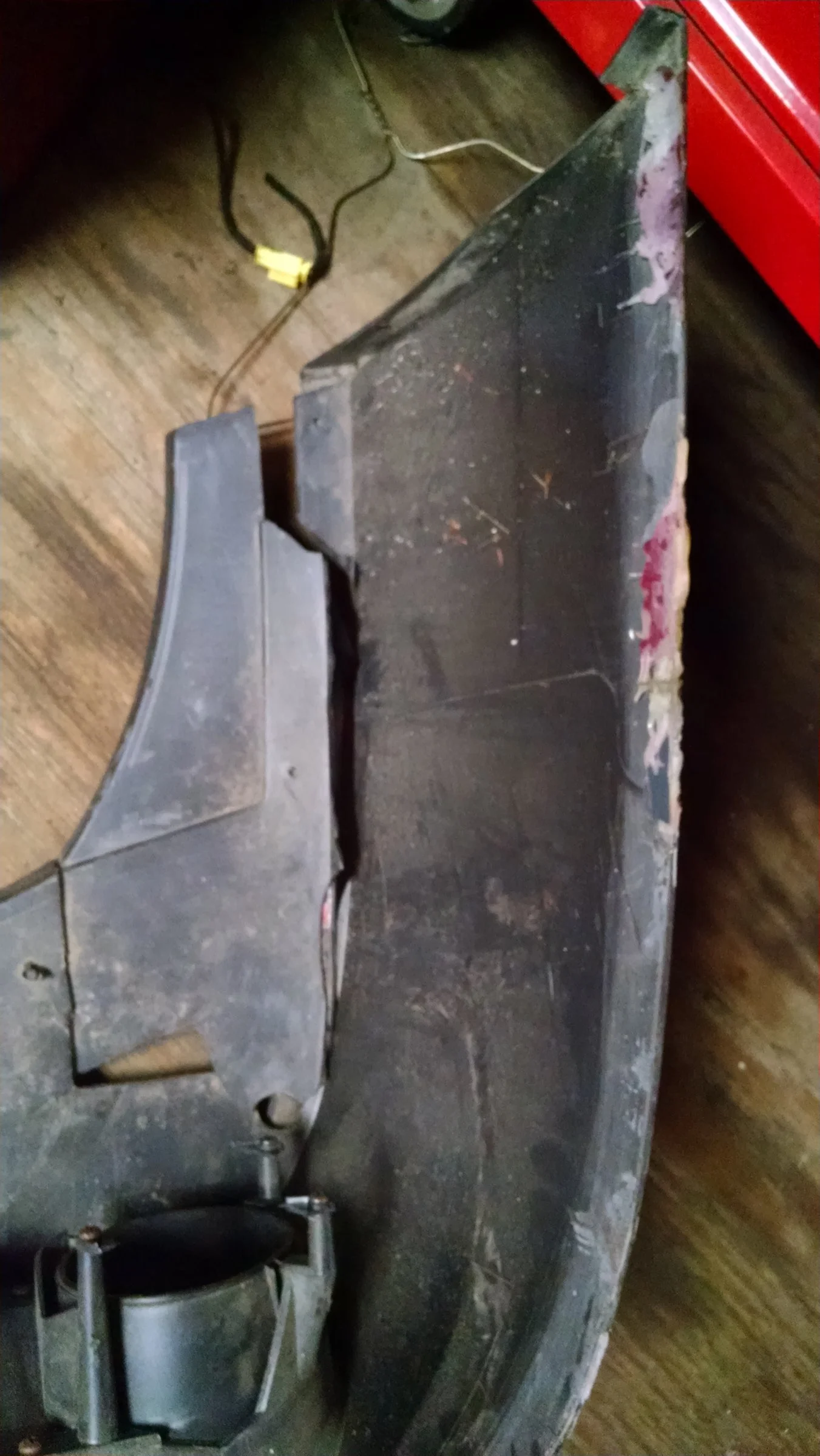

The bumper lower isn't a total loss. I do have to buy a fog light and a fog light bezel, but that's all under 100 bucks.
The cover got scraped pretty bad and its a foot long crack at the bottom edge. I think I can fix it with 8115....I hope. If I can't save it.....it'll cost about 400 bucks and a lot of time to trim it to fit.

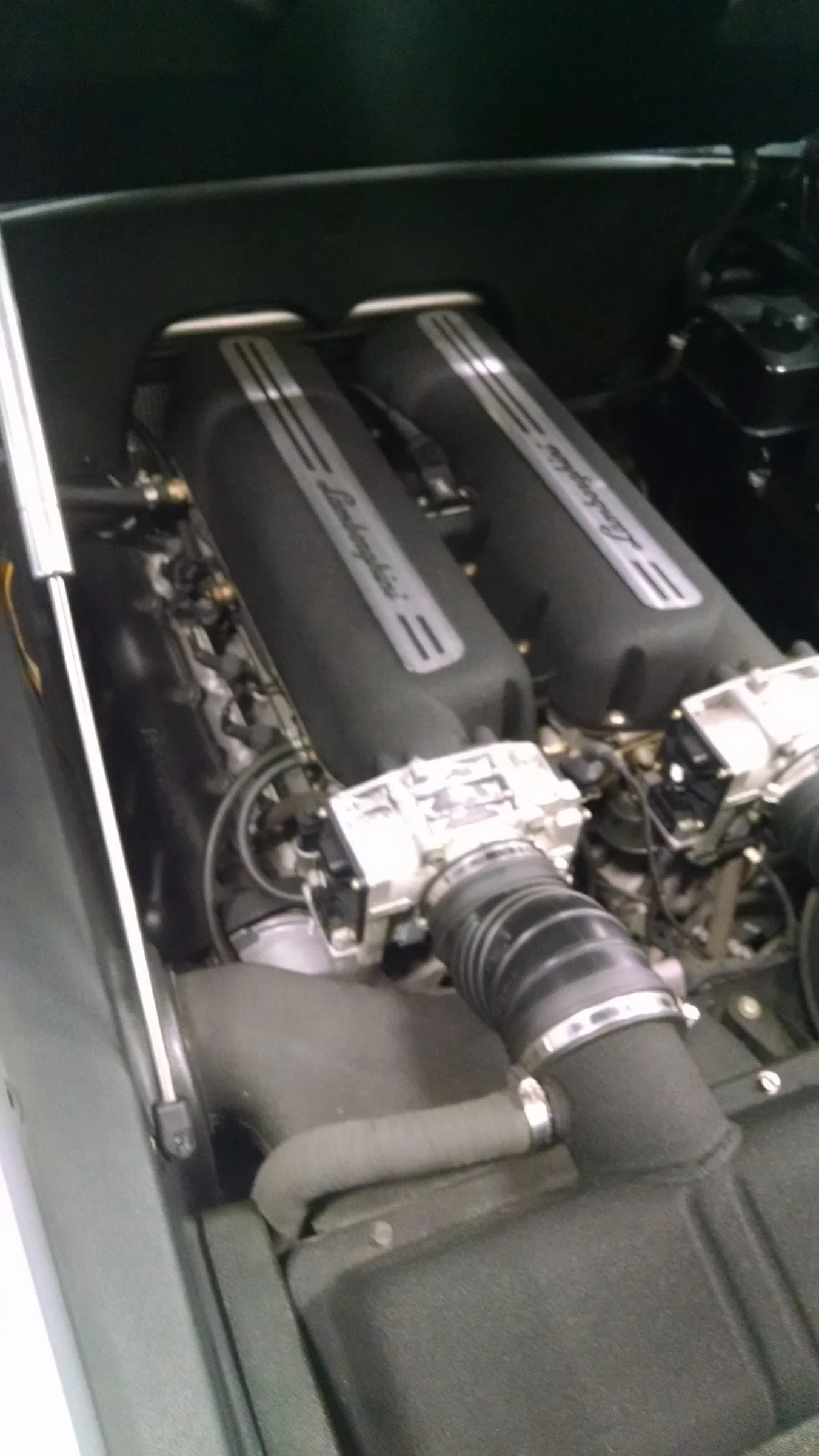

I've always wondered if there is any advantage to that type of an induction system other than being a seemingly signature style of Italian supercars.
There is a benefit.... It helps keep down air turbulence at higher rpms.

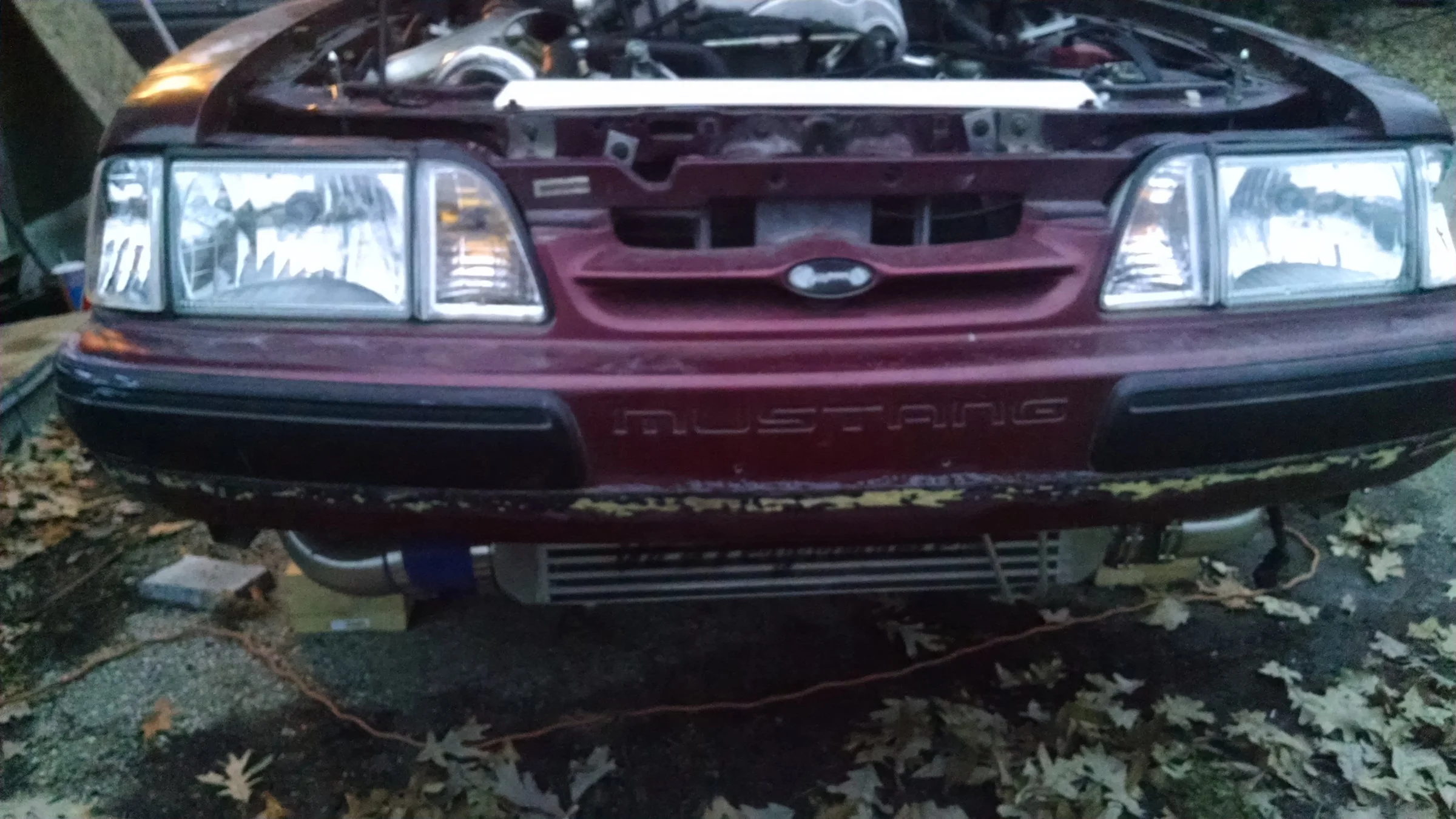

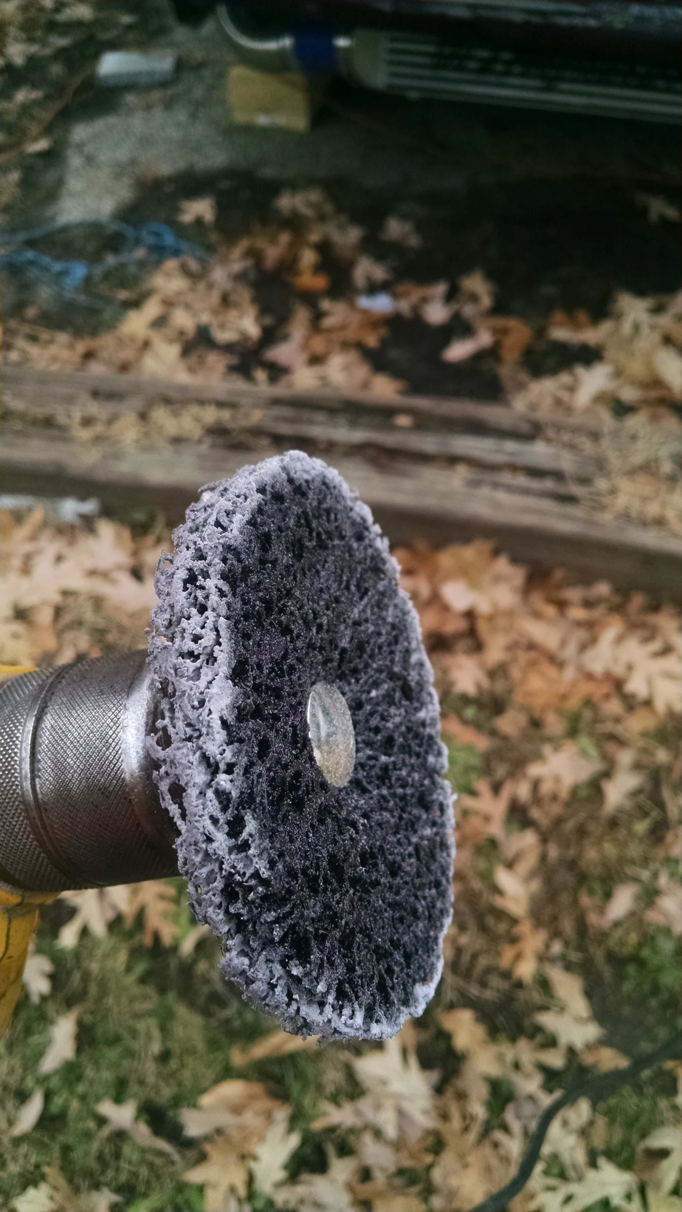

All I can say is....this dag on epoxy is hard to remove. The seam sealer came off easy enough...but the 3m 4747 has become part of the front bumper.
I used this thingy....
Getting prepared for Terminator Cobra bumper 2.0.
I've got to find a fender stand to sit the bumper on for repairs. I'm going to attempt to fix the one I have verses buying a new one. Picks of the bumper will come when I start messing with it. Right now it depresses me too much to take a photo of it.
Good thing is, I found out that 4747 urethane epoxy is great for our stock urethane bumpers...not so much for polypropylene. ( I think that's what the new bumper is ). It also hardens up too fast for what I'm trying to do. It didn't give me enough time to set the bumpers together the way I wanted.

Here's the aftermath of my big foot...

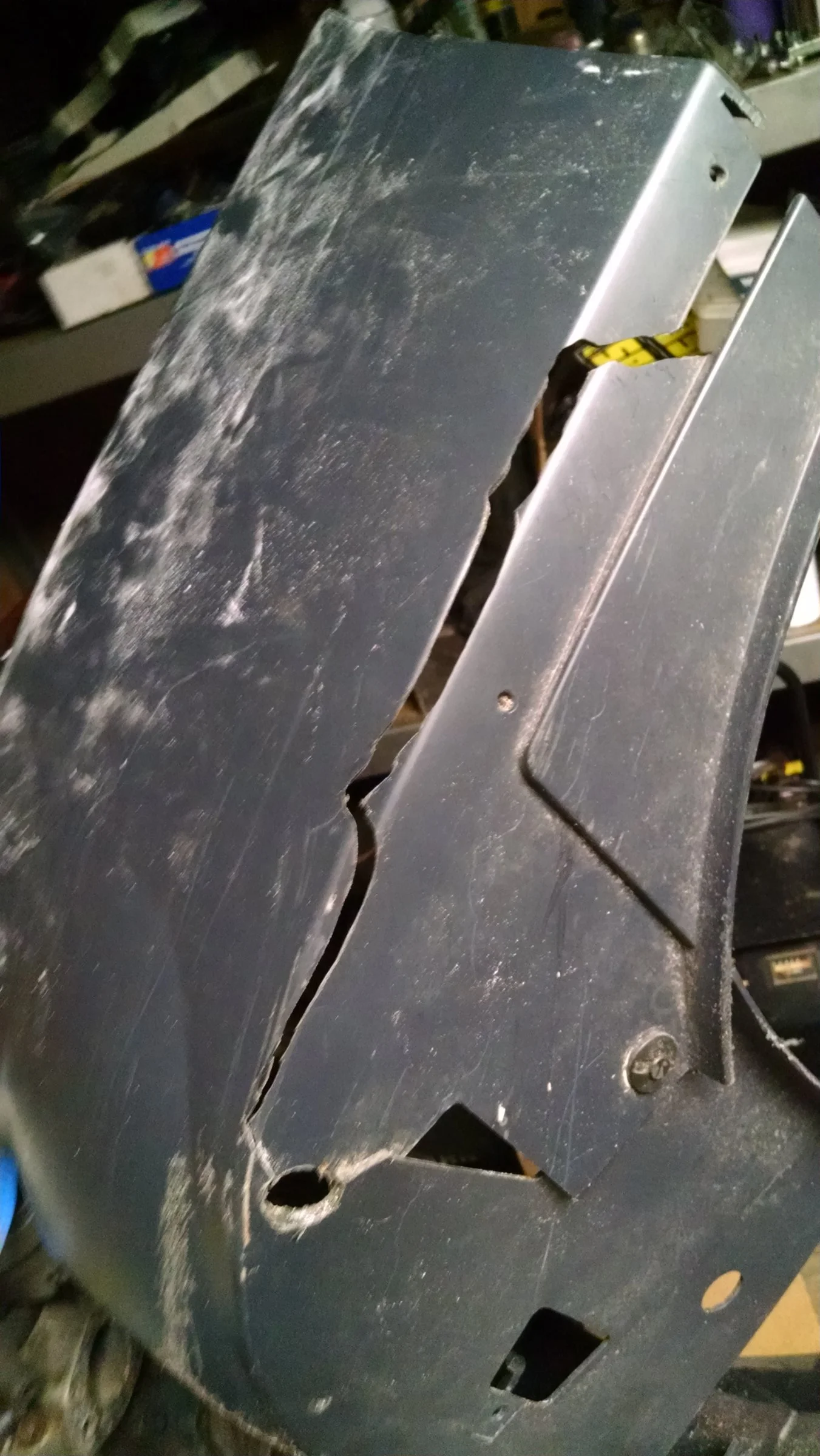

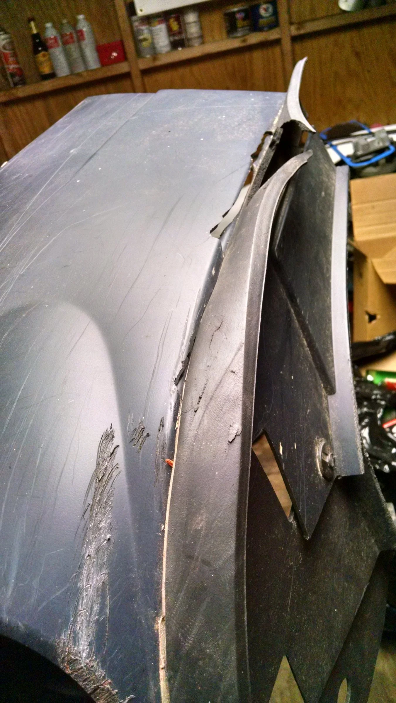

That little hit knocked d the lower clean off and did this...
I think its fixable with PBA...what do you think @ davedacarpainter. At least my dog didn't eat it.

Yeah Scott, you can fix that.
Just remember the PBA is a LOT slower, so you'll need some sort of form. Even something simple like masking tape for the gouged out part.

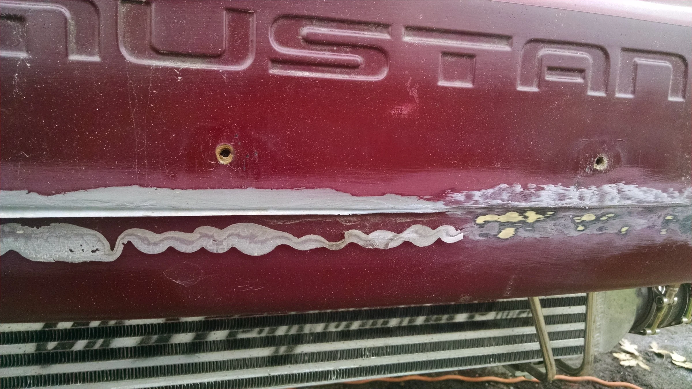

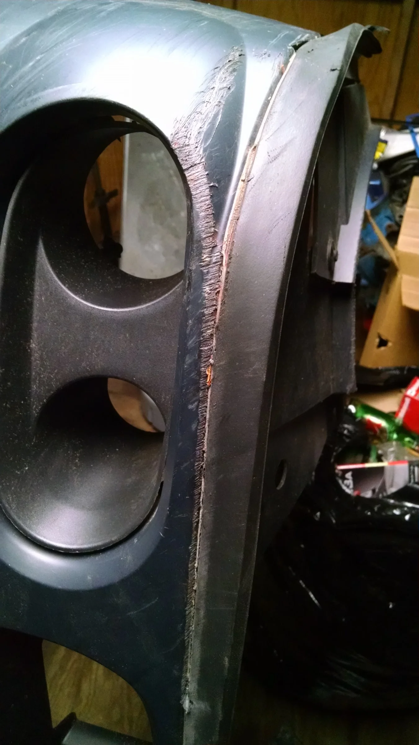

I got out in the shed and got some work done with my Dremel. The seam sealer I used was about a quarter inch all the way around the top. I did this to keep water from freezing behind the edge and popping the bumper loose last winter. Jeesh, its been a long time.
Anyway, a quick spin of a wire brush got rid of that....and a barrel sand paper bit got rid of the old epoxy residue.
Here's a better look at the damage....

I've fixed way worse than that with PBA Scott, should be simple. I used mesh dry wall tape on the backsides of my repairs too.
