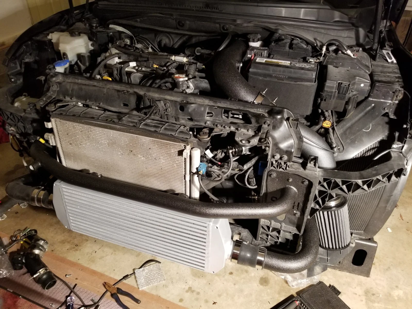

Been busy working on customers cars. This veloster got CAI, intercooler W/ hot & cold piping, new fuel pump, tubular crash bar, braided upgraded line to the high pressure pump, and map sandwich plate.
I got paid and his old CAI and Synapse BOV. Things keep leading me into the deep hole of modifying the 19 ecoboost.

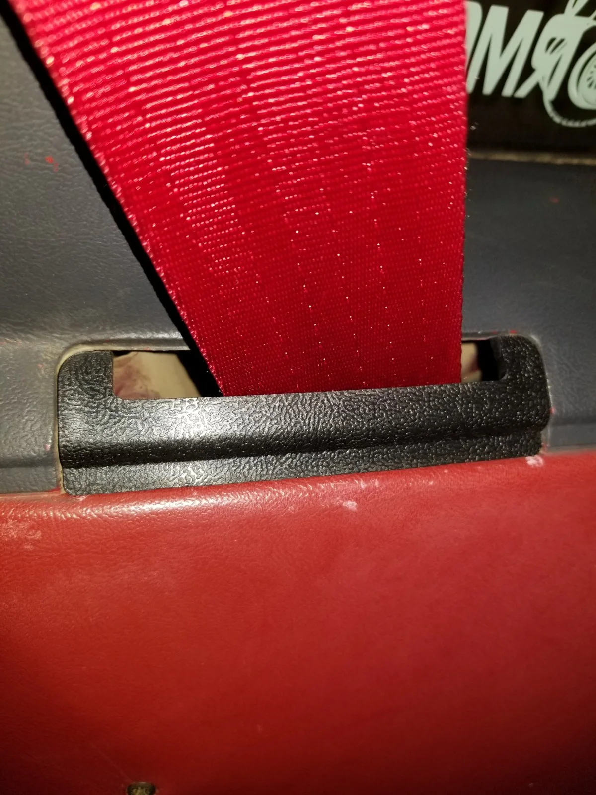

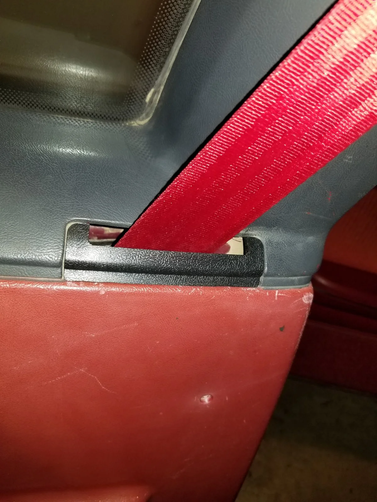

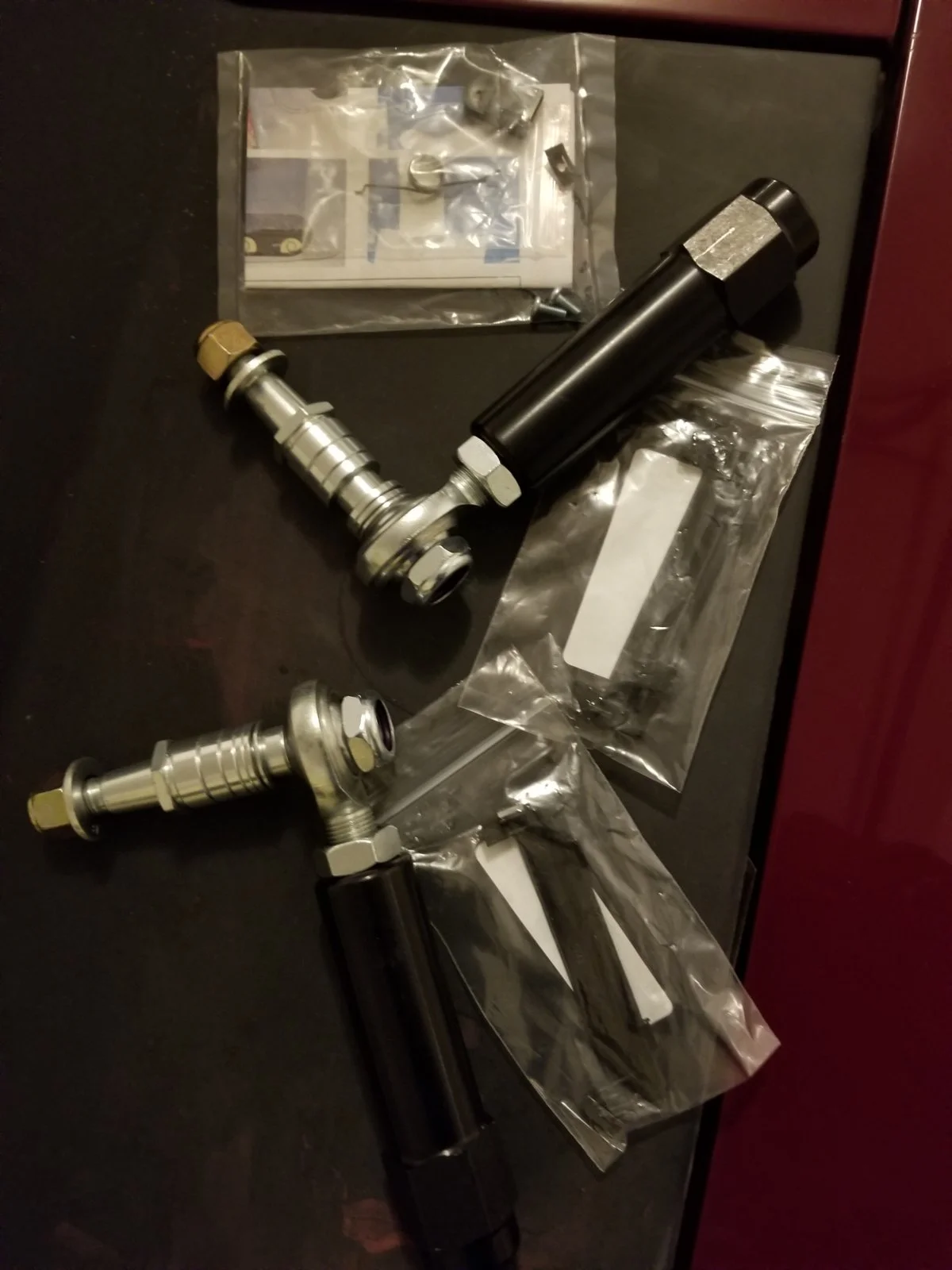

Got this stuff in the mail. It's a bump steer kit, seat belt hole covers, and an ash tray repair kit. Ordered new struts that should be in store Sunday.
These things are a PITA. Just to let everyone know the coupe and convertible take the same covers.
....and, Mike , I finally installed an interior part. If you look close you can see the Indiana dust behind the panels. I had them removed and cleaned behind them when I had the entire interior apart and out. Don't fret, it'll all be cleaned...again. There's some painting in my future, too.
The bottom tabs broke on both pieces trying to get them seated. Probably had something to do with the low temps in the garage. They fit anyways though. I'm happy with them. They are in there tight as hell.

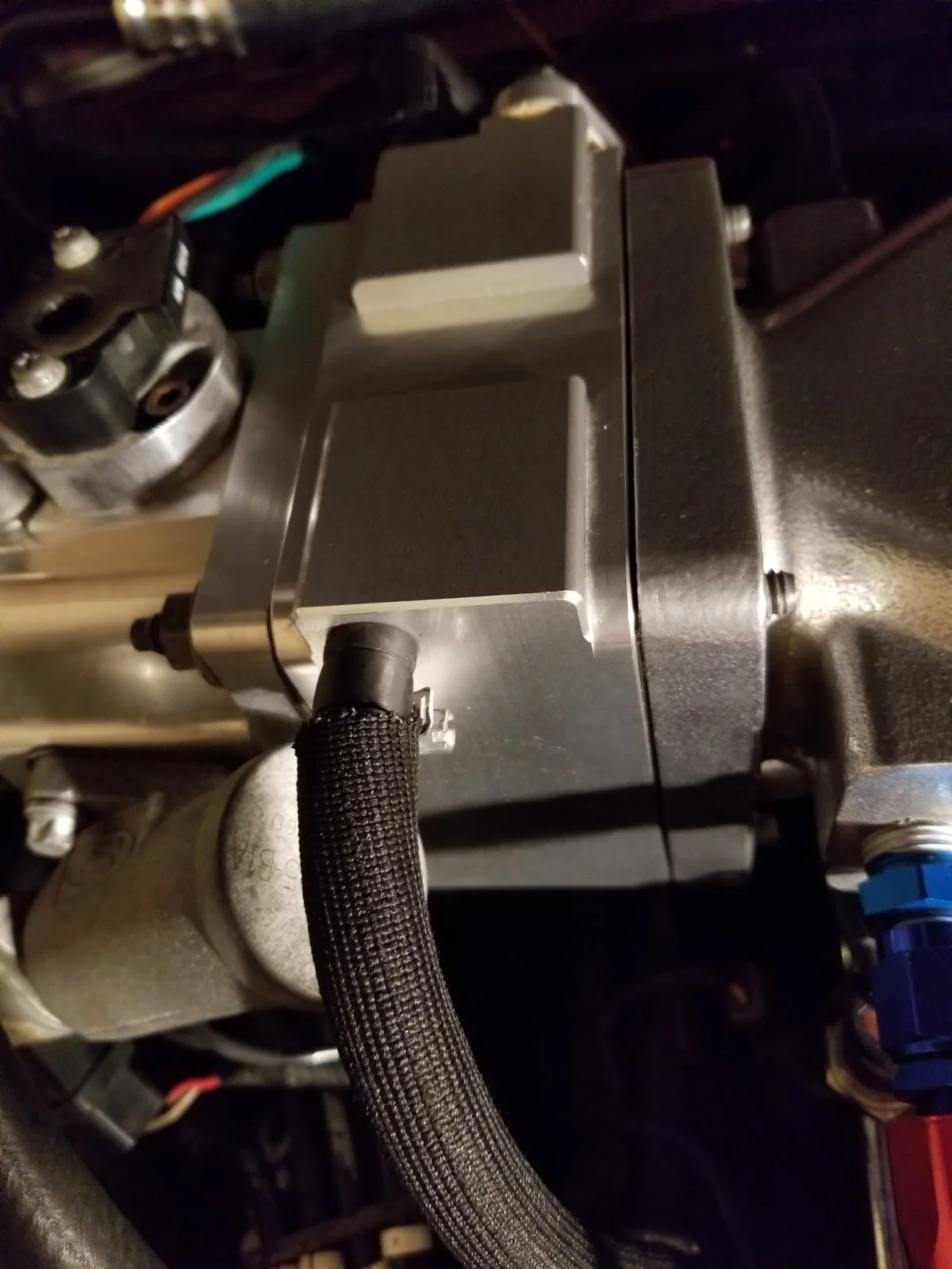

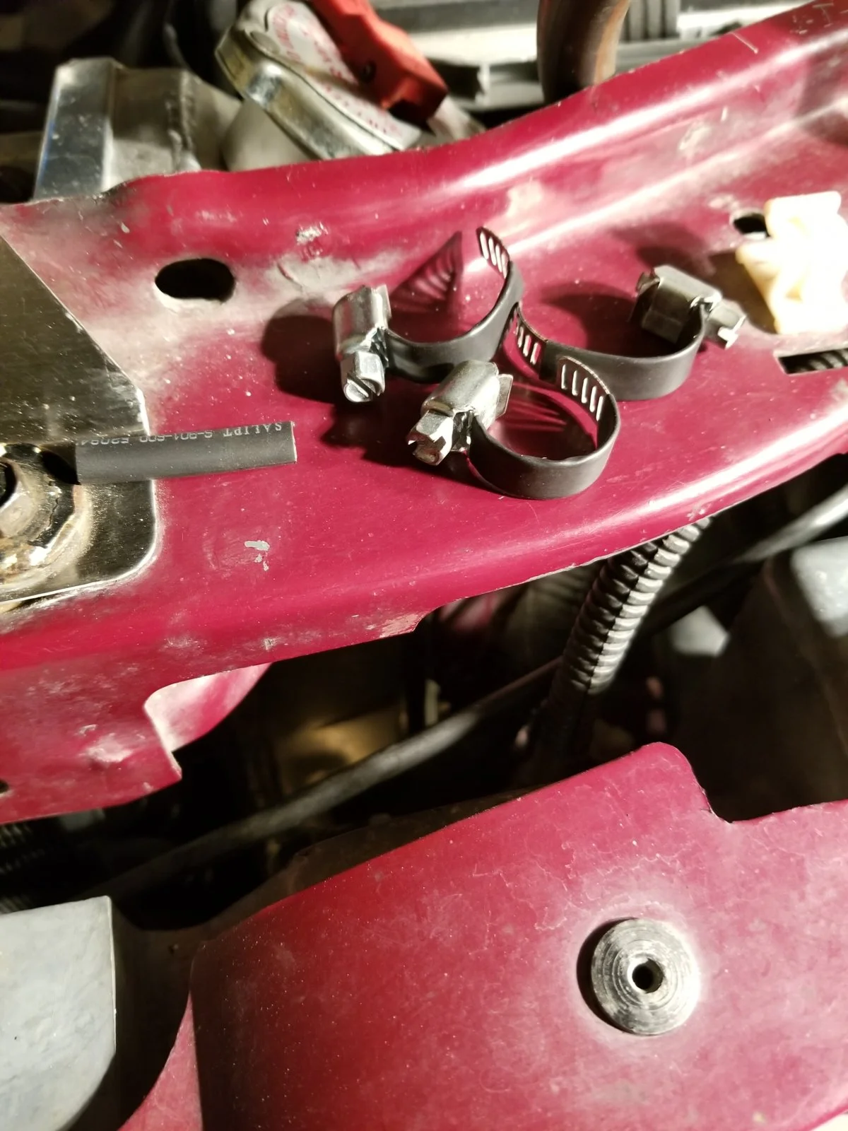

Up to my old tricks with hose clamps. A little heat shrink goes a long way.
Can barely see the clamp up by the throttle body now.

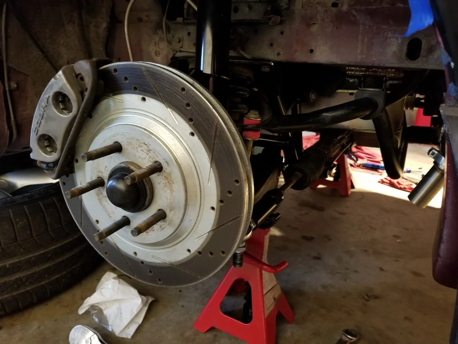

However, the worn old Strange struts were shot. Felt every little bump on the road. The IRS springs were way too soft and caused the car to bottom out in the rear...and the tire brands didn't match front to rear.
One hot summer day I rollz up to O'Reilly's and bought jack stands, struts, shocks, and spring spacers. The guy came out of the store and saw me on the side with my car on the 4 jack stands wonderin' what the hell I was doin'. We talked a bit and I told him I'd only be about an hour. He told me if I was done in an hour he'd let me get a refund on the jack stands....
Needless to say, I got it done with a few minutes to spare. He refunded the money for the stands. I drove over to a tire shop and bought 4 tires and got an alignment.
I remember telling the guys not to use my ebrake...but they did anyways. Man was that tech scared when the back wheels were locked up. Lol. I didn't have return springs on the rear calipers. To release them you had to stick a screw driver back there and pry the e brake cam. Almost scared them into giving me the alignment for free...but they were all way too cool for that.
This UPR bump steer kit came from the first trip to MW Myrtle Beach....where I met Mike with his red throwback mustang coupe. Me and Carmicheal Angelo talked for at least an hour or so that day. ( he don't remember none of it...that old coot. Lol )
These struts carried me through a lot of pot holes....blizzards....trips to the track....even took a ride over a curb with Dusty. I'll miss these old cheap struts. It was great but sometimes ya jus' have to move on.

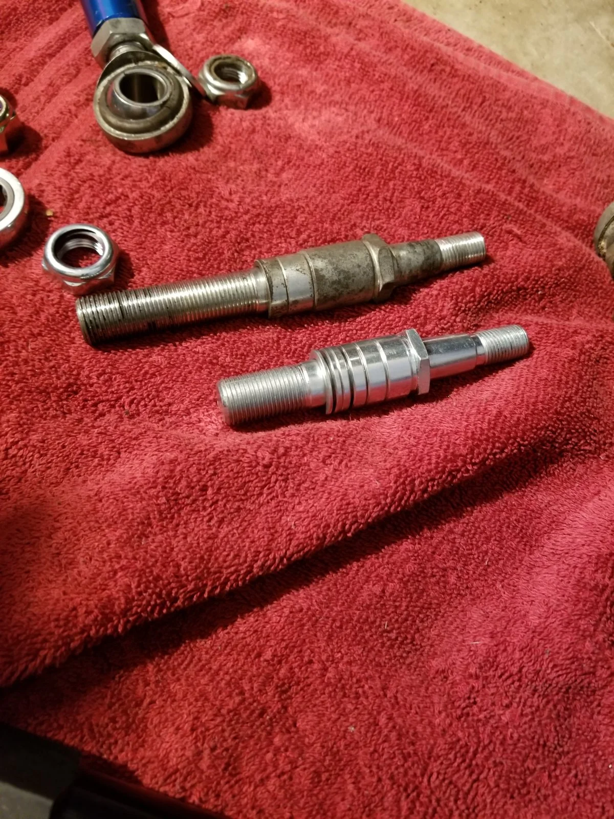

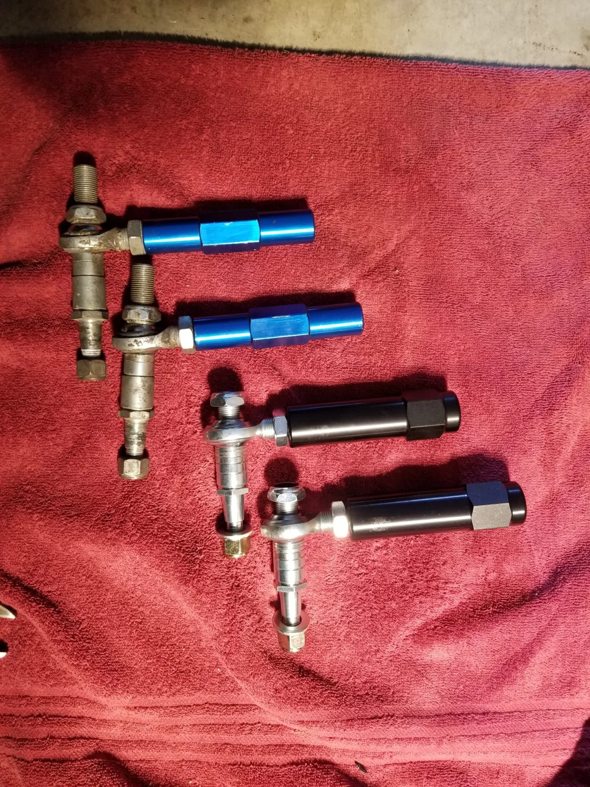

If you notice the new bump steer ends are on the old bump steer kit. That's because the UPR kit end is way longer allowing for more adjustment. The threads on the outer heims joint are also reverse thread which simplified adjustment. With the new kit I have to turn the inner tie rod to adjust. With the old UPR all you had to do was loosen the nuts and turn the blue aluminum body. Not a big deal.
Car is back down on the ground and everything is installed.

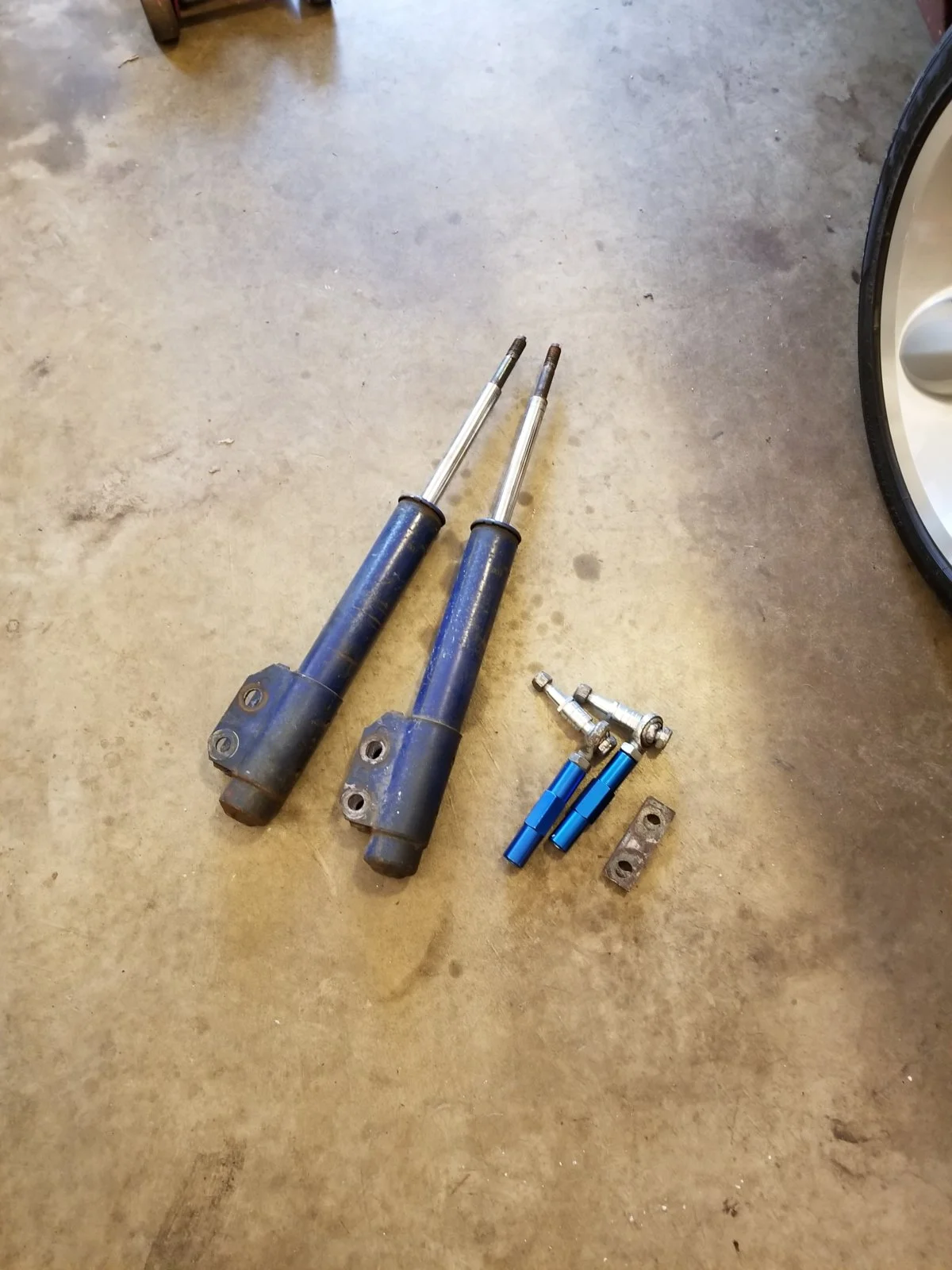

I installed the OEspectrum Monro struts. I want to do coil overs and adjustable struts but the budget wouldn't allow it yet. Kinda caught me off guard when I went to tuck the passenger side. No way I could leave it the way it was.
There's no more play in the struts or bump steer kit....I'm happy.

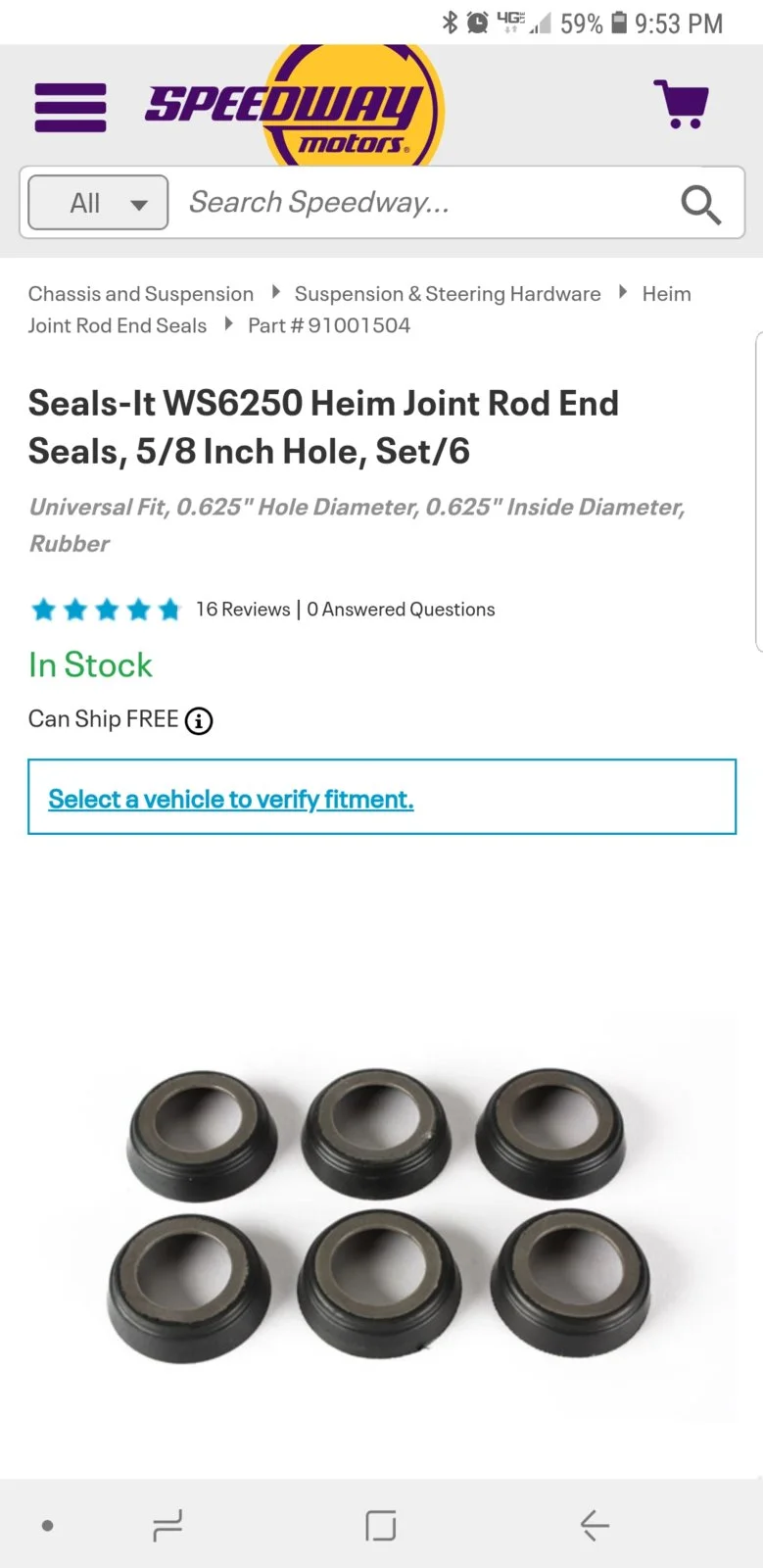

I found these and will be installing to keep dirt out of the heims joints. Should help them live a little longer.

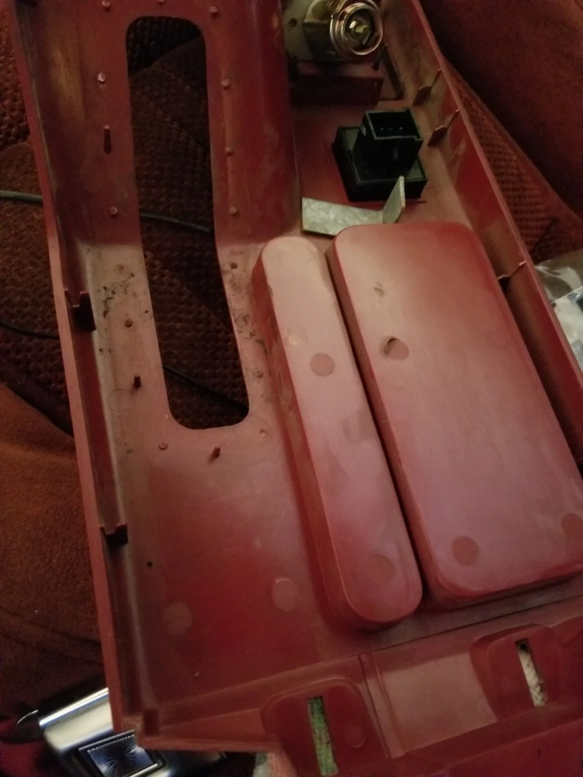

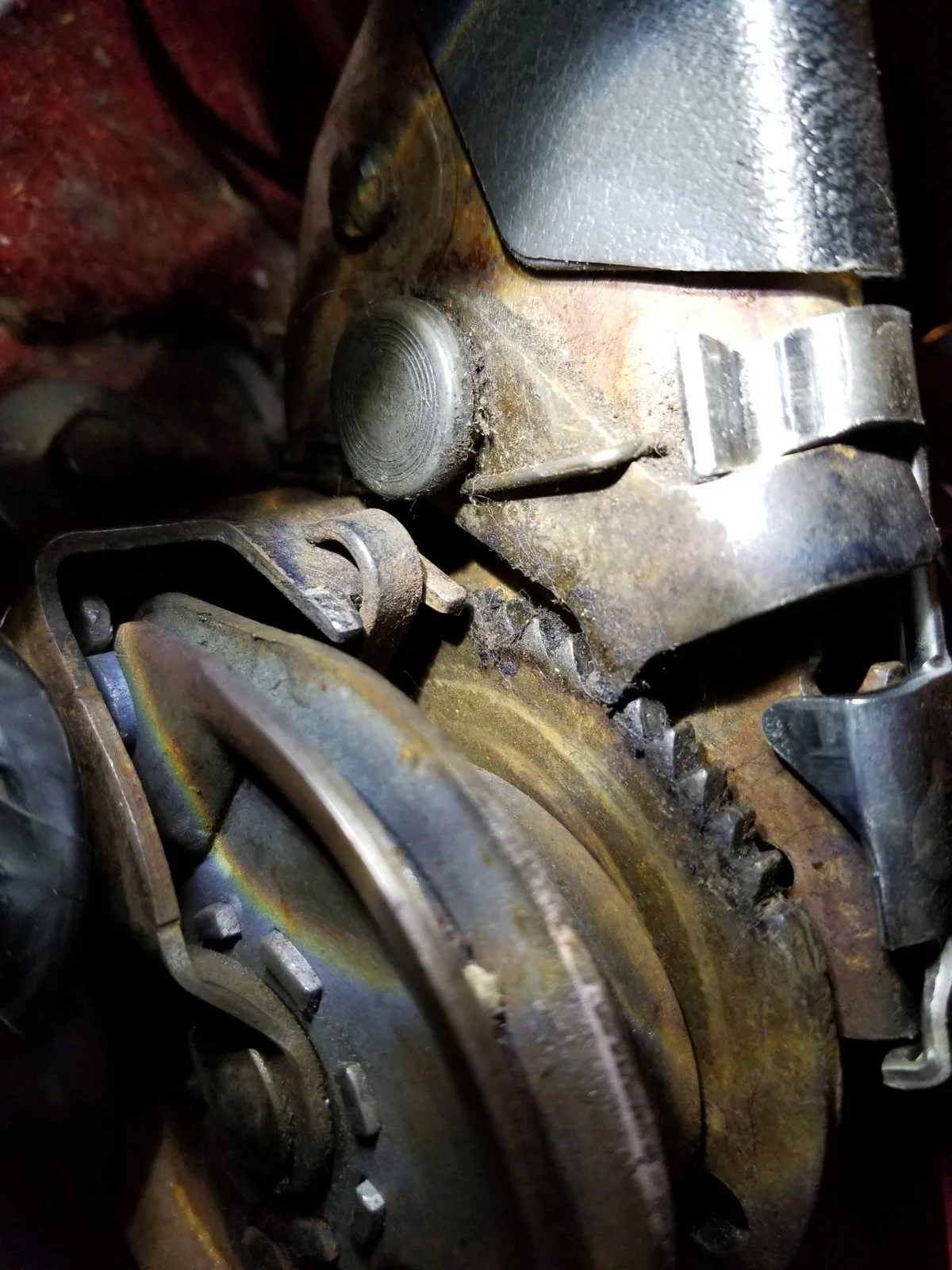

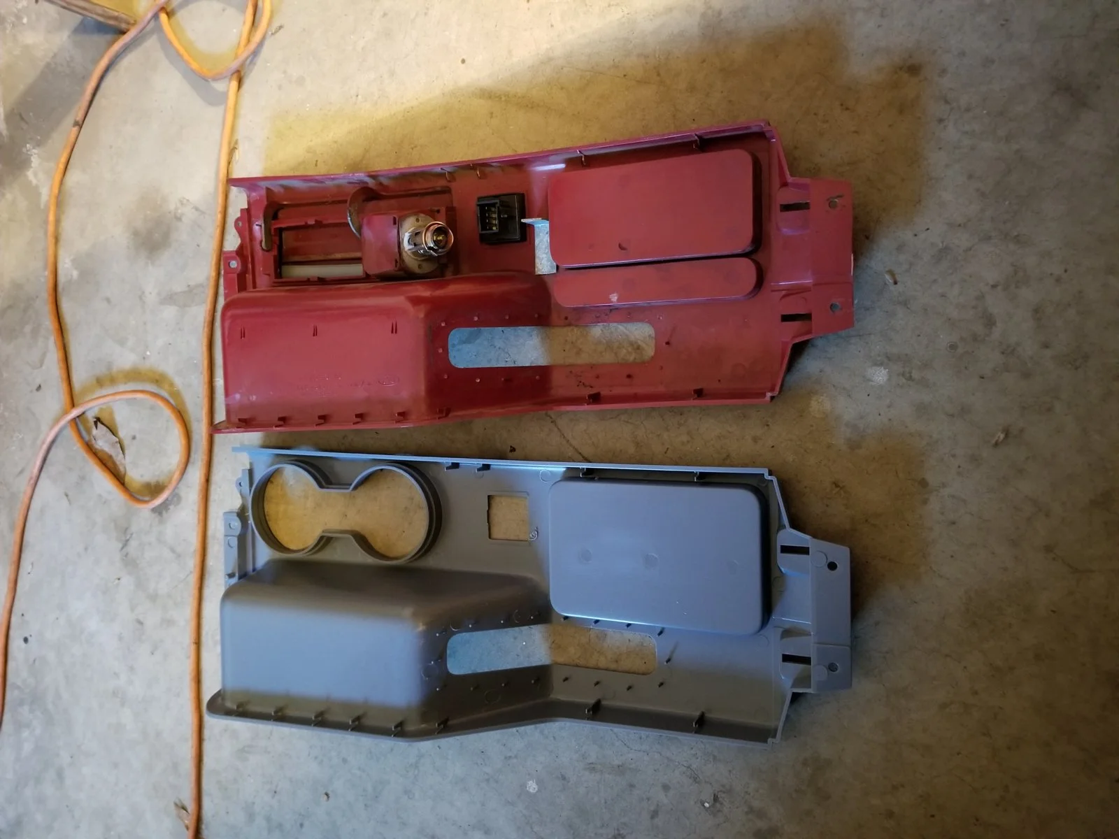

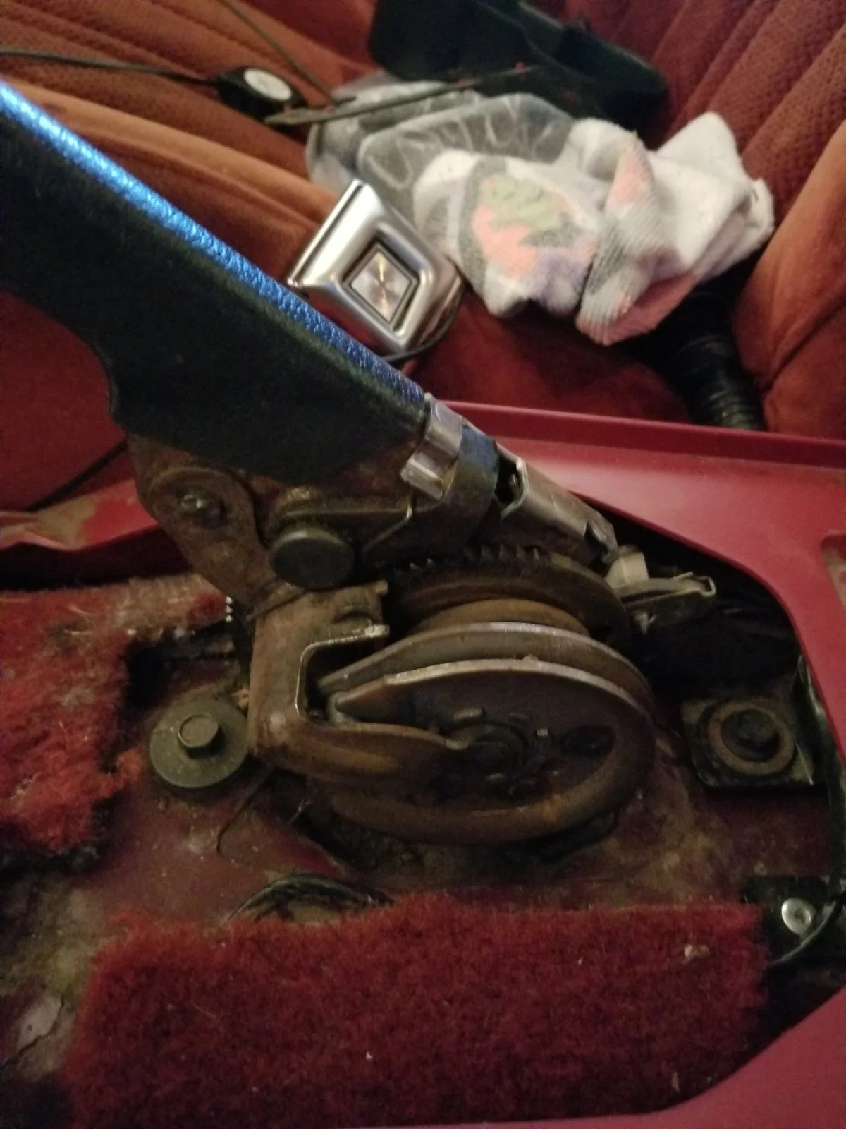

Had a few minutes to spare this evening. Decided to tackle the ash tray door and the e brake recall fix.

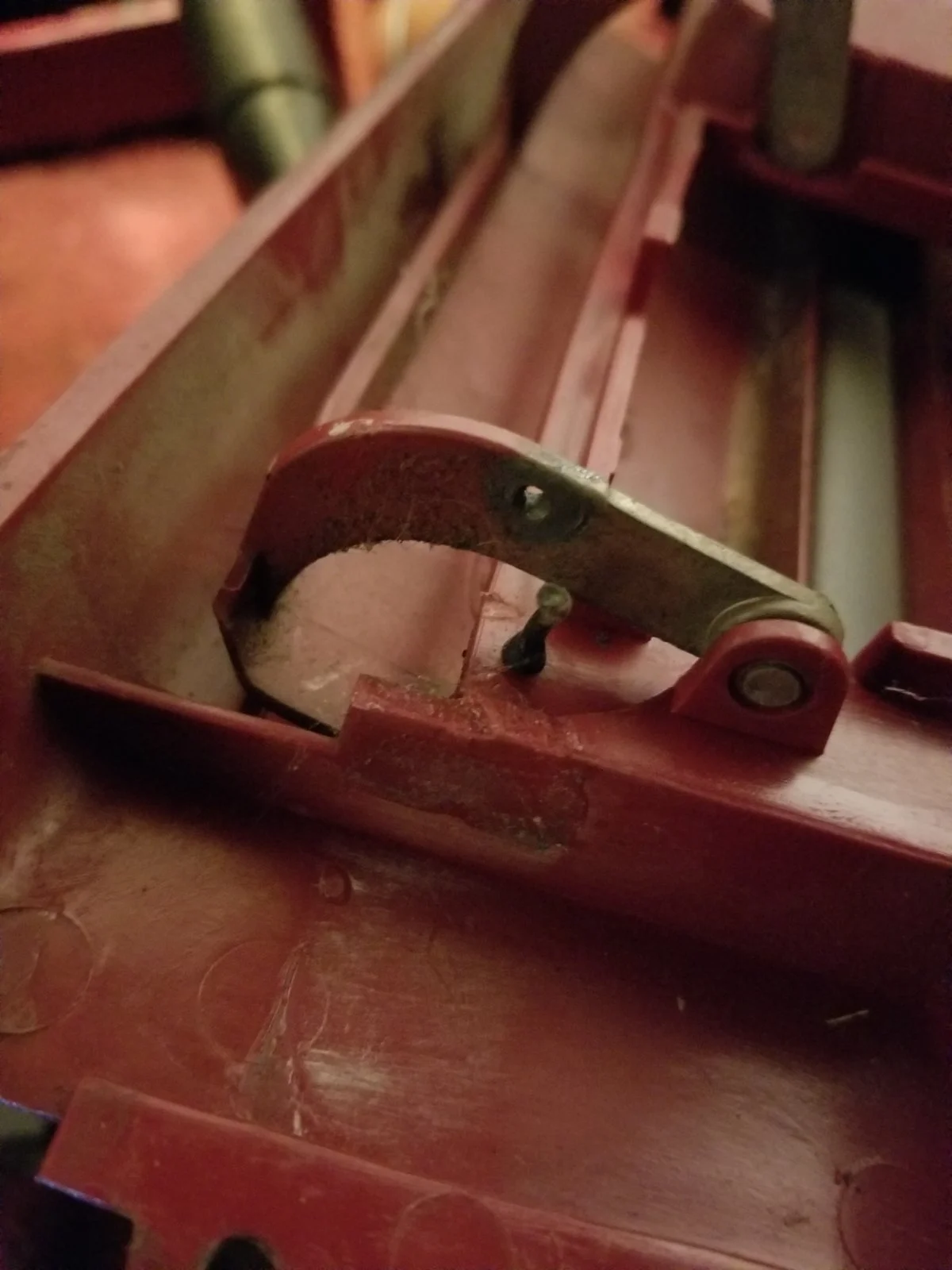

This is what happened to my center console...
I was on the phone with the woman ( while she complained about everything under the sun ) and heard a crack. The seal for the e brake just cracked clean off. Then I re- noticed this...
The arm that holds the spring is completely gone. I knew this when I put everything back in the car....but I forgot. The repair kit won't work. I can make something to fix it but I won't. Looks like I have another thing to order.
Reactions: RaggedGT

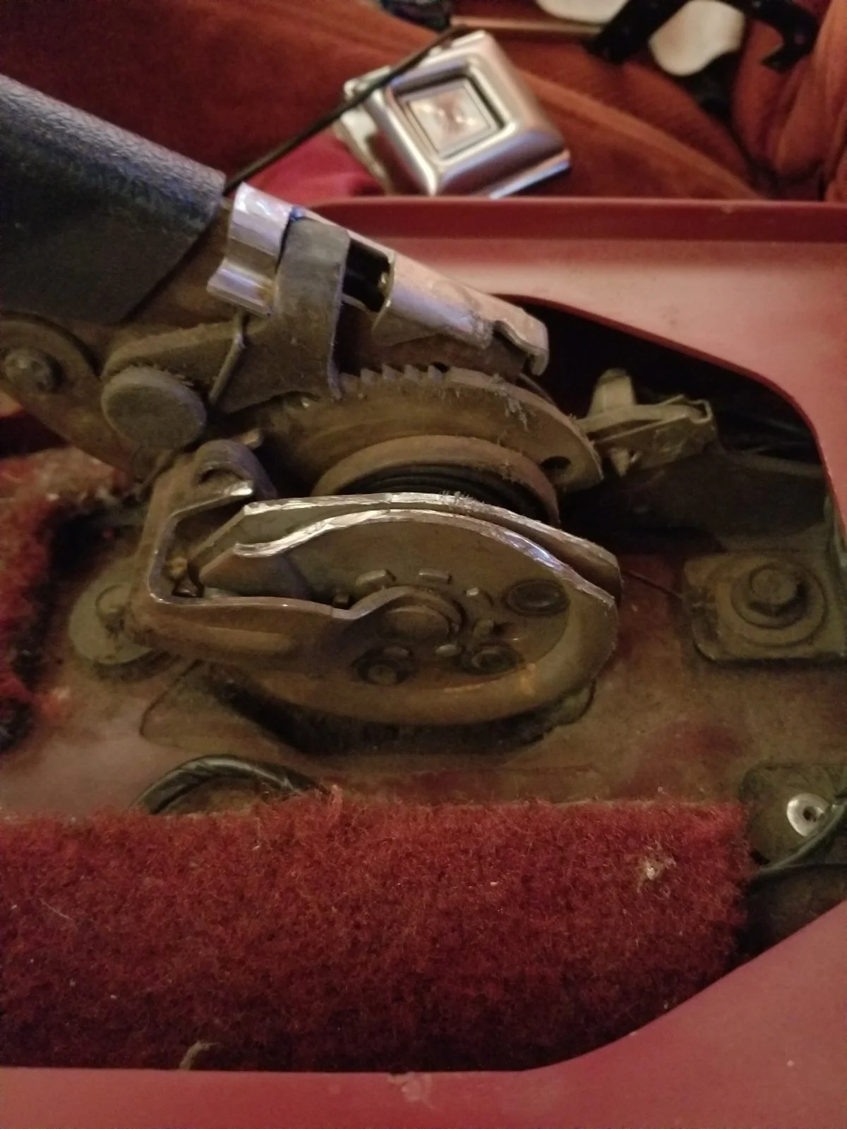

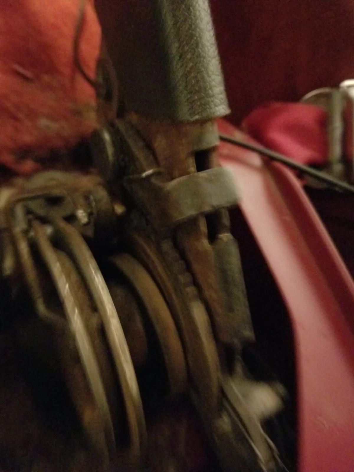

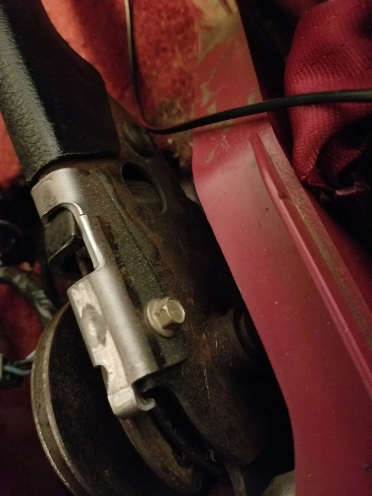

The e brake repair went flawless. Heres a before shot...

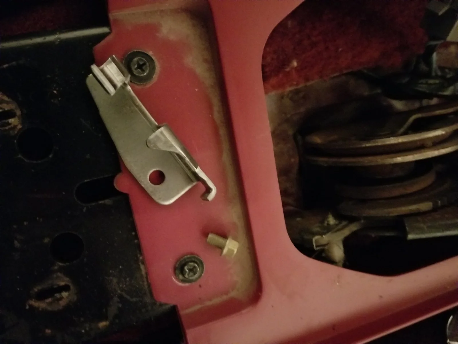

Here's the recall part...
Here's where it goes. What it does is locks the ratchet pawl in position. When the handle is down the pawl is released. When you pull it up it grabs one of the teeth and sets the brake. That mechanism could fail causing the e brake to not grap. Easy install...
I use an e brake out of a 98 mustang. Its different than the 79- 93 mustangs. Made the change because of the IRS and the sn95 style cables.
Works like a charm.

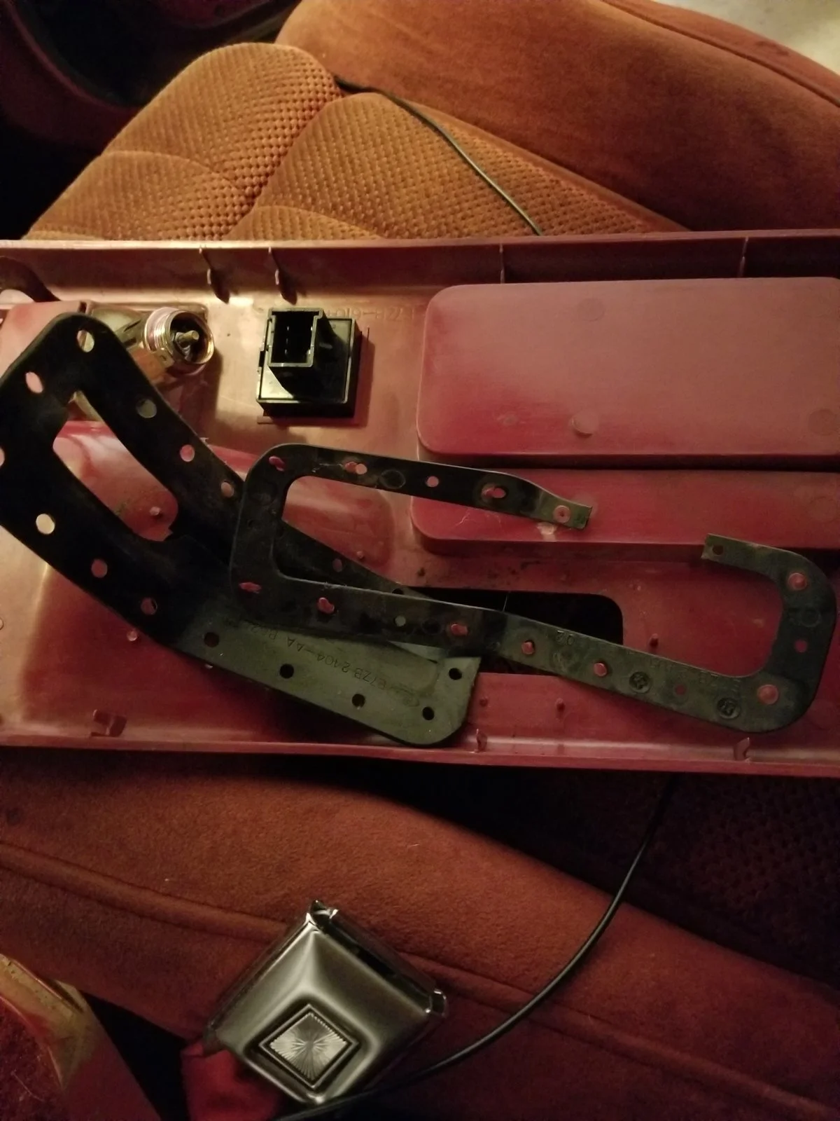

The issue with the center console isn't LMRs fault. I use a 98 e brake because of the IRS rear. The cable cam on the 98 is larger in diameter than the original e brake handle. That big square pocket is just low enough to not allow the console to fit. On the original it was under the pen pocket which is not as deep as the old change pocket.
I can modify the e brake handle cable cam by shaving 1/4 to 3/8 of an inch off of it. That means I'll have to remove it to do that or risk throwing hot sparks all over the interior. The thing will also need to be painted.
I'm not doing that anytime soon.

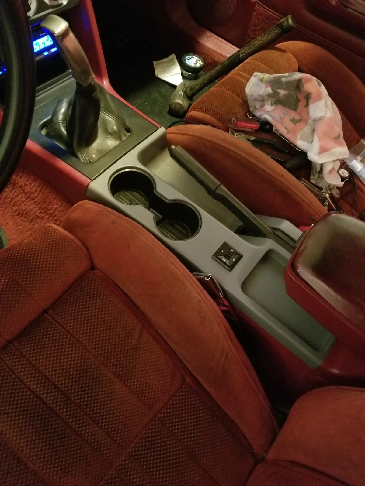

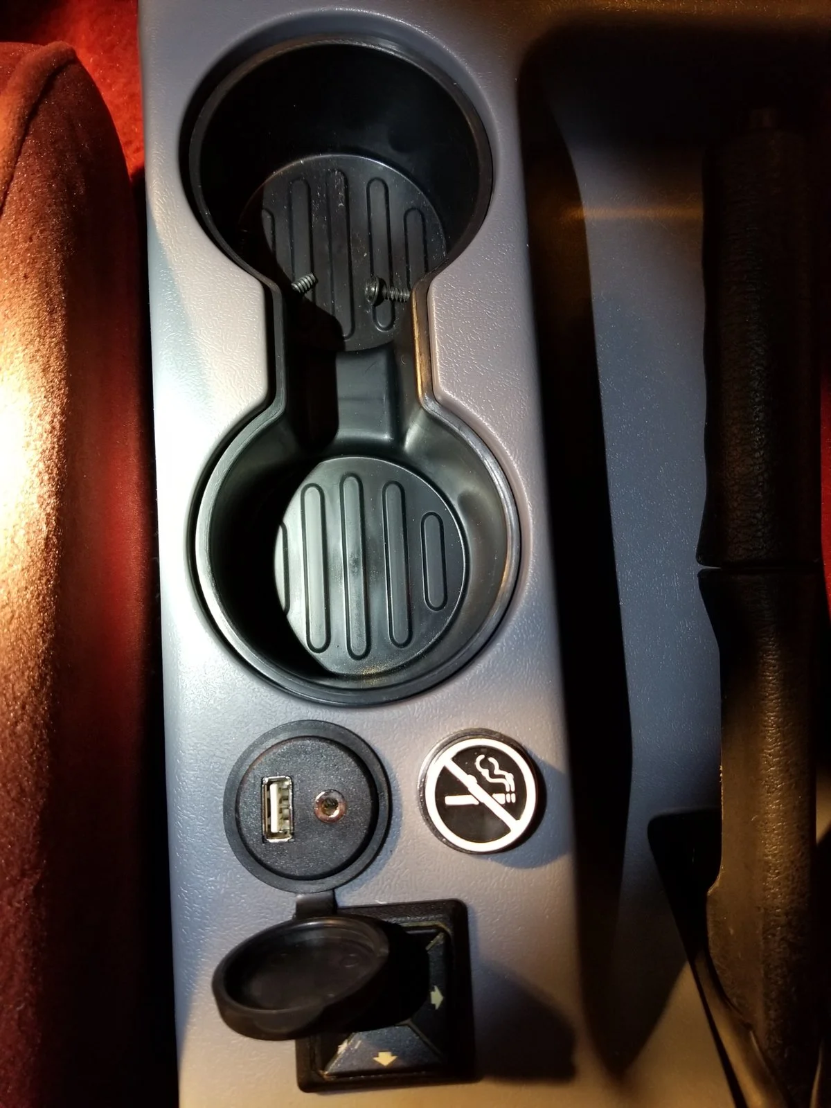

Now I'm part of the cup holder crew. This is all just a test fit. It'll get painted but with rain the next three days and temps around 50 degrees it just ain't happenin' right now.
I want to add a USB for megasquirt and a charging usb along with a 12v port. Been playing around with the factory cigarette lighter and it may go in great.

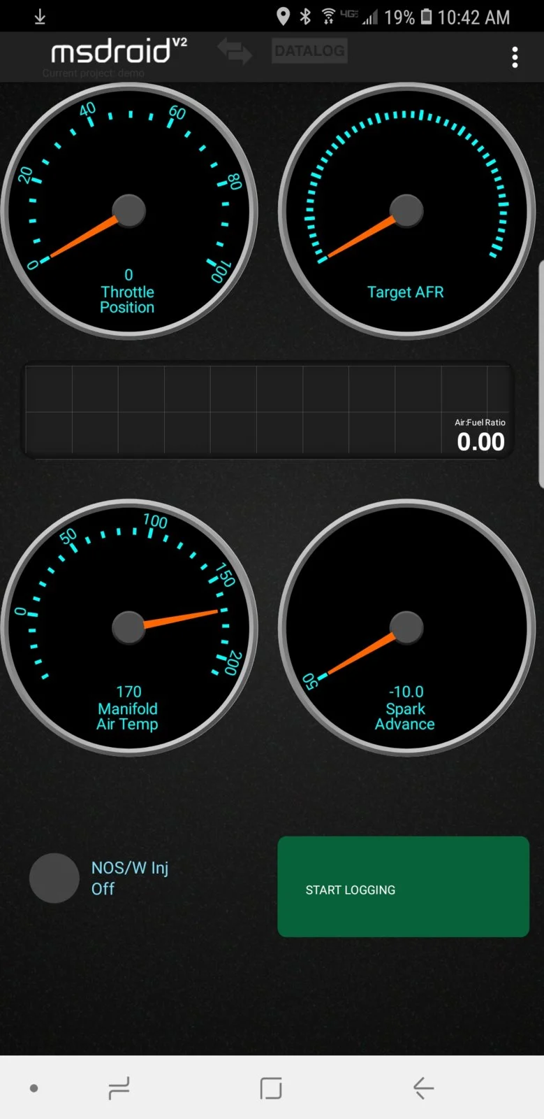

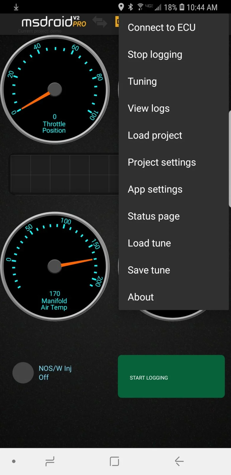

I've been working on the MSDroid Pro app for my phone. Getting ready for easier data logs and not having to plug the laptop in to tune.

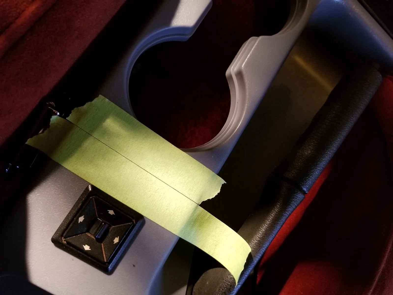

Installed the factory cigarette lighter / charger port and the usb w/ aux jack. When I get the knock sensor installed it'll be a listening jack. ( won't need it but it's cool....doubt I'll be able to hear knock over the turbo, cam, and rockers )
I laid some masking tape down so I wouldnt mark up the console. Also gave me a center line to judge off of.
Used the mirror switch to square it up. The ports aren't the same size so I wanted to get them as close as possible to square and even. Once installed I even hooked up the bulb that goes on the factory port. It actually lights up now. May change it to one that lights up green like everything else inside this car. Reminds me of all the money I continue to spend.
I traced the inside of the holding nut for the usb thingamabob and used the flat metal plate that goes under the factory port. Used a dremel with a cutting drill bit to cut them out....then used a sanding barrel to creap up on the right size.
Its wild looking at all this stuff that's going to come back out again. The cords reached to the back of my radio and to the adapter for my MS. The adapter for my phone should be here tomorrow so I can finally test this app out.

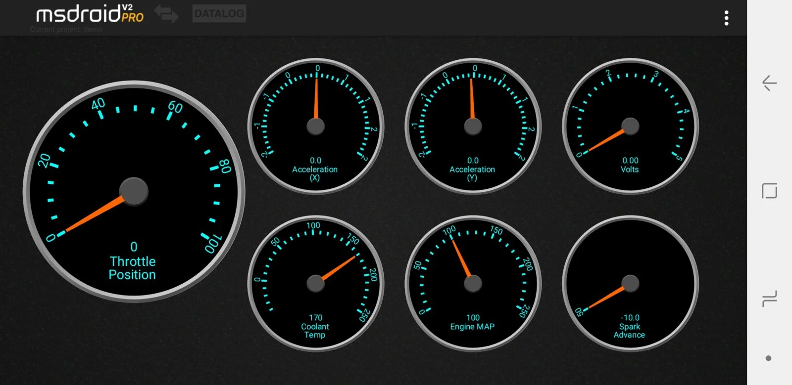

Some things need to be worked out with the MSDroid log. According to it my car idles at -2.3 psi. My gauge was showing me about 12in vacuum which is normal for my car at 8- 900rpm.
