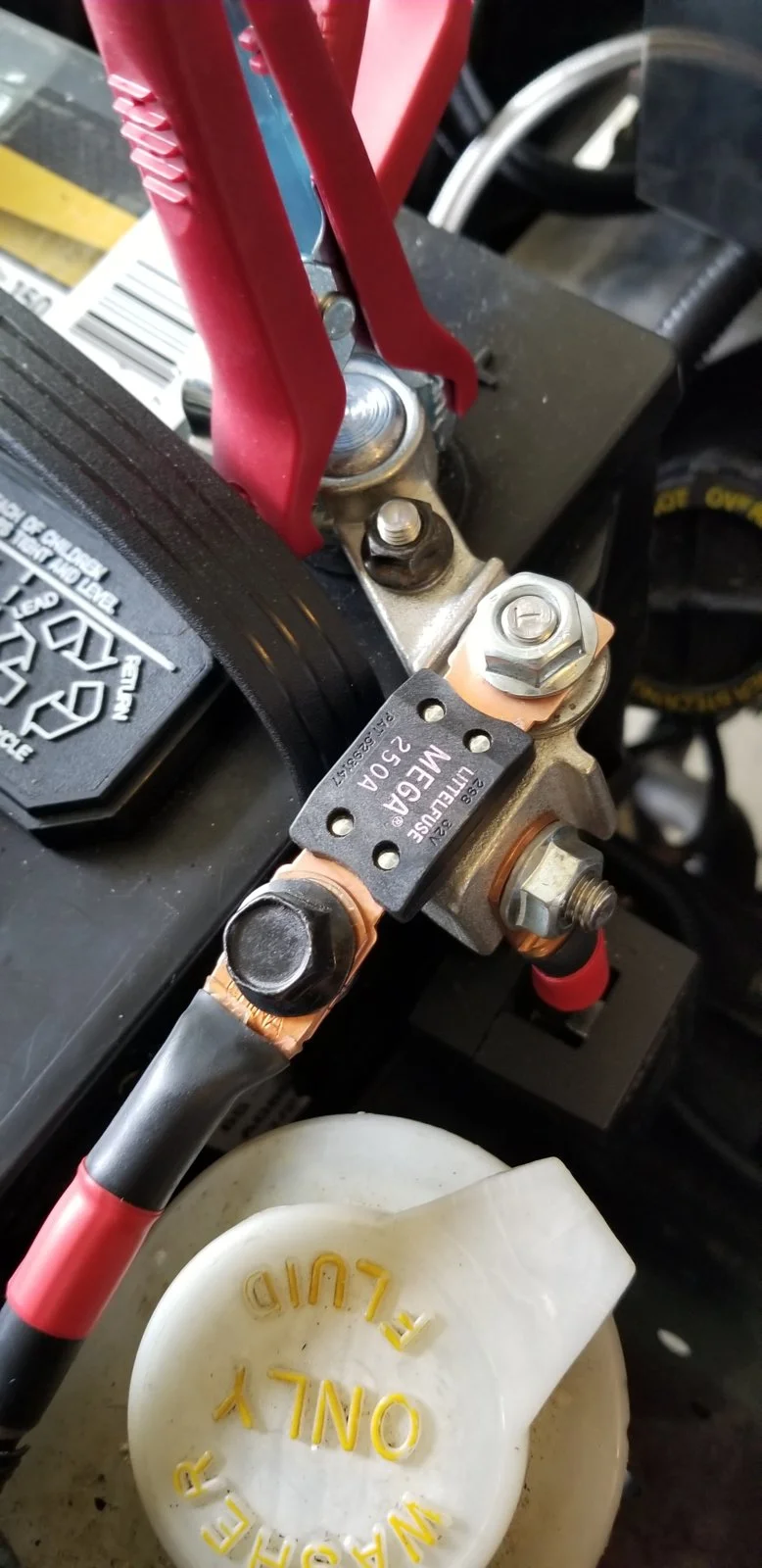

Added a 250amp mega fuse to the main battery cable. I went through all types of ideas to do this. Was going to order a mega fuse box like the alternator one, that thing is too big. Then I bought more cable ends to cut the cable and add it behind the fender, that defeated the purpose and put it after the metal it passes through. So...I came up with this. Coulda saved myself 5 bucks...no cable cutting required.

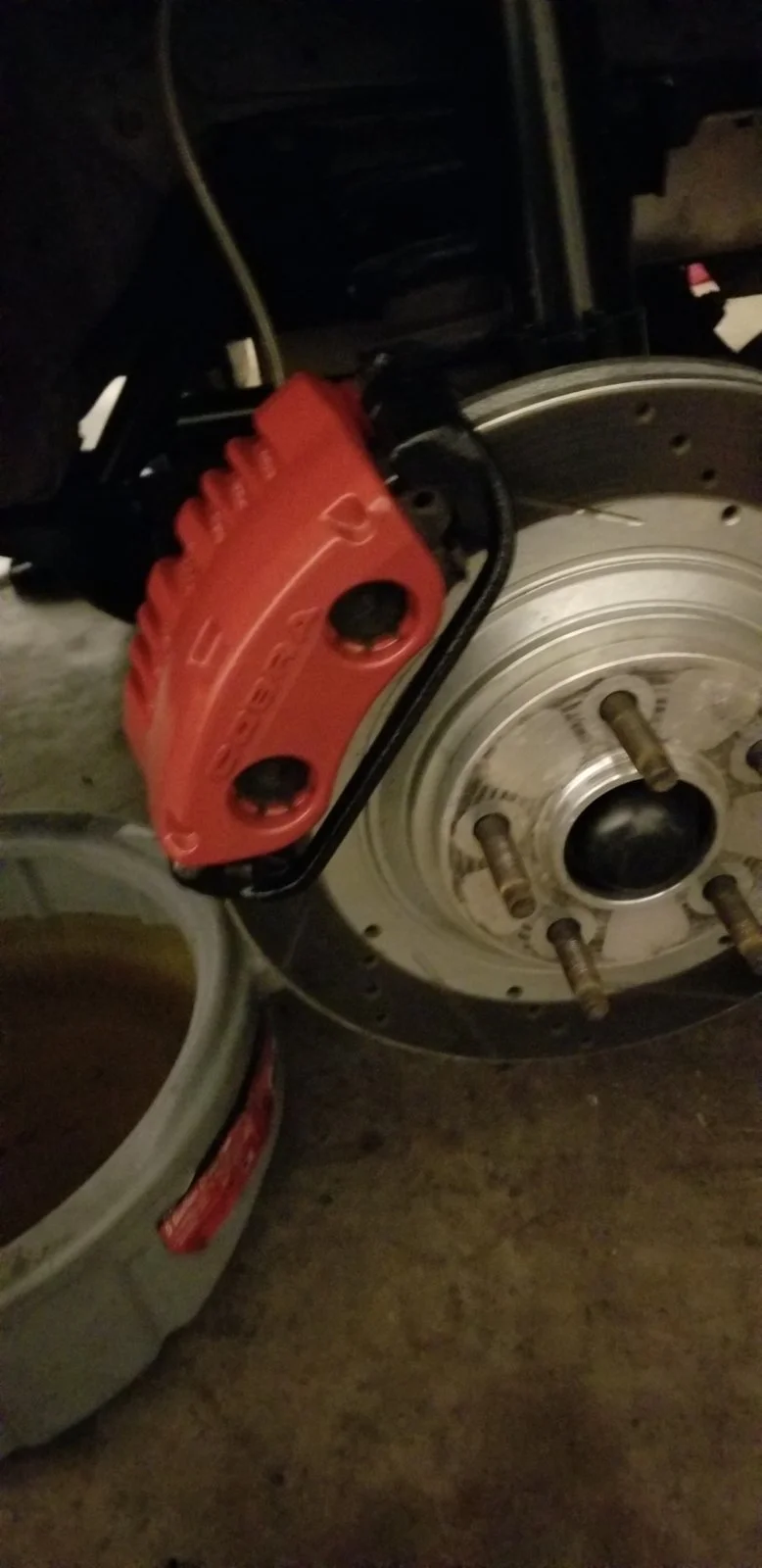

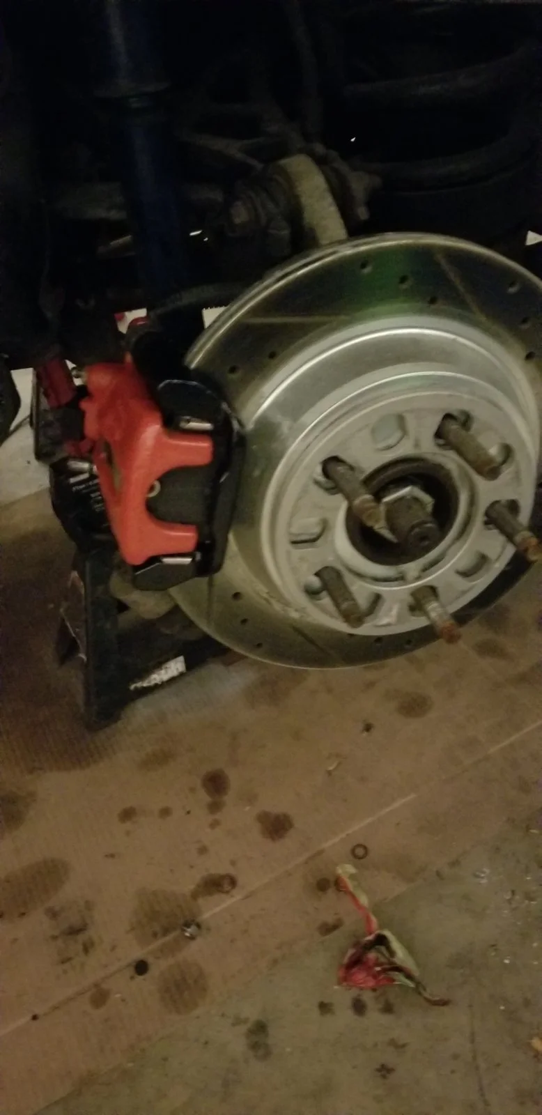

Got the calipers mounted and bled the brakes with my mighty vac. Haven't started the car yet. Pedal travel feels a little weird. There are no leaks but feels like air is still somewhere in there. I'll find out tomorrow.

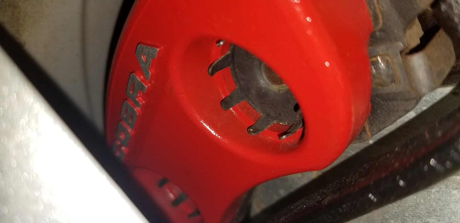

Tried to paint the " Cobra " script with some touch up paint I have for the 19....yeah don't try that. It had a bad reaction with the caliper paint and wrinkled the " C " up. Luckily, I was still in the process of doing that first letter. I wiped it off, red paint too. When the paint fully cures I'll sand the red off the top of all the letters and see how the bare aluminum letters look. If I like it I'll clear them and call it a day....if not then I'll paint them black with different paint that's the same ceramic paint as the caliper paint.

What did that battery terminal come off of? I could use something like that on my car to get a few terminals off of my starter solenoid.
When I painted my cobra calipers, I did just what you are talking about on the lettering. I think makes a good contract between the black calipers and the aluminum colored letters.

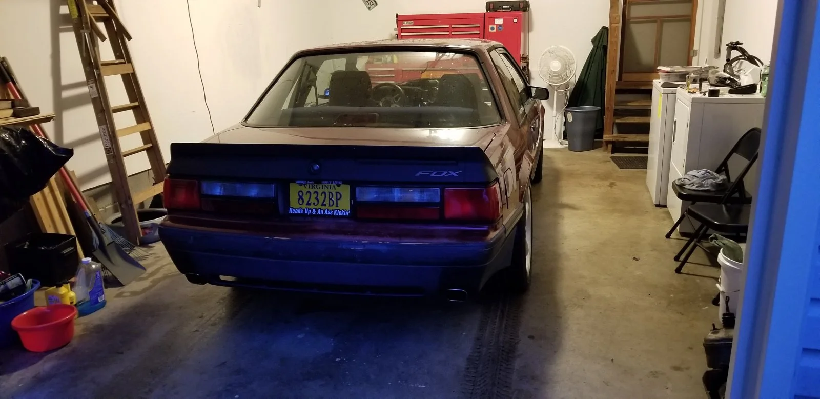

Here's how it sat last night. Ignore the old washer and dryer in there.

Proof that I did complete the calipers.
