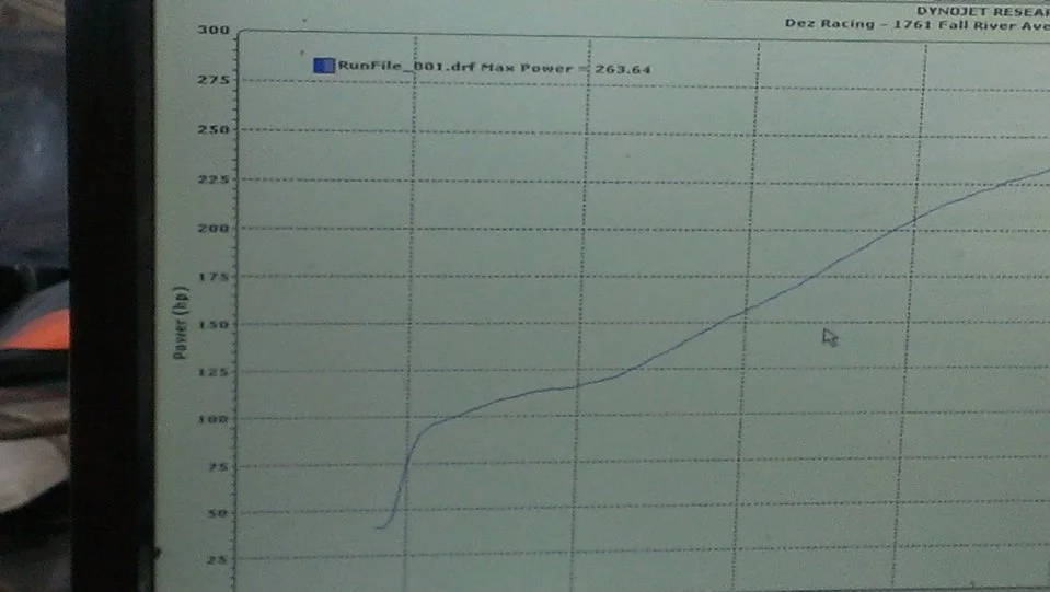

1st run, stock timing, popped a cap off the nipple for the egr coolant line, coolant every where. Getting it fixed and then we will see what happens.

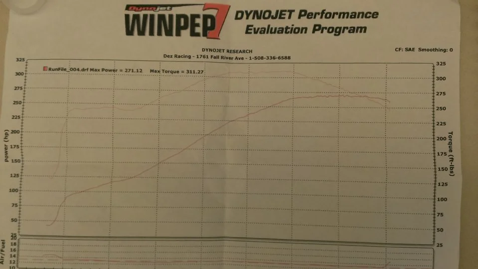

It made 271hp and 311tq after dialing it in. I am not super thrilled with the hp number, but not disappoited either. I think it is right about where it should be. The limitiations are what you guys already know, shortly headers and chinese junk intake. I think I could easily pick up 10 15 by swapping those out.
Are you running stock electronics? No tuning device i.e. PMS or chip? I don't remember what intake you are running. But a good intake, tuning equipment, full-length Headers should definitely get 20 more horsepower
Stock electronics, there is a chip though. I already reached out to tmoss about porting an explorer intake I picked up ($45). I think I want to keep something with a longer runner for the low end torque. Tuner recommended staying with the gt40 style intake if it is only a street car. He said if I am looking for a higher HP number go for a systemax II with a power pipe.
I had moss port my ho lower and I removed the pre-cats on the stock h-pipe and I picked up 23 hp.

We've all been there! Should be a solid fun driver. And I wouldn worry about the "numbers". They don't mean much.
