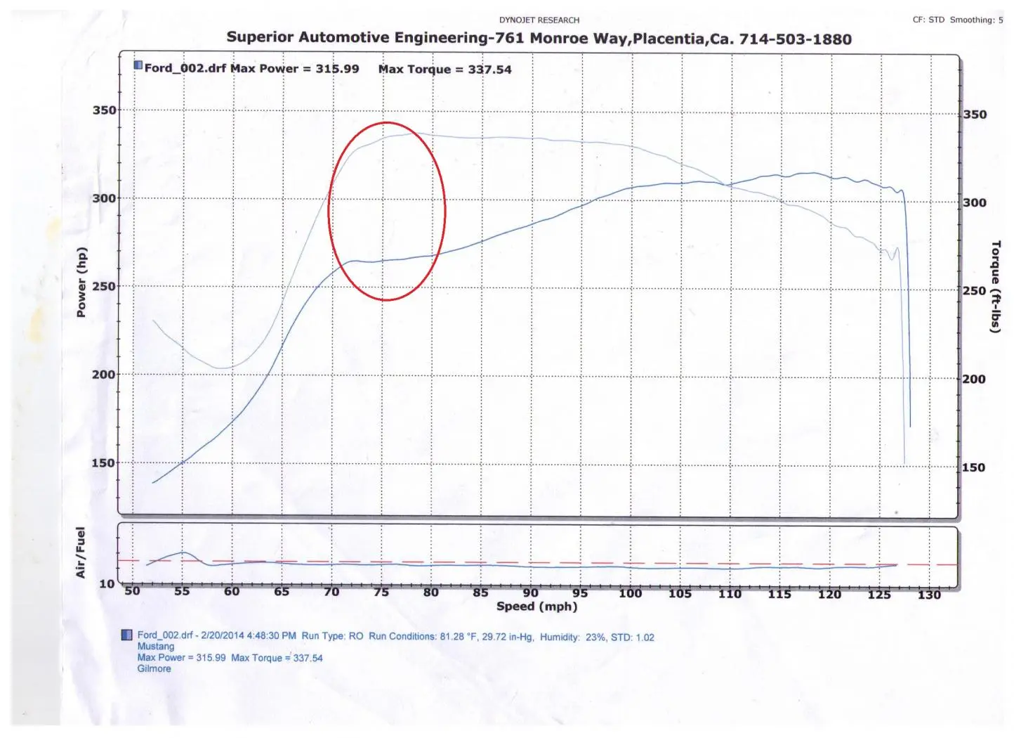

3) Appears I lost the dyno chart, but aside from the A/F, the other interesting thing was that the HP curve shape looked about what I wanted it to look like (peaked around 5800, pulls till 6000), but the torque curve had a huge spike at around 3500 and started coming back down. Is there any reason for that? The dyno shop owner was surprised it didn't keep building, and whatever caused that probably caused my peak #'s to be lower (had the curve followed what it was doing up until 3500rpm, it would have corresponded to higher torque numbers throughout, and obviously higher hp figures).
The A/F ratio had just leaned out around that rpm range, which may explain some of it.

Well, I go to the dyno place last Wednesday and they've done a partial run, which they said they stopped because they heard some valve noise. The had taken it to 4200... and it was already making 254 hp. My eyes got kinda wide and i said valve noise be damned, I'm going to see the rest of this curve (I did have them adjust the valvetrain to reduce risk a bit, figured it wasn't a horrible idea.. they may have just ripped me off who knows).
Results: 316 rwhp, 336 rwtq, and my tires lost traction on the dyno :woot:
Obviously the biggest change was the previous dyno was a Mustang dyno and this was an accelerometer based dyno (thats how the guy described it anyway, he told me what they're called but i forget, just said it was not a Mustang Dyno).
And unlike last time, I didn't take the time to clean the filter, secure the header bolts/remove exhaust leaks, give it fresh oil, check plugs, etc. Plus... definitely missed peak torque due to traction, so the cinder block mod might come in handy too. Might be a few left in there :hmm:
Insert happiness! Interestingly TD68302 is still the winner, though he's now MUCH closer (within a horse on both counts). Though if I actually take the time to prep it... might have some left in it.

And chart attached. Woohoo!
