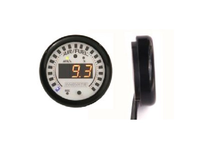

I got my LC-1 through www.DIYautotune.com and the XD-16 guage from Jegs. If I would have known Krazy Koncepts was a dealer, i'd have got them from Jon. The guage was not cheap, but being able to program the LED's to the color I want helps when your running down the track. 10-11.99 is green and 12.00-20.00 is red. When I'm racing, it is very easy to read and if you see red, you get your foot off the gas. ahhh,...Good times.....:nice:
