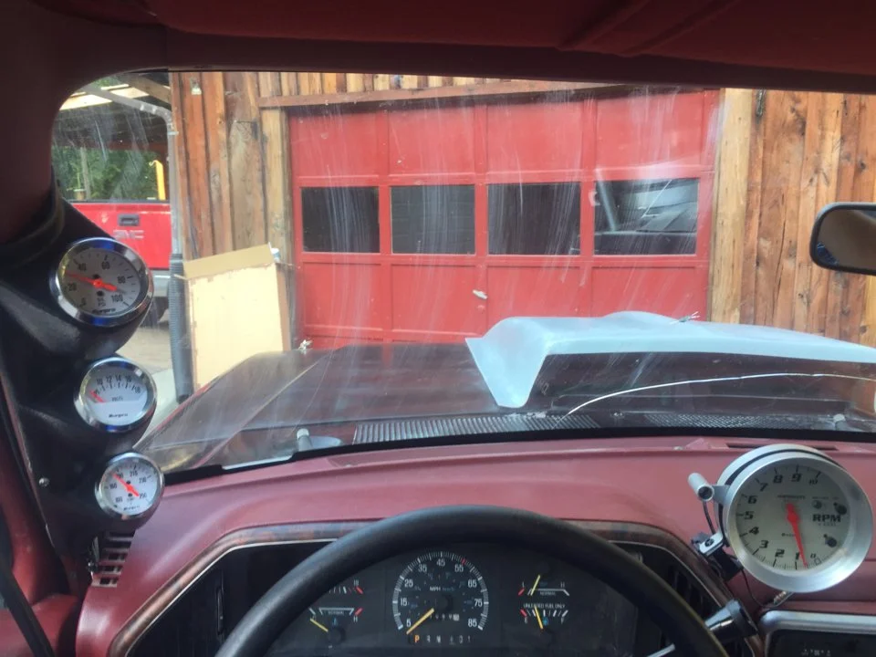

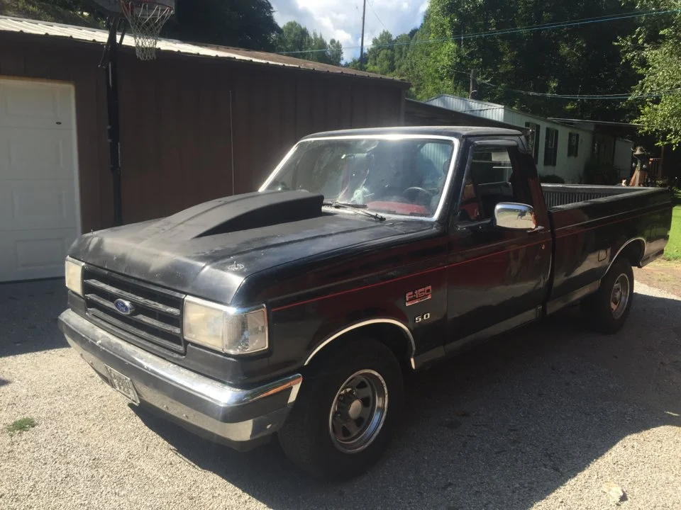

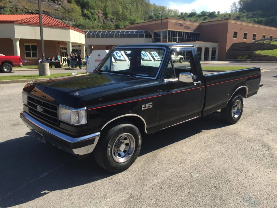

Also I know this is A mustang forum but what do you all think of my truck? I'm 18 and built it from the bottom to top, including I did the paint and body work.
Very nice, although I have to be honest.....I liked it better with the stock hood.
....but, you're 18, so I understand why you think it looks good. ;)
