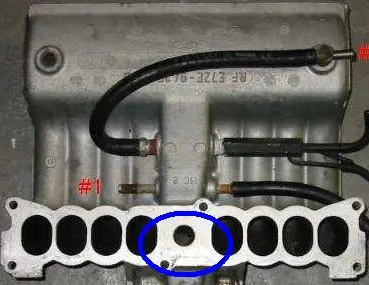

I blocked off the holes in my heads, made a plate to go on egr spacer. Now i am debating blocking off the hole between the upper and lower intake. what would be the best way to do this? i have seen ppl do it with a peice of a soda can stacked on top of the gasket. Any ideas? Thanks..
Not sure what you meant by the piece of soda can - but anything in the middle of the intake interface that's thicker than the rest of the gasket (a piece of soda can) has the potential not only to create a vacuum leak, but also overstress or crack/break the upper when you tighten it down. I would not do that. I'd tap threads into the upper egr hole, and screw a plug into it such that the plug doesn't interfere with the mating surface (deeper than flush). But, if you blocked off the egr holes in your heads, why block off the hole in the upper/lower? No exhaust gas can reach it anyway. Unless you're talking about blocking off the air injection holes in the back of the heads. If that's what you meant, those holes are different than the egr holes - the egr system and the air injection system are two different systems.

I did think about the soda can creating leaks/crack. I thought about tapping the intake or my phonelic spacer (prob. go for the intake) but have to find the right drill/tap.
i did block off the holes in the back of my heads, those are the air injection holes right? the smog bumps in my heads are not plugged if thats what you are talking about. (is that even possible?)
in other words, i still have to block off the hole that is circled in this picture? is there a gasket out there that would block this off?

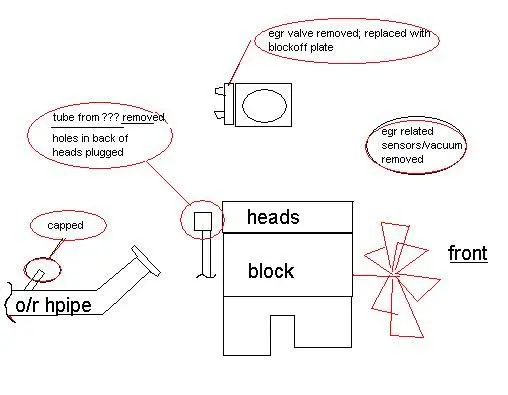

see the pic for my setup. im having trouble remembering, someone help me...
does the smog pump feed air to the hpipe via the tube on the hpipe, and the tubes for the holes in the back of my heads (where do they go to, i cant remember)

Bock's got an answer for you - and yes, the hole circled is the one to block if you're trying to prevent exhaust gas from reaching the upper intake.
thats strange.. my phonelic spacer does have the hole. anyway, now im thinking about counterboring a place for a washer to block it off, but still not really sure if i even need to. i have the egr spacer blocked off where the egr valve used to be, and both holes in the backs of the heads are welded shut so, i guess there really isnt a need to block it off on the intake. Right?? Thanks...-a
