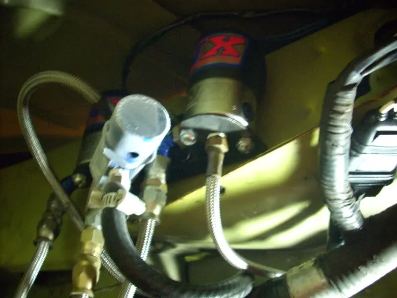

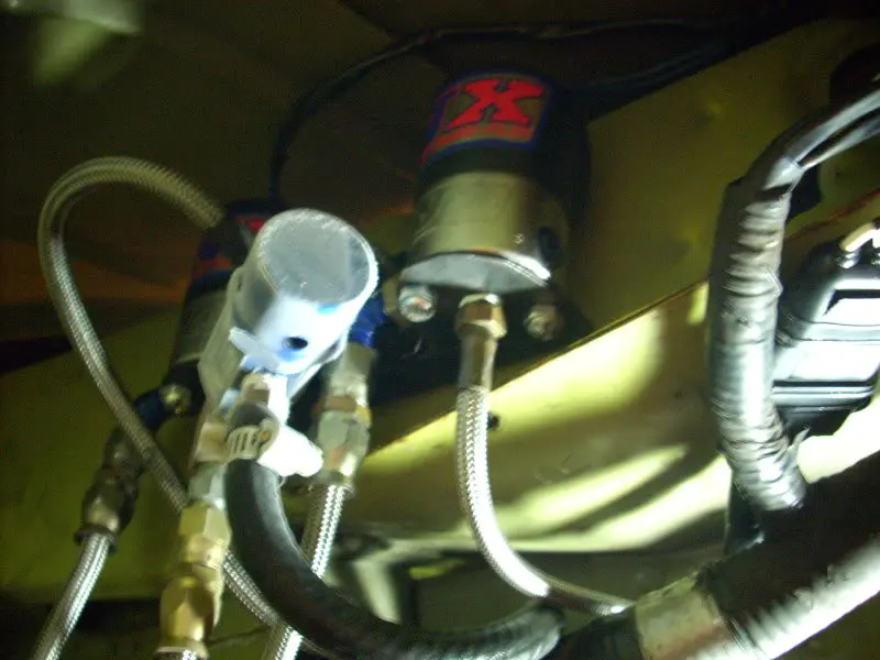

Once you get a tune it's a non event. Until then, you will get a check engine light, but the car won't run super abnormal, just a little mid throttle pinging like everyone else said. All those plastic lines run up under the passenger side inner fender to a bunch of control solenoids. If you have already removed your smog system, that whole solenoid system can be removed all together. The red line off the back of the intake supplies vacuum to the system. Removed the right front wheel, and the plastic fender guards and those vacuum solenoids are mounted to either 2 or 3 studs clipped to the inner fender there. I don't have a picture handy of those vacuum solenoids, but it is a fairly large assembly. Unplugging it from the computer does not throw a code. Those studs actually offer a great place to mount nitrous solenoids.
