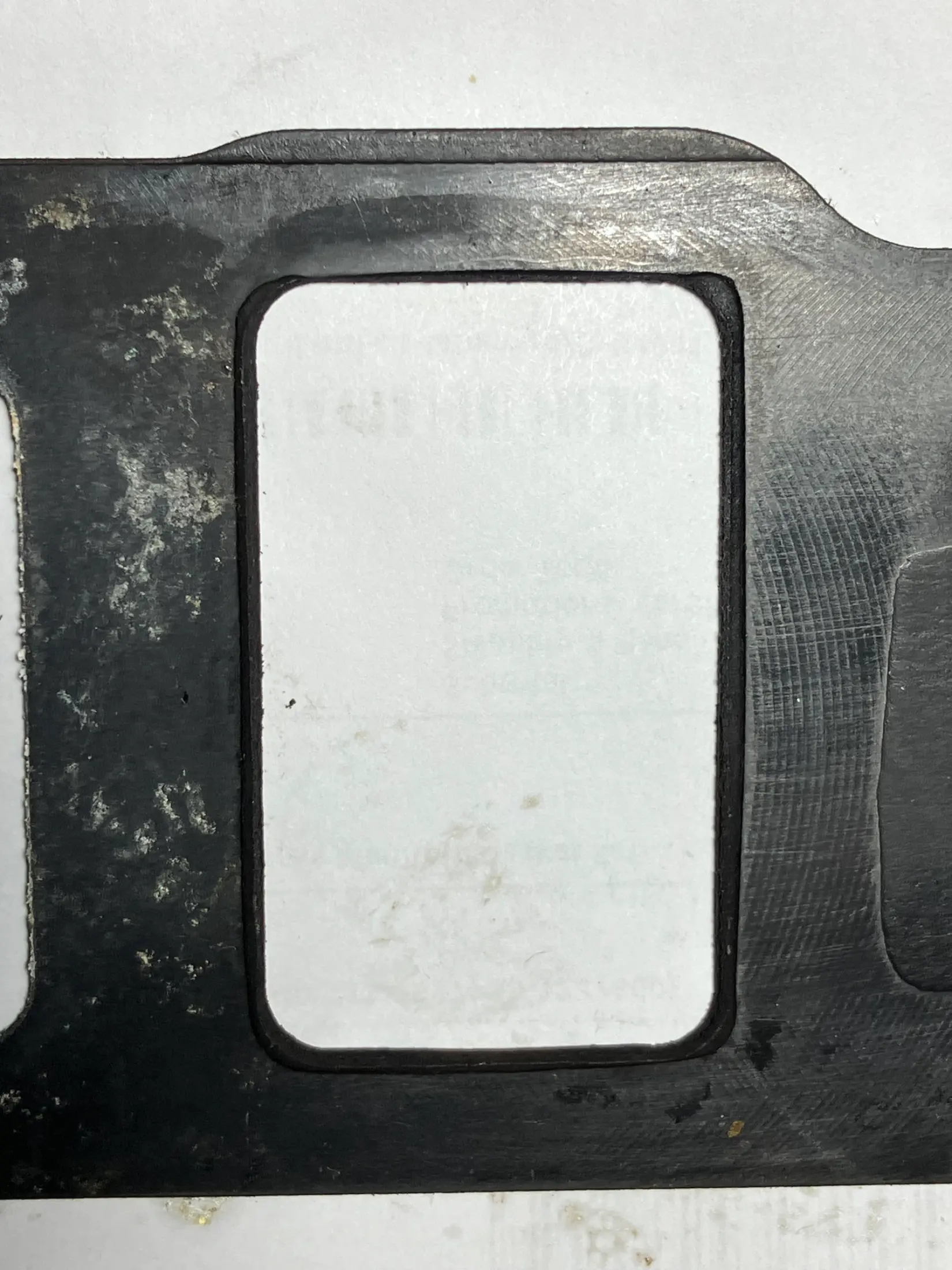

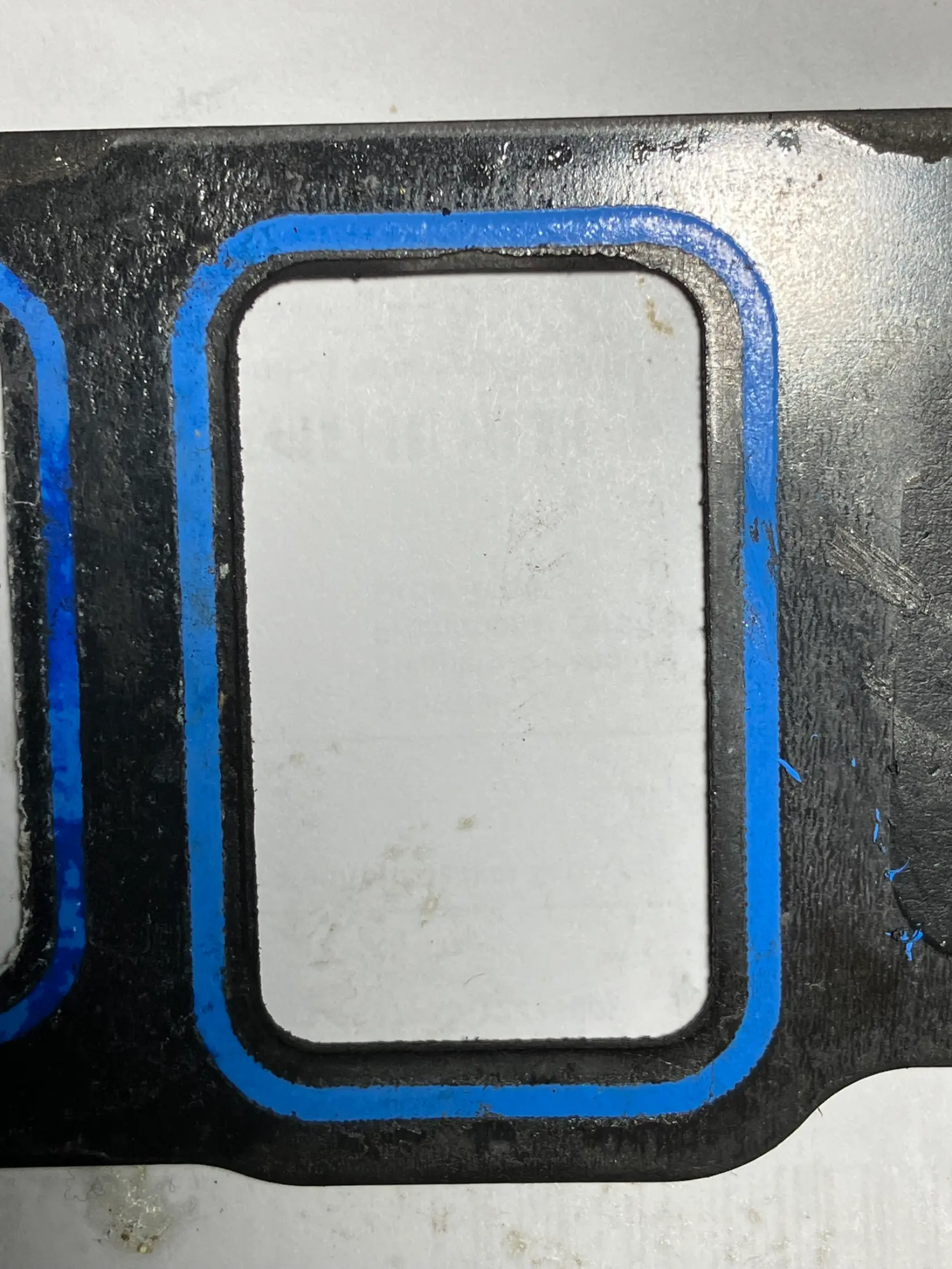

I’m putting the top end back together.
Upon removal of the lower intake I noticed the gaskets are hanging inside the ported creating bump to the airflow. The instructions on the Felpro gaskets say to stick the gaskets and to trim the gasket hanging inside of the port with a sharp knife.Unfortunately this might apply for the regular 1250 intake gasket but do not apply to the 1250S-3 which has steel laminate here and it is impossible. I’ll post a pic from the head’s mating surface and the upper intake side. It is not that much but still not a smooth transition and I don’t know how much it affects the airflow.

A 1250 is 1.20” x 2.00” where a 1262 is 1.28” x 2.10”. Any chance the bigger gasket will work?
Reactions: PonyGTrider
