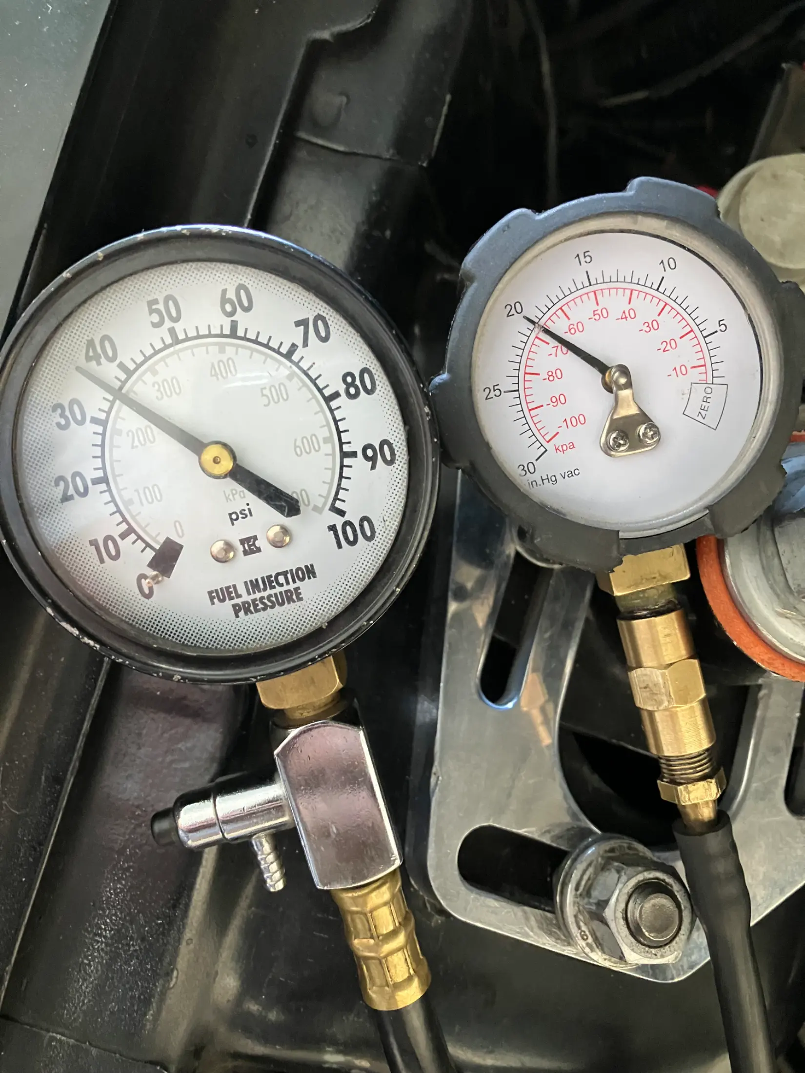

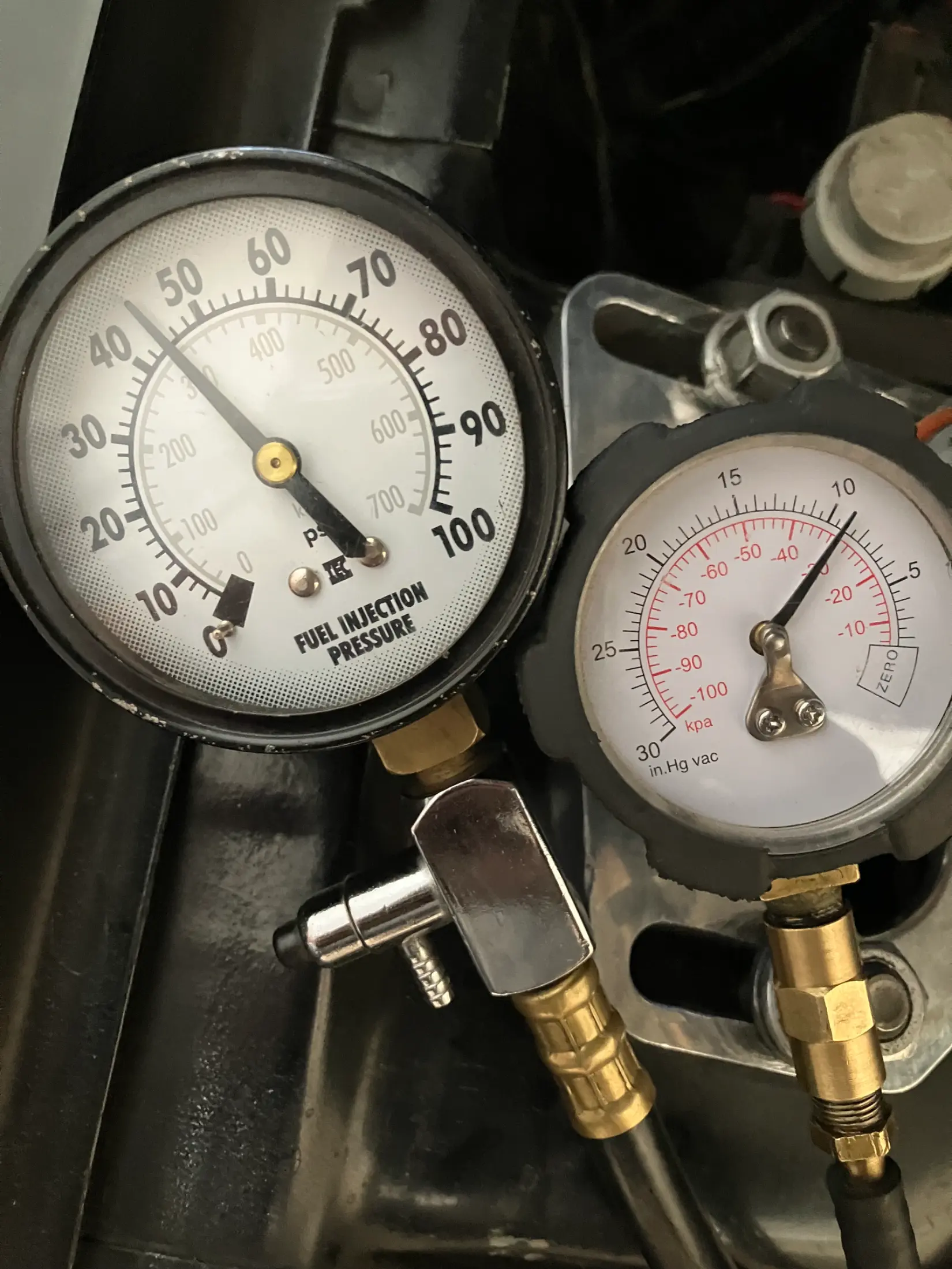

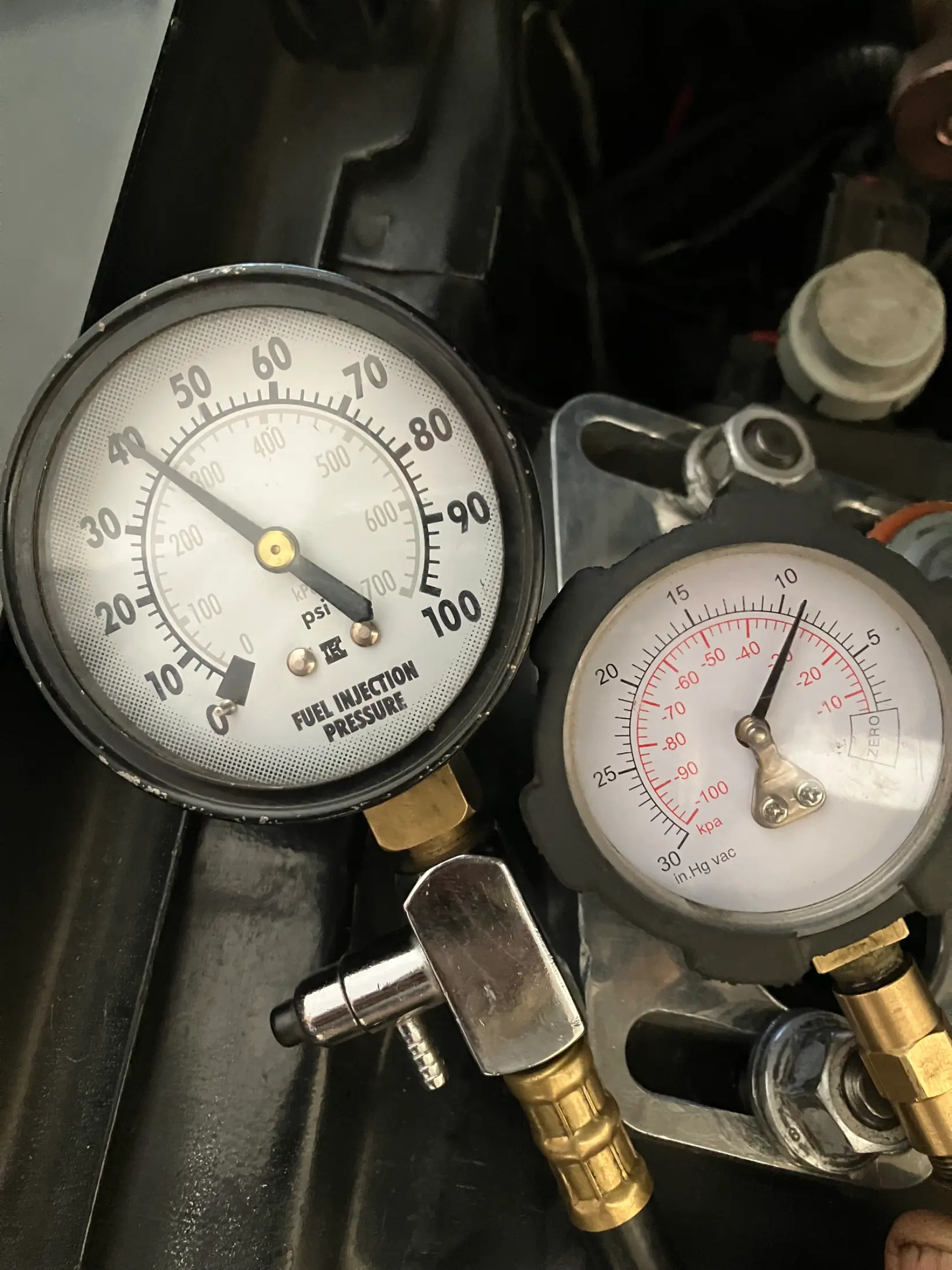

Ok here’s a new update:
For a test I disconnected and plugged the EGR vacuum line and installed a vacuum gauge and a fuel pressure gauge then started up the engine I only had ~9.5 inches of vacuum at normal operating temperature why I had 12 inches of vacuum about two hours before???
Anyways, I unplugged the vacuum line from the regulator and my fuel pressure reading was about 44 psi (First photo) then I plugged the vacuum line back to the pressure regulator with about 9.5 inches of vacuum and it only came down to 40 psi (Second photo)
Then just for the sake of it I removed the vacuum line from the pressure regulator plugged it and applied 20 inches of vacuum manually and the fuel pressure only dropped to 38 psi (Third photo)
So why the pressure only dropped six psi when I applied 20 inches of vacuum from 44 psi to 38 psi??? Should I inspect the return line closely for any blockages?????? There is absolutely no fuel smell at the fuel pressure regulator’s vacuum port…

So here is what I found:
The fuel pressure regulator was bad. No leaks just no matter how much vacuum you applied there was no change in fuel pressure as the diaphragm probablyhas hardened. So I replaced it with a good one and when I applied 20 inches of vacuum manually the pressure dropped to 32 psi.
The other problem I found was that EGR solenoid or EVR had a major vacuum leak dropping more than a half of my vacuum, most likely the little plunger got stuck and was venting mora than 50% of my vacuum.
Just for the hell if it I put some very light oil in the ports , shock it and re installed it and so it worked out fine the vacuum bleeding stoped!!!
This was just a quick temporarily fix I have a new EVR order and will be here this coming Monday to replace this old one.
I just filled some gas and should be able to see some progress on my main issue of too high fuel consumption.
