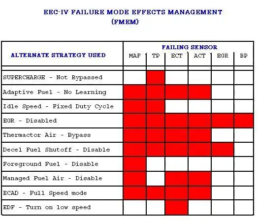

Actually.... as soon as the EEC detects any EGR related failure code, it will shut it down, delete it, bypass it. Since the EGR based spark advance is an "adder" function" based on the EVP output change....... it will not be added. A/F and the other spark advance adders will not be affected or cause any driveability problems (unless something else is amiss) as defined by the GUFB FMEM strategy.
