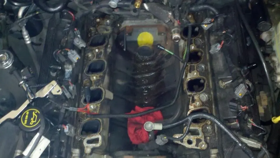

To my understanding there is no performance gain. However, I just did a Intake manifold swap and I was very surprised at the amount of carbon and gunk on the inside of my intake and the intake heads. I scrubbed for a good 45 minutes with a wire brush getting it all off. It runs a heck of a lot smoother now and I'm thinking it was because EGR recirculates the exhaust back into the intake. Here is a picture of it. So, wouldnt removing the EGR keep your engine cleaner?
+1, it would seem as though turning off the EGR and using a PCV pre-filter and even a catch can would reduce the amount of carbon re-entering the engine, therefore keeping it cleaner. I'm sure deleting the EGR does not help fuel economy though, but it could keep deposits from forming on the interior of the engine.

The thin film of goop the EGR system leaves on the intake ports doesn't hinder flow in any substantive way. It's too thin and too evenly deposited to be a concern. And on port injection engines the port bowl and back of the valve are cleaned by the fuel injector anyway.

I run chevron with Techron in all my cars and it does an excellent job at keeping the intake ports clean. I had 37,000 miles on the heads when i recently swapped my intake. my intake ports were as clean as the day i put the heads on. If you don't want to buy chevron fuel then once a year go to the chevron station and buy a bottle of concentrated techron. Poor it in the gas tank and it will clean the injectors along with the heads . It will even partially clean the intake from the sray being in a vapor. Most of those other fuel additives are snake oil and don't work but techron is very good and works very well.
