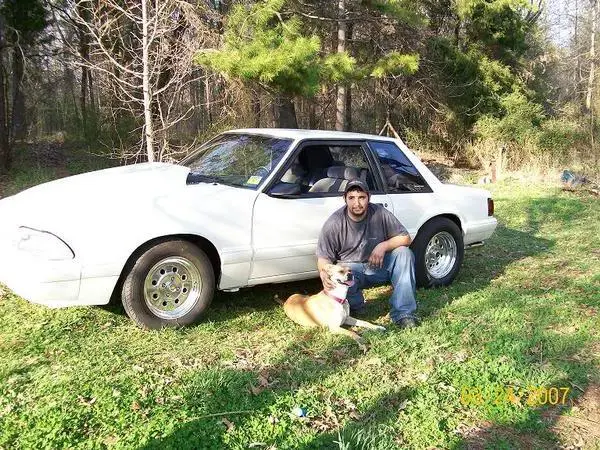

That car that I installed the springs on we only put the rears in. And left the stock 4cyl springs in the front.
Here is a pic of the car coming out the hole.
Edit This is the only pic I could find on the car just siting still. The back sits a little high.

It took the springs about two months to settle in and sit like that. Did sit real high in the back at first.

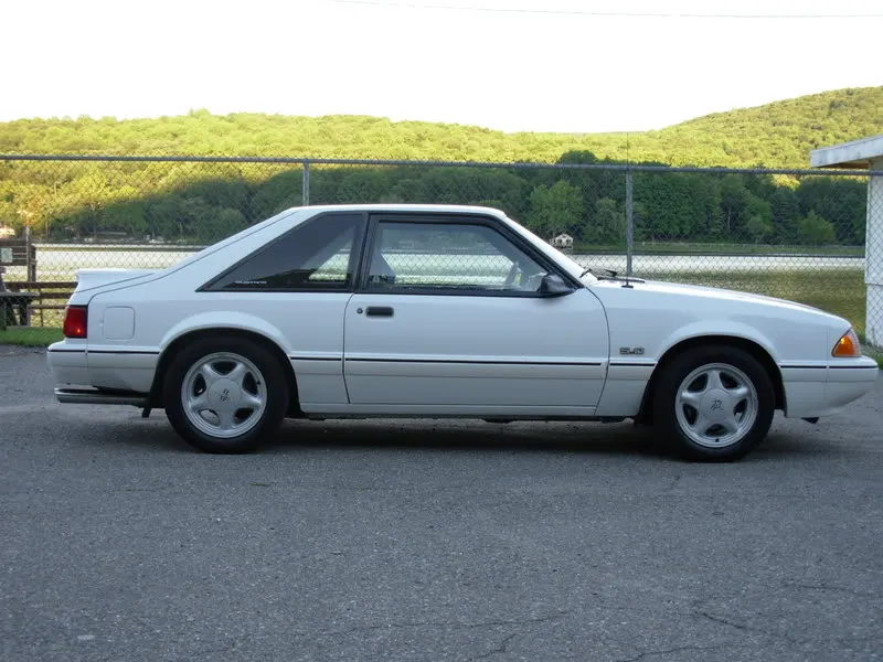

When I get home I'll post up a pic of mine. It's totally stock looking (16' ponies) so it will give you a good idea how it sits. Ive heard of people cuttung the springs but only because they couldn't get them in.(The fronts are a btch too put in)

It's on level ground and they are stock size tires also.
