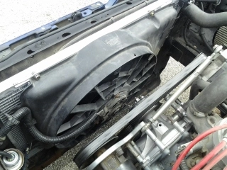

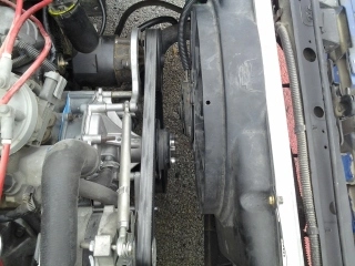

I made some brackets for my Taurus fan. Didn't bother to make a shroud to cover the whole radiator. Honestly just didn't feel like it at the time.

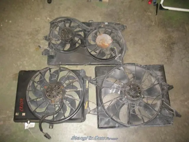

Do you guys have any pics of these junkyard fans mounted? I'm curious on how they look and how to mount.
This is a Ford Taurus fan that I picked up (free) mounted on a stock radiator. (for now) Monster can "overflow tank" lol

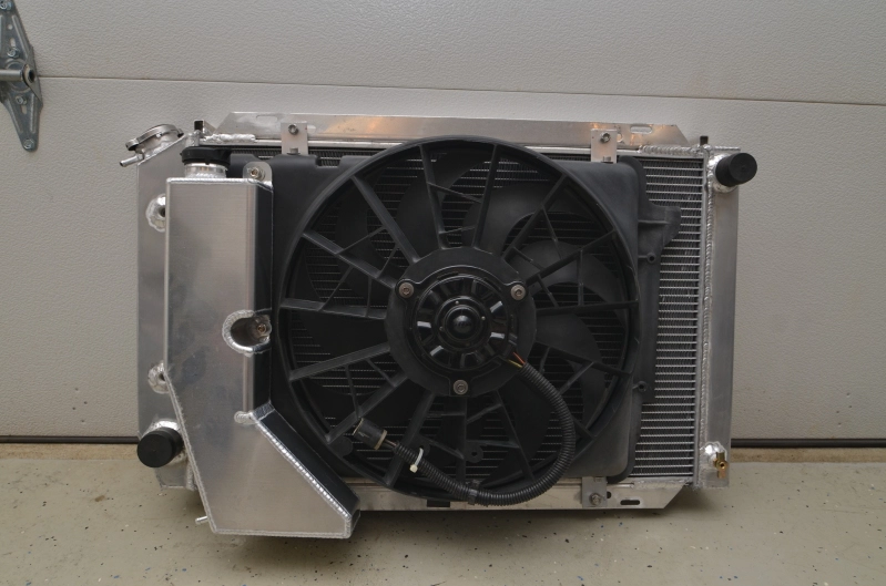

Im waiting to get the rest of my parts to complete my h/c/i setup, then the fan will be mounted on my Griffin aluminum radiator.
