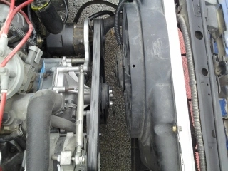

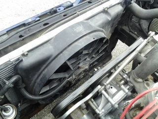

Exile said:
This is a Ford Taurus fan that I picked up (free) mounted on a stock radiator. (for now) Monster can "overflow tank" lol
Im waiting to get the rest of my parts to complete my h/c/i setup, then the fan will be mounted on my Griffin aluminum radiator.
I live in Texas, and it always stays nice, and cool!
I have been running a Taurus electric fan for a while now using the stock 91' Mustang alternator, and have had no problems. (yet)
Here's the math, so see for yourself...
Electric fan = 3G alternator if you want long life & reliability from your car.
The electric fan saves some HP. The stock fan's parasitic drag runs from 7-12 HP depending on who you talk to. The electric fan uses about 1/2 HP of power from the electrical system.
Figure this:
Ignition system & computer = 12 amps
Fuel pump = 12 amps
Exterior lights = 15 amps
Fan (heater or A/C) = 15 amps (can run between 5-25 amps depending on setting)
Radio & instruments = 10 amps
Wipers = 10 amps
That's grand total of 74 amps from a 65 amp alternator. Talk about overdrawn at the bank!
Figure this:
Fuel pump = 12 amps
Wipers = 10 amps
My Car/Figures:
Fuel pump = 12 amps
No Fan (heater or A/C) = - 15 amps
No Radio = - 10 amps
Wipers = 10 amps
Grand Total of 49 amps from my 65 amp alternator.
But I know what your saying, and a 3G alternator is in my plans for the near future!
