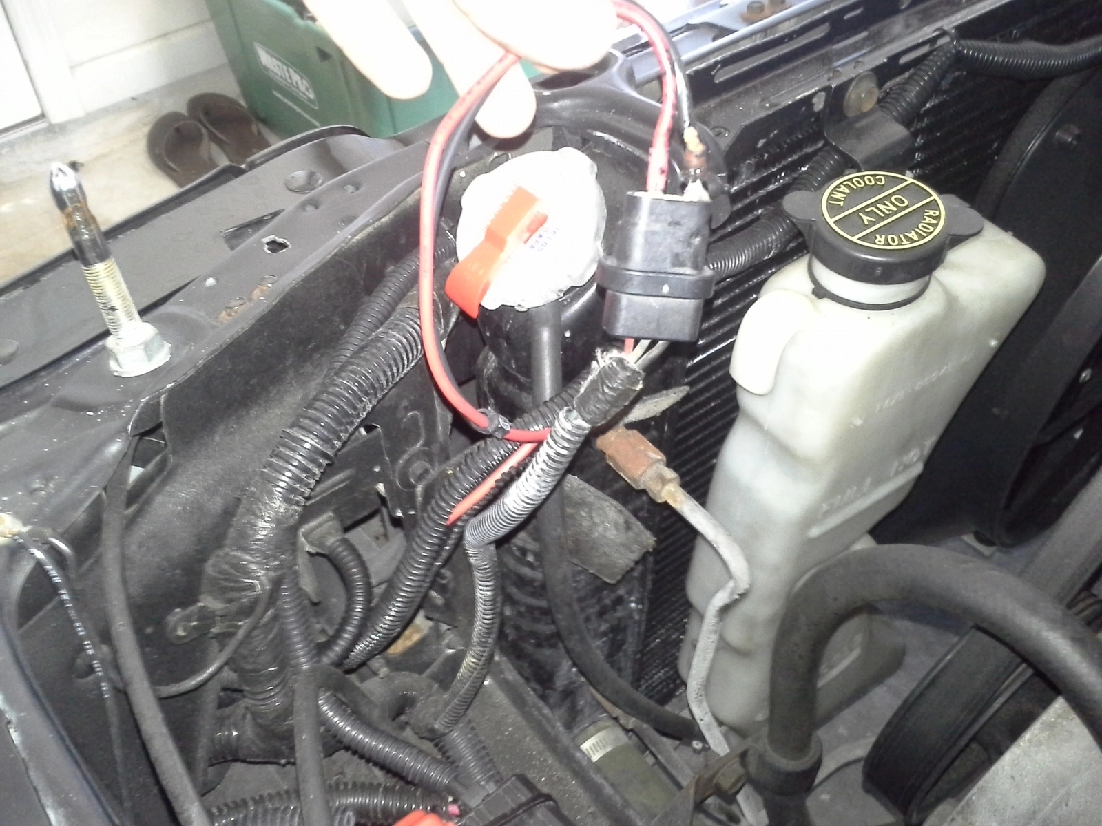

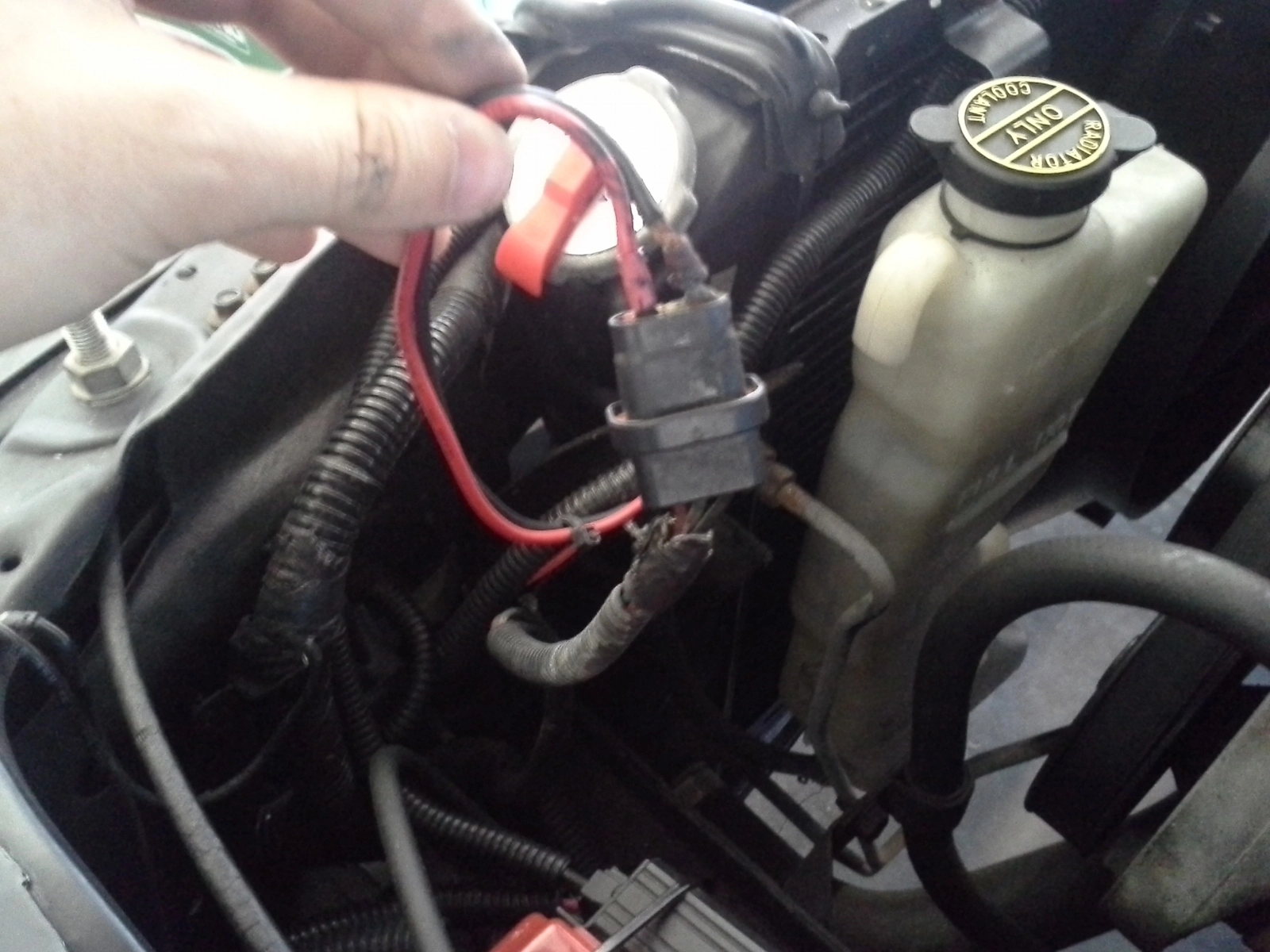

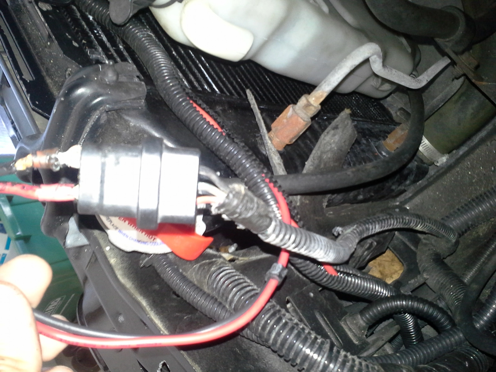

My electric fan (Black Magic 185) crapped out and I believe the culprit is the harness it's connected to with the RED, GREEN, and BLACK wires.
Anybody know what this harness was originally connected to?

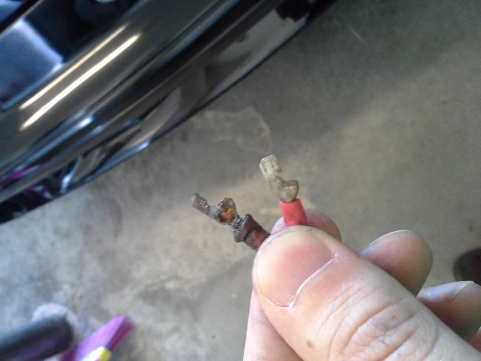

The dude who put the fan in cut the male ends in half to make them fit. The Green wire was not used and the black was ground, red 12v power source. By cutting them in half, no wonder it melted.
My battery was relocated to the trunk was I assume he did it so e wouldn't have to run a wire all the way to the trunk. Is using this harness safe? Anyone know what it originally connected to? Thanks

I can't identify that harness. Almost looks like the plug for the coolant level sensor, but I could be wrong. I can tell you, however, that is absolutely not a safe way to power a fan. You need to power it through a relay. Pull 12v from your starter solenoid and run in into a relay and then to the fan. Are you manually controlling the fan or do you have some kind of controller?

I agree that looks like it is wired to the overfill tank wires and the guy just stuck a few female connectors into the male connectors of that plug- def NOT how to wire the fan up . as + wire for that fan is pulling too much amps and is overheating. Is this the BM fan with the thermostat on top of the fan controlled by a dial? My advice is to do it right and wire it up per the FAL BM instructions. You should at least put a 40 amp relay inline off a switch with a dedicated pos and neg wires. Pos goes to the + side of the solenoid and Neg to the post behind the battery. You also need to wire for the fan to come on when the A/C comes on..
How do you turn the fan on? Manually or with a thermostat controlled device?
You may not want to hear this but IMO those BM fans are crap to start out with, They don't pull squat for air, always break. Unless you are dead set on keeping that fan, I would recommend either a Taurus 90's 3.8 V6 fan and a FAL 33054 variable speed controller. For about $150 you will have a fan that will move enough air to support 500hp cars and has a soft touch feature on start up so that it does not fry your wiring.

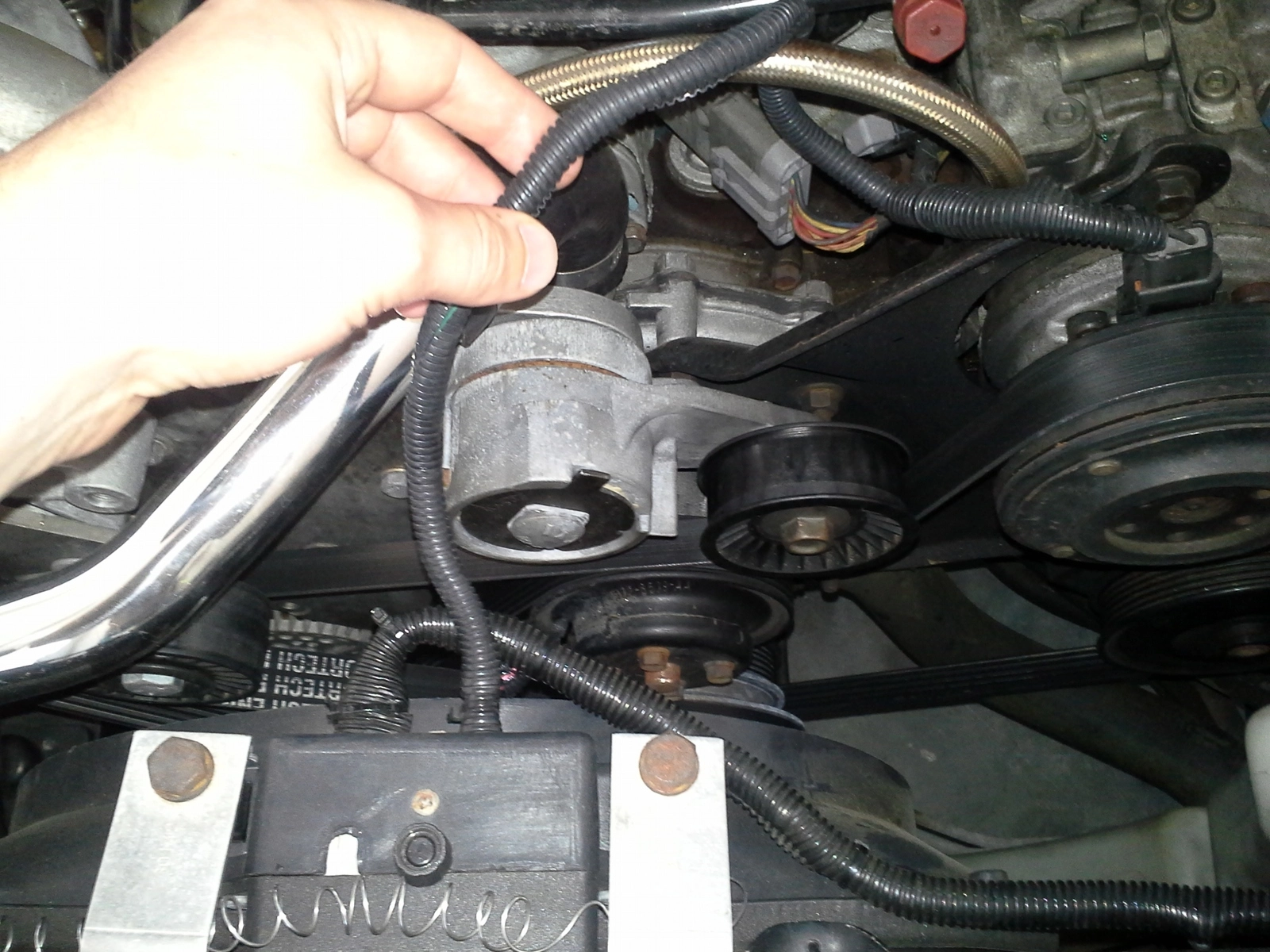

I don't have the instructions available . I'll take a pic of where the other wires are connected.....
There is a green wire that connects to the A/C (the wire loom my hand is holding), and there is a red wire that connects to the starter relay. The black and other red wire, as discussed above.
My battery is in the trunk so I guess I will have to run the ground and power wire to the battery? Are there any other power sources in the engine bay I can use besides the dangerous coolant level sensor?

You can go to the + side of the starter solenoid with a 40amp watertight megafuse inline and for the - go to the dedicated ground post behind the battery. You can go to BM and download the instructions.
