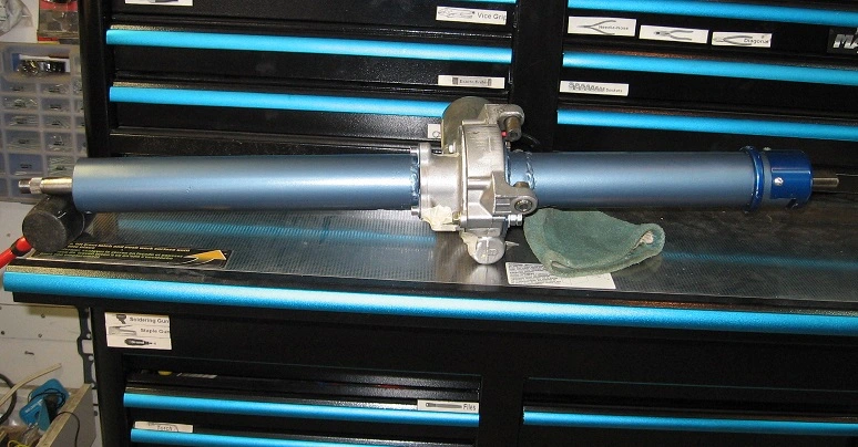

I recently installed electric power steering in a 1966 Mustang. I did not use a kit, I simply pulled a column style EPS from a newer GM vehicle and then spliced the unit into the original steering column.
The results far exceeded my expectations and the cost was less than $200. I designed a controller that automatically adjusts assist level based on vehicle speed, so that the steering feel is "just right" regardless of speed.
I documented (with pictures) how I went about this on a Vintage Mustang forum. If anyone is interested do a google search for "Best $200 mod ever (EPS)"
or
follow this link to page 7 where the details start: http://forums.vintage-mustang.com/mod-custom-forum/787114-best-200-mod-ever-eps-7.html#post6037649
Any questions just ask.

In my 66 Mustang no issue with 1+3/4" SuperComp headers at all, the electric steering box is under the dash not in the engine compartment. No hydrulics, no fluids, no leaks, and speed sensitive assist.
Hydraulic power steering will be a thing of the past soon.
I actually have a manual rack in my car, I just inserted the EPS unit in the middle of my original steering column to get power assist, everything else remains the same.

There is no pump!
Simply a small electric motor that intersects with the steering shaft in the steering column. Current draw when not turning is < 1A. The main advantages are:
1) Variable assist based on vehicle speed, so one finger turning in a parking lot, and sports car feel at highway speed
2) Simple no pumps, hydraulics, hoses (and or leaks and groaning PS pumps)
3) More efficient, power is only used while you are turning, this is the main reason the manufacturers are switching to EPS, the vehicle saves 1 MPG over hydraulic power steering.

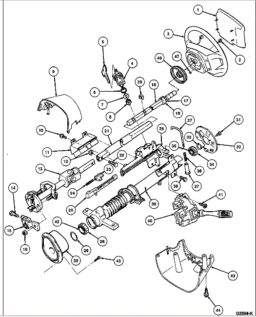

It doesn't look like it will fit with long tube headers. I have my doubts about the fit with short tube headers in a Fox body as well.
I think you missed the write-up, the EPS unit is under the dash NOT in the engine compartment, since my headers reside in the engine compartment, (not under my dash), header clearance is a non-issue. ;-)

Long tube headers have known clearance problems with the stock steering shaft in Fox body Mustangs. It is not uncommon to have to do some hammering on the tubes to get the shaft to clear. Other times, a steering shaft from Flaming River or Maximum Motorsports is the answer. Sometimes loosening the steering column and repositioning things fixes the problem.
Unless your solution uses a different shaft arrangement which includes the slip column required for the collision collapsing feature in the OEM design, it won't fit. There is very little extra room in the clutch and brake pedal area to mount anything larger that the stock steering column; it is a very compact fit.
92-93-mustang-steering-column-exploded-view-gif.106769
The collapsing steering column are parts 17 & 21 in the drawing.
The universal joint/steering shaft (item 13 in the drawing) are usually where the interference with long tube headers becomes a problem.
See https://www.google.com/webhp?source...ng+tube+headers+interfere+with+steering+shaft for 157,000 comments on this common problem
