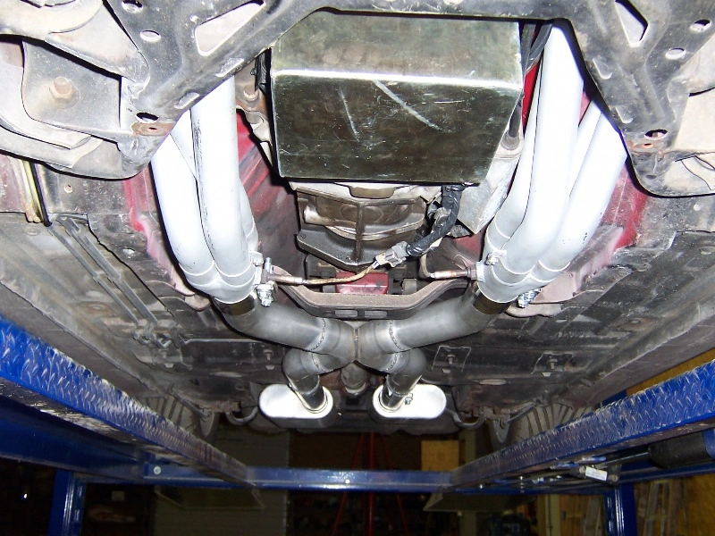

Are those kooks header longtubes? Where are the O2 sensors located relative to the head? I could easily see having the car run better in open loop than closed if the O2 sensors are far enough from the head to have heating problems.

Yup, too far. At idle the O2 sensors cool off and start reading a false lean condition, which causes the ECU to add fuel. On mine it would happen as soon as I started idling, and within a few minutes the trims would be maxed out. If you cannot find a way to keep the sensors hot enough to function right, your best bet may be to try and force open loop just at idle. I would try to keep CL operation available for non-idle so that you can benefit from ECU learning (the sensors should stay warm enough when exhaust flow is higher).
Or move the O2 sensors into a primary tube on each side. That has it's own downsides of course.
Or go with shorties. :shrug:
