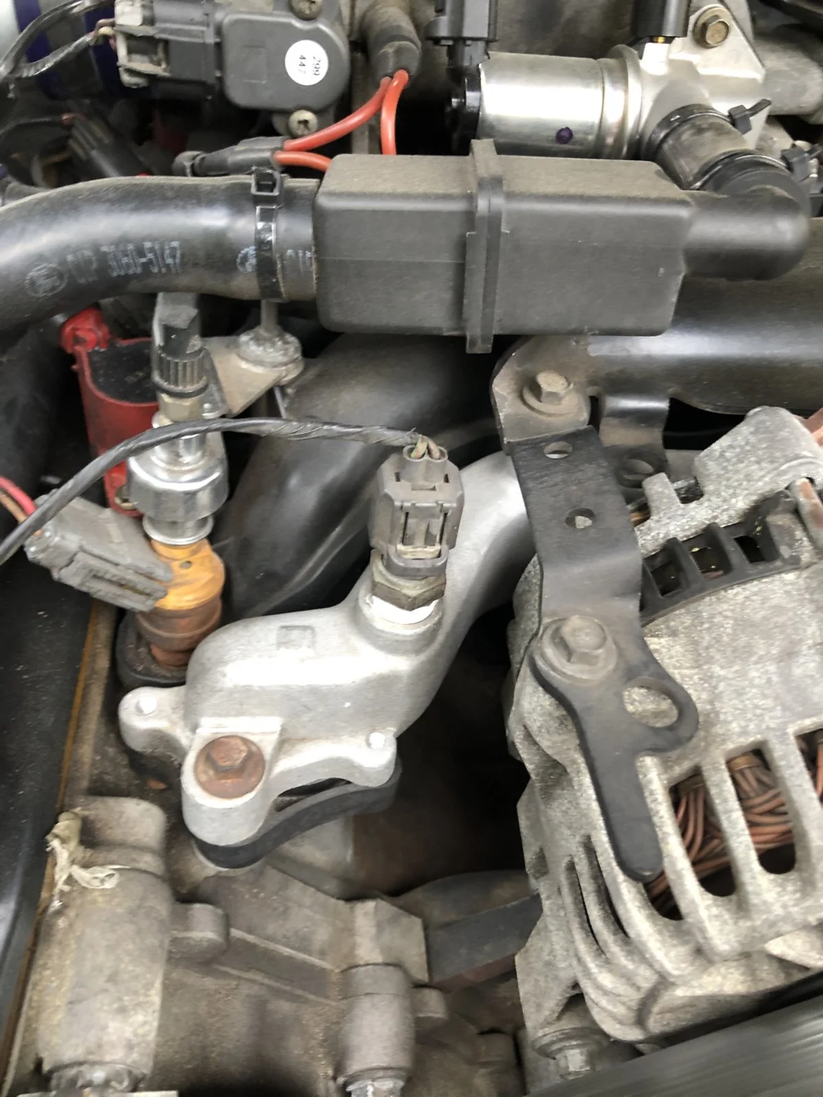

^^^This is the expected results when there's a problem with the PCM receiving a valid ECT sensor signal. This is also what the P0118 DTC is trying to tell you.
Since the ECT value is valid sometimes and not others, this tells me that the ECT sensor itself is likely OK. I would look for a wiring problem between the ECT sensor and the PCM. Think corrosion or poor connector pin fitment.
One way to trouble shoot this is with a "wiggle" test. IE, wiggle the wiring harness while monitoring the ECT value looking for a change.

Is this the ECT sensor?
