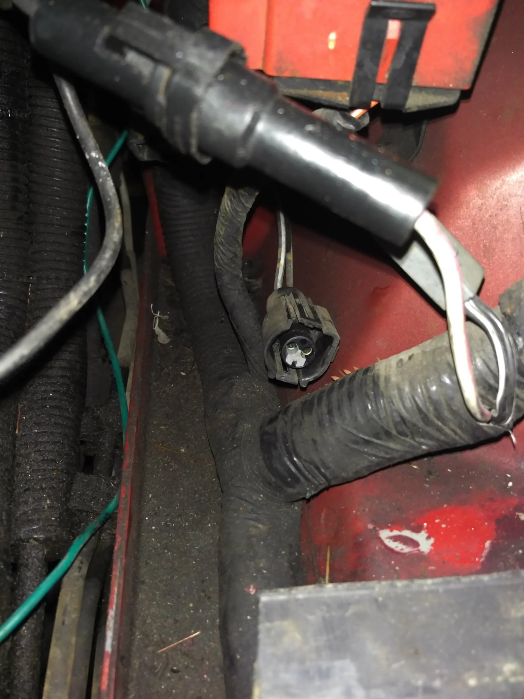

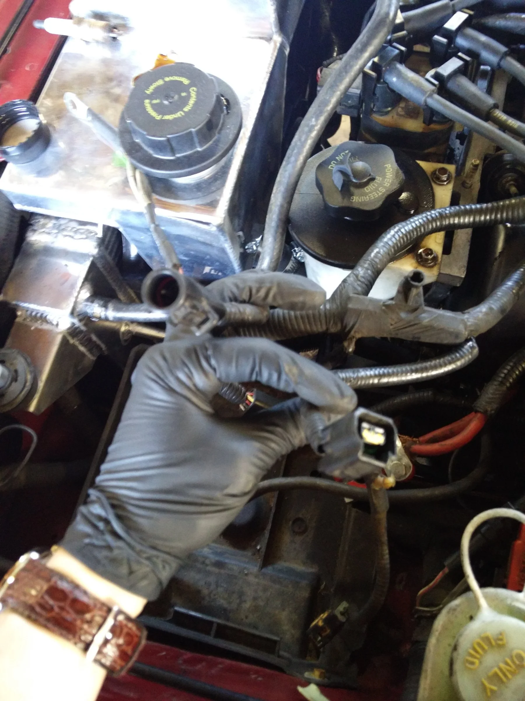

Finally got some photos to show you guys! I did figure out that one of the connectors is meant to go to the Degas bottle, right next to where the lower radiator hose would go. However I have an aftermarket Degas bottle and it doesn't have a spot for that, is this something I should be concerned about?

these are the two mystery connectors at the front driver's side, maybe this harness is meant to wrap around the front of the block? I'm not sure.

this is the other female connector, it is right behind where the battery sits. I am pretty certain this one is in the right spot as it is still mounted in place.
