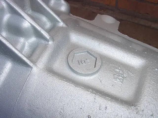

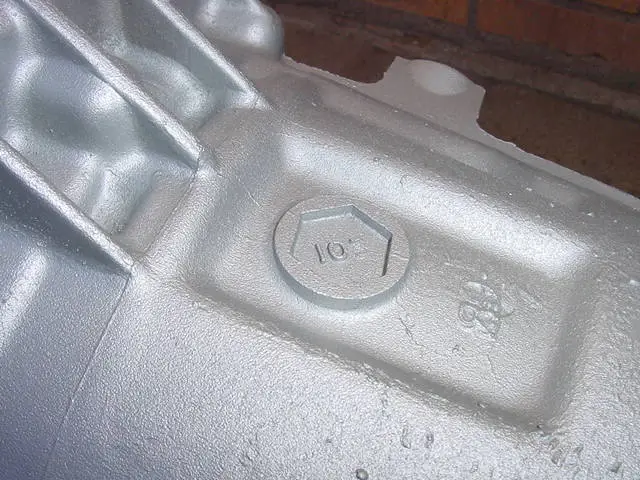

When I was looking for an AOD for my swap, I was told by a transmission shop to look for the hex indentation cast into the top center of the case. This identifies it as the beefier trans. After it's all done, I think I would have been happier with the more expensive AODE swap. I don't like the silly shift pattern of the AOD with second and third sharing a position. The AODE has an electric switch for the overdrive leaving the three positions on the shifter for one, two, three.
