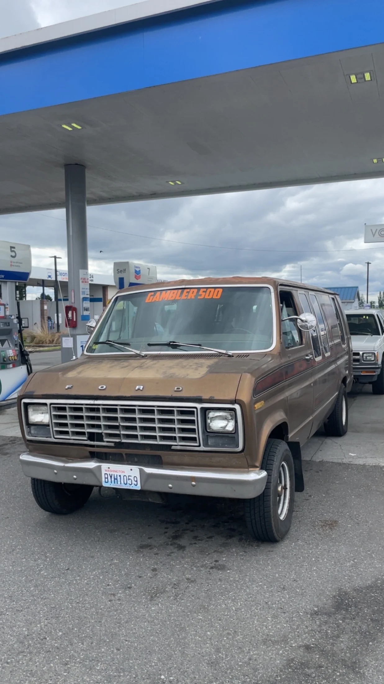

Here she is in all her glory. Pretty sweet camper, has a ton of space with the extended cab.
