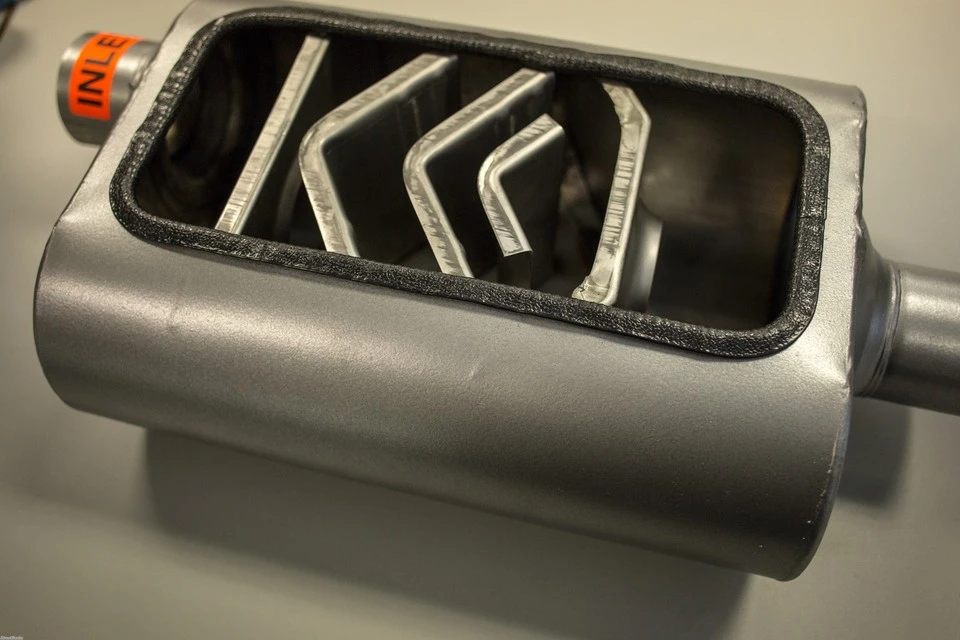

Chambered mufflers are designed to give a certain frequency of sound and cancel other frequencies. They are divided into "chambers" which have different diffusers in different design layouts in order to cancel frequencies and have no packing material, giving them pretty good flow. Chambered mufflers, IMO, are the only mufflers engineered to give a wanted sound while canceling unwanted sounds such as raspiness.
