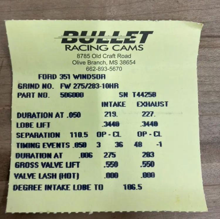

Just for the motor infor it is a new built 289 bored .040 with Wiseco pistons(part # pts500a4). Ford racing timing set. It has melling hydraulic roller lifters, and a bullet cam (see photo for specs).I have afr 185 heads, with upgraded springs. I am using trickflo 1.6 rocker arms and 6.300 comp push rods. I have a edelbrock dual plane intake. I am running Holley efi with hyperspark distributer with coil driver. Coil igntion. C4 trans with 2800 stall. Ford racing balancer.

Is that vacuum okay for my cam specs. Its a bit aggressive but nothing crazy?

Is 15 degrees a good start with this cam or should i go to say 22 and limit WOT to 36?

Hello,

For anyone with similar problems...I ended up adjusting the fueling to make it richer and this cleared up most problems. I need to take it to a tuner to get it fueled completely right. Seems its a large cam for a 289 and needs alot more fuel at idle...
