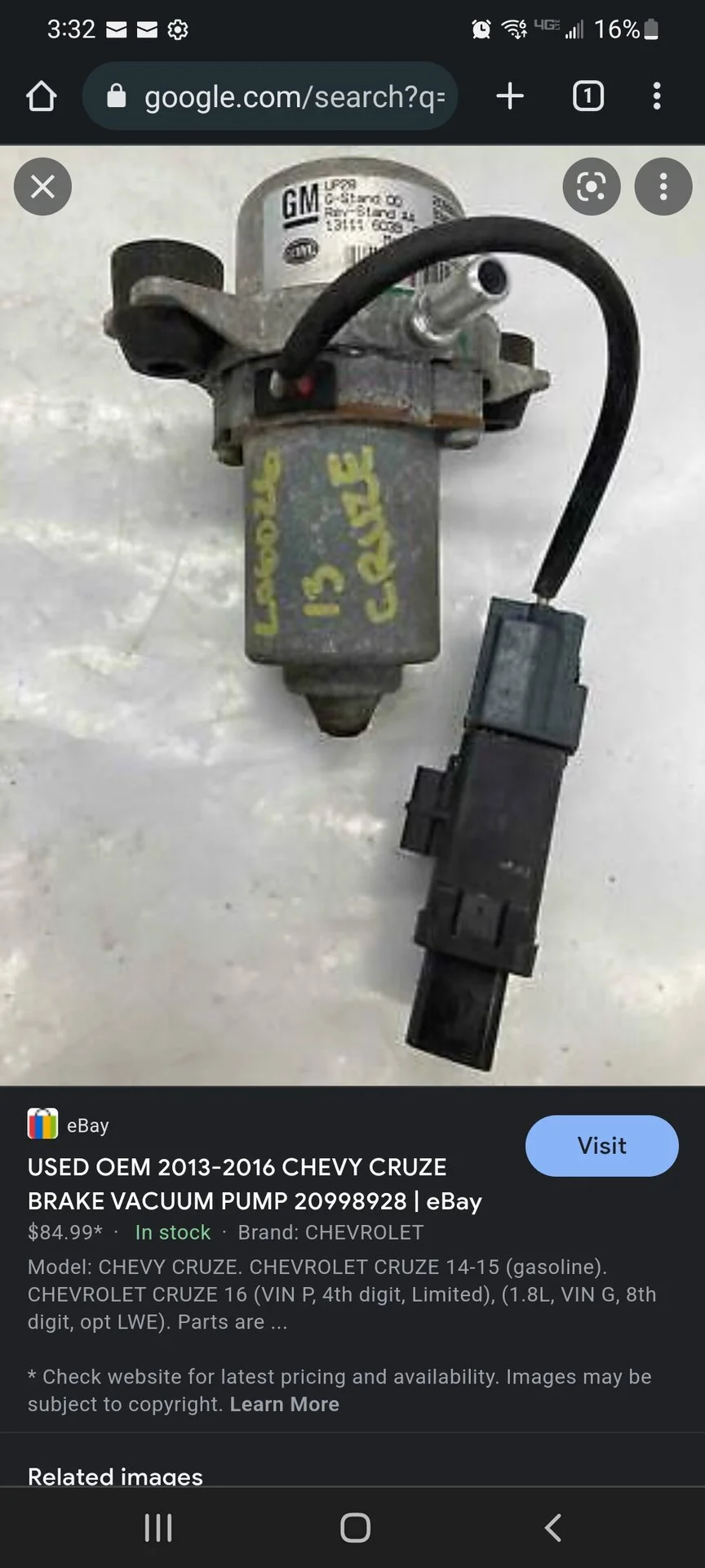

Chevy Cruze has a vacuum pump that has the relay plugged to it. Very easy to snatch at a junk yard ( I have one in my car because of my xe282hr comp cam ). They are also on the doge caravans and just about all the newer v6 and 4 cylinder cars. I chose the cruise because it's easy to pull everything you need. There's even a vacuum switch and all the check valves on the hose going to the booster. ( tan connector ). Very easy to wire up and comes on when booster vacuum drops below 16in.hg.
