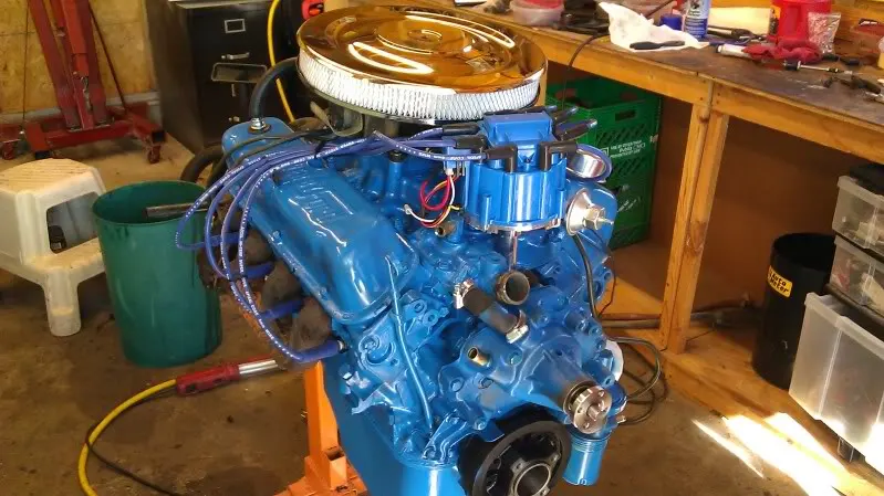

Here is a picture I uploaded from an engine I just did for a customer. This went in an old Ford truck. I put the PCV valve into the passenger side valve cover, and on the driver's side there is a breather oil fill cap. The hose going to this PCV valve is a little crude, I admit but he needed it done as cheaply as possible.
