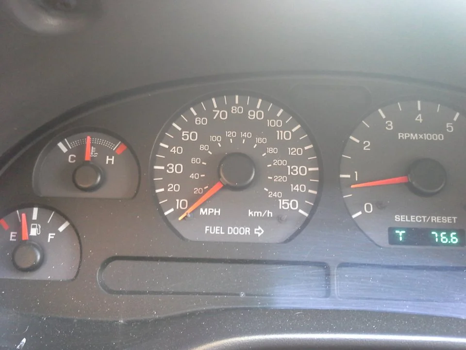

Here is a pic of the trip odometer and the fuel gauge. This is the actual miles since fill-up and is past a half tank already. Bare in mind this mileage reflects casual driving and not wreckless driving. Pretty crappy I have to say. That is why I would like to know if the PO455 is causing this terrible fuel mileage or not. Or should I be looking elsewhere for the problem?
Unless there is raw gas leaking from the filler neck, normally a P0455 will not have and effect on gas mileage. At the very least, there would be other DTC codes as well.

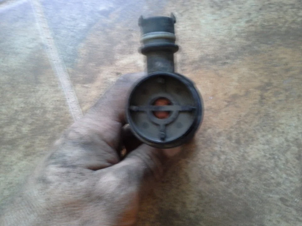

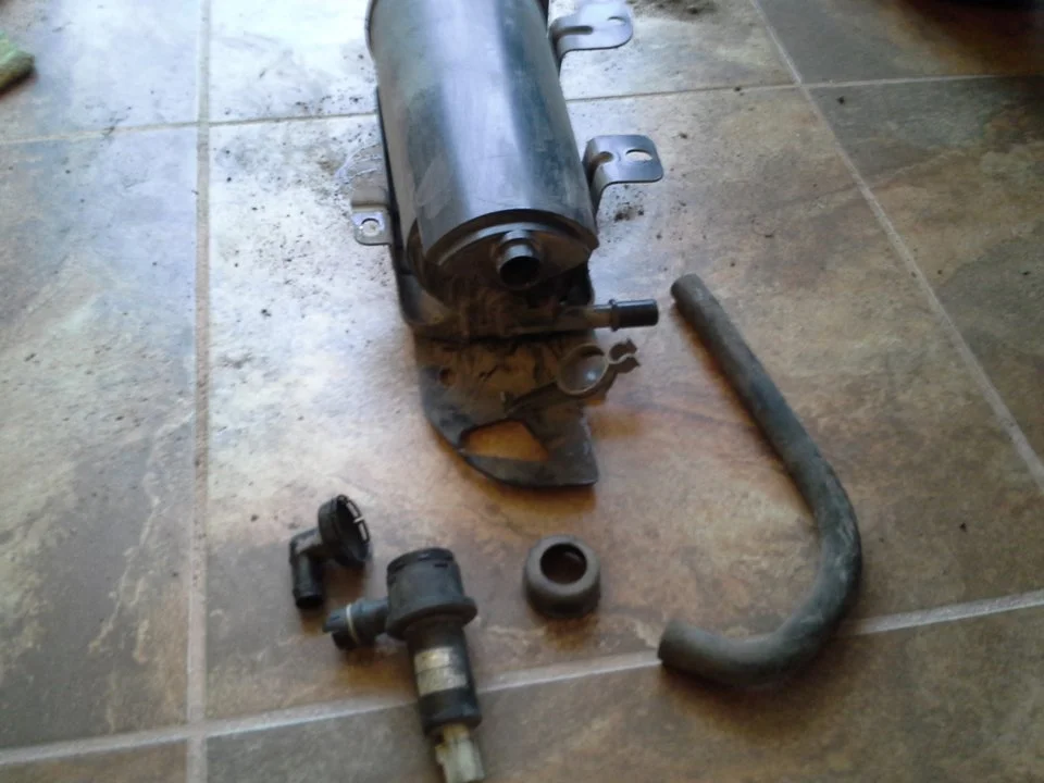

Well I have been reinspecting EVAP parts and still not have across anything out of the ordinary. I m getting puzzled, I took the purve valve off and opened it adn cleaned it out with condensed air, to include the internal filter. And I took the rear EVAP canister out and cleaned it up, cleaned out the external electrical valve also, to include cleaning the screen inside the valve, and the butterfly flaps inside. All seems to be in good standing order.

Can you blow through the charcoal canister? If not, vapors can't either. If just one time in this car's life the gas tank has been over filled (or filled while the motor is running), this could draw raw gas inside the charcoal canister. Once done this turns the charcoal to jelly thus blocking the canister. The only fix is a new canister. They are not all that expensive.

Well just a follow up to my cleaning and taking apart the purge valve solenoid and the charcoal canister and check valeve adn reinstalling it. I have since gone almost 200 miles since that work, and still no CEL lights. Usually it would only take 30-50 miles for the codes to pop up. But 200 miles later and no CEL's. I am finally happy that the PO455 is hopefully gone. I guess cleaning and blowing out the filter on the purge valve solenoid worked.

Good work fixing the EVAP DTC code. Sometimes EVAP problems can be very difficult to locate. I wish more PPL would tackle the problem like you did. IE, take apart, clean, inspect and replace as needed.
