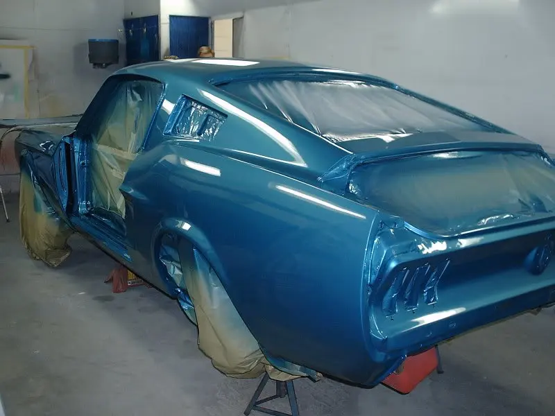

California, $12000 + . the shop that did our 65 (bare, media blasted prior to going to paint shop with the body on a rolling dolly). One shop wanted to start at 20K and go up without stripping the body (would have been significantly more as the quarter panel and tail light panel ended up being replaced). The shop that did ours had over 100 hours in labor and close the $1,000 in material at a minimum (search truck90278 their are photos of our 65)

It really is not a matter of "a bit more hits by a hammer". It takes a lot of time to prepare the surface for final color. Many hours of priming and block sanding, shooting guide coats and more block sanding. When a shop will spend easily in excess of 100 hours with out major repair work, the costs go way up. When you take into account the "cost of doing business" (workers comp, insurance, rent, equipment, EPA "environmental polution agency" etc.) it adds up fast. I have painted probably 15 special interest cars (~8 mustangs) and I have spent a mininmum of 100 hours up to 250 hours per car. The reason the "One Day" shops can do it cheap is they do absolutley the minimum of preparation (a couple of hours surface prep) and lowest cost paint purchased in bulk quantities, in fact their colors are limited. If you ask for a factory color their costs change. As far as cost of paint, the costs are more than just the base color. There is activator, reducers, hardners, clear coats with their hardners etc. Material prices can easily exceed $1,000.
As in an earlier response, I said we paid $12,000 for our Mustang paint and metal work, which included fitting some FG parts (I stopped painting, too much work). We got a bargain at that price. It all depends on what you want and how long it will last. One thing I would do is to look at their work on special interest vehicles. If a shop mainly does newer vehicles and insurance work, they tend to shy away from earlier special interest vehicles - their reason is that as they get into them they find many hidden problems and don't want to deal with the issures. Find a shop that does a lot of work on older cars if possible.
