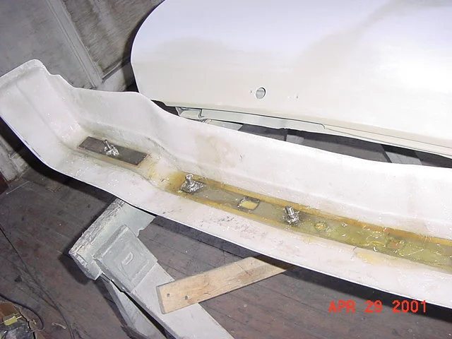

The fiberglass "bumper" is nothing more than a skin, and will need to be attached to a reinforcement beam if you want it to provide any protection.
Here's a pic with some metal strips fiberglassed into the back of the bumper. I believe that it came form one our forum members, but I don't remember who.
You can see that the metal strips have bolts attached so it can be fastened to a reinforcement beam of some sort.

I got one from Rod&race fiberglass. Seemed to be better quality than another one I purchased from another supplier. I removed my bumpers,split the outer shell from the main part and fiberglassed it to the bumper. After fiberglass was dry I used spray in foam to fill all the voids and make it feel solid. Sorry- no pics of process.
Thanks, That's my bumper. Those strips are put in the back to bolt it to the factory bumper beam. The is ths front I did the exact same thing with the rear.
