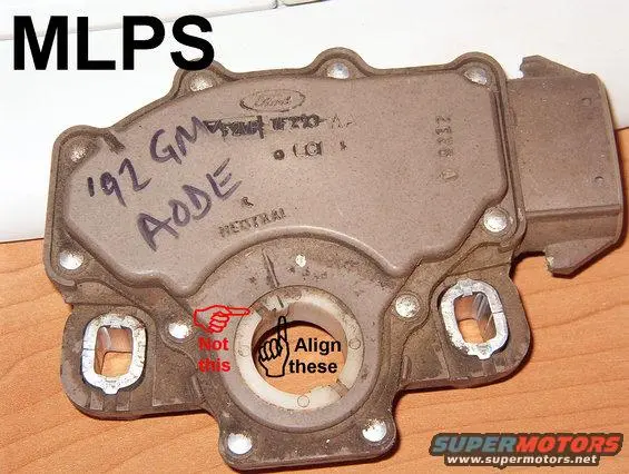

This is it here, it's under the drivers side. I'ts held on by 2 bolts where you see the small holes on the bottom left and bottom right. Really easy to replace, takes about 5 minutes.
I would try that first, they are pretty cheap from autozone/oreillys. In my case it didn't help. I ended up swapping to a 4r70w from a '02 V6, came out a whole lot cheaper than rebuilding.

found a pic on how to align.
Do I need to unbolt the cable ? or Not...
all I need to do is unplug connector and 2 bolts and install the new one and re align ? (while in nuetral ?

Nice find on that pic!

Here's a bit of a update om my auto problems...
Had that problem for over 2 years was getting bad this summer..
So I decided to try this out (MLPS sensor),
Well I got as far as locating mine and notice some rust on it so I unbolted the screws and re align the old one and got a rag and dip it in oil and apply it onto the sensor part hole..
IT'S Been 4 days and my tranny never downshifts and goes into nuetral for a few seconds anymore...
WORKS Execellent... tranny good as new once more...
PLUS I DIDN'T REPLACE IT JUST AJUSTED IT and oil it up !
Was going to autozone and get a new sensor but so far not needed.
