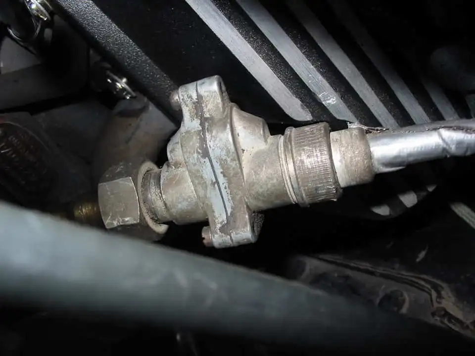

Incidentally, what is this? Anybody know? It's in between the transmission speedo cable, and the cable that runs to the cluster.
