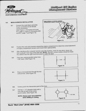

I am looking for the template to cut the hole in the firewall for the harness to pass through. I have seen this before but now I can't find it. Does anyone have a link for it or if you know the size of hole to start with I can go from there. Thank you.
Here ya go... happy cutting. Hopefully these are legible...
