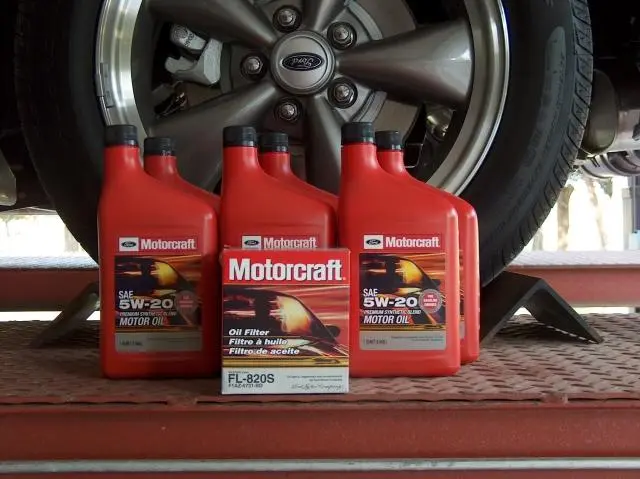

I just did my first change at 730mi. I had no problems getting my filter off however, I have a lift so I am able to get good leverage. She took a full 6qts.
