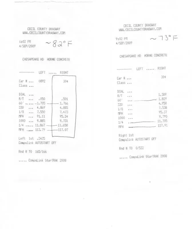

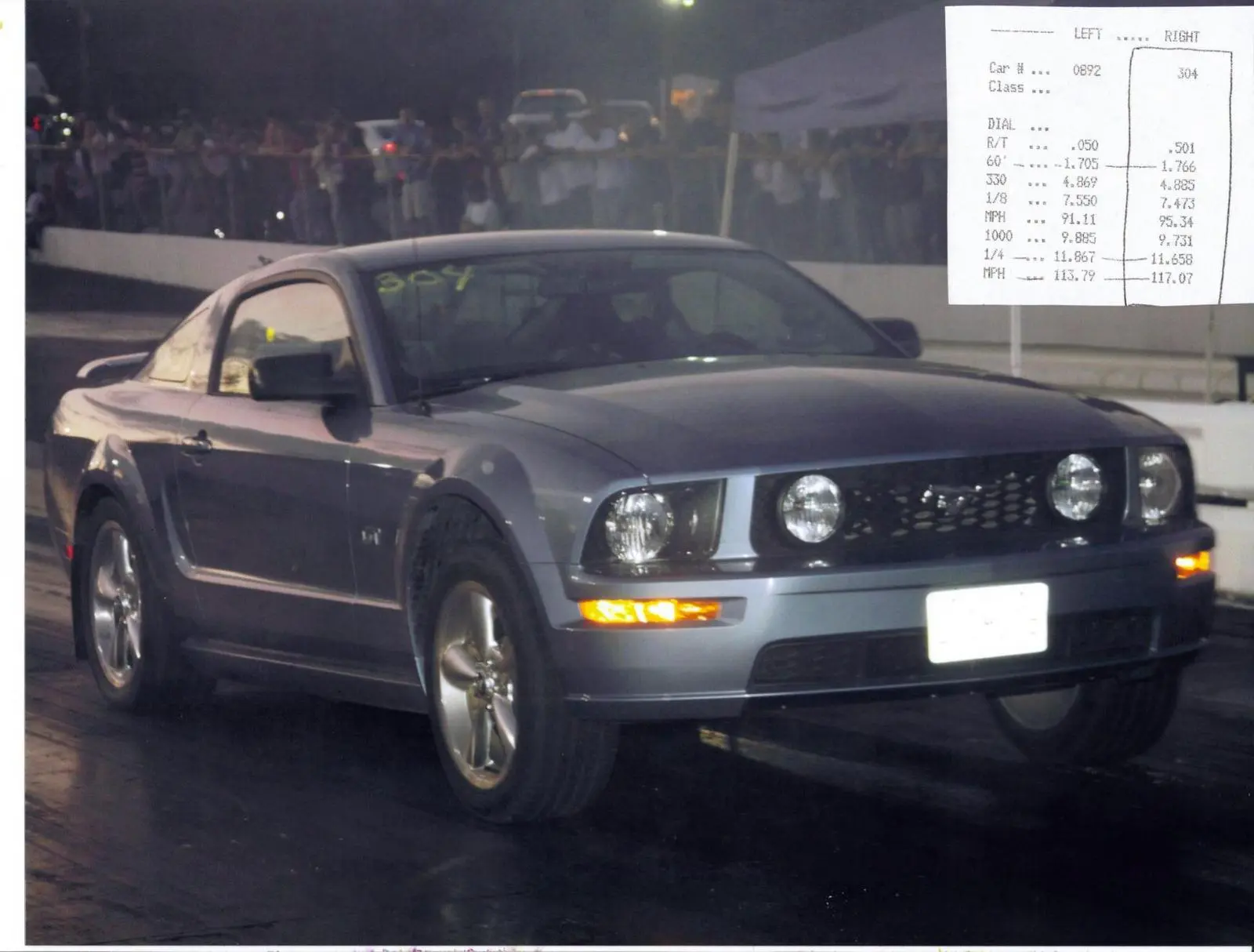

Finally got to the track w/ my new combo...
Needless to say I am very happy w/ the results...it seems like my S197 was the only one at Cecil breaking into the 11's when there were a bunch of Cars making "more" hp... except they seemed to be struggling w/ the launch...I felt like I was cheating w/ the auto... just hold the brake and give it a little gas... and let her rip when the light turns green. It does not get any easier that that.
On my very first pass ever... I went 11.658 w/ a 1.766 60 ft time in 82 deg weather
Mods to date:
Tillman's Edel E-force stage 1 w/ 3.50 pulley (7-9.5 psi), 450 rhwp SAE
JBA Shorties headers, magnaflow catted x-pipe, SSS Adrenaline axle-backs
100% stock suspension, gears (3.31's), transmission and converter.
Mickey T's drag radial on stock 18" bullitts (265-40-18)
There were a few GT500's that could not get out of the 12's to save their lives... one dude showed me his JPC dyno chart where he was making 572 rwhp.... 615 rwtq... and his 60 ft times were like 2.4 seconds and his best ET was 12.60 (I think).
Just trying to decide If I should put the stage 2 pulley on and get myself kicked-off for the hell of it...(no roll bar)
My timeslips are attached.

Tommy...I got some really funny looks...most people there at the track really were not familiar w/ the looks of an Edelbrock E-force supercharger. After my first run, people cam mope'ng around my car causually looking under my hood with a dumb-founded look on their faces...
The GT500's dudes came walking around too...I just played dumb and really did not get into any conversations...when asked... I just said a 9-10 lbs of boost from a supercharger and some axlebacks...nothing else...
