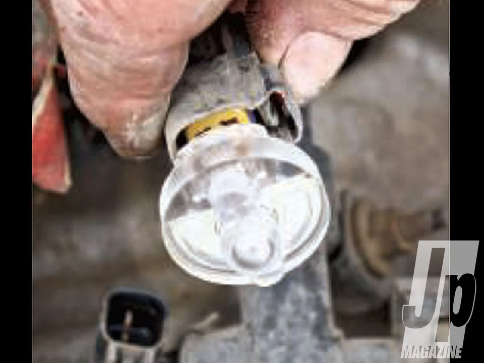

If you don't hear the injector pulsing, to check the injector for power, go to Autozone and buy a NOID test light. You simply disconnect the electrical connector on the suspected injector and plug in the NOID tester. Then start the engine. If the light flashes, you have power going to the injector and it is either clogged or bad.

The noid tester, is that alligator clip and light bulb type tester?

You can also make a home made one using a 194 bulb and a few inches of wire soldered onto the terminals.
