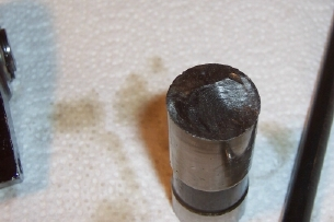

attachment.php
I hate when I'm right!
hey that looks like the one I recently pulled from mine,ate the lifter about a 1/4 inch.I have installed a few cams and this was my first that went flat and it really bugged me for days adjusting valves and a nasty noise would return.Mine was due to the oil filter getting plugged with moly lube,but live and learn. :rolleyes:
